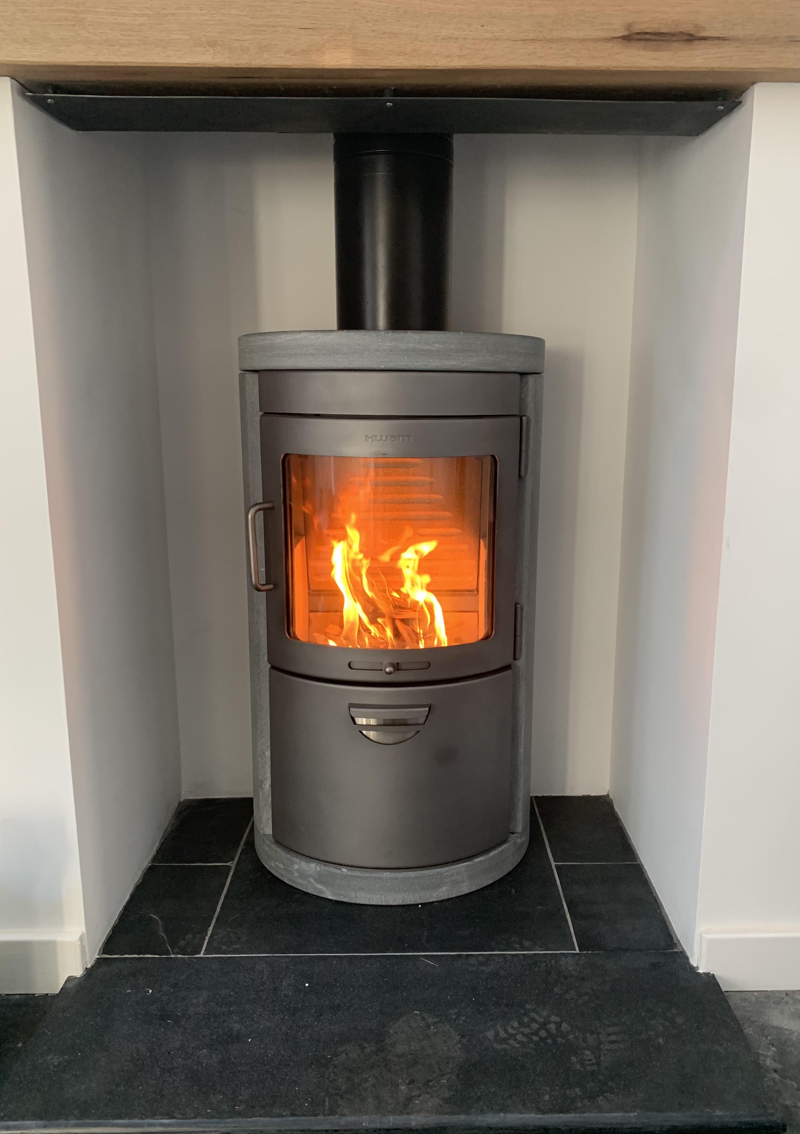

PeterW Posted December 31, 2020 Share Posted December 31, 2020 There is no easy correlation between stove size and heat output. Look up the 5kw Hwam stoves, they are very big but small output. This Hwam Beethoven with a soapstone surround is only 4.5kw for example. At over 1050mm tall, it looks big but isn’t ..! Link to comment Share on other sites More sharing options...

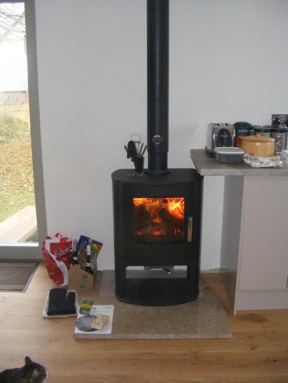

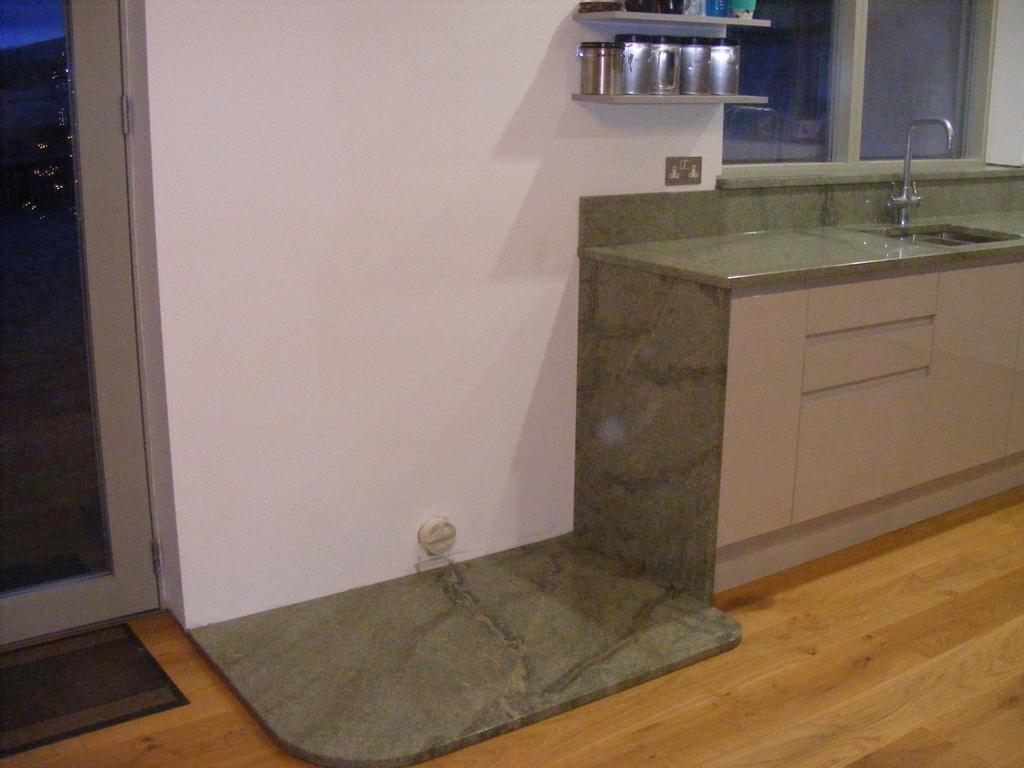

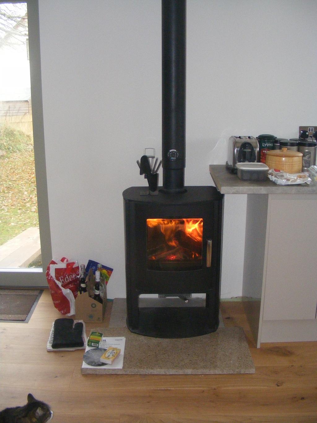

ProDave Posted December 31, 2020 Share Posted December 31, 2020 Mine is a Mendip stoves Churchill 5, log store convection model. We wanted a small stove that must have ducted air intake, and must look modern. We bought this as an ex display model on sale. That was with a temporary hearth and a temporary (illegally overhanging) kitchen worktop. Here is the final worktop and hearth before the stove was put back Link to comment Share on other sites More sharing options...

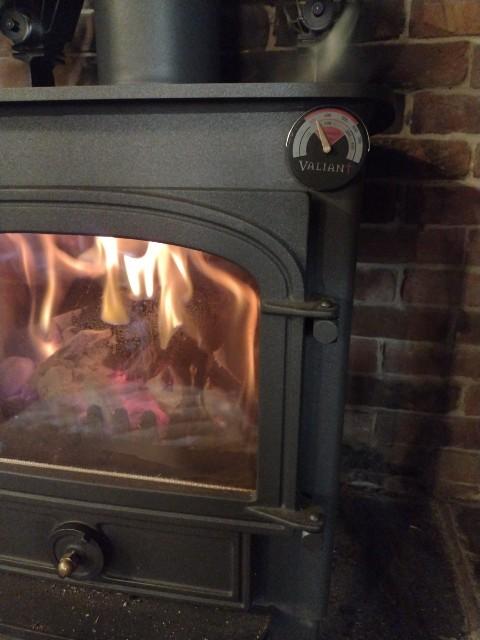

bassanclan Posted December 31, 2020 Share Posted December 31, 2020 The photo is of a Clearview stove. I think pioneer 500. The optimum burn on that thermometer is 140-300c approx. It generally sits around 150-200, but can get to 300c if you really load it and burn it hard. I have a Dunsley Yorkshire with back boiler and it's not as easy to light or control and doesn't keep as clear a screen as the Clearview,but does run at similar temps. Link to comment Share on other sites More sharing options...
