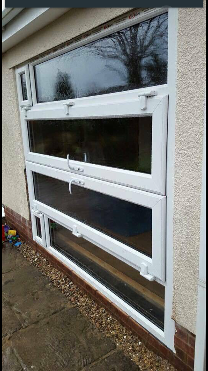

TerryE Posted January 29, 2017 Posted January 29, 2017 If you do want to fill the internal box sections, then the trick is to use the foam gun with extension piece and start be squirting in a small amount in the middle ,say about 1/10th of the length. This will then expand and harden over the next 6-12 hours to fill the middle third. Then repeat on each side in one or two more goes. Practice on one, then do all of the other cills in batch. Cut of the excess when full hardened. Doing it in multiple fills like this will avoid undue internal pressure build up and the risk of distorting the exteriors.

Onoff Posted January 31, 2017 Author Posted January 31, 2017 As above I faffed the sill up on the Evolution chop saw! Took it over my chippy mates last night for a perfect cut on his saw. Brought his laptop back to change the DC jack in return. Maybe next weekend! Got to make some wooden wedges too.
Nickfromwales Posted January 31, 2017 Posted January 31, 2017 Wedges just go in finger tight . Put them in the corners so as not to distort the legs. .
Onoff Posted January 31, 2017 Author Posted January 31, 2017 41 minutes ago, Nickfromwales said: Wedges just go in finger tight . Put them in the corners so as not to distort the legs. . So even though it's low expansion foam what stops the long, vertical sides bending in the middle if you only wedge the corners?
PeterW Posted January 31, 2017 Posted January 31, 2017 52 minutes ago, Onoff said: So even though it's low expansion foam what stops the long, vertical sides bending in the middle if you only wedge the corners? On a small window the sides are probably reinforced but you could wedge and screw the frame in and then fit the glazing with appropriate packers. Once glazed just foam in and it won't go anywhere.

Nickfromwales Posted January 31, 2017 Posted January 31, 2017 2 hours ago, Onoff said: So even though it's low expansion foam what stops the long, vertical sides bending in the middle if you only wedge the corners? On your window they're not what I'd call 'long' .

Construction Channel Posted January 31, 2017 Posted January 31, 2017 FWIW we usually foam ours after we have glazed them but i don't think that is for any real reason, You are not going to bend a 1m long leg with expanding foam, i don't care how much you try (no cheating and sealing it in), if you want to fill the sill with foam (i get a feeling you do) I can't see it causing an issue, just don't seal it in, let it come out the ends and cut it off after, otherwise just do as everyone else has said and fit the bloody window! I am dreading the day you ask about toeing and heeling a door.....
