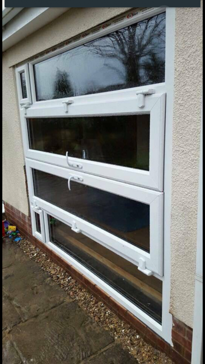

Onoff Posted January 29, 2017 Posted January 29, 2017 Got my small window made by a local company. Now I've only ever fitted two DG windows and from memory they were pre-glazed and I used tabs on the side. To long ago to remember tbh. Any tips? Sill How best to attach this? Options are mitre bond, Sika EBT, CT1 or some st/st wood screws up through the bottom. Or even a line of low expansion foam?Whatever, I think it needs a continuous "wet" seal to at least minimise draughts: End Caps Mitre bond? Fixing Got some generic M10x160 frame fixings. Good enough to save me buying any? 3 per side maybe? Window is nom 1000h x 600w. Compriband I've got some so seems rude not to use it. I've read you've got to be quick with it as it expands. My guess then is: - Old window out and hoover all round. - Assess where I can get a fixing (don't know what the wall construction is yet but think it's "solid"). -Trial fit window loose and gauge packs required -Drill 10mm holes in uPVC frame -Window back in and drill thru holes in frame into wall reveals -Window out, Compiband stuck on but cut where packs need to go? -Window back in, fixings in but not tightened fully -Packs in, tighten fixings -Glass in with packs all 4 sides -Leave Compriband to expand. -Foam fill/mortar gun outside Cheers

PeterW Posted January 29, 2017 Posted January 29, 2017 The cills are designed to be hollow and are box section to be insulating - no point filling with anything as you could distort them. Fitting a cill is as simple as a quick bead of clear CT1 or silicone along the back up stand angle and then 3 decent woodscrews holding it on to the bottom of the frame. Mitre bond the end caps on, don't forget to make sure the cill is centered or that you take the horns off before you start. Is it glazed or have you got to glaze it too ..?
Nickfromwales Posted January 29, 2017 Posted January 29, 2017 I always pack and level the cill first and concrete or tapcon it to the foot of the opening, sealing accordingly after with a combination of foam and frame sealant. Cut the horns first as said. Dont pre drill the frame ! Always drill with the frame in situ as you may pre drill on a hollow mortar bed or worse. . I line it all up, window in position ( unglazed ), shim it in tight with wooden shims and foam all around. DOUBLE CHECK AT THIS POINT THAT THE FRAME IS PLUMB, LEVEL AND SQUARE. Once set, only then do I drill for mechanical fix.

PeterW Posted January 29, 2017 Posted January 29, 2017 12 minutes ago, Onoff said: I'll tell you the bit that bugs me most is the gap between sill and frame between those two anchor shaped tabs (first photo). I know that's where things drain but to me it seems to defeat the whole object and be a weak point in terms of insulation/design. Do Not seal that gap ..!!! You will end up with a window frame full of water...!! We went back to a house where someone had done that - water running into the house as he had blocked that and the drain holes "to stop draughts".... 1
PeterW Posted January 29, 2017 Posted January 29, 2017 16 minutes ago, Onoff said: How about screw the sill on packing with st/st penny washers to hold that cavity together more? UPVC section has very poor pull strength for screws - try and do it up tight and you will find the screw spinning and just creating a hole. A frame that size may not have any reinforcing in it either - way to check is look inside and out around the frame for a series of small screw heads that mean either steel or ally has been added for strength. Not needed for plastic strengthening as it's weldable so doesn't matter if it moves slightly. CT1 on that back joint will be fine - the rest is all pretty standard.
Onoff Posted January 29, 2017 Author Posted January 29, 2017 52 minutes ago, PeterW said: Do Not seal that gap ..!!! You will end up with a window frame full of water...!! We went back to a house where someone had done that - water running into the house as he had blocked that and the drain holes "to stop draughts".... Oh no I wasn't going to just seems a silly design "feature" or is that oversight? The more I look the sillier the idea is of screwing the sill on. As I see it I would be penetrating the window frame for a start. Any hole would let water run down the screw thread and into the sill cavity. I don't really hold with the "mastic the screw threads" idea. At the moment water in the frame should exit via the front hole and down the slope of the sill. As I say I'm in the "cheaper" seats here. It's funny but I was brought up at a time when having "double glazing" was seen as a proper sign of affluence. My parents had aluminium at first which failed and now have replaced them with generic uPVC. It's only because of this site I realise all double glazing is NOT created equal!
Nickfromwales Posted January 29, 2017 Posted January 29, 2017 For a window that size, if it were me, I'd be fitting 6 screws. 2 top, 2 where the window slams shut and two at the bottom. With the foam and getting tiled in it's not going anywhere. I've fitted plenty of smaller ones with just the head fixed and the rest shimmed and foamed + frame sealant. Dont over think / do this one or you'll end up distorting the left and right legs. Damp the brickwork prior to applying LE ( pink ) foam and go have a brew. Hour or two later see just how good that is without screws and report back

Nickfromwales Posted January 29, 2017 Posted January 29, 2017 1 minute ago, Onoff said: Oh no I wasn't going to just seems a silly design "feature" or is that oversight? The more I look the sillier the idea is of screwing the sill on. As I see it I would be penetrating the window frame for a start. Any hole would let water run down the screw thread and into the sill cavity. I don't really hold with the "mastic the screw threads" idea. At the moment water in the frame should exit via the front hole and down the slope of the sill. As I say I'm in the "cheaper" seats here. It's funny but I was brought up at a time when having "double glazing" was seen as a proper sign of affluence. My parents had aluminium at first which failed and now have replaced them with generic uPVC. It's only because of this site I realise all double glazing is NOT created equal! Water is ok to enter between the window and the cill, been done that way for many years by many fitters. You need to fix the frame to the cill, end of, and stainless screws coated in silicone will not let anything through to the cill cavity.
Nickfromwales Posted January 29, 2017 Posted January 29, 2017 4 minutes ago, Onoff said: So do you screw the sill on, guessing not? Foam and frame sealant. This advice is for your small window. For eg I'd use concrete screws through the frame AND cill if this were French doors / similar or a large window. Edited to add. Don't forget to keep checking the cill for level whilst the foam cures. Best to weigh it down imo.

bassanclan Posted January 29, 2017 Posted January 29, 2017 I think you are overthinking this! 3/4 s/s screws to fit the cill (they were probably supplied, used for fixing the packing to the frame) 2/3 concrete screws/zebras, low expansion foam, frame sealant. All done in less time than you've spent writing on this thread!
