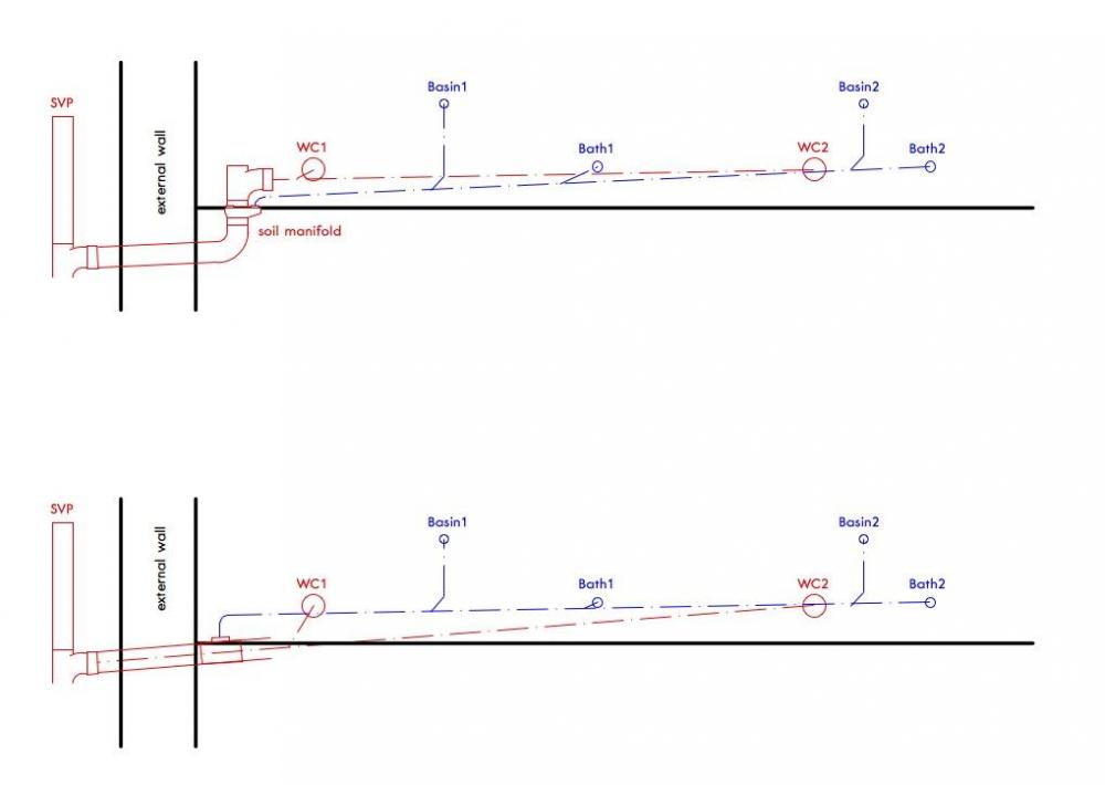

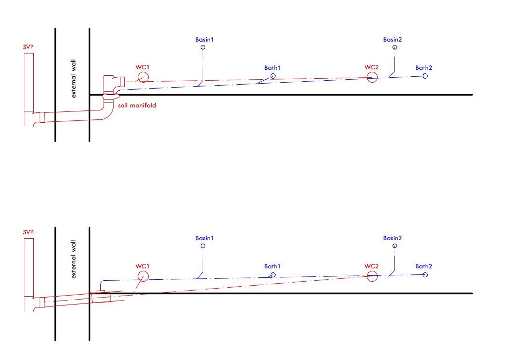

lineweight Posted December 21, 2020 Author Share Posted December 21, 2020 Essentially these are the two options I'm looking at. Top one, waste pipe is laid from WC2 to a "soil manifold" type connector at the most gradual gradient allowed and connects in as shown. Then, waste pipe from Bath2 can run at a slightly steeper gradient and connect in as shown. Bottom one, waste pipe from bath2 is laid as shallow as is allowed, then drops into a simple boss connection on the larger pipe, which is near horizontal at that point. Then, the larger waste pipe starting from WC2 runs at the steeper gradient, to whatever that level has to be. The bottom option seems the more straightforward. But is it ok just to drop the 'blue' pipe into the 'red' one like that, and if so does it have to go in the top or can it just go in the side (in which case the main pipe might barely have to drop below floor level). Link to comment Share on other sites More sharing options...

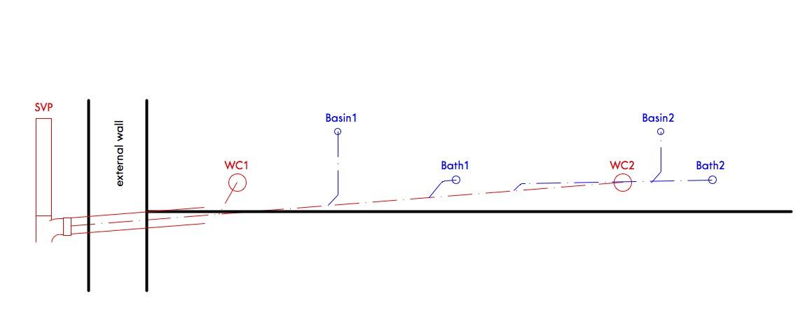

lineweight Posted December 21, 2020 Author Share Posted December 21, 2020 (edited) ...and if my second option is basically ok, does that mean that something like this would be ok: If the main 100mm pipe were running *below* the floor (so 300mm or so lower down) then it would be different.... but when I look at this, it doesn't look right because the baths and the WCs all look too closely connected and asking for problems if there's a blockage. Is there somewhere in the building regs or BS that specifically outlaws what I've drawn here? Edited December 21, 2020 by lineweight Link to comment Share on other sites More sharing options...

Temp Posted December 21, 2020 Share Posted December 21, 2020 I think I prefer your very first drawing with the manifold. However I would add a stub stack with AAV on the 110mm pipe on the right hand side near WC2. Also allow room for a small AAV near basin 2 on their pipe. Ideally instead of the manifold you would run two pipes through the wall to the stack where they would connect into it at different heights (thats in the Approved Doc) but if you can't do that then the manifolds should be ok. Link to comment Share on other sites More sharing options...
lineweight Posted December 21, 2020 Author Share Posted December 21, 2020 36 minutes ago, Temp said: I think I prefer your very first drawing with the manifold. Out of interest what would be your reason for preferring it? Because I thought I preferred it but then once I'd drawn it out, I couldn't actually come up with a reason why it's any better than the second one. Link to comment Share on other sites More sharing options...
Temp Posted December 21, 2020 Share Posted December 21, 2020 9 minutes ago, lineweight said: Out of interest what would be your reason for preferring it? I can't see how your bath works otherwise. Lets call the two pipes 110mm (WC) and 50mm (basin/bath). Even if the 110mm pipe is only just above floor level then the top connection into it for the 50mm pipe to the bath/basins would be something like 175-200mm above floor level. Too high for a bath?. With the manifold approach the 110mm pipe for the WC can be raised up (if you use WC with horizontal outlet). That means the 50mm pipe can then run under the 110mm pipe at floor level as per your drawing. Link to comment Share on other sites More sharing options...
lineweight Posted December 21, 2020 Author Share Posted December 21, 2020 1 hour ago, Temp said: I can't see how your bath works otherwise. Lets call the two pipes 110mm (WC) and 50mm (basin/bath). Even if the 110mm pipe is only just above floor level then the top connection into it for the 50mm pipe to the bath/basins would be something like 175-200mm above floor level. Too high for a bath?. With the manifold approach the 110mm pipe for the WC can be raised up (if you use WC with horizontal outlet). That means the 50mm pipe can then run under the 110mm pipe at floor level as per your drawing. As I've shown it, the top of the 110mm pipe would be just about at floor level where the connection was made. That obviously wouldn't work in all cases - but in this case it could, because of the way the floor joists work. Then there is still enough height difference between there and the outlet level for a bath. I've drawn it as if the connection goes vertically into the top of the pipe. But would it even have to? Approved Document H doesn't seem to have a lot to say about what should happen when one branch pipe joins into another. What it does say is: That seems to allow for the possibility that the smaller pipe could simply join into the side of the 110mm one. The soil manifold, I think, is mainly designed to deal with the Doc H requirements for what happens when a branch pipe connects into a stack. But that's not actually what I'm looking to do here. Link to comment Share on other sites More sharing options...
Gone West Posted December 22, 2020 Share Posted December 22, 2020 14 hours ago, lineweight said: ...and if my second option is basically ok, does that mean that something like this would be ok: I can't see a real problem with that layout and it is the way I would do it as long as the drop is ok. Link to comment Share on other sites More sharing options...
