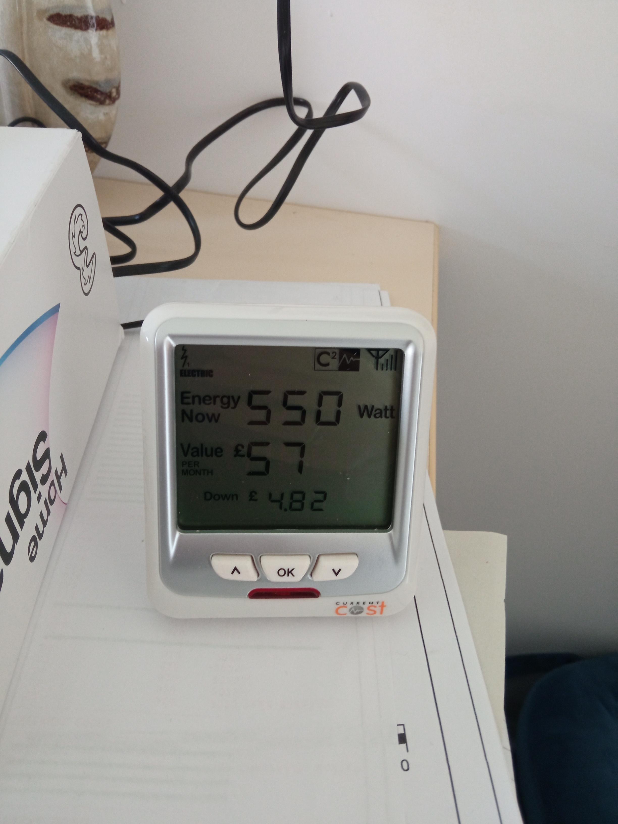

canalsiderenovation Posted February 12, 2021 Author Share Posted February 12, 2021 13 minutes ago, MikeGrahamT21 said: You sure someone isn't making a sneaky brew without asking if you want one too? ? Is the burst of 3kW a regular occurence? If so its time to start turning some circuits off and narrowing it down. The Current Cost monitor is now at 880-900w and pretty steady. We have the Quooker tap and it didn't really make much difference when my other half made me a drink. Link to comment Share on other sites More sharing options...

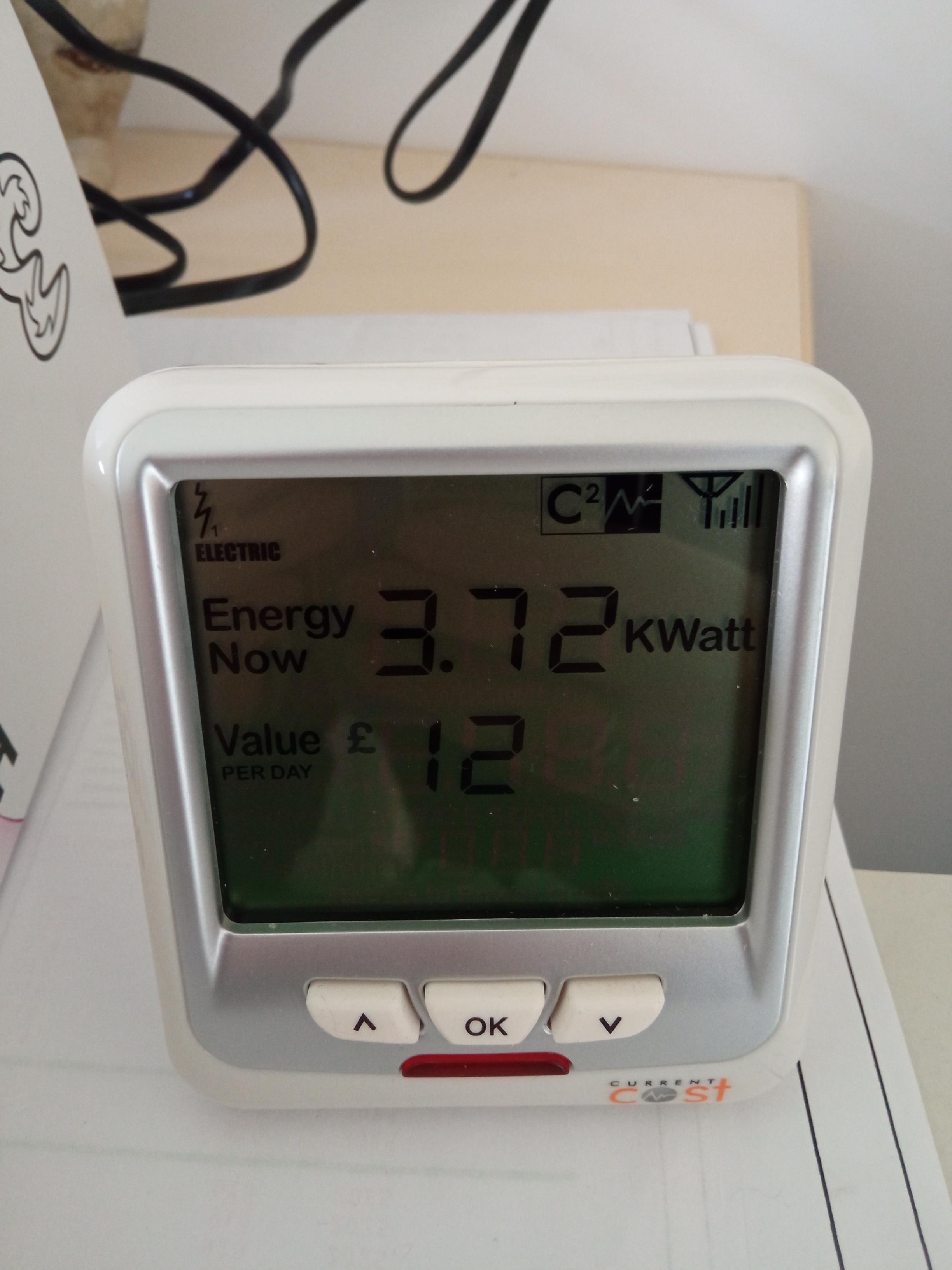

canalsiderenovation Posted February 12, 2021 Author Share Posted February 12, 2021 Sat in house nothing extra plugged in since I said it was fairly static at 800-900w and then this... Seconds later.. and it's now between 500-600w. It has to be the heat pump for our heating because we haven't changed anything else. Link to comment Share on other sites More sharing options...
MikeGrahamT21 Posted February 12, 2021 Share Posted February 12, 2021 3.2kw - Would this relate to your ASHP? Assuming they can modulate much like a gas boiler? What model is it? Had a look through the post and couldn't see it mentioned, apologies if i've missed it Link to comment Share on other sites More sharing options...
joe90 Posted February 12, 2021 Share Posted February 12, 2021 Can you not just “turn it off” when the reading is that high? Just to see if it is that causing the high usage? Link to comment Share on other sites More sharing options...

canalsiderenovation Posted February 12, 2021 Author Share Posted February 12, 2021 Just now, joe90 said: Can you not just “turn it off” when the reading is that high? Just to see if it is that causing the high usage? Yep when I see it shoot up again I'll turn the HP off and see if it's that! 1 Link to comment Share on other sites More sharing options...

canalsiderenovation Posted February 12, 2021 Author Share Posted February 12, 2021 It's the heat pump. The cost current shot up to 3.23 turned off the HP at the fuse and it dropped to 420w. When the reading on the cost current was 580w I turned off the HP and the meter dropped to 450w so when the HP calls for heat that seems to account for the increase. I will over the course of the week be able to see what happens when we use larger appliances. Link to comment Share on other sites More sharing options...
