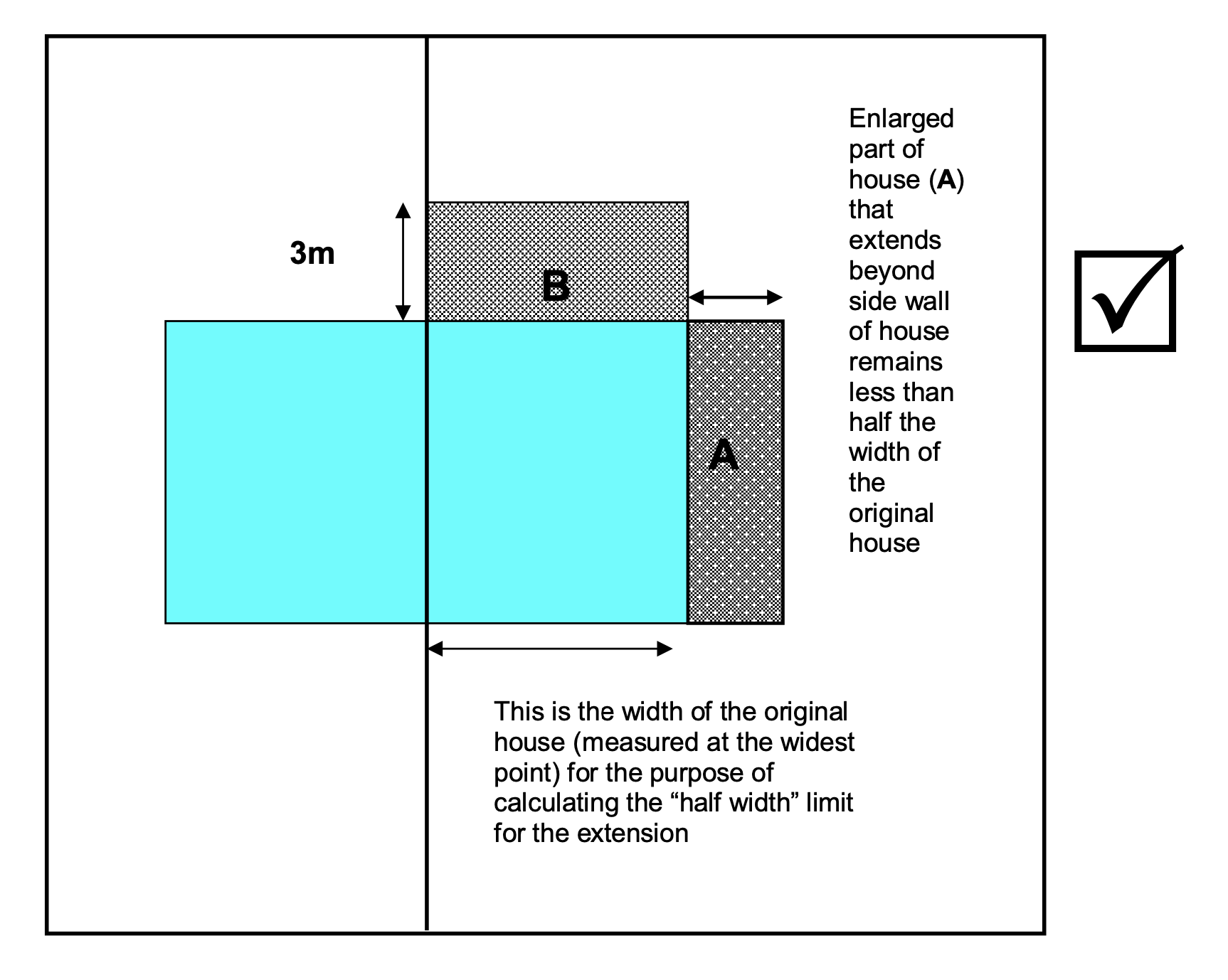

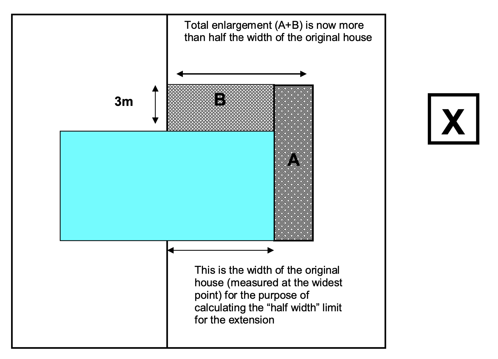

AliG Posted December 31, 2020 Share Posted December 31, 2020 3 minutes ago, Ferdinand said: It's a nice long garden... It is indeed. It seems crazy to have such long gardens and then the houses so close to each other at the sides, but it is what it is. I like the idea of that plan, I am not a fan of rooms much longer than they are wide, they are hard to use. A smaller room at the front and wider lounge at the back would work well. You will want to keep within permitted development rules, so no more than 4m back which it looks like you are within. Is that utility area actually a roofed extension as it would affect the ability to do a rear extension under PD, see these pictures. If not under PD you will have issues with the 45 degree rule. As far as I can see a side extension would also be within PD, so it is very much up to you if you think the cost is worth it, you will need a lot of steel. I think moving the garage wall and WC is a lot of work for a very small benefit, the garage will be around 3.2m wide without this. Keeping the front pf the garage stepped in a little as shown would be a good idea. The thing that would make the biggest befit to using the garage is a wider door which you would have room for. 1 Link to comment Share on other sites More sharing options...
