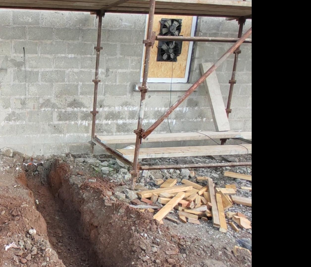

Iceverge Posted January 20, 2021 Posted January 20, 2021 The best thing you can do is make sure your builders understand the concept in that case and the level of detailing required to get a good result. I'd scour eBay and buy a car fan, wire and some crocodile clips to make up a test fan in a sheet of OSB or ply for one of the windows. Clip it onto the car battery to depressurise the house, (best to leave the car running I found as it draws a lot of current and flattens the battery). Go searching for leaks with the back of your hand. This will do more explaining about the nature of airtightness than anything else I could say. https://www.ebay.co.uk/itm/2006-2011-LEXUS-IS220-2-2-D-RADIATOR-FAN-422750-1620-/203184726071?_trksid=p2349624.m46890.l49292 1
tanneja Posted January 20, 2021 Posted January 20, 2021 7 hours ago, Iceverge said: The best thing you can do is make sure your builders understand the concept in that case and the level of detailing required to get a good result. I'd scour eBay and buy a car fan, wire and some crocodile clips to make up a test fan in a sheet of OSB or ply for one of the windows. Clip it onto the car battery to depressurise the house, (best to leave the car running I found as it draws a lot of current and flattens the battery). Go searching for leaks with the back of your hand. This will do more explaining about the nature of airtightness than anything else I could say. https://www.ebay.co.uk/itm/2006-2011-LEXUS-IS220-2-2-D-RADIATOR-FAN-422750-1620-/203184726071?_trksid=p2349624.m46890.l49292 This is really appreciated @Iceverge. Can I ask a nonsense question? Our house is part old construction (solid 215mm brick, with decent condition sand cement external render) and part new (300mm double medium density block skins with insulated cavity). The old build is to be covered with EWI (100mm EPS) and then both think coat render silicone silicate over top. Question is can the parge coat be applied externally for the old build under the EWI? Seems like it would still be behind the insulation. Presumably for the new build it needs to be on the inside to be on the inside of the insulation. Just wondering if, weather permitting, an external coat prior to EWI would be simpler to manage the joist joints. Maybe it wouldn't stand up to even a short duration in the elements.
Iceverge Posted January 20, 2021 Posted January 20, 2021 1 hour ago, tanneja said: This is really appreciated @Iceverge. Can I ask a nonsense question? Our house is part old construction (solid 215mm brick, with decent condition sand cement external render) and part new (300mm double medium density block skins with insulated cavity). The old build is to be covered with EWI (100mm EPS) and then both think coat render silicone silicate over top. Question is can the parge coat be applied externally for the old build under the EWI? Seems like it would still be behind the insulation. Presumably for the new build it needs to be on the inside to be on the inside of the insulation. Just wondering if, weather permitting, an external coat prior to EWI would be simpler to manage the joist joints. Maybe it wouldn't stand up to even a short duration in the elements. no nonsense questions only nonsense answers! yup it can be done like in the below picture with airtight paint. the trouble is thought that it’s difficult to join to your roof airtight layer. if you’re joining to the windows with an external parge coat you’re very weather dependant to get tapes to stick. it’s impossible to pinpoint leaks using a depressurisation fan afterwards too. Have a look through Philips from prodomos blog, i found it useful. I also bought all my airtightness kit from him although i’m not sure if he can supply GB post brexit. https://www.prodomo-ireland.com/prodomo-ireland-s-blog/
tanneja Posted January 21, 2021 Posted January 21, 2021 (edited) On 20/01/2021 at 00:59, Iceverge said: The best thing you can do is make sure your builders understand the concept in that case and the level of detailing required to get a good result. I'd scour eBay and buy a car fan, wire and some crocodile clips to make up a test fan in a sheet of OSB or ply for one of the windows. Clip it onto the car battery to depressurise the house, (best to leave the car running I found as it draws a lot of current and flattens the battery). Go searching for leaks with the back of your hand. This will do more explaining about the nature of airtightness than anything else I could say. https://www.ebay.co.uk/itm/2006-2011-LEXUS-IS220-2-2-D-RADIATOR-FAN-422750-1620-/203184726071?_trksid=p2349624.m46890.l49292 Going around the house feeling for leaks is presumably a labour of love. Did you use additional devices to quantify the ACH and Pa when performing this exercise? Also super appreciate the external approach information. Fortunately where our joists go into wall plates, I think an internal parge ove rthe walls, with blowerproof around the edges of that wall plate should be really effective. If the joists were into the wall then that would presumably be much more work with ensuring airtightness around the joists. Edited January 21, 2021 by tanneja
Iceverge Posted January 21, 2021 Posted January 21, 2021 It's not difficult, just take your time. After various experimentation with a beesmoker, Joss sticks, talc etc I found the easiest way was the back of your hand for the larger leaks, it's surprisingly sensitive. Then I shoved a long candle into a piece of conduit for the minute pinholes. This was remarkably accurate at finding weak spots with the added advantage you don't have to do any climbing or bending down No special equipment, some on here have DIY'd manometers but it's not easy to make an accurate one The guy with the blower door did the proper measurements Are your joists built in already?

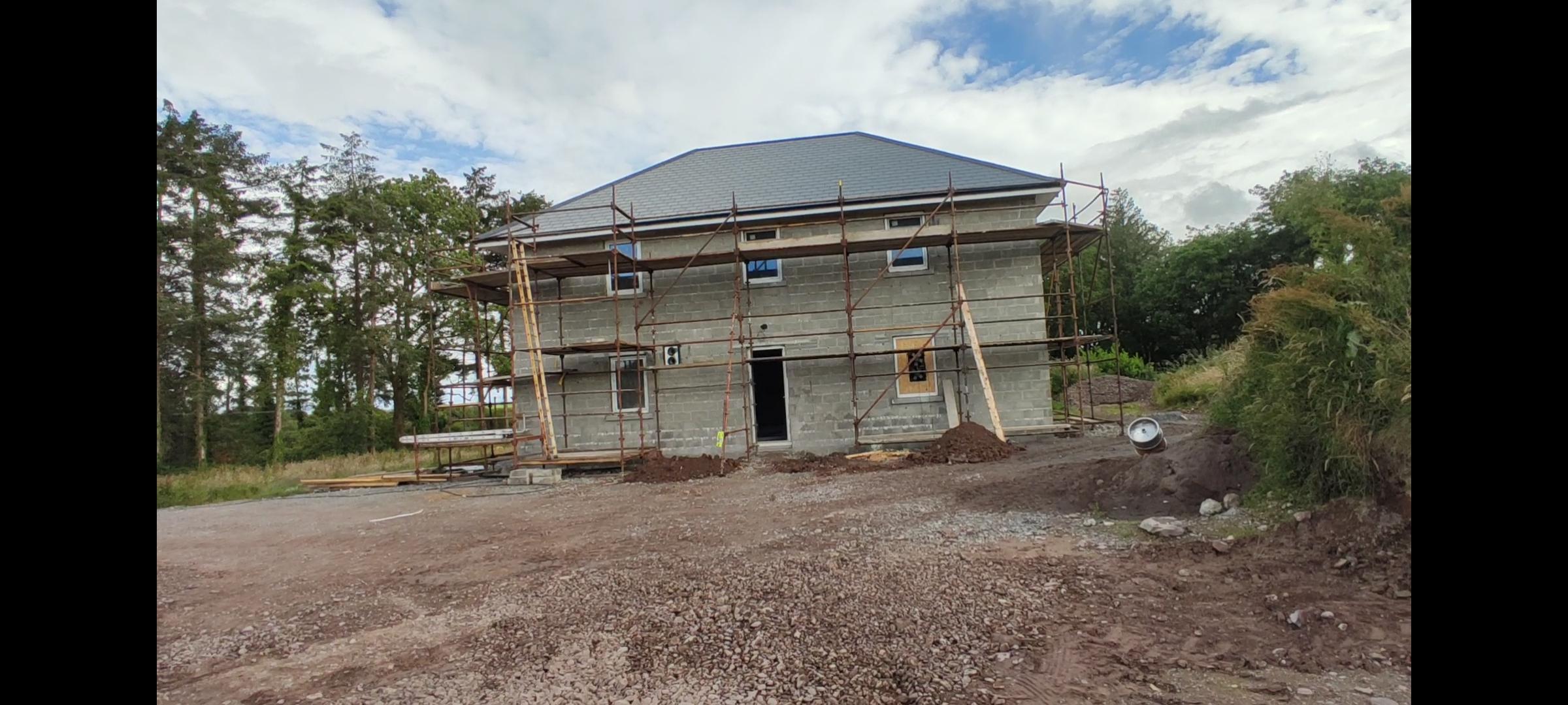

tanneja Posted July 25, 2021 Posted July 25, 2021 A bit of a resurrection here. Airtightness throughout the house has seemed to go well, plan a test once the spots go in upstairs and able to hood over them, but VLC and parge throughout. One element of the build that I am uncertain about is the attached garage (has a garage door, a back door to garden and access door to the house). It was build up to it's current stage before we thought seriously about air tightness. It will likely be used as a home gym and storage area, unlikely to have a car. I appreciate regs say it can't be an airtight space, so this is more hypothetical. Just thinking ahead to if it becomes habitable. We are likely to have the garage door just be a fixed, cellotex backed sheet of ply for the foreseeable future due to costs, but at least can make it air tight. The back door is airtight, and the window / skylight airtight detailing has been done to the best of our ability. The issue is the room construction is double skin (rock wool filled) breeze blocks, ceiling is vaulted rafters with regs thickness cellotex intra and under the timber structure, but no air tight layer, all of which which have already been dot and dabbed / screwed PB as appropriate, but not yet skimmed. . What hope can I have of making this room relatively airtight at this late stage? Is whole room blowerproof prior to skim a good idea? Unsure if the skim will take to the blowerproof well enough if used over all the floor and ceiling. I could just blowerproof the PB joins? Ask for thicker than usual skim? Obviously also need to look at all the PB penetrations (sockets etc) and make sure they have appropriate putty / silicone treatment. Obvious solution is to forget about any of these and focus on a good airtight insulated door between house and garage, but exploring all our options. Any guidance would be much appreciated.
