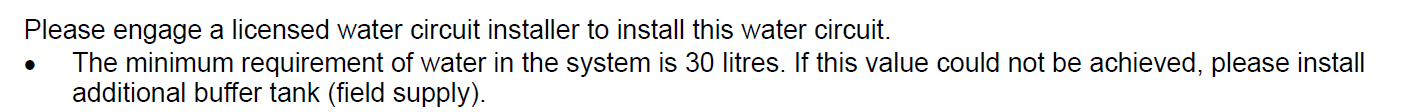

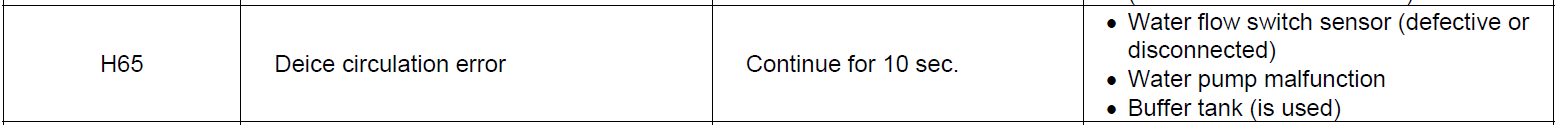

jack Posted December 14, 2020 Posted December 14, 2020 From the installation instruction manual for my 5kW Aquarea model (WH-MDC05F3E5): I interpret this as suggesting a buffer tank is not required. I believe there's a small internal buffer in the unit, hence the use of "additional" here. And the troubleshooting section says this: I assume "is used" is a typo for "if used", which again suggests that a buffer tank is not compulsory. As an aside, the (Panasonic-authorised) engineer who fixed mine suggested that a buffer tank was desirable irrespective of what the manual said. 1
Temp Posted December 14, 2020 Posted December 14, 2020 Google found this but I don't know if this is a totally different model.. https://heidi-air-conditioning.co.uk/assets/downloads/user-manuals/panasonic-aquarea/End-user-guide-F-and-G-series-A2W_HR.pdf "H65 Defrost circulation error Reset once if reoccurring contact your local Panasonic installer, quoting fault code"
Temp Posted December 14, 2020 Posted December 14, 2020 5 hours ago, jack said: From the installation instruction manual for my 5kW Aquarea model (WH-MDC05F3E5): I interpret this as suggesting a buffer tank is not required. I believe there's a small internal buffer in the unit, hence the use of "additional" here. And the troubleshooting section says this: Oops I miss read that as DEVICE circulation error whereas it says DEICE which is same as DEFROST.
Temp Posted December 14, 2020 Posted December 14, 2020 (edited) So are they saying you need a nice big buffer tank full of hot water to defrost it when it ices up? Could "Buffer tank (is used)" mean "Buffer tank (is used up/cold)"? Edited December 14, 2020 by Temp
Rohan Posted December 14, 2020 Author Posted December 14, 2020 8 hours ago, PeterW said: @Rohan what is the make and model number for the heat pump ..? Panasonic WH-UD16FE5
Temp Posted December 14, 2020 Posted December 14, 2020 1 hour ago, dpmiller said: if so why would a new pump fix it? Pure speculation but.. Perhaps if the pump is failing the controller thinks it needs a defrost cycle. If that involves pumping hot water from the system/buffer it seems reasonable it might generate a defrost circulation failure error. Perhaps it tries to do a defrost but because the pump is failing the flow temperature falls and it thinks its out of hot water to do the defrost. I'm making this up as I go along so happy to be corrected if this is wrong.
PeterW Posted December 14, 2020 Posted December 14, 2020 3 hours ago, Rohan said: Panasonic WH-UD16FE5 So in the MIs it states the following : Go back to Panasonic, quote their own MIs and say this did not require a buffer as over 50 litres. Give them the exact reference above and then ask them when they would like to send their engineer .... 1
