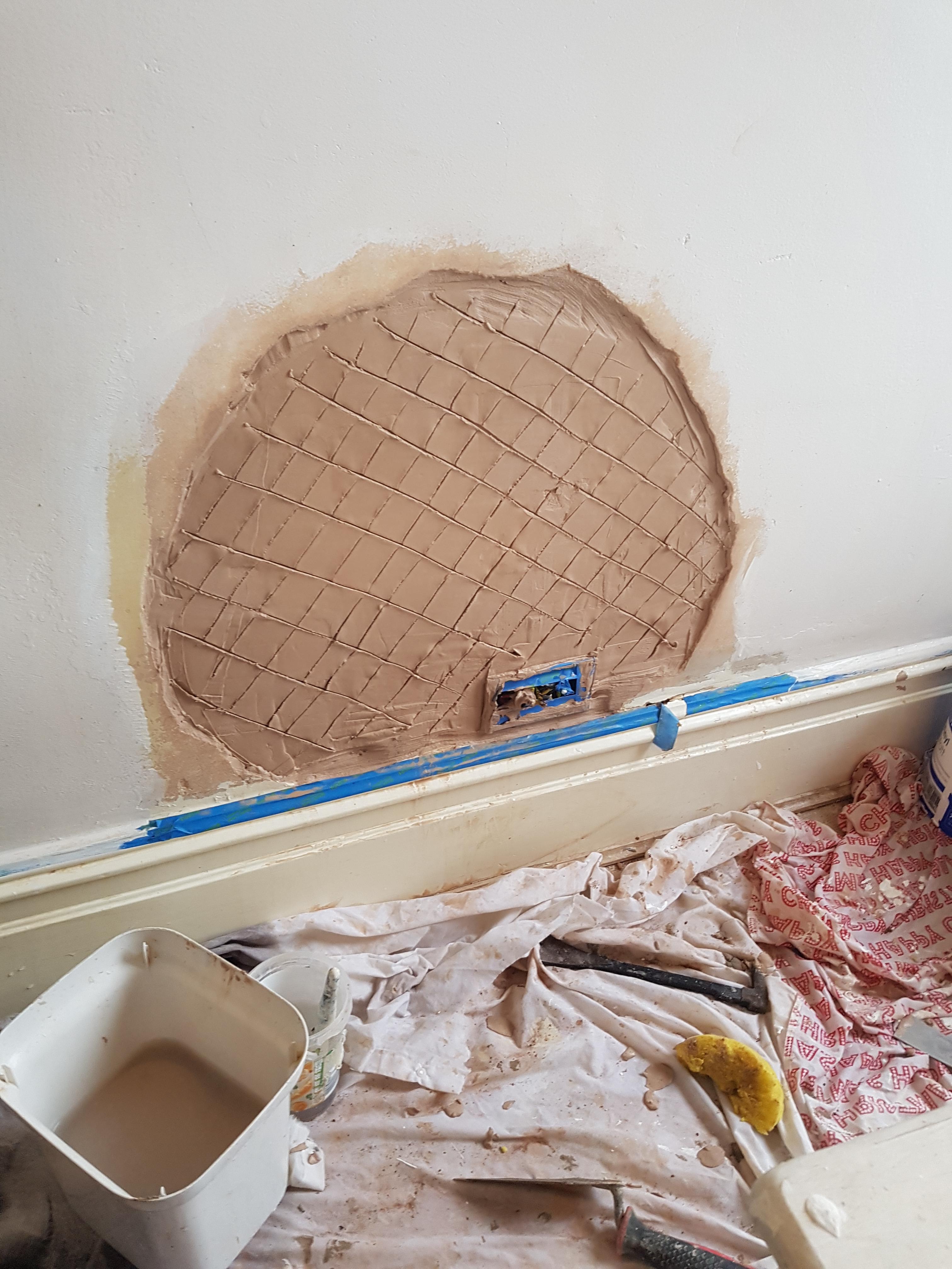

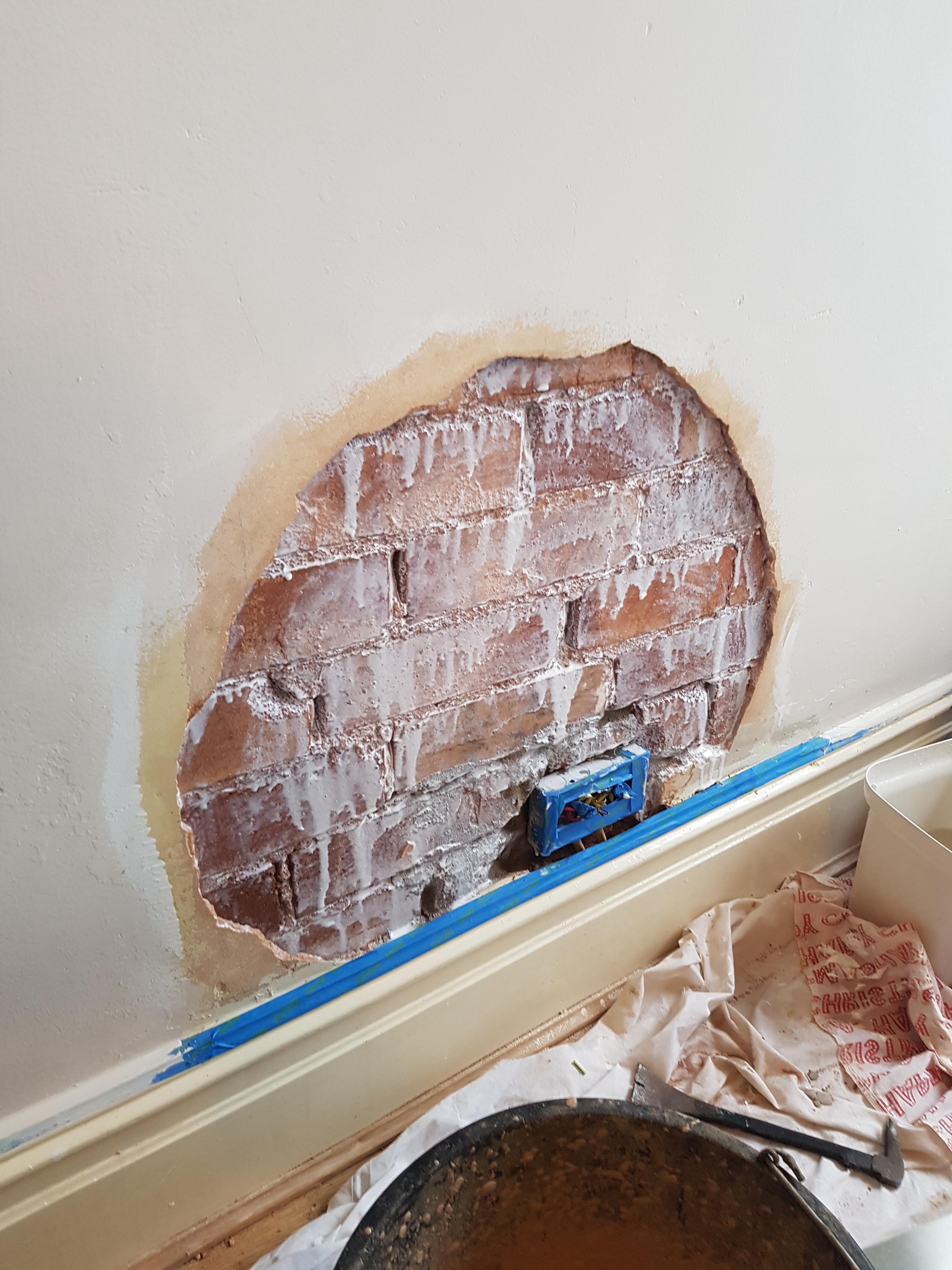

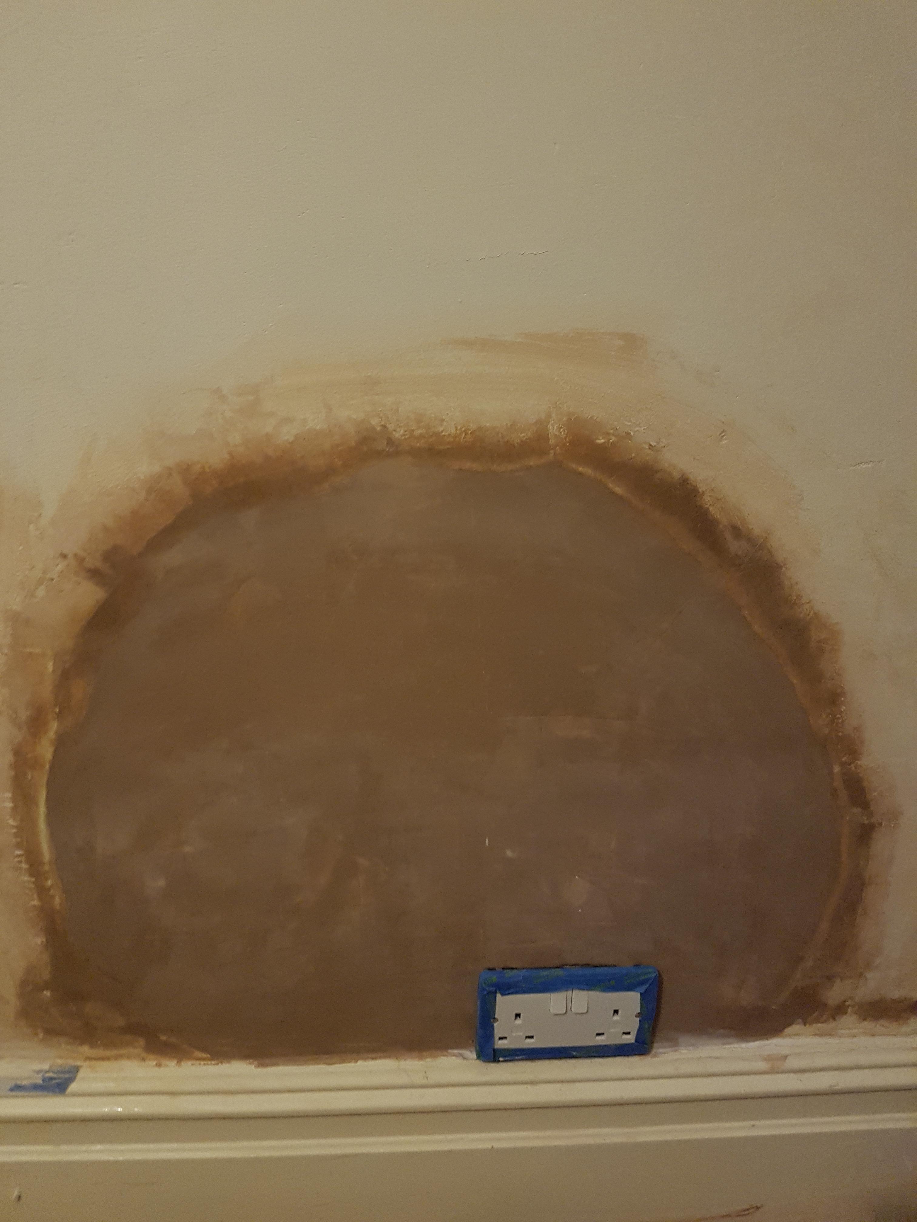

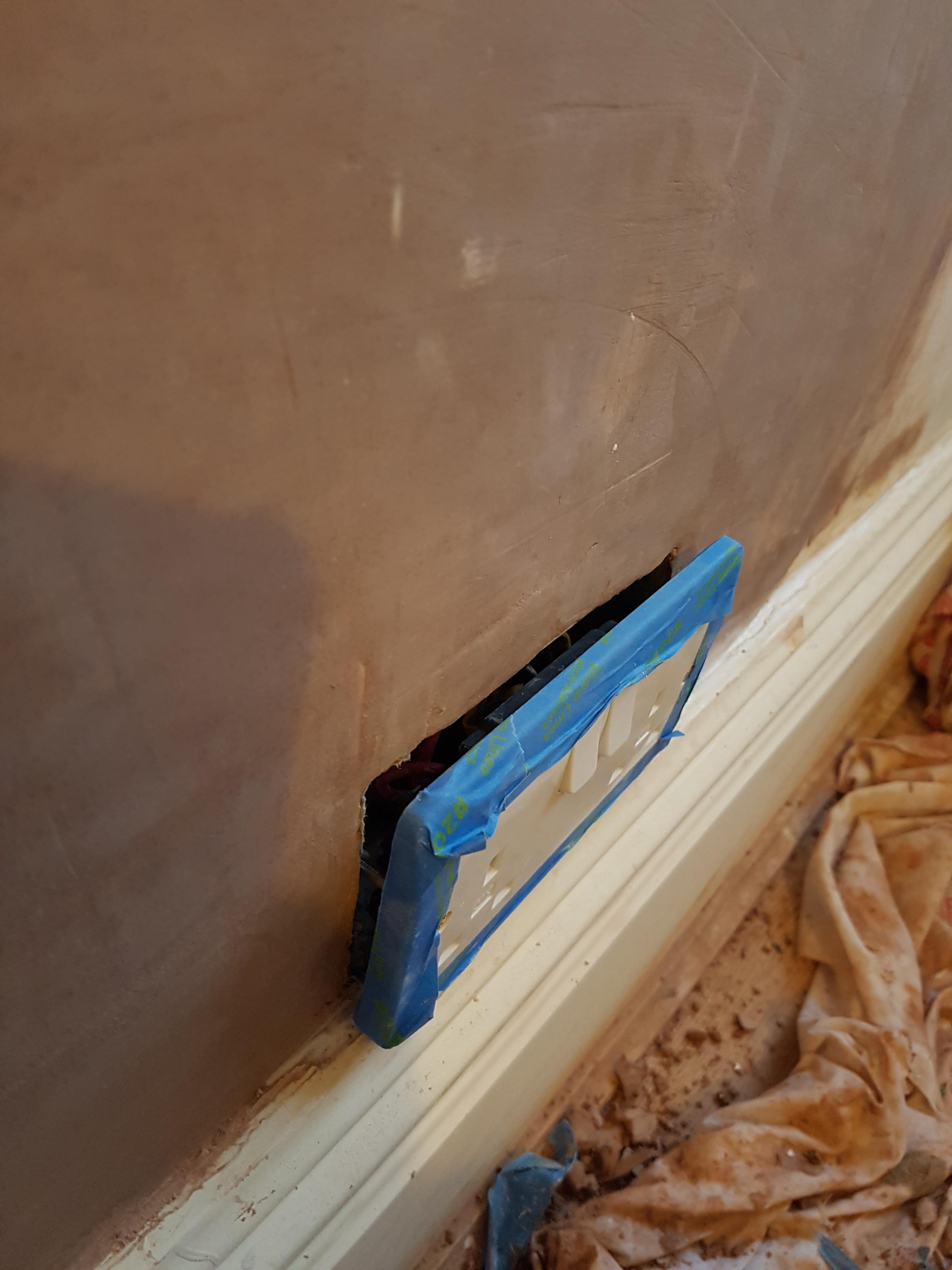

Moonshine Posted December 10, 2020 Share Posted December 10, 2020 I am decorating my living room, and had to deal with an area of some blown plaster. It was about 8mm deep and 750mm diameter. Because it was a small area i couldnt be arsed to get a plasterer in and as it's going in a hidden spot behind a sofa, I figured let's have a go myself, though this was my first ever time plastering, and the location of the back box wasn't helping how easy it would be. I hold plasterers in high regard as it's a heck of a skill and a physically demanding job, that in mind I hit YouTube.... After a few videos, my plan of attack was, - weak dilution PVA on bare brick and plaster side walls, allowed to dry. - stronger dilution PVA on top, allowed to go sticky. - one coat of multi finish to 3-4mm, smoothed fairly flat and keyed, allowed to dry to firm but damp. - top coat of multi finish to 3-4mm smoothed flat. Photos of stages below Wet PVA prior to first coat First coat keyed Second coat Detail around back box It took ages to get the final coat smooth. However I think that I made the final coat too sloppy and sagged towards the skirting. It was a bit of a struggle to work with. Also I was able to see the keyed first coat through the second until it dried a bit. Overall pretty happy with how it turned out, and feel more confident to tackle larger area, but I would be interested to hear where I can improve. Link to comment Share on other sites More sharing options...

PeterW Posted December 10, 2020 Share Posted December 10, 2020 @nod will be along shortly to give you your Strictly Come Plastering scores, but that doesn’t look too bad ..! Trick is to leave it alone and not constantly mess with and then flat it back. 1 Link to comment Share on other sites More sharing options...
Moonshine Posted December 10, 2020 Author Share Posted December 10, 2020 2 minutes ago, PeterW said: Trick is to leave it alone and not constantly mess with and then flat it back. That was what I heard, but I couldn't stop fiddling with it ? Link to comment Share on other sites More sharing options...
MikeGrahamT21 Posted December 10, 2020 Share Posted December 10, 2020 56 minutes ago, Moonshine said: That was what I heard, but I couldn't stop fiddling with it ? Yeah that was the biggest thing I learnt too when plastering, patience, leave it alone, its amazing how it wets back up to smooth it. Would also say if your final coat was sagging you may have been a bit on the thick side. I know its hard when doing a patch though. Link to comment Share on other sites More sharing options...

Moonshine Posted December 10, 2020 Author Share Posted December 10, 2020 8 minutes ago, ProDave said: It mixed up and went on okay but set it a matter of minutes and I could hardly get it flat before it was going stiff and became unworkable and ended up with a poor finish. Did you PVA the wall you were patching first as if not the bear bricks will leach away the moisture from the plaster(?). Also how hot was it in the room when you did it, it was cold in the room i was working in. Link to comment Share on other sites More sharing options...
MikeGrahamT21 Posted December 10, 2020 Share Posted December 10, 2020 38 minutes ago, ProDave said: I only tried plastering once, at my previous 1930's house, just patch repairs like this. I would love to know what I was doing wrong. It mixed up and went on okay but set it a matter of minutes and I could hardly get it flat before it was going stiff and became unworkable and ended up with a poor finish. Then when we had an extension built and had a plasterer in I was staggered by how long it remained workable. I had assumed it was because he had plastered a whole room and it was so wet and humid in there it stopped it drying out too quick? Assuming your plaster was in date? Poured the plaster into water, not water into plaster? Consistency should be like greek yoghurt, nice and creamy. All equipment fully clean, and water crystal clear? Any speck of plaster will cause it to go off super quick. If you splash with water too soon it makes it go off also, water causes it to harden. I've seen all sorts of tricks to slow or quicken the setting times in videos online. Link to comment Share on other sites More sharing options...

nod Posted December 10, 2020 Share Posted December 10, 2020 5 hours ago, Onoff said: This was the lad I "learnt" from when my boy & I plastered the bathroom ceiling and one half wall. Really pleased with both. Adding cream of tartar to the mix gives extra working time. Old plasterer's trick. It works. Easifill 20 is good too for filling those last imperfections. Trick is to give it a coat let it go in Then mix a small amount for the second coat It will smooth out easier Looks a pretty good effort to me though Link to comment Share on other sites More sharing options...
