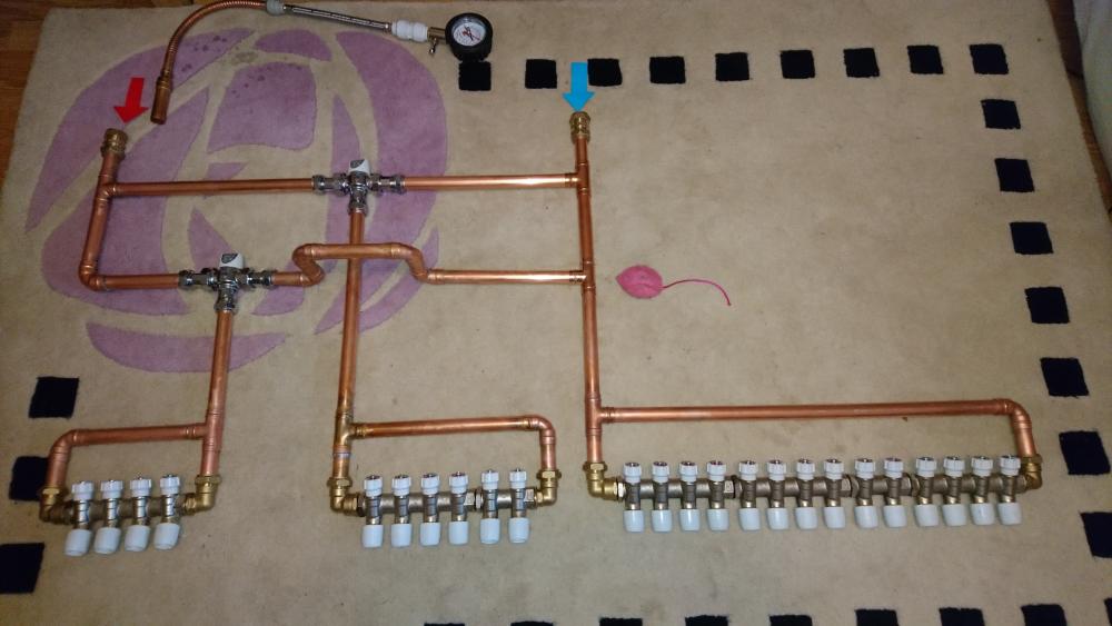

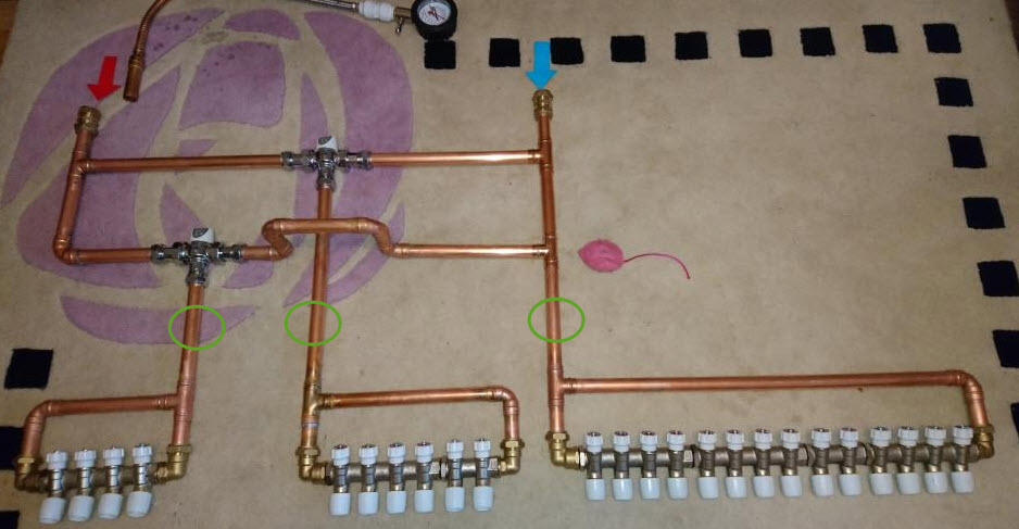

TerryE Posted February 21, 2017 Share Posted February 21, 2017 Jamie, for future reference you can get crossover fittings You also need to think about how you drain it down if you have to, so you might want to add some draincocks. IMO it's also nice to be able to isolate the entire hot or cold at the quarter turn of a valve and you can get decent full bore ballcock valve for this. But looking good Link to comment Share on other sites More sharing options...
Barney12 Posted February 21, 2017 Share Posted February 21, 2017 (edited) 17 minutes ago, TerryE said: Jamie, for future reference you can get crossover fittings You also need to think about how you drain it down if you have to, so you might want to add some draincocks. IMO it's also nice to be able to isolate the entire hot or cold at the quarter turn of a valve and you can get decent full bore ballcock valve for this. But looking good Would you add a drain cock for each manifold? I.e. P.S. This is a great thread. Keep it coming!! Edited February 21, 2017 by Barney12 Link to comment Share on other sites More sharing options...
jamiehamy Posted February 21, 2017 Author Share Posted February 21, 2017 45 minutes ago, TerryE said: Jamie, for future reference you can get crossover fittings Doh! Thanks - will do that - neater and probably better for the flow. 45 minutes ago, TerryE said: You also need to think about how you drain it down if you have to, so you might want to add some draincocks. IMO it's also nice to be able to isolate the entire hot or cold at the quarter turn of a valve and you can get decent full bore ballcock valve for this. But looking good I did wonder about drain cocks, but my thinking was that as the outlets are all pointing down, then I can simply open an outlet per manifold to get rid of any water? For the isolation, I'll put one on the main hot and cold feed - thank you. I still can't work out how the hot doesn't flow down the cold side tho @TerryE! I had a read at your blog and can't work it out! Link to comment Share on other sites More sharing options...

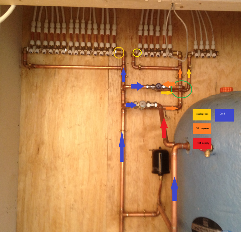

TerryE Posted February 21, 2017 Share Posted February 21, 2017 Better consult the Lord High Executioner. I used 22/15/22s instead of 22elbows on the manifold loops and put the draincocks there. This is also for the pragmatic point that I can use this 15mm spigot as a fill point for pressure testing before the whole caboodle is complete. 10 minutes ago, jamiehamy said: I still can't work out how the hot doesn't flow down the cold side tho @TerryE! I had a read at your blog and can't work it out! They can back siphon in pathological conditions, and you need to add some check valves on the branches to the DHW from the CW riser if you are concerned about this, but I would add that the DHW has to be potable in a modern pressurised system anyway, so there isn't any difference from the back flow risk from CW to CW tap.. Any taps or appliances where there is a risk of backflow should address this by design. Link to comment Share on other sites More sharing options...
Onoff Posted February 21, 2017 Share Posted February 21, 2017 Loving this thread. There'll be few copying it I'm sure. Ref the crossovers, if you're handy with a bender you can do your own: (I'm just tight! ) Link to comment Share on other sites More sharing options...
Nickfromwales Posted February 21, 2017 Share Posted February 21, 2017 ?. That looks awful familiar ?? Patent pending me thinks lol. Manifold plumbing has a good few advantages. One which I found most useful is to be able to purge and set to work each individual run without having to pressurise the whole installation at once, like you have to do with series ( regular ) plumbing. Very handy indeed for those who mostly work alone for the finer jobs, like myself. Keep at it! Looking good so far ?? 1 Link to comment Share on other sites More sharing options...
