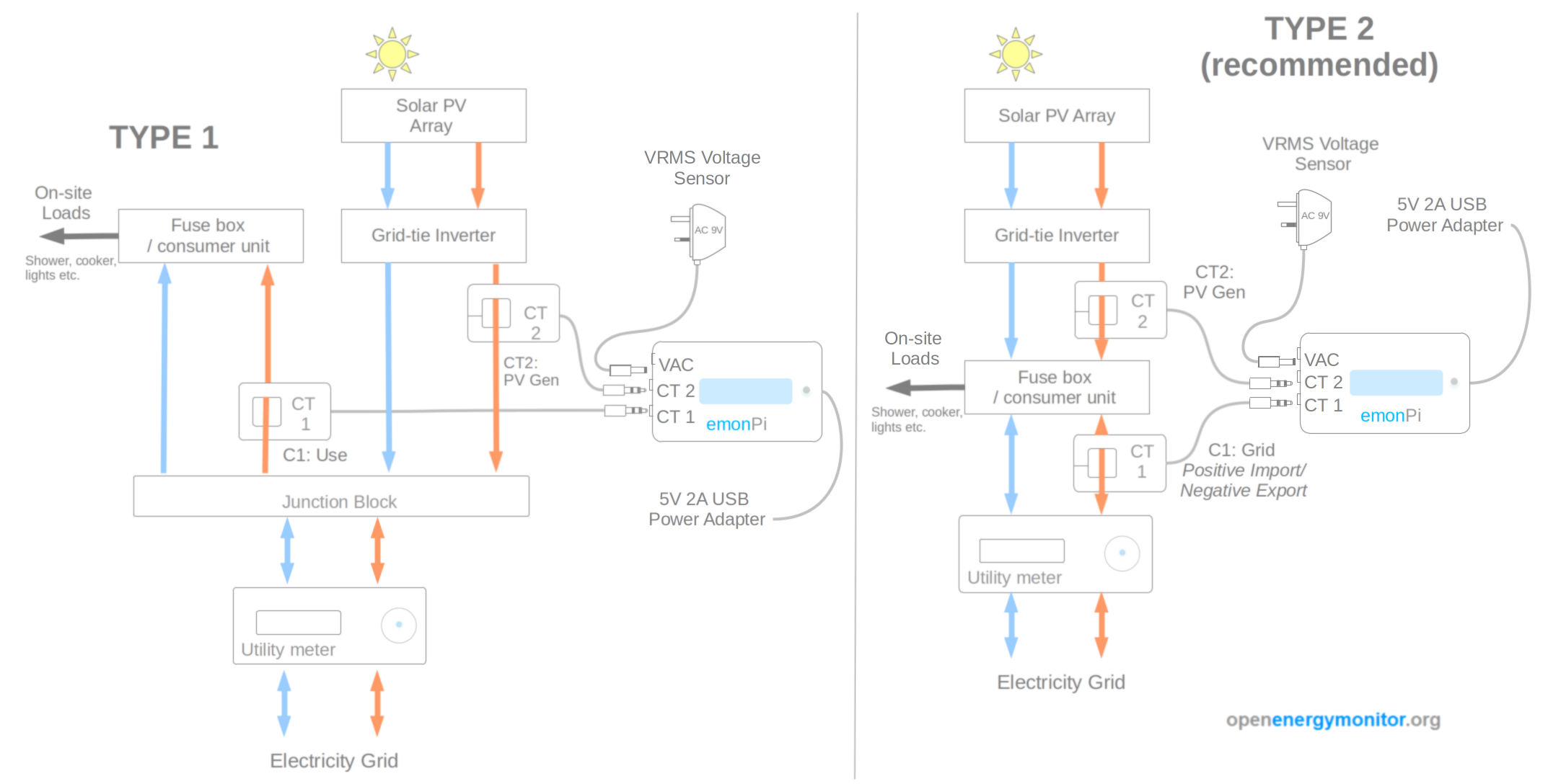

ToughButterCup Posted December 7, 2020 Posted December 7, 2020 (edited) The end in mind here is simple. I want to make sure that I consume as much of my 'own' solar PV production as I can. How can I do that when the meters fitted don't tell me? The context 3.86 kW peak fitted to a Solis inverter. No FIT. Solis ( Ginlong) supply an app which purports to describe your production. It does so, but in a way that a first year undergraduate coding student could do better. It is impossible to work out whether I am consuming the PV we produce. These two threads ( Smart Meters ) and ( Self consumption, Making sense of meter readings ) lay the framework for this one. @ProDave has sorted a similar problem out by fitting his own meter ( but he's an electrical genius) and @SteamyTea said that I'll have to get one of those power management sytems. He also hooked my interest by saying that it should be Possible to do the job with a little ingenuity: Quote I think a normal digital meter has the LED light up permanently if exporting. Link that in with the generation meter flashing, via a Raspberry Pi or two, job done. https://forum.buildhub.org.uk/topic/17923-smart-meters/ There is a wider context: the issue has been researched for a little while now, so for those who are interested, I attach a pdf - it's useful because it reviews the current (2015) situation in relation to this issue. Luthander et al (2015) Photovoltaic self-consumption in buildings: A review in Applied Energy 142 So @SteamyTea, hit me with a reading list, or better put, start me off on yet another steep learning curve, please! Thanks. 1-s2.0-S0306261914012859-main.pdf Edited December 7, 2020 by ToughButterCup

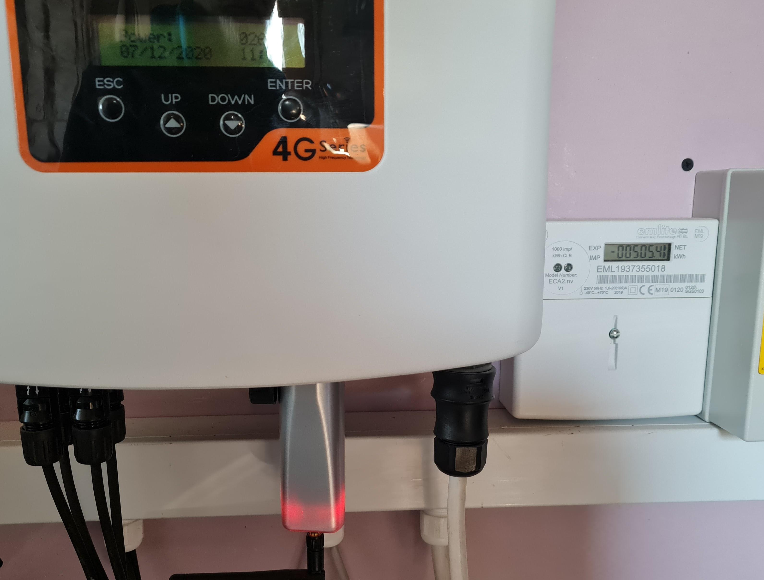

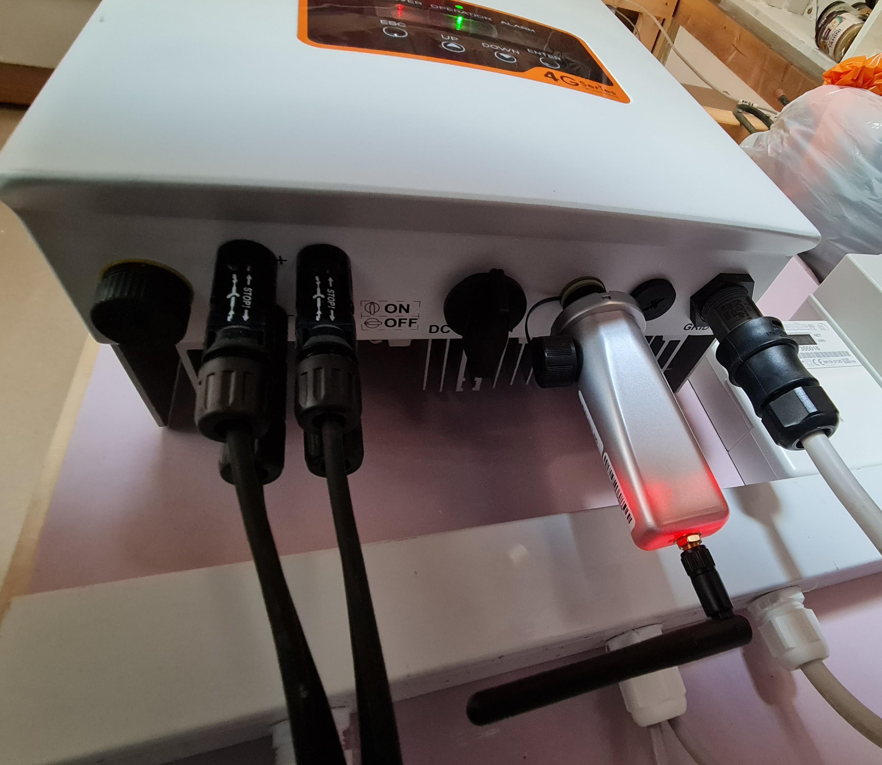

ToughButterCup Posted December 7, 2020 Author Posted December 7, 2020 (edited) The inverter is connected to the meter as shown here (apologies for the images - I can't undo the distortion) Edited December 7, 2020 by ToughButterCup

Bramco Posted December 7, 2020 Posted December 7, 2020 1 hour ago, ToughButterCup said: The end in mind here is simple. I want to make sure that I consume as much of my 'own' solar PV production as I can. How can I do that when the meters fitted don't tell me? You need to install a system that will tell you. Take a look at the open energy monitor site -> https://openenergymonitor.org/ They sell a simple system based on a Rasberry pi which will monitor your overall usage and your PV generation - there are tools included to allow you to create your own dashboard. There's also instructions on how to build a PV diverter to divert any excess into an immersion heater. These will only divert when there is excess PV over and above your consumption, so automatically will stop diverting if say you turn on the dishwasher and you aren't generating enough to run it (there are commercial units that do this as well). There are also some apps for android and apple so that you can see what's happening and on the community there's lots of additional info and ideas - for example with a fairly simple bit of code you could light an LED when you are generating enough to run a big appliance - of course you could just look out of the window ?. Also follow the advice about running big appliances round midday and only one at a time - you'll get the best self consumption that way. Simon

ToughButterCup Posted December 7, 2020 Author Posted December 7, 2020 (edited) 1 hour ago, ProDave said: I assume you have some form of solar PV diverter to automatically send surplus PV generation to your immersion heater? This will show what has been exported. ... If you want a similar export meter setup, just buy another generation meter, usually available cheap on ebay, and any competent electrician should be able to fit it. Probably worth labelling it as I have done to avoid any confusion. Assuming anything on our build is dangerous.... No, I think is the answer, but I will check with the electrician who fitted the system. I'll get my spark to price the export meter for me : a guess at the price Dave? Thank you @Bramco (Simon). Just what I was looking for - some quiet fireside reading ( Oh hold on, hmmmm, no fire anymore) PS, the sparky has just texted me to say that there isn't one fitted - yet. Edited December 7, 2020 by ToughButterCup

ProDave Posted December 7, 2020 Posted December 7, 2020 7 minutes ago, ToughButterCup said: Thank you @Bramco (Simon). Just what I was looking for - some quiet fireside reading ( Oh hold on, hmmmm, no fire anymore) PS, the sparky has just texted me to say that there isn't one fitted - yet. Cheapest I can see on ebay at the moment is £20 https://www.ebay.co.uk/itm/Brand-New-Approved-230V-Single-Phase-Electric-Solar-PV-Generation-Meter-100A/324383422000?hash=item4b86c23630:g:J6QAAOSwFn1fuQjX 1

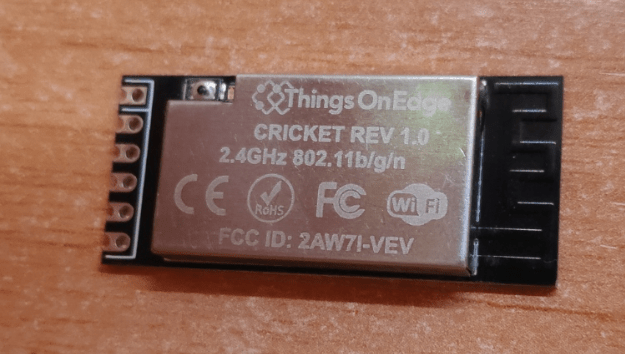

Bramco Posted December 8, 2020 Posted December 8, 2020 1 hour ago, SteamyTea said: An ESP has a built in power saving function i believe. They do and I think the IOTCricket is based on either the original or the ESP32. But of course you need the software to handle the sleep, awaken and manage the wifi to send the data. The IOTCricket seems to have solved this, although it's worth reading Pete Scargill's blog. For us the ESPs were in a place where power wasn't an issue, so they ran continuously without using the sleep functionality - it's a lot easier if you can do this. 1 hour ago, SteamyTea said: They have been gathering dust for 2 years Tsk tsk - and you've had many months of Covid idling when you could have ....... ? Simon
