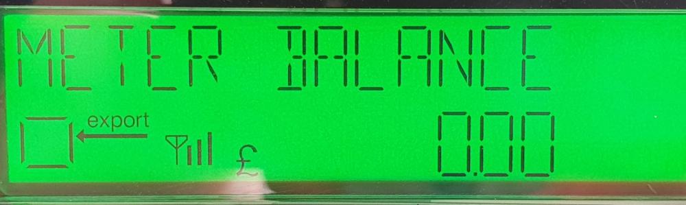

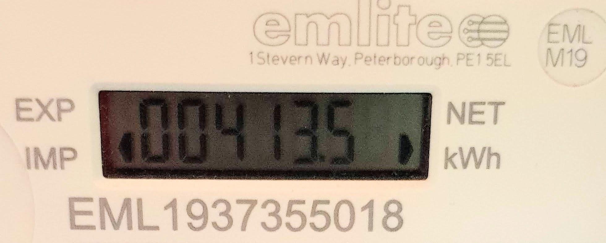

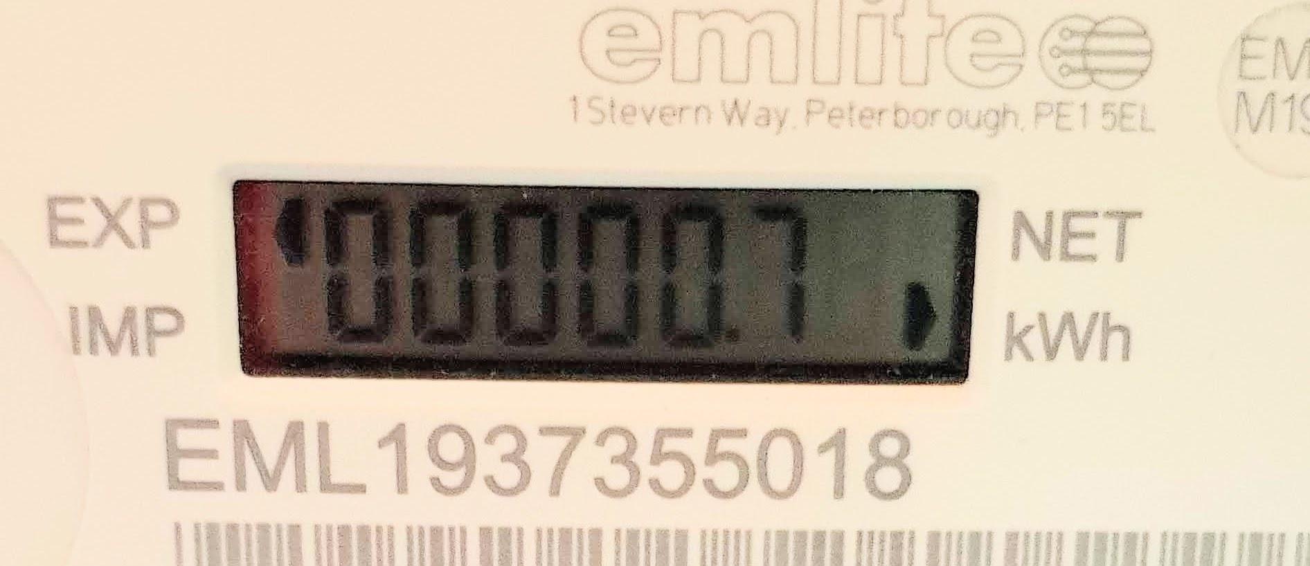

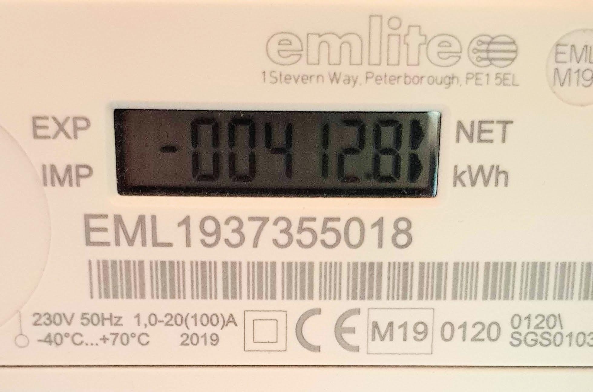

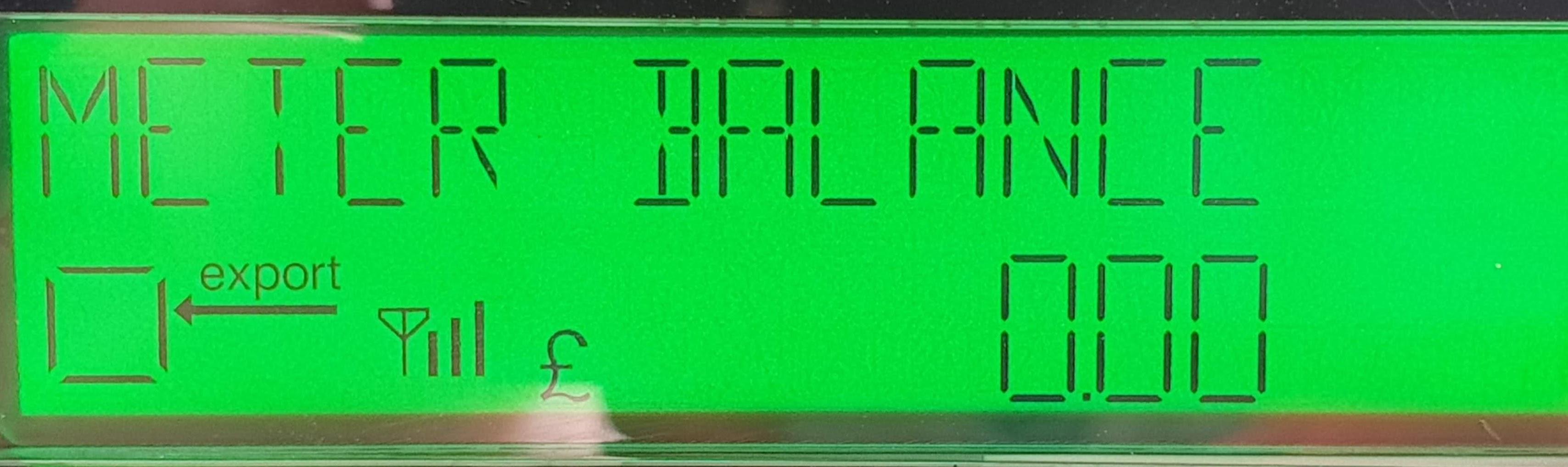

ToughButterCup Posted October 21, 2020 Share Posted October 21, 2020 I have a SOLIS (Ginlong) inverter with its associated meter. I am trying to find out how much of our self generated power we consume. In trying to answer the question for myself, I have tried to make sense of the SOLIS app. Frankly it's an insult to customers. Looks to me like it was designed by a first year undergrad: mostly it doesn't work. When it does, it provides a meaningless graph. There's no way of downloading and analysing the data. So I'm going back to the raw data. Here are three images from the meter next to the inverter. ( I have uploaded images because I don't understand them - yet) The amount of electricity imported since installed(?) .... amount exported (?) To whom? ... 412.8 ( below) is 413.5 less 0.7, I can see that - does that mean I have consumed 0.7 of a kWh of self-generated electricity? Or does it mean I have made a present of 0.7kWh to the National Grid Can anyone point me to an online resource which will help me sort this out for myself. Thanks for your help..... Link to comment Share on other sites More sharing options...
ProDave Posted October 21, 2020 Share Posted October 21, 2020 First image is "imported power" Second image is "exported power" Third image is net power, Imported - exported To understand what "imported" and "exported" means, I need to know what this meter is doing? Is it your main electricity meter? I think not, that's in the piggery isn't it? So is this your "generation meter"? dedicated to the inverter? If so then "export" in this case is how much your inverter has produced, and "import" is the tiny amount it consumes over night in standby when the panels are not producing anything. So NET will be how much you have generated. That's all very interesting, but it won't tell you how much you have self consumed, for that you need to look at your supply meter. Do you have a smart meter? If so that should be able to show you your export figure. That export figure will be what has "escaped" to the grid without you using it. If you don't have a smart meter, you will probably have to fit your own export meter like I have done, I can take a picture and post it later. 1 Link to comment Share on other sites More sharing options...

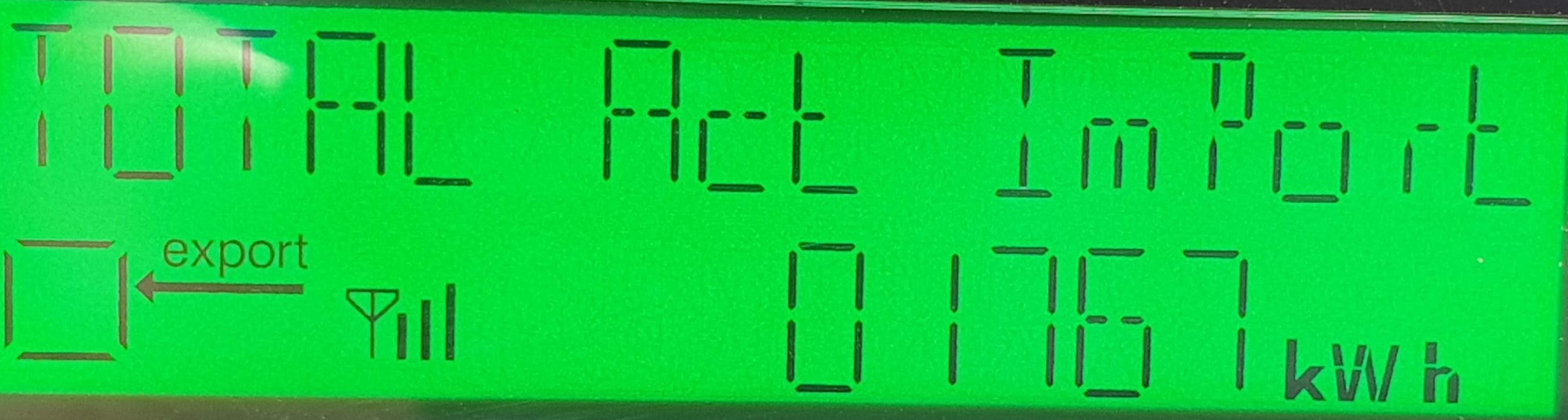

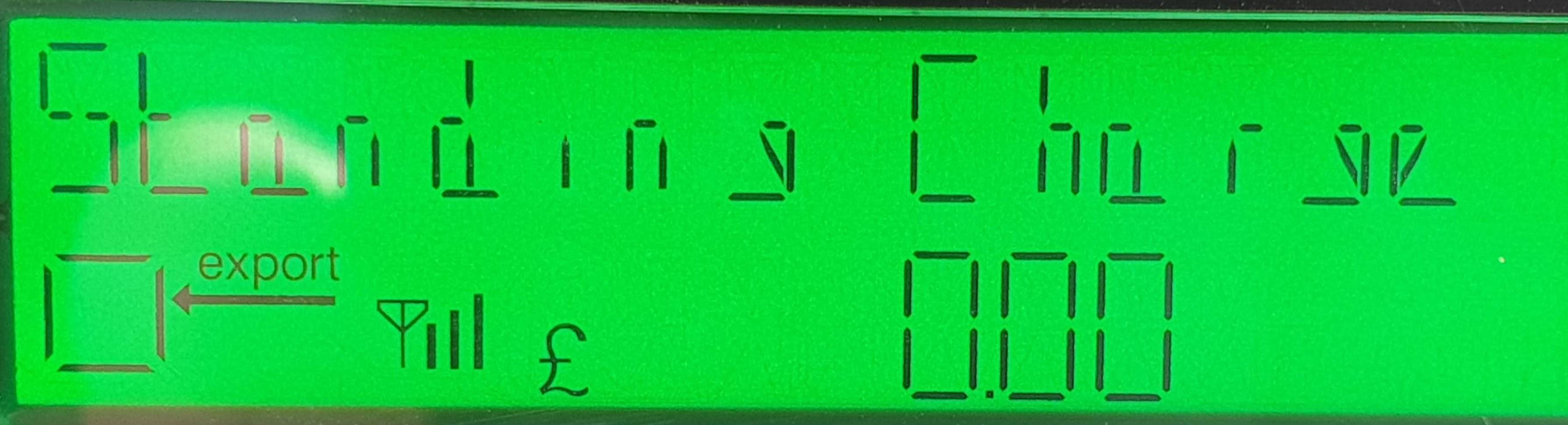

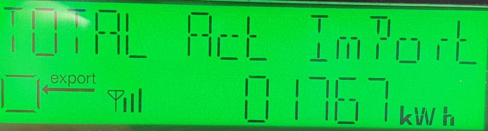

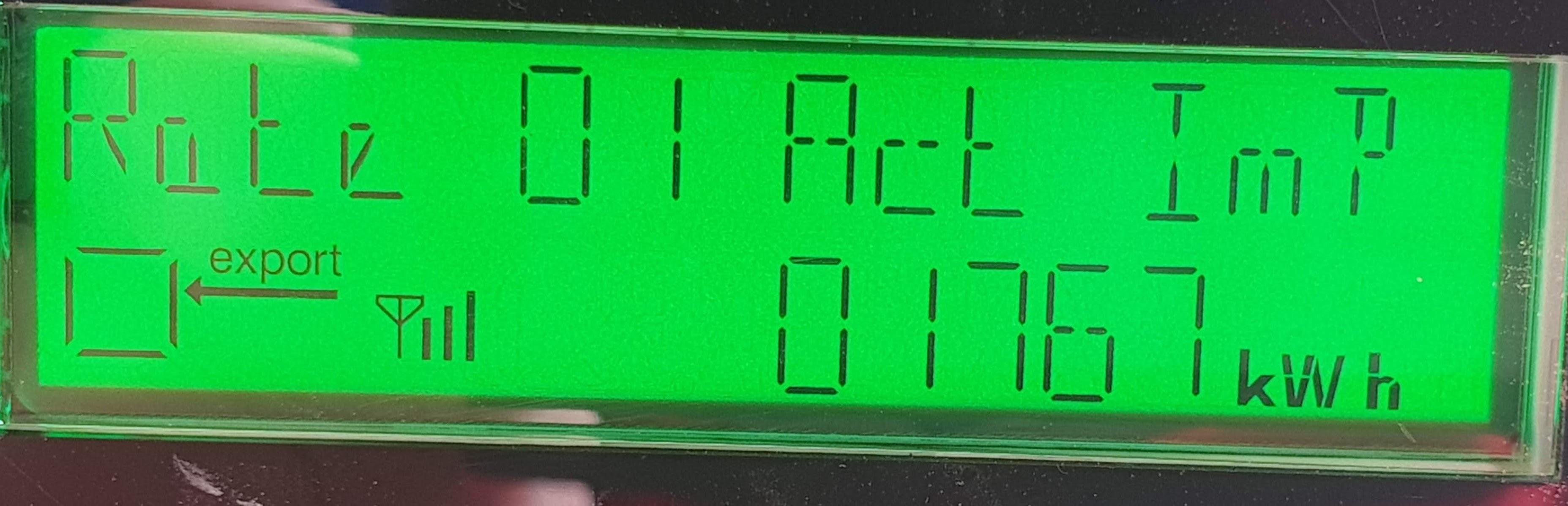

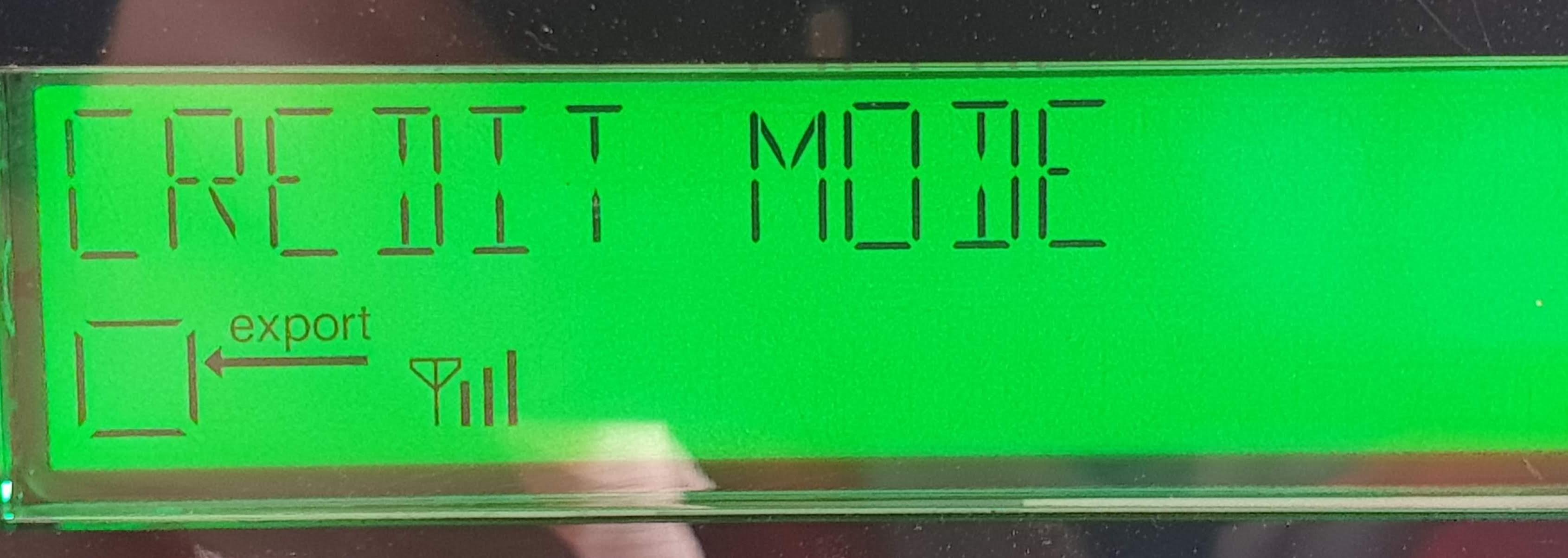

ToughButterCup Posted October 21, 2020 Author Share Posted October 21, 2020 40 minutes ago, ProDave said: ... So is this your "generation meter"? dedicated to the inverter? ... Yes. 40 minutes ago, ProDave said: ... Do you have a smart meter? If so that should be able to show you your export figure. That export figure will be what has "escaped" to the grid without you using it. ... Yes. Here's what I think is the relevant photograph of the screen It's a bit counterintuitive -not to say confusing - to see both Export and Import on the same screen With typical care and attention to detail you say 40 minutes ago, ProDave said: .... Do you have a smart meter? If so that should be able to show you your export figure. That export figure will be what has "escaped" to the grid without you using it. ... Yes, I do. But I suspect smart meters are not all created equal are they? I doubt whether that figure (1767) is the one to which you refer (export figure) because its labelled Actual Import. But the screen also shows an Export indicator. There's a button on the side of the meter which makes the LCD display illuminate, and allows you to scroll through a series of (I think irrelevant) screens ( date, time, credit mode, meter balance, standing charge) They don't make it easy do they? Link to comment Share on other sites More sharing options...

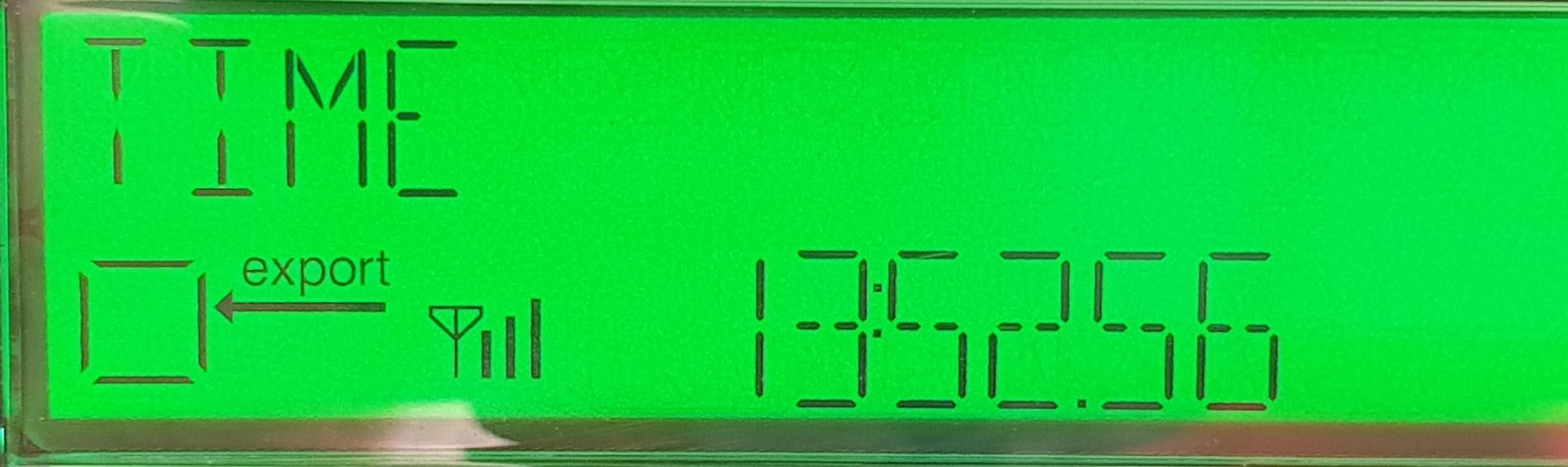

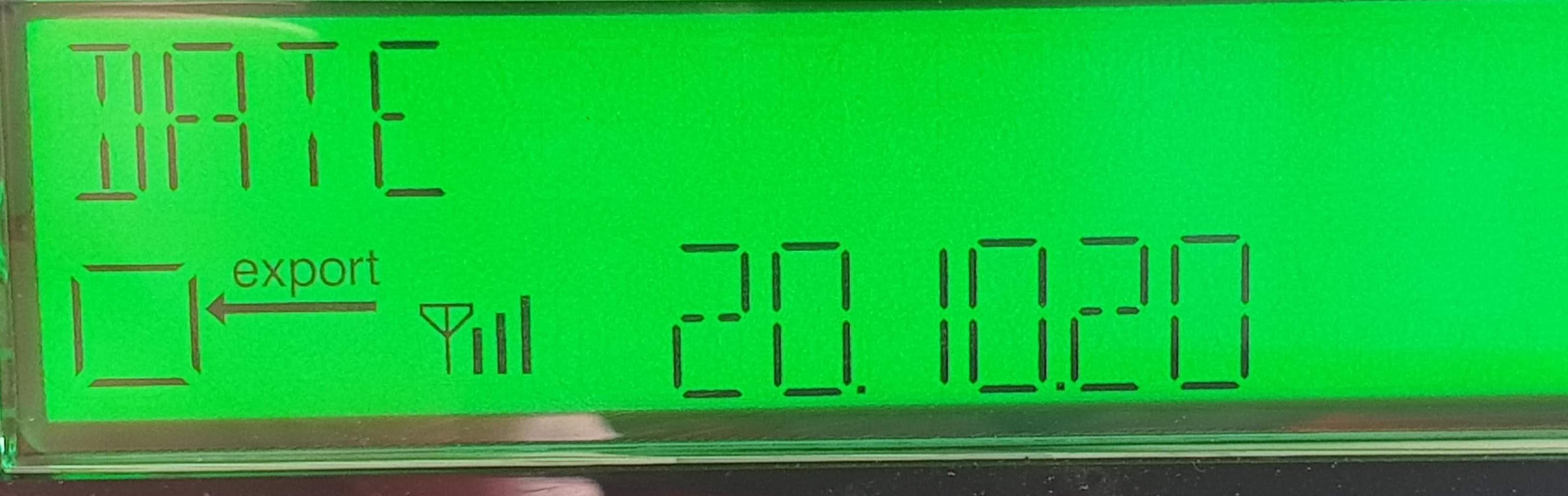

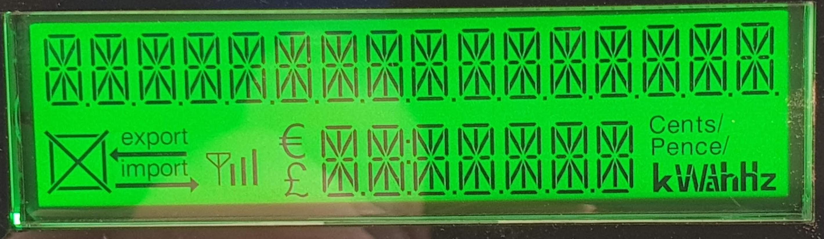

ProDave Posted October 21, 2020 Share Posted October 21, 2020 No, smart meters don't seem very intuitive at all. Tedious I know but can you scroll through all the different display modes on your smart meter and photograph each one? Link to comment Share on other sites More sharing options...
ToughButterCup Posted October 21, 2020 Author Share Posted October 21, 2020 Already done that Dave... Link to comment Share on other sites More sharing options...
ProDave Posted October 21, 2020 Share Posted October 21, 2020 That's not very helpful. It's not goinf to show your export. I think that arrow pointing to export might be saying, that at the instant you took the picture you were exporting power, but it does not seem to want to show you how much you have exported. Link to comment Share on other sites More sharing options...
ToughButterCup Posted October 21, 2020 Author Share Posted October 21, 2020 Right. Wot's next then? Noo smart meter? Link to comment Share on other sites More sharing options...
ProDave Posted October 21, 2020 Share Posted October 21, 2020 Here is what I did. I don't have and don't want a smart meter. I just have the standard dumb single rate meter. I then added my own export meter. It is the same meter sold as a generation meter for solar PV. But notice the mains from the suppliers meter goes to the "output" terminals of this meter, and the "input" terminals connect through the meter box No 2 and my distribution to the house and other places. So this meter records what is exported back to the grid and does not register what is imported. I read all my meters once a week and log energy usage. 1 Link to comment Share on other sites More sharing options...
