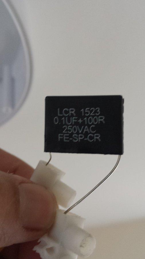

Onoff Posted December 6, 2020 Posted December 6, 2020 Are these particular spots switched / wired otherwise any differently? Is that particular grid switch's wiring in closer proximity to the live feed(s) to the grid bank than the other light switches? In close proximity to any other non lighting circuit wiring? It used to be that these new fangled CFLs could flicker even with the light switch off. Talk abounded of stray capacitance along the 3-core and earth wiring used for two way switching and induced voltage. Swapping the common / strappers around was a trick to try and/or along with fitting a "snubber" from Maplin usually. Actually an RC contact suppressor. (Not Radio Control ?). RG22Y was the product code: What about trying a Danlers CAPLOAD?
