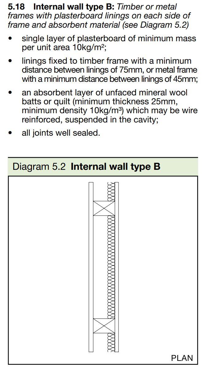

Ian Posted December 2, 2020 Posted December 2, 2020 (edited) 18 minutes ago, Russell griffiths said: Morning can anybody point me at building regs for sound insulation between rooms in timber stud walls. If a wall is built using 88mm cls timber then I’m going to struggle to get 100mm in, so is 75mm sound slab enough walls will have 11mm osb both sides and then plasterboard, happy to upgrade plasterboard if it’s needed. Regs extract below is for England from Approved Doc E, page 65 https://assets.publishing.service.gov.uk/government/uploads/system/uploads/attachment_data/file/468870/ADE_LOCKED.pdf Edited December 2, 2020 by Ian 1

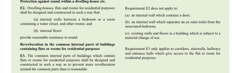

Russell griffiths Posted December 2, 2020 Author Posted December 2, 2020 @PeterW so are you basically saying if I have a wall with a door in it that has a 10mm gap underneath for the mvhr to work better the wall insulation becomes a waste of time, as sound transfer will be through the door itself as well as the gap under the door.
PeterW Posted December 2, 2020 Posted December 2, 2020 5 minutes ago, Russell griffiths said: @PeterW so are you basically saying if I have a wall with a door in it that has a 10mm gap underneath for the mvhr to work better the wall insulation becomes a waste of time, as sound transfer will be through the door itself as well as the gap under the door. E2 limitation A) applies from the below (extract from regs)
nod Posted December 2, 2020 Posted December 2, 2020 1 hour ago, Russell griffiths said: Morning can anybody point me at building regs for sound insulation between rooms in timber stud walls. If a wall is built using 88mm cls timber then I’m going to struggle to get 100mm in, so is 75mm sound slab enough walls will have 11mm osb both sides and then plasterboard, happy to upgrade plasterboard if it’s needed. What are the regs on ceilings between rooms I have 225mm deep joists so far more room in there. Bathroom to bedroom Toilet to living space The rest is choice 1
Oz07 Posted December 2, 2020 Posted December 2, 2020 @Russell griffiths its previously been discussed on here and you're better with 50mm acoustic slabs with 88mm cls. Filling the stud results in worse performance. I could hear the missus on her phone last night when I went to bed. Shut the bedroom door and it near enough completley blocked it out. I only mention because i have a gap at bottom of door for air flow but it was still effective 1
nod Posted December 2, 2020 Posted December 2, 2020 1 hour ago, Oz07 said: @Russell griffiths its previously been discussed on here and you're better with 50mm acoustic slabs with 88mm cls. Filling the stud results in worse performance. I could hear the missus on her phone last night when I went to bed. Shut the bedroom door and it near enough completley blocked it out. I only mention because i have a gap at bottom of door for air flow but it was still effective Exactly We partition hundreds of student pods of six and only use 25 mil acoustic roll Packing them full of insulation achieves the opposite 50 mil slabs are good but should ideally not touch either side of the PB (Air Gap)
