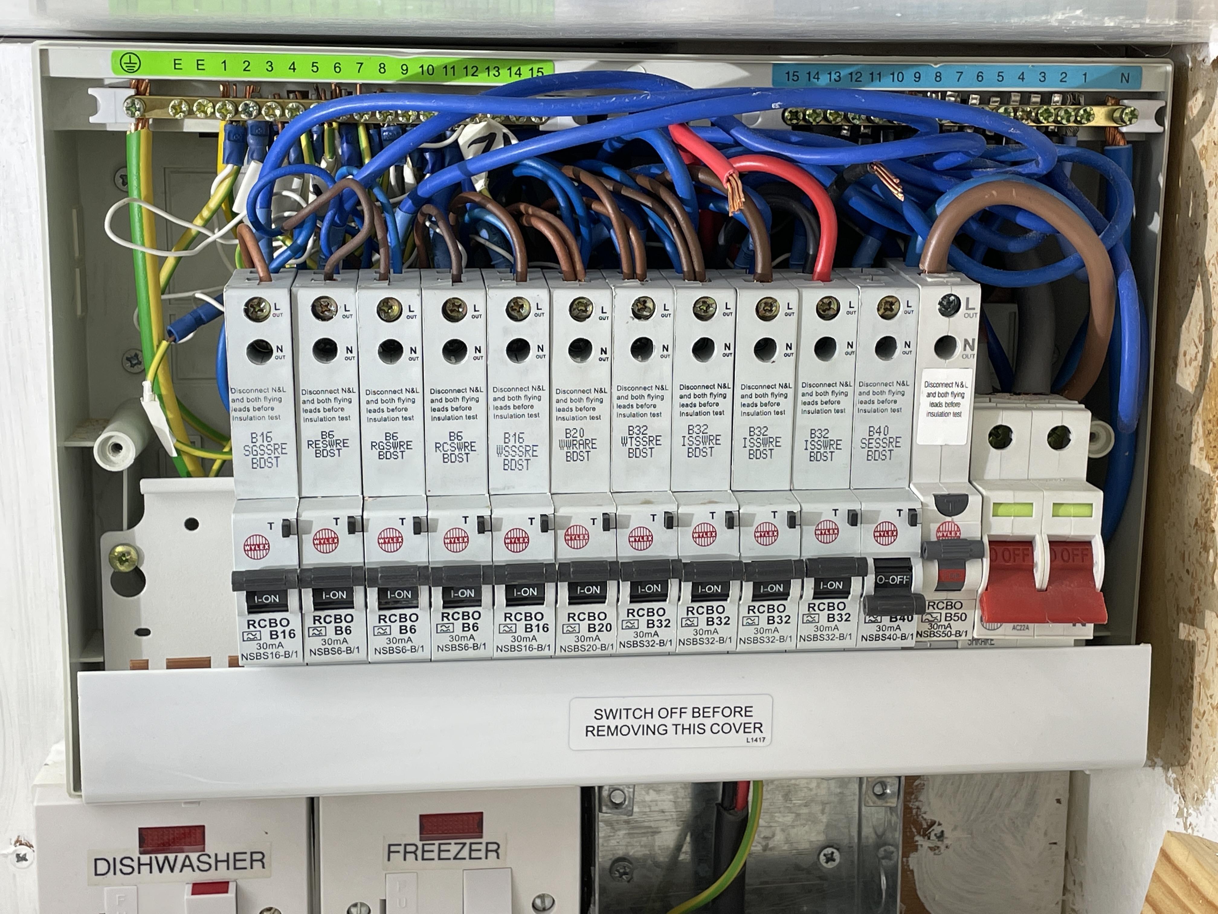

Thorfun Posted December 1, 2020 Posted December 1, 2020 Hi all. I’m in the middle of removing an external run from our existing house RCD. I’ve removed the live and neutral but I’m not sure if I have to remove the blue wire which looks like it’s the shared neutral. any electricians on here able to help please? The power is currently off so could do with finding out soon! here’s a photo

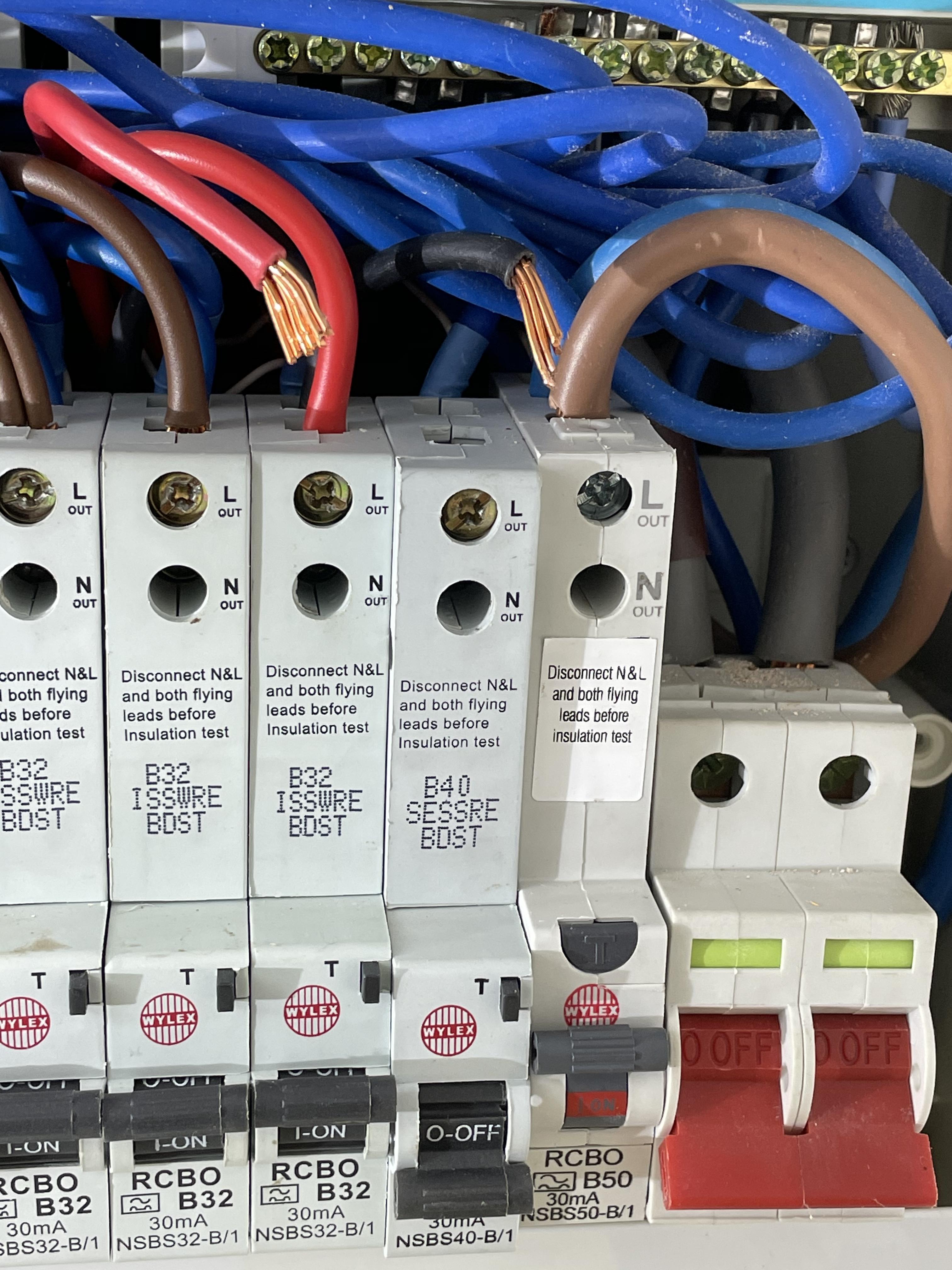

Onoff Posted December 1, 2020 Posted December 1, 2020 That's an RCBO so it has a flying blue neutral? Is that what you're on about?
Onoff Posted December 1, 2020 Posted December 1, 2020 If so then I'd just disconnect and make safe (at least tape those ends or remove completely), the incoming cable to your circuit. There'll be an earth wire too. Leave the RCBO in and it's blue & white wires connected. You might want to use it for something else later on.
Thorfun Posted December 1, 2020 Author Posted December 1, 2020 16 minutes ago, Onoff said: That's an RCBO so it has a flying blue neutral? Is that what you're on about? Exactly what I’m talking about 13 minutes ago, Onoff said: If so then I'd just disconnect and make safe (at least tape those ends or remove completely), the incoming cable to your circuit. There'll be an earth wire too. Leave the RCBO in and it's blue & white wires connected. You might want to use it for something else later on. im going to pull out the live and neutral and earth and leave the blue cable in the RCBO. thanks @Onoff

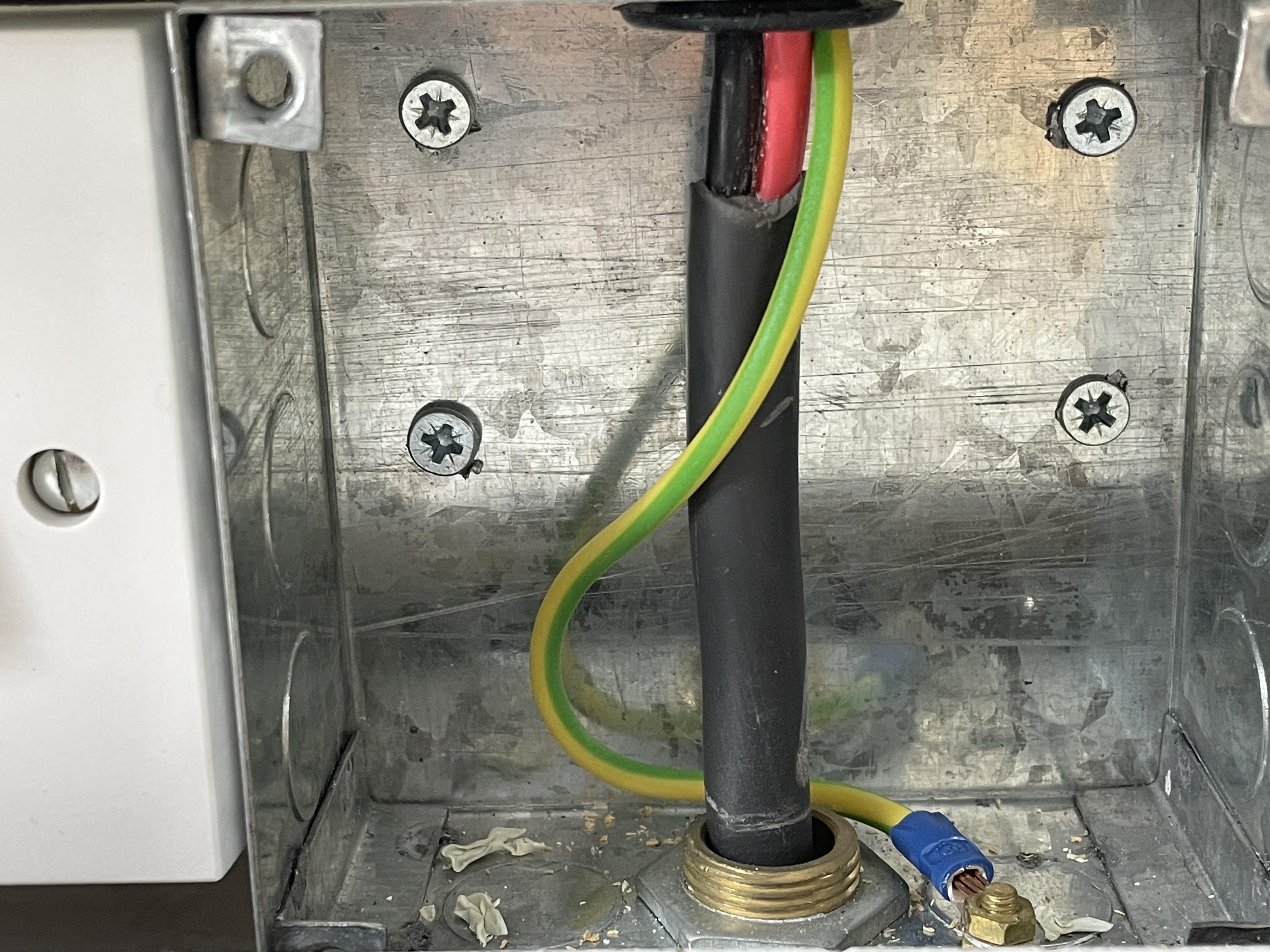

Thorfun Posted December 1, 2020 Author Posted December 1, 2020 @Onoff tracing the eart cable is proving tricky! Any secret ways of doing so or is it just trace one at a time until you find the right one. this is a photo of the cable I want to remove in its housing. The earth is separate from the live and neutral and this is the whole fuse box. You can see the cable to remove below it
Thorfun Posted December 1, 2020 Author Posted December 1, 2020 Hmmm....and I can’t seem to pull out the red and black cables. I think I’ll just tape them off. That cable runs outside to another fuse box for the pool house which is coming down to make way for our new house. So I might eventually reuse that for a supply for the builders so I can possibly reconnect it at a later date. do I need to remove the earth cable as well? Or can that stay connected? so simply tape up the removed red and black and then put the cover back on?
Onoff Posted December 1, 2020 Posted December 1, 2020 7 minutes ago, Thorfun said: @Onoff tracing the eart cable is proving tricky! Any secret ways of doing so or is it just trace one at a time until you find the right one. this is a photo of the cable I want to remove in its housing. The earth is separate from the live and neutral and this is the whole fuse box. You can see the cable to remove below it OK that's 2-core steel wire armoured. The earth path goes from the earth bar in the CU via the bit of earth wire to that galvanised adaptable box. The earth path will likely continue via the stranded armoured around the cable. Those strands will be connected to the brass gland. Tug / push up that earth wire in the galv box and you might see it move on the earth bar in the CU. No prob leaving that earth wire in situ to the galv box. Are you removing the swa cable completely? 1
Thorfun Posted December 1, 2020 Author Posted December 1, 2020 2 minutes ago, Onoff said: Are you removing the swa cable completely? Yes, eventually when this house is demolished after we’ve built the new one. I was just thinking about reusing it for a site electricity supply if I can dig it up and attach the pool house RCD to a housing outside. Would save running cables through windows for builders and would also allow us to isolate from inside the house when no one is using it. so if I just leave the earth connected and tape up the live and neutral all is good?

TonyT Posted December 1, 2020 Posted December 1, 2020 The swa has been glanced in a metal box and the live and neutrals are passing through the box to prevent a joint. The earth cable at the bottom of the box is supplying a flying lead to an earth somewhere else? Without seeing the whole installation at least that looks well done
TonyT Posted December 1, 2020 Posted December 1, 2020 Just leave the blue and white wires connected they aren’t doing any harm just remove the load cable the red and black into the metal box, put some connector block on them and put the lid back

Nickfromwales Posted December 1, 2020 Posted December 1, 2020 4 minutes ago, TonyT said: The swa has been glanced in a metal box and the live and neutrals are passing through the box to prevent a joint. The earth cable at the bottom of the box is supplying a flying lead to an earth somewhere else? Without seeing the whole installation at least that looks well done The metal box has been utilised as a transition so the SWA can be made off to a bonded metal structure. A bit OTT but hey-ho. The earth lead does not service something else, it’s the critical earth bond strapper that bonds the SWA sheath and is functional.
TonyT Posted December 1, 2020 Posted December 1, 2020 Maybe the consumer unit is plastic, so makes sense and if I was in that situation would probably do the same Nice to see brass nuts and bolts used instead of roofing bolts!
Thorfun Posted December 1, 2020 Author Posted December 1, 2020 thanks all. it is removed, taped up and secured and the power is back on with no ill effects that I can see yet! now I can crack on with removing the RCD in the pool house.
