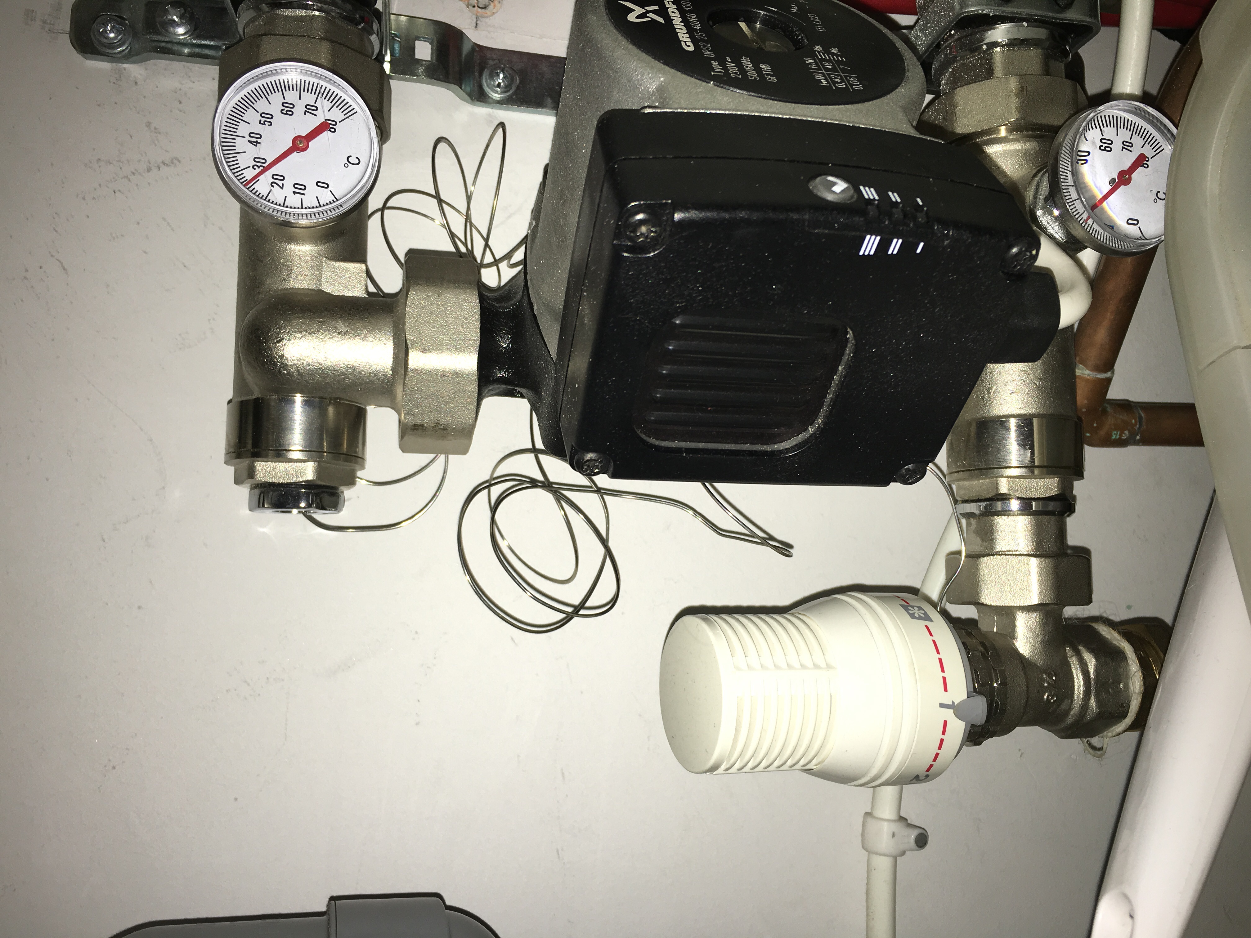

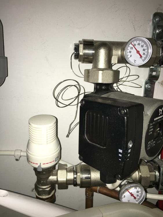

Calvinmiddle Posted March 16, 2017 Share Posted March 16, 2017 What's a blending valve? if it's the White thing in my photo then Wunda are talking nonsense as that is from them and I can get it to blend down to 25c with no problem Link to comment Share on other sites More sharing options...
PeterW Posted March 17, 2017 Share Posted March 17, 2017 30 minutes ago, Calvinmiddle said: What's a blending valve? if it's the White thing in my photo then Wunda are talking nonsense as that is from them and I can get it to blend down to 25c with no problem You've got one of the old ones - the new ones are by ESBE for up to 5 ports and don't go lower than 35c Chat with their tech department was interesting as his view was just run at 35c and it will just reach temperature quicker - didn't seem to grasp the concept of not going full chat and over heating.... The whole low energy house thing seemed not to be of interest. Link to comment Share on other sites More sharing options...
TerryE Posted March 17, 2017 Author Share Posted March 17, 2017 1 hour ago, PeterW said: Chat with their tech department was interesting as his view was just run at 35c and it will just reach temperature quicker - didn't seem to grasp the concept of not going full chat and over heating.... The whole low energy house thing seemed not to be of interest. Peter if this is your problem go back up to my post on @dogman's thread about limiting energy vs. limiting power. I am replacing the analogue thermometers by DS18B20s. You could consider doing the same and integrate the ΔT (e.g. by sampling every minute and summing). This will tell you how much heat you've pumped into the slab on this on period. You can use this to set your mark-space ratio that is heat on to pump recirc ratio where each on period dumps a fixed ΔQ into the slab. Or you can just replace the TMV and use Jeremy's approach. Link to comment Share on other sites More sharing options...
Jeremy Harris Posted March 17, 2017 Share Posted March 17, 2017 (edited) 8 hours ago, Calvinmiddle said: What's a blending valve? if it's the White thing in my photo then Wunda are talking nonsense as that is from them and I can get it to blend down to 25c with no problem That's the same valve and manifold as ours, and it does hold down to 25 deg C OK I've found. It seems significantly better than an ordinary thermostatic mixer valve in this application, because it remotely senses the internal temperature of the supply manifold, with the capillary probe. The only downside I've found is that when little power is being drawn from the UFH, that valve shuts right down and presents a fairly high flow resistance to the ASHP, which would cause an over-pressure trip on ours, until I fitted a bypass valve. Works very well now, though. Edited March 17, 2017 by JSHarris Link to comment Share on other sites More sharing options...
