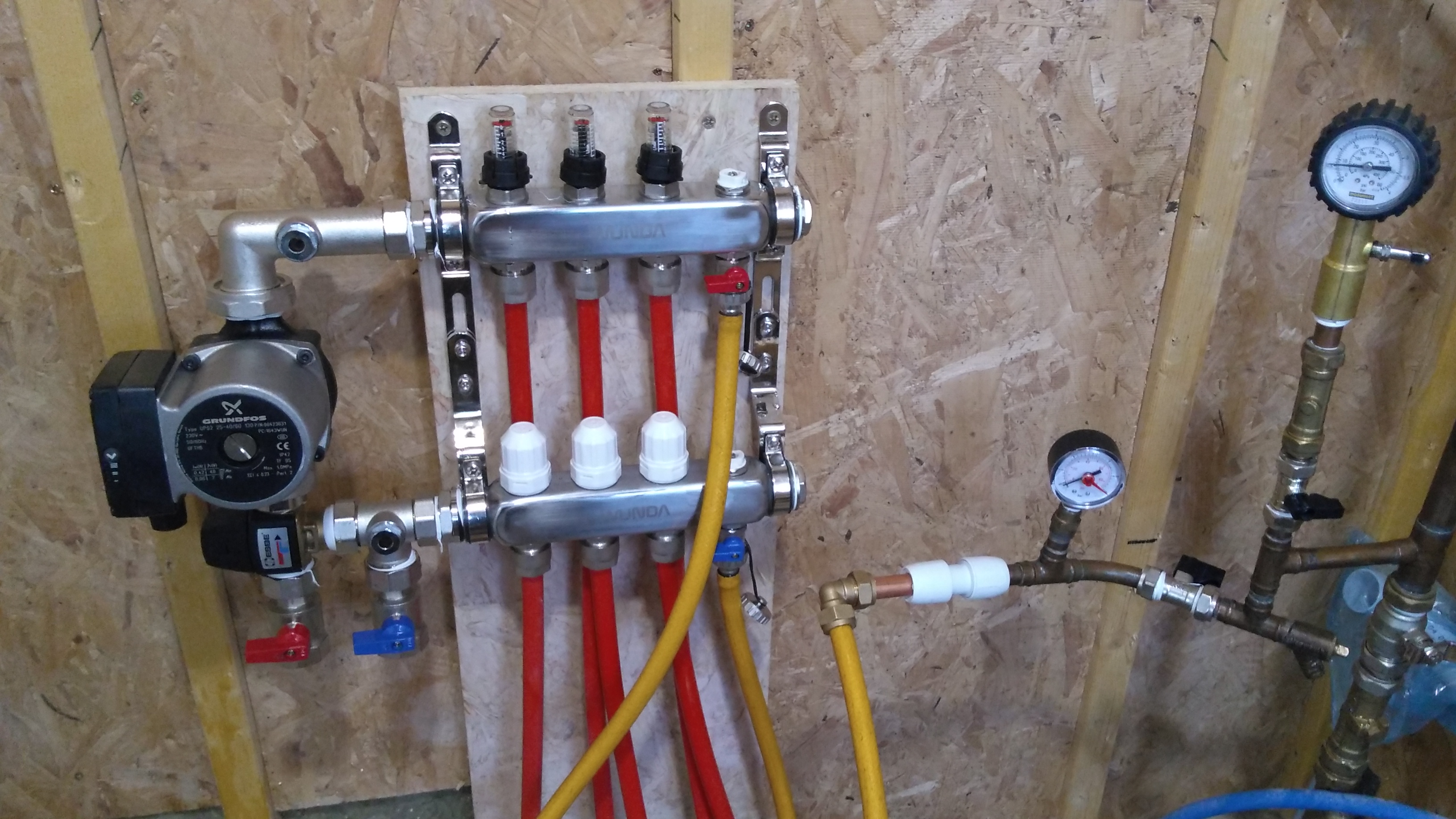

TerryE Posted February 24, 2017 Author Share Posted February 24, 2017 The UFH manifolds in and pressure tested. It's coming along. Next step to plumb in my Willis heater. @jamiehamy Is this one next? 1 Link to comment Share on other sites More sharing options...
Nickfromwales Posted February 25, 2017 Share Posted February 25, 2017 Only advice to add to this phase is to add one or two automatic air vents ( bottle vents ) instead of the manual ones. Will make commissioning a much easier job . These will screw straight into the empty holes ? 2 Link to comment Share on other sites More sharing options...
Barney12 Posted February 25, 2017 Share Posted February 25, 2017 13 hours ago, TerryE said: The UFH manifolds in and pressure tested. It's coming along. Next step to plumb in my Willis heater. @jamiehamy Is this one next? Newbie to UFH question time ...... I assume the yellow pipes and rig to the right are your temporary filling loop? Are the hot and cold valves your currently connected to for filling and the ones to the left (under the pump) for your eventual heating connection? Link to comment Share on other sites More sharing options...
TerryE Posted February 25, 2017 Author Share Posted February 25, 2017 @Barney12, yes on both accounts. Have a look at the Wunda videos on YouTube. The only difference is that I didn't buy the Wunda pressure test kit, because I already had my home brew one. 1 Link to comment Share on other sites More sharing options...
Barney12 Posted February 25, 2017 Share Posted February 25, 2017 50 minutes ago, TerryE said: @Barney12, yes on both accounts. Have a look at the Wunda videos on YouTube. The only difference is that I didn't buy the Wunda pressure test kit, because I already had my home brew one. Ta. Just watched them. Very informative. Link to comment Share on other sites More sharing options...
TerryE Posted February 25, 2017 Author Share Posted February 25, 2017 One thing that did surprise me was that I did a flow test (after I had purged the circuits individually) by opening all three circuits and letting the mains 3 bar run from the filler though the loops in parallel and out into a bucket. It was quite slow. I think that this is time for a properly measured flow and some Boffin's Corner flow calcs And thanks for the hint about the air exhaust vent, Nick Link to comment Share on other sites More sharing options...
TerryE Posted February 25, 2017 Author Share Posted February 25, 2017 Also note my mounting the manifold on a mounting board. I did this partly because there's only OSB behind this, but if also proved very useful for another reason. MBC use PexAlPex UFH pipe which is a lot more rigid then the stuff Wunda supply and the tails only came up 60cm or so our of the floor. It would have been really fiddly trying to manoeuvring them into position with the manifold fixer, so I put the board in place, measured and marked the correct tail lengths, then took the board away again. I then cuts the tails to length, chamfered and fitted the insert fittings, before lowering the board into place and over the tails. I then screwed up the tails, and finally screwed the board back to the partition wall. This worked well and was painless. 1 Link to comment Share on other sites More sharing options...

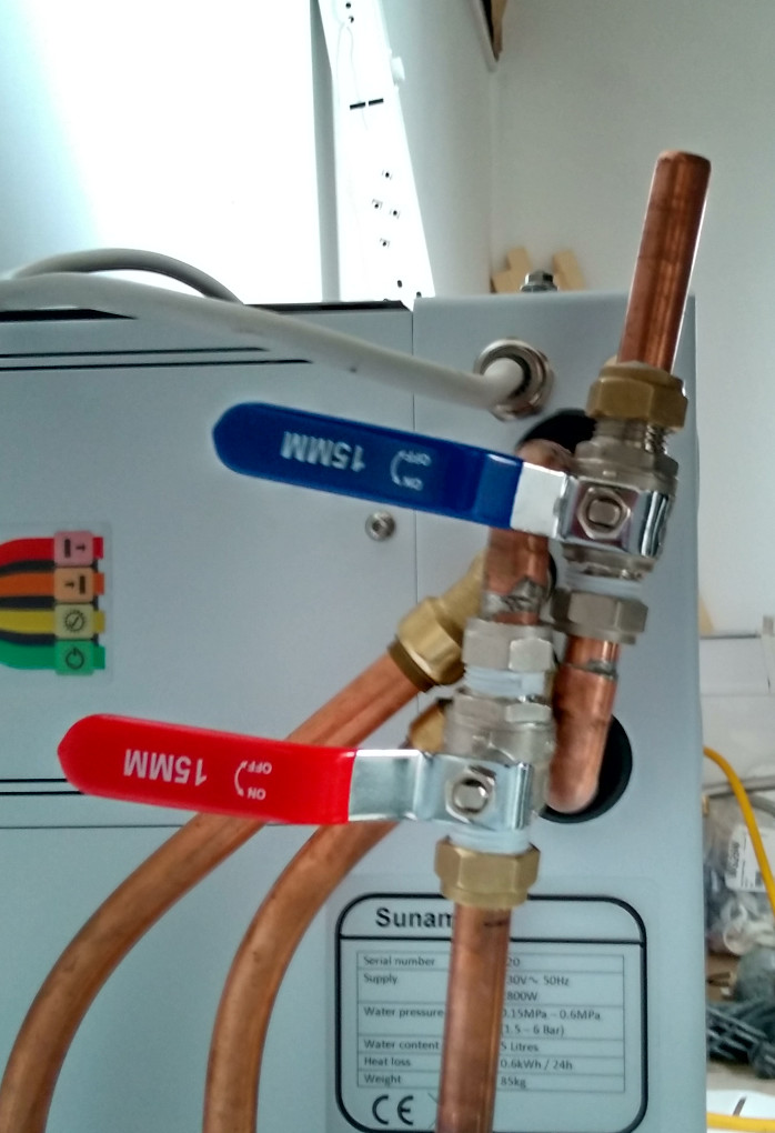

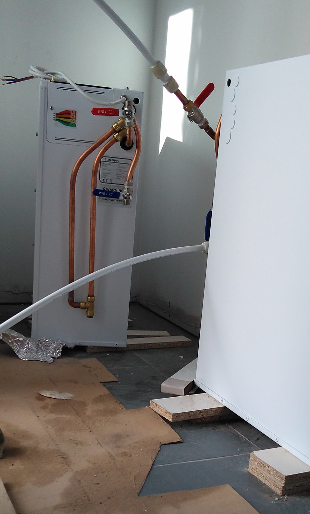

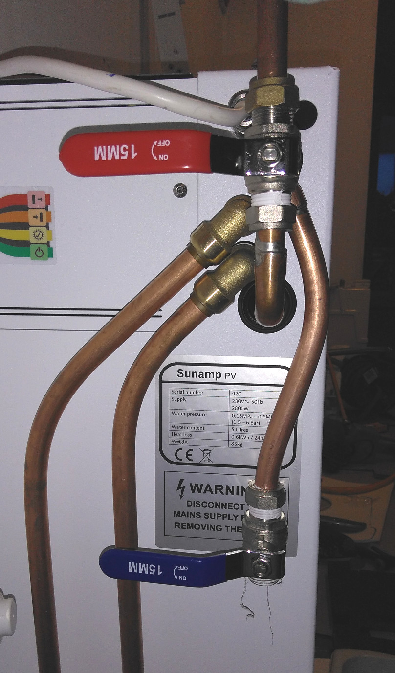

TerryE Posted March 3, 2017 Author Share Posted March 3, 2017 (edited) My latest whoops is on the SunAmps. See photo below. (The two tails on valves are for pressure testing. and the red/blue handles are on the wrong valves.) I had carefully made up rigid tails to allow me to mount the two SunAmps side-by-side. There are four pipe connections all arranged vertically on the back: the cold in, the hot out and two overflows for the PRelV and the cells. So I laid it all out: cold from the bottom, hot out of the top, the two overflows off to the side and down to a tundiish. Great. Except that when I came to connect them, I realised that the cold was on the top and the hot on the bottom -- and of course they are vertically aligned. Given that the cold normally rises and the hot often goes up to a manifold, then they could have at least swapped them or even offset the access holes. But neatness trumps functionality. Thank-you SunAmp. Now I've got to remake all of the bloody tails so they can neatly cross over. Shit, shit, shit. Before and after and pressure test I know the levers are upside down, but if I turn the valves around so that they are the other way up, then they'll jam against the back wall. Oh, yes and a codicil to the leaded vs lead-free solder debate. I am using the lead-free solder for our potted water after all. Once I got used to it, I find that I prefer it. It seems to wet / wick better than my old lead alloy solder. Edited March 4, 2017 by TerryE Add 5 bar pressure test after flush though Link to comment Share on other sites More sharing options...
