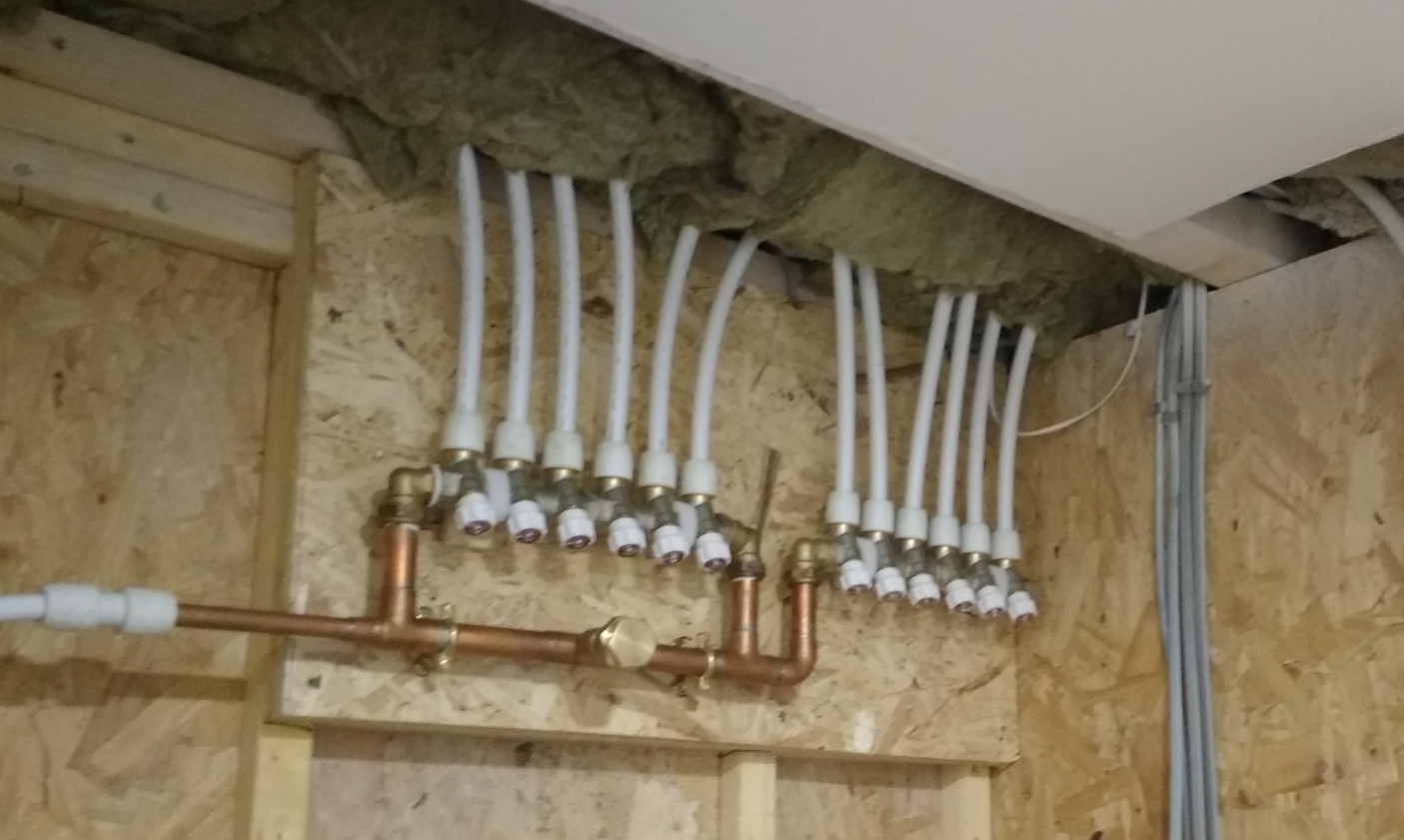

TerryE Posted February 8, 2017 Author Share Posted February 8, 2017 OK, here is the hot manifold also done: Ignore the Hep20 connector to the left; that's just temporary for pressure testing and commissioning. I'll replace this with the draincock later. The TMV fits onto the 28mm common where the 28mm compression endstop is currently fitted. (There is extra insulation behind the panel and I am going to fit a box around this lot for insulation.) However we've got an issue that I would like some advice on. I commented in an earlier post that our flow rate is over 35 ltr / min. This is an understatement. If you do a 6-second flow test with two buckets: the first is to catch the flow for a few secs whilst it settles down, then you cut the second bucket into the flow stream for the six second count, and the measure. The flow rate is ~50 ltr / min. The picture shows the nominal high-flow to the left; low-flow to the right, but the flow out of the "low flow" taps is fearsome -- far too fierce for most of our basins. So we would like to throttle the low flows right back. I don't think that the manifold valves are really designed for such flow throttling. So I was wondering whether to put a restrictor or in or even a 15mm PRV set to 1-bar or so in order to drop the flow rate to the toilets and basins right back. I realise that I'll need to redo the pipe work, e.g. in this hot case put take the flow around to the other end of the low-flow 2×3 manifold set on the right and this will give room for a PRV or a flow restrictor. Comments? Link to comment Share on other sites More sharing options...
Barney12 Posted February 9, 2017 Share Posted February 9, 2017 I'm sure the pro's will have a better solution but I used a couple of these in my last place to balance a hot and cold feed. Worked perfectly. http://www.wondervalve.com/ 1 Link to comment Share on other sites More sharing options...
PeterW Posted February 9, 2017 Share Posted February 9, 2017 16 minutes ago, Barney12 said: I'm sure the pro's will have a better solution but I used a couple of these in my last place to balance a hot and cold feed. Worked perfectly. http://www.wondervalve.com/ Quite a clever bit of kit - did it come with a WRAS marking on the packaging ..?? Link to comment Share on other sites More sharing options...
Barney12 Posted February 9, 2017 Share Posted February 9, 2017 16 minutes ago, PeterW said: Quite a clever bit of kit - did it come with a WRAS marking on the packaging ..?? From memory there wasn't any packaging. They came in Jiffy bags. Link to comment Share on other sites More sharing options...
Barney12 Posted February 9, 2017 Share Posted February 9, 2017 (edited) Just noticed the WRAS logo is displayed on the product brochure: http://www.wondervalve.com/uploads/files/wondervalve_brochure_26_08_11.pdf (last page) Edited February 9, 2017 by Barney12 1 Link to comment Share on other sites More sharing options...
Jeremy Harris Posted February 9, 2017 Share Posted February 9, 2017 (edited) We had to fit (and test) flow limiters on all outlets. I just fitted flow rate limiting washers, cheap, easy to fit (and remove after inspection................) and do the job over a wide pressure range. For a shower you can just replace the existing washer in the fitting with a flow limiting one, for a bit of pipe you need to fit the flow limiting washer in an adapter. You can pay through the nose for adapters with ball valves on, but if you hunt around there are cheaper straight ones available. The washers I used are like these, colour coded for flow rate in litres/min, over their working pressure range: These work by the elastomer bit in the middle deflecting under changes in water pressure to open or close the peripheral water flow space, hence regulating the flow rate more or less independent of pressure. Edited February 9, 2017 by JSHarris 1 Link to comment Share on other sites More sharing options...
TerryE Posted February 9, 2017 Author Share Posted February 9, 2017 Guys, I'll have to go around with the likes, but I go to bed with a problem and wake up to a solution. Isn't this forum and its members brilliant! Thanks guys. Link to comment Share on other sites More sharing options...
Jeremy Harris Posted February 9, 2017 Share Posted February 9, 2017 Terry, if you want an idea of the massive range of flow restrictors like this, then this page (where I nicked the image above from) give a fair idea: https://www.qssupplies.co.uk/Taps/Taps/EcoHomeRestricters/Product/463.htm There are literally dozens of suppliers of these things, as the water regs require that taps, showers etc be limited in flow rate for a lot of new builds. Often fittings are supplied with the flow limiters already fitted, we found; our downstairs WC tap had one on already, for example. 1 Link to comment Share on other sites More sharing options...

TerryE Posted February 10, 2017 Author Share Posted February 10, 2017 Back to the flow regulation issue, I've been checking our taps and they all use a standard diameter aerator / flow limiter and increased flow restriction versions are cheaply available, so for any that fail the flow tests, I can swap them out for the test. They all seem to have a preferred 1-5 bar rating and our 3 bar pressure is bang in the middle of this, so the whole "need to do flow restriction" is pretty much a non-issue if done at the appliance end. Phew. Another panic over. However, with all of these restrictors around the place, having a decent clean filtered water seems a really good idea, so I want to find a decent limescale inhibitor and a filter that I can clean without having to do any major disassembly. However, having looked into this there are no WRAS approved chemical filters for potable water, since these work by swapping out the calcium and magnesium ions in the water for sodium ions, and this effects both the taste and wholesomeness of the water. The magnetic descalers seem to be based purely on pseudo-science and there is no real evidence that they do anything at all. As to filters, the magic search term to use is strainer (thanks Jeremy) which yielded the business on the JTM site: Brass Strainer 22 mm. Another step forward. Where is your Welshman when you need him! 1 Link to comment Share on other sites More sharing options...
