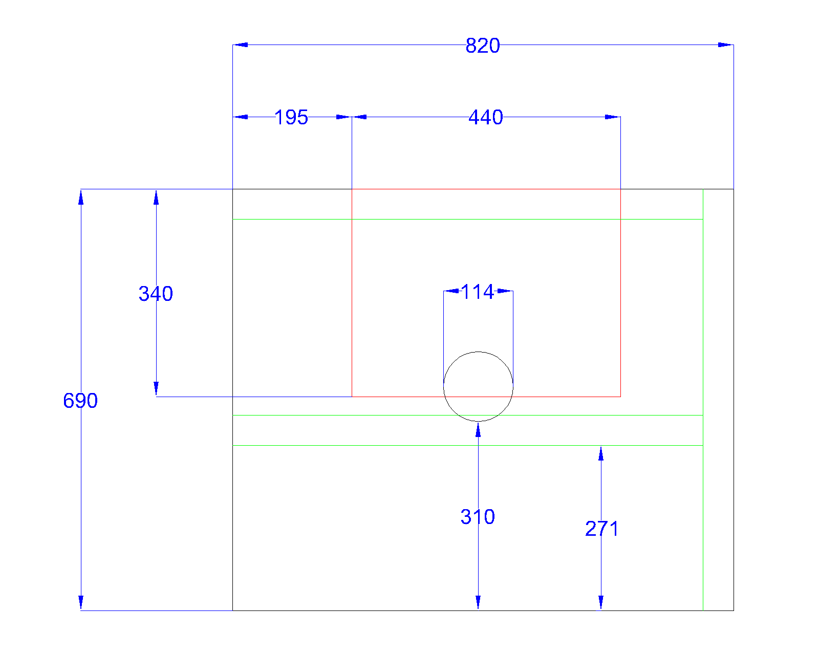

Onoff Posted November 30, 2020 Author Posted November 30, 2020 Reckon I'll have to lose that 4x2m joist that just clips the 114dia access hole I drilled. Red is the boiler outline, green is 4x2 frame/joist. Can just see the edge of the joist, top left of the hole I drilled. A circa 450x450 hatch as suggested is the way I'm going I think:
Gav_P Posted November 30, 2020 Posted November 30, 2020 1 hour ago, Onoff said: Reckon I'll have to lose that 4x2m joist that just clips the 114dia access hole I drilled. Red is the boiler outline, green is 4x2 frame/joist. Can just see the edge of the joist, top left of the hole I drilled. A circa 450x450 hatch as suggested is the way I'm going I think: Ffs ? It’s a bloody inspection hatch not the spacex escape hatch. 2
Mr Punter Posted November 30, 2020 Posted November 30, 2020 Cheap plastic rectangular one. Leave the joist. https://www.ebay.co.uk/p/23011376431 fitted in 3 minutes. Multi tool and mastic. These are the sort that I put in. Also use them for dirgos and base of internal stacks. 1

Onoff Posted November 30, 2020 Author Posted November 30, 2020 29 minutes ago, Mr Punter said: Cheap plastic rectangular one. Leave the joist. https://www.ebay.co.uk/p/23011376431 fitted in 3 minutes. Multi tool and mastic. These are the sort that I put in. Also use them for dirgos and base of internal stacks. Too late, just ordered a 450mm2 fire rated one north of £50.
Mr Punter Posted November 30, 2020 Posted November 30, 2020 1 minute ago, Onoff said: Too late, just ordered a 450mm2 fire rated one north of £50. Mug! Cancel the order and split the winnings with me for my fine advice. 1
