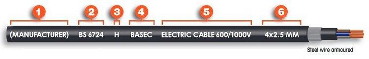

Do you know the cable run length in metres and what size the cable is? If it's armoured cable look for something like the 4x2.5 below. G'teed it won't be white anymore! ? Often it's raised / embossed.

Supply comes from the other half of the building. Its the incoming to that that i think is the issue. A small bit sticks out of the ground. Ive got 16mm armoured under my drive. Its WAY bigger than that. But thats not to say its that size all the way. Difficult to know. Not my farm :(
