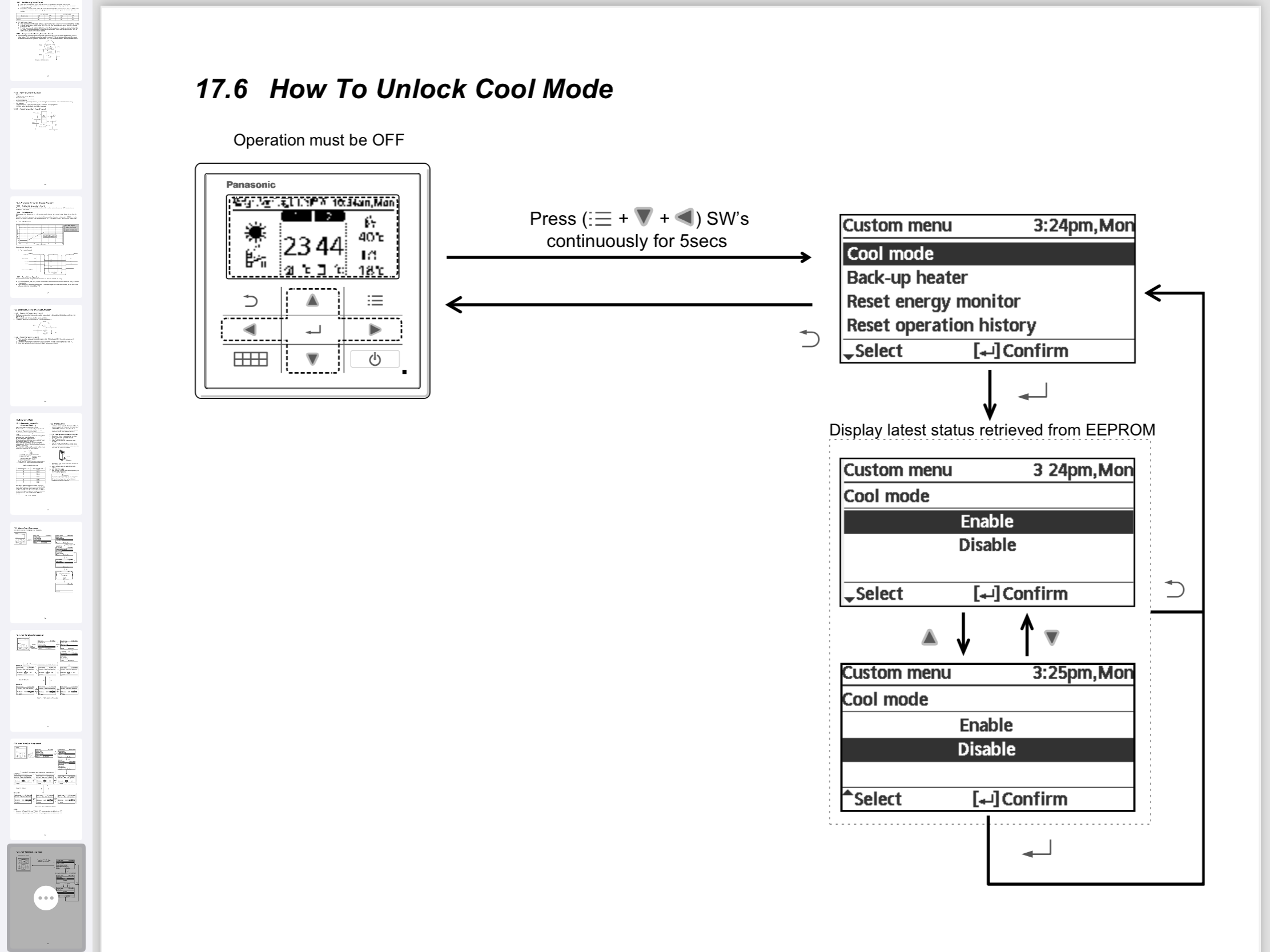

Nick Laslett Posted May 9, 2024 Share Posted May 9, 2024 (edited) On 23/11/2020 at 23:37, Nick Laslett said: I believe that @jack has a Panasonic ASHP with cooling mode engaged. I think you need a service menu code to enable it. Panasonic “J” series ASHP. Just for future reference, here is the page from the Service Manual, with the key presses to unlock cooling mode. You need to enter the installer setup first before pressing the buttons. Edited May 9, 2024 by Nick Laslett Link to comment Share on other sites More sharing options...

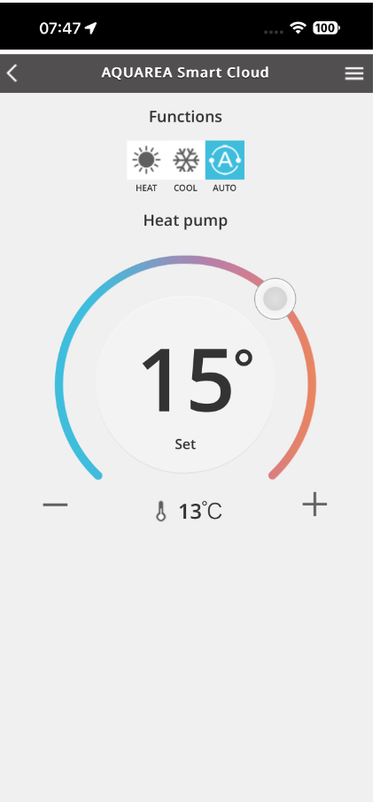

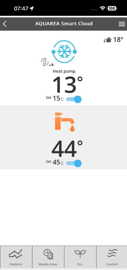

Avendit Posted August 1, 2024 Share Posted August 1, 2024 On 09/05/2024 at 18:58, Nick Laslett said: Panasonic “J” series ASHP. Just for future reference, here is the page from the Service Manual, with the key presses to unlock cooling mode. You need to enter the installer setup first before pressing the buttons. On 10/05/2024 at 12:06, Dave Jones said: exactly what i did with our aquera. Home Assistant gives more control over it than the Panasonic app! I've just tried this but am not getting cooling. Unit is cooling enabled, I have a target temp of 12 configured as a 'direct' temp, cooling shows up through the whole UI, but it's not firing up to actually deliver cooling. Does something physical need added as per post 2 or 3 from the start of the thread? Either a terminal short or cooling stat? For heating I'm just using the water temp to call for heat, so no heating stat or connection to the heating system. Link to comment Share on other sites More sharing options...
Dave Jones Posted August 1, 2024 Share Posted August 1, 2024 6 hours ago, Avendit said: I've just tried this but am not getting cooling. Unit is cooling enabled, I have a target temp of 12 configured as a 'direct' temp, cooling shows up through the whole UI, but it's not firing up to actually deliver cooling. Does something physical need added as per post 2 or 3 from the start of the thread? Either a terminal short or cooling stat? For heating I'm just using the water temp to call for heat, so no heating stat or connection to the heating system. As long as cooling is enabled on the controller it should work on the app also. 3 port valve should move etc. Post photo of your controller showing the setup. I use AUTO on the app so whatever temp you dial in it will try to achieve hot or cold doesn't matter. Link to comment Share on other sites More sharing options...
Avendit Posted August 1, 2024 Share Posted August 1, 2024 41 minutes ago, Dave Jones said: As long as cooling is enabled on the controller it should work on the app also. 3 port valve should move etc. Post photo of your controller showing the setup. I use AUTO on the app so whatever temp you dial in it will try to achieve hot or cold doesn't matter. (Wouldn't normally have it on at these temps, or set this cool, just did this for the pic). But no activation of the HP and therefore no cooled water ☹️. Link to comment Share on other sites More sharing options...
JohnMo Posted August 1, 2024 Share Posted August 1, 2024 7 hours ago, Avendit said: Does something physical need added as per post 2 or 3 from the start of the thread? Either a terminal short or cooling stat? How do you call for heat when heating? If you are using a buffer the call for heat may come that, if so you need to change it's temperature activation temperature. If you are using house thermostat(s) then you need to wind them above your actual room temperature so they call for heat. If you using radiators don't waste your time. Just because you have enabled cooling, doesn't mean the heat pump will do anything. It needs a call for heat or cooling to start. Link to comment Share on other sites More sharing options...
Avendit Posted August 1, 2024 Share Posted August 1, 2024 50 minutes ago, JohnMo said: How do you call for heat when heating? If you are using a buffer the call for heat may come that, if so you need to change it's temperature activation temperature. If you are using house thermostat(s) then you need to wind them above your actual room temperature so they call for heat. If you using radiators don't waste your time. Just because you have enabled cooling, doesn't mean the heat pump will do anything. It needs a call for heat or cooling to start. It has zone & sensor set to use 'room temperature: water sensor' to sense demand so I can use a compensation curve. When heating is 'on' it then keeps its loop at the set temp, which keeps the buffer at the temp, which keeps the heating at the temp. I run open loop in winter, so although I have room controls, they are all set up at 22, and I don't think the (heatmiser) heating system is electrically or logically connected to the HP. That said, I can create 'demand' by setting a room temp up to 30 degrees when it's warm to get the heating water circulating, but the buffer and HP loop stay at 20, despite a target temp of say 12. I'm hoping someone that used the process from the manual above to unlock cooling can confirm if anything else was needed. Link to comment Share on other sites More sharing options...
Dave Jones Posted August 1, 2024 Share Posted August 1, 2024 post a picture of your controller with cooling turned on, ill see if its similar to mine. Link to comment Share on other sites More sharing options...
Avendit Posted August 1, 2024 Share Posted August 1, 2024 2 hours ago, Dave Jones said: post a picture of your controller with cooling turned on, ill see if its similar to mine. Sorry, I thought I had, apologies Link to comment Share on other sites More sharing options...
Dave Jones Posted August 1, 2024 Share Posted August 1, 2024 i mean the controller not the app Link to comment Share on other sites More sharing options...
Avendit Posted August 1, 2024 Share Posted August 1, 2024 Well, I don't think I did anything, but that's it running now! Is there a lower outdoor temp it won't run below? I was playing in the evening last night, so possibly just too cool to kick in. Link to comment Share on other sites More sharing options...
Dave Jones Posted August 1, 2024 Share Posted August 1, 2024 1 hour ago, Avendit said: Well, I don't think I did anything, but that's it running now! Is there a lower outdoor temp it won't run below? I was playing in the evening last night, so possibly just too cool to kick in. just check the delta T 5c range thing is turned off for cooling, you want exacts 1 Link to comment Share on other sites More sharing options...
Dave Jones Posted August 2, 2024 Share Posted August 2, 2024 15 hours ago, Avendit said: Well, I don't think I did anything, but that's it running now! Is there a lower outdoor temp it won't run below? I was playing in the evening last night, so possibly just too cool to kick in. how did the cooling work out ? Link to comment Share on other sites More sharing options...
