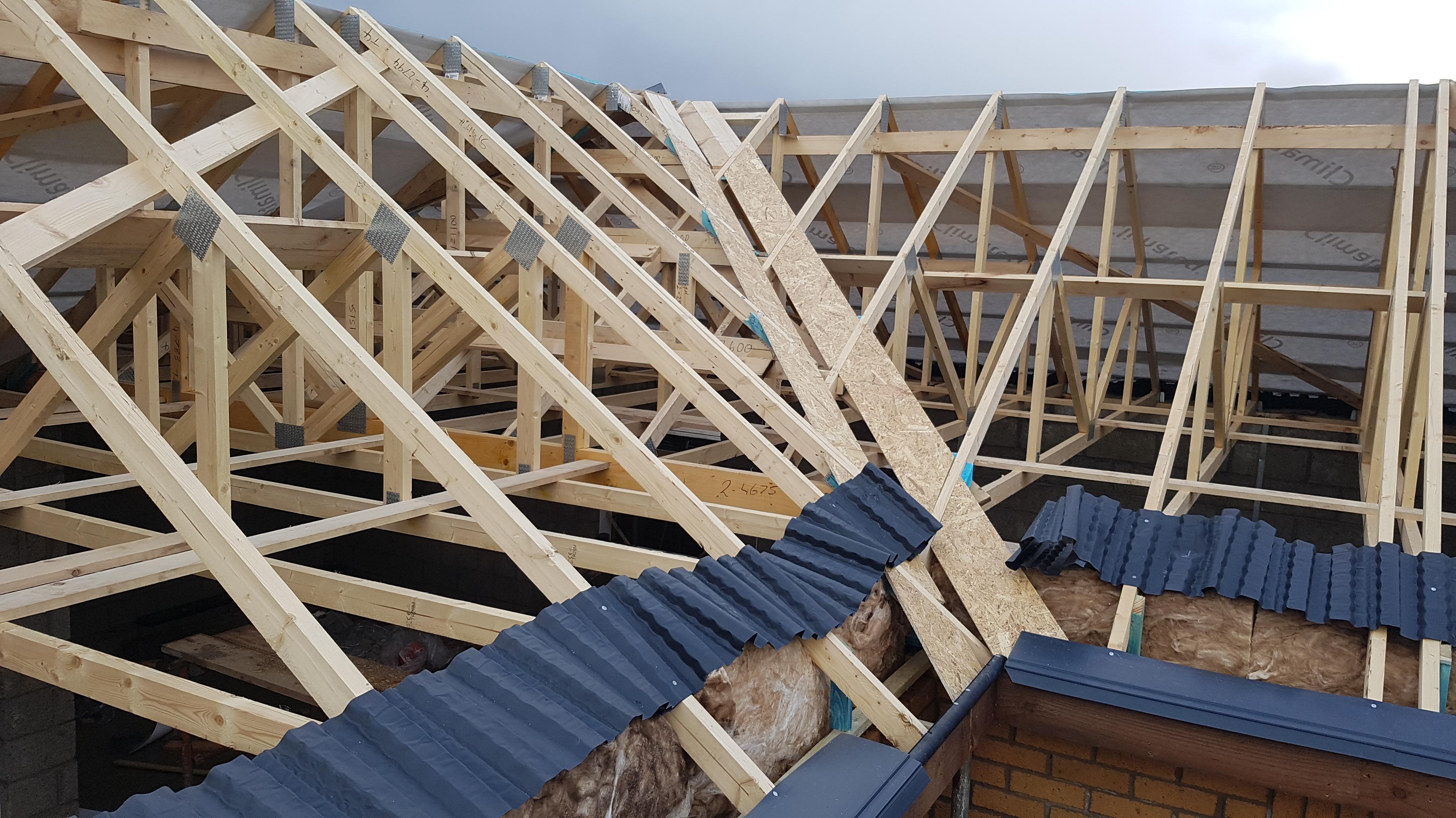

Iceverge Posted November 25, 2020 Share Posted November 25, 2020 This is what we did. 2 Link to comment Share on other sites More sharing options...

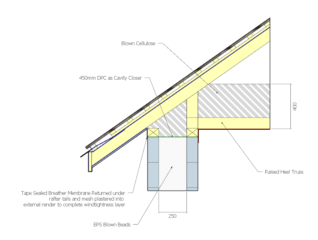

tonyshouse Posted November 26, 2020 Share Posted November 26, 2020 Nice, for me the op has too little insulation in the eaves zone and almost none over the wall plate ? Link to comment Share on other sites More sharing options...
Iceverge Posted November 26, 2020 Share Posted November 26, 2020 7 hours ago, tonyshouse said: Nice, for me the op has too little insulation in the eaves zone and almost none over the wall plate ? As a workaround adding extra insulation below the roof joists or a fillet piece internally might work if aiming for low thermal bridging at the eaves. Link to comment Share on other sites More sharing options...
tonyshouse Posted November 26, 2020 Share Posted November 26, 2020 Yes, or false skeiling ceiling Link to comment Share on other sites More sharing options...

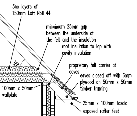

MortarThePoint Posted November 26, 2020 Author Share Posted November 26, 2020 This is part of the construction drawing. The loft insulation is to overlap the wall plate and cavity insulation. Link to comment Share on other sites More sharing options...
MortarThePoint Posted November 26, 2020 Author Share Posted November 26, 2020 On 25/11/2020 at 11:11, Oz07 said: What's that rippled black plastic called? I presume it's to create a ventilation gap between insulation and roofing membrane Link to comment Share on other sites More sharing options...
Mr Punter Posted November 26, 2020 Share Posted November 26, 2020 10 minutes ago, MortarThePoint said: What's that rippled black plastic called? I presume it's to create a ventilation gap between insulation and roofing membrane Roll out rafter tray Link to comment Share on other sites More sharing options...
Oz07 Posted November 27, 2020 Share Posted November 27, 2020 Egg box sh!t. As in " get me another roll of that egg box sh!t" Link to comment Share on other sites More sharing options...
PeterW Posted November 27, 2020 Share Posted November 27, 2020 8 hours ago, MortarThePoint said: What's that rippled black plastic called? I presume it's to create a ventilation gap between insulation and roofing membrane Only required if you don’t use breather membrane as airflow is not required otherwise. Link to comment Share on other sites More sharing options...
