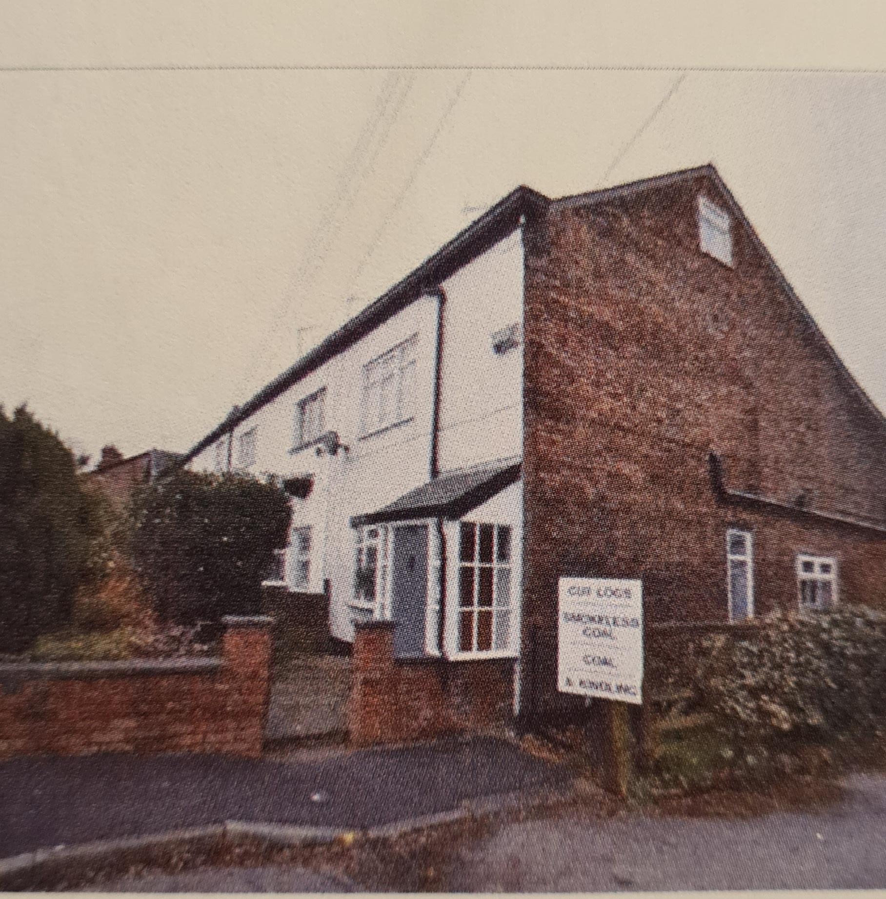

Country Geek Posted November 23, 2020 Author Share Posted November 23, 2020 (edited) 5 minutes ago, ProDave said: I would love to know what happened there. the "join" ends 2/3 of the way up. Above that the bricks are bonded across properly. It's like a small building got extended to the side and over the top? How do you know it's going to be an issue in surveys if there is no sign of movement? Any attempt to cover it up would just be seen as trying to hide a fault. Its an end of terrace of a row of 5 cottages that used to be farm outbuildings I think. I just know it was an issue last time round but I never got to the bottom of why there were issues. Nobody actually gave us the exact reason, I am only assuming it was this that flagged up. I don't know where I'd be able to find the buildings full history ? Any ideas? Edited November 23, 2020 by Country Geek Link to comment Share on other sites More sharing options...
Pete Posted November 23, 2020 Share Posted November 23, 2020 Search maps historically for your area, it may show up what it used to be like Link to comment Share on other sites More sharing options...
ProDave Posted November 23, 2020 Share Posted November 23, 2020 Is that "join" within your property or on the boundary with next door? Is that your front or back wall or end wall? Just trying to visualise better. Link to comment Share on other sites More sharing options...
Country Geek Posted November 23, 2020 Author Share Posted November 23, 2020 Thats the end wall of a row of 5. Thats our wall not shared Link to comment Share on other sites More sharing options...
joe90 Posted November 23, 2020 Share Posted November 23, 2020 (edited) 24 minutes ago, Country Geek said: of 5 cottages that used to be farm outbuildings there you go, altered/extended, proper join, unless there is evidence of movement it’s not a problem. Tell any buyer that!!! If you can find any history, buyers like that sort of thing. Edited November 23, 2020 by joe90 1 Link to comment Share on other sites More sharing options...
Ferdinand Posted November 24, 2020 Share Posted November 24, 2020 Is there another one on the other end of the terrace? I would say it looks like a small terrace or barn that was extended for growth 150 years ago reusing the structure, and for some reason the bit on the end was removed afterwards. May have been a former house or some sort of barn. To make a road? There may be foundations under that bit of the path / side track. The mortar came out over time and someone bodged it with goo. IMO a surveyor should mention that as it is obvious. F 1 Link to comment Share on other sites More sharing options...

ProDave Posted November 24, 2020 Share Posted November 24, 2020 One thing that would smarten it up and to a small extend "hide" the obvious joint is paint the end wall white to match the front. If the front is render, not just paint, then render the end wall would certainly hide the issues. Link to comment Share on other sites More sharing options...

Country Geek Posted November 24, 2020 Author Share Posted November 24, 2020 43 minutes ago, Ferdinand said: Is there another one on the other end of the terrace? I would say it looks like a small terrace or barn that was extended for growth 150 years ago reusing the structure, and for some reason the bit on the end was removed afterwards. May have been a former house or some sort of barn. To make a road? There may be foundations under that bit of the path / side track. The mortar came out over time and someone bodged it with goo. IMO a surveyor should mention that as it is obvious. F The other end is rendered. 31 minutes ago, ProDave said: One thing that would smarten it up and to a small extend "hide" the obvious joint is paint the end wall white to match the front. If the front is render, not just paint, then render the end wall would certainly hide the issues. Yep, could do, big job though, and as I say its not really a buyer issue it's more mortgage lender surveyors. We had lots of interest last time round and not one person (buyer) noticed it. Link to comment Share on other sites More sharing options...
Ferdinand Posted November 24, 2020 Share Posted November 24, 2020 19 minutes ago, Country Geek said: The other end is rendered. Yep, could do, big job though, and as I say its not really a buyer issue it's more mortgage lender surveyors. We had lots of interest last time round and not one person (buyer) noticed it. In which case I would probably tidy up the joint (and perhaps apply some dust to the mortar ... think hidden tunnel entrances and Colditz ?), and have a clear explanation ready for when anyone asks. Including that piccie showing where the extra building used to be, plus any maps etc. My usual source for old maps is https://www.old-maps.co.uk/#/ there are others. F Link to comment Share on other sites More sharing options...

joe90 Posted November 24, 2020 Share Posted November 24, 2020 4 minutes ago, Ferdinand said: So your audience to convince is surveyors. if a surveyor says that’s a crack then yes I would challenge it, it’s obviously a join and no sign of settlement above or below that join. I have challenged surveyors before (and won). When selling my late parents house a surveyor made several assumptions that were plainly incorrect and when I presented my evidence they retracted their findings. Link to comment Share on other sites More sharing options...
ProDave Posted November 24, 2020 Share Posted November 24, 2020 3 hours ago, Country Geek said: The other end is rendered. Yep, could do, big job though, and as I say its not really a buyer issue it's more mortgage lender surveyors. We had lots of interest last time round and not one person (buyer) noticed it. Does that mean a sale fell through because a survey stopped someone getting a mortgage? Link to comment Share on other sites More sharing options...
ProDave Posted November 24, 2020 Share Posted November 24, 2020 1 hour ago, Ferdinand said: So your audience to convince is surveyors. Which repointing the joint will not do, that will just draw attention to it and make them suspicious. The best thing for a surveyor is leave it alone so he can SEE the joint is old and there is no movement or cracking, and an explanation of how the building changed many years ago to leave a joint like that. 1 Link to comment Share on other sites More sharing options...
