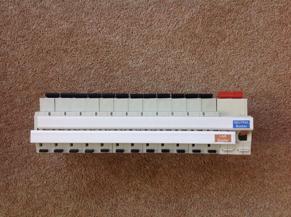

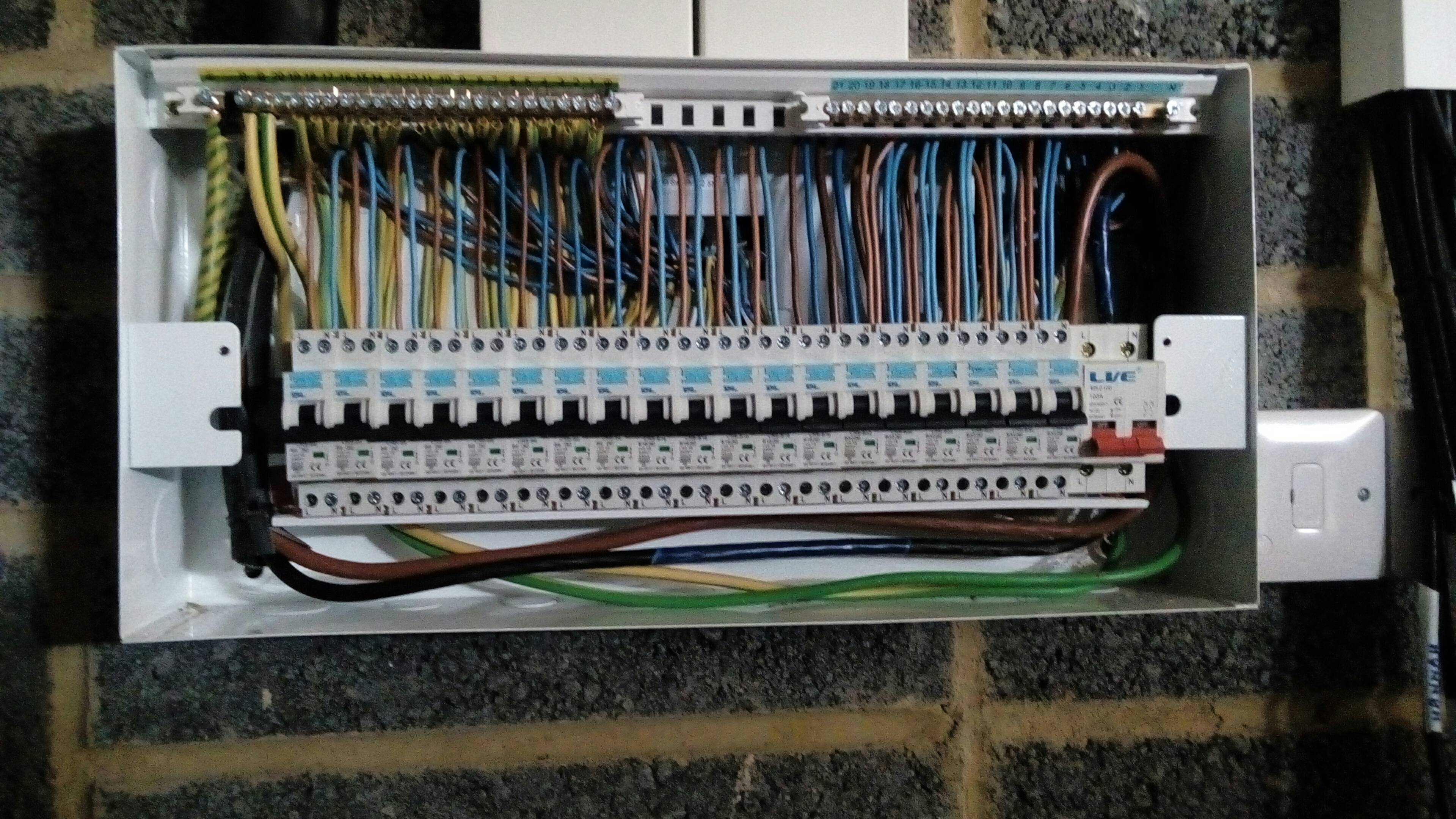

Steptoe Posted January 23, 2017 Posted January 23, 2017 A picture of a board with DP RCBOs, Not mine BTW, but loads of room. 1
Onoff Posted January 23, 2017 Posted January 23, 2017 2 hours ago, Steptoe said: A picture of a board with DP RCBOs, Not mine BTW, but loads of room. No fly lead, T&E goes straight into the RCBO. All you have to do is connect the cpcs! (I do remember commenting as to the lack of cable markers! )
PeterW Posted January 23, 2017 Posted January 23, 2017 5 minutes ago, Onoff said: All you have to do is connect the cpcs! Explain please.... And most of these don't use a bus bar and the Neutral / Live are next to each other on the feed so how does that work..??
Steptoe Posted January 23, 2017 Posted January 23, 2017 6 minutes ago, Onoff said: No fly lead, T&E goes straight into the RCBO. All you have to do is connect the cpcs! (I do remember commenting as to the lack of cable markers! ) Ye, its one I use to show customers of how tidy they can be.
Steptoe Posted January 23, 2017 Posted January 23, 2017 1 minute ago, PeterW said: Explain please.... And most of these don't use a bus bar and the Neutral / Live are next to each other on the feed so how does that work..?? Dual busbar under the RCBO, and DP RCBO with the same form factor as a normal MCB, But you won't ever see these in the sheds.
Onoff Posted January 23, 2017 Posted January 23, 2017 Just now, PeterW said: Explain please.... And most of these don't use a bus bar and the Neutral / Live are next to each other on the feed so how does that work..?? OK, bring in your twin and earth cable to the enclosure. Line & neutral goes to L&N of the RCBO (either top or bottom) and the cpc (circuit protective conductor) aka "earth" wire goes to the earth bar top left. That's it. Ref the bus bar, it's two separate, "staggered", insulated bus bars: Obviously if you bring your circuits in to the bottom of the assembly the bus bars would go on top. Can supply details of the supplier of these if you discuss with your sparks and he contacts them.
PeterW Posted January 23, 2017 Posted January 23, 2017 OK so the bus bar pitch is the same as normal..? How does that work with the neutral that normally is to one side of the line ...? I can see how if they are "stacked" then the line can hit the isolator correctly - do they come with bus bars to match..? And whats a CPCS..??? As its not a Construction Plant Competence Scheme....
PeterW Posted January 23, 2017 Posted January 23, 2017 2 minutes ago, Onoff said: OK, bring in your twin and earth cable to the enclosure. Line & neutral goes to L&N of the RCBO (either top or bottom) and the cpc (circuit protective conductor) aka "earth" wire goes to the earth bar top left. That's it. Ref the bus bar, it's two separate, "staggered", insulated bus bars: Obviously if you bring your circuits in to the bottom of the assembly the bus bars would go on top. Can supply details of the supplier of these if you discuss with your sparks and he contacts them. Aaaaaaaaaaaaaaaahhhhhhhhhhhhhhhh !!!!!!!!!!!!!! Makes sense now ! Cheers @Onoff...! Supplier may be of use although I'm doing the buying as he's on install labour only And I now get the reference to CPC's, it was the CPCS bit that threw me ...!
Onoff Posted January 23, 2017 Posted January 23, 2017 26 minutes ago, PeterW said: Aaaaaaaaaaaaaaaahhhhhhhhhhhhhhhh !!!!!!!!!!!!!! Makes sense now ! Cheers @Onoff...! Supplier may be of use although I'm doing the buying as he's on install labour only And I now get the reference to CPC's, it was the CPCS bit that threw me ...! There was you thinking "Farnell?" 1
PeterW Posted January 23, 2017 Posted January 23, 2017 Yep to start with ..! Interesting way of doing it too - shows that things move on and it makes a very neat install.
Steptoe Posted January 23, 2017 Posted January 23, 2017 1 minute ago, PeterW said: Yep to start with ..! Interesting way of doing it too - shows that things move on and it makes a very neat install. Yep, you simply wouldn't use SP RCBOs, and these are a comparable price, Assuming, (and I know I shouldn't) that OnOff and myself both obtain these direct from the same source, they are not afaiaa sold to the public, but only to Electricians who have evidenced it to the importer.

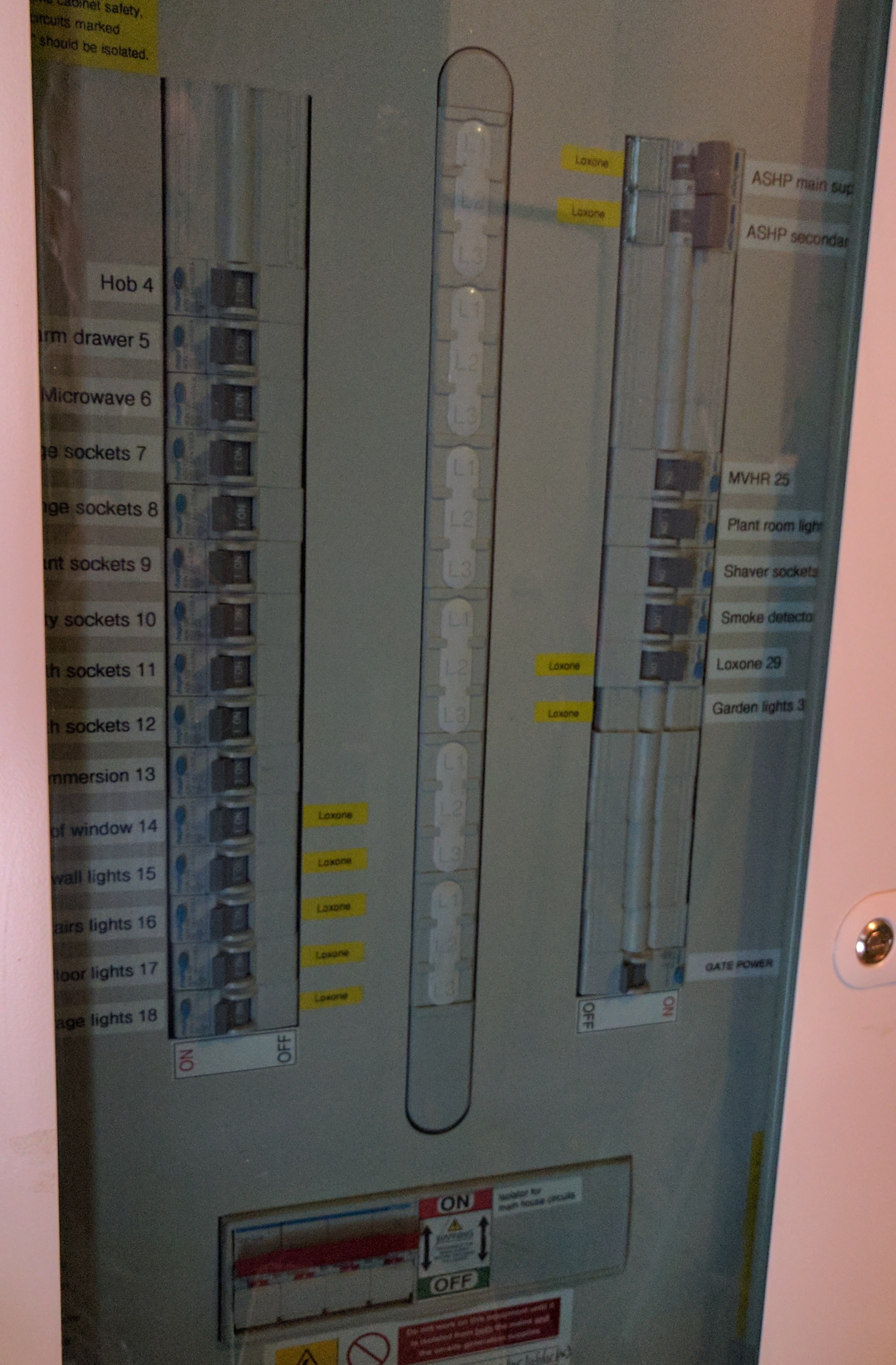

jack Posted January 24, 2017 Posted January 24, 2017 9 hours ago, Steptoe said: they are not afaiaa sold to the public, but only to Electricians who have evidenced it to the importer. Is this the guy who's a sponsor on the electricians' forum? At one point I looked into getting our unit from him but my electrician was wary about where the RCBOs were sourced, then other things got in the way so I ended up with a large Hager box (three phase with a conversion I think) with SP RCBOs.
Steptoe Posted January 24, 2017 Posted January 24, 2017 1 minute ago, jack said: Is this the guy who's a sponsor on the electricians' forum? At one point I looked into getting our unit from him but my electrician was wary about where the RCBOs were sourced, then other things got in the way so I ended up with a large Hager box (three phase with a conversion I think) with SP RCBOs. Yep, They come from the same source many brand name RCBO s and MCBs come from, and are widely used worldwide where mostly only DP RCBOs are used, Yet another area where we are in the dark ages and still permitting SP RCBOs as acceptable under most circumstances. As I'm sure you know, most of these things are simply rebranded generic clones.
jack Posted January 24, 2017 Posted January 24, 2017 1 minute ago, Steptoe said: As I'm sure you know, most of these things are simply rebranded generic clones. Yes, my electrician and I looked into it far enough to agree that was the case. I can't remember exactly why we didn't go with it in the end. I think he just felt more comfortable with branded, which I can understand given what's at stake. Given the size of the house and the number of circuits needed (ASHP, PV, home automation, stupid number of kitchen appliances, etc) we ended up with a Hager three-phase board with conversion pack(?)
jack Posted January 24, 2017 Posted January 24, 2017 Yes, hence the move away from a domestic CU! Please don't tell me any of this is lethal!
Barney12 Posted January 24, 2017 Posted January 24, 2017 2 hours ago, jack said: Yes, hence the move away from a domestic CU! Please don't tell me any of this is lethal! Looks like CU Porn to me and that can make you blind!! Anyway don't panic there are many many things that are lethal, my younger brother nearly killed me with a chicken Kiev many years ago (true story).
Jeremy Harris Posted January 24, 2017 Posted January 24, 2017 I've seen Jack's board first hand, when his electrician was there wiring it up, and can vouch for it being big. Very big!. I've seen smaller boards in small factories.................
ProDave Posted January 24, 2017 Posted January 24, 2017 But there are only 22 circuits, it would have been easy to get that down to 20 and use the same large domestic board as I have. e.g do you really need a dedicated circuit for a shaver socket? And I am going to regret asking this as I am sure the answer is obvious, but what's the yellow "loxone" label on half the circuits?
