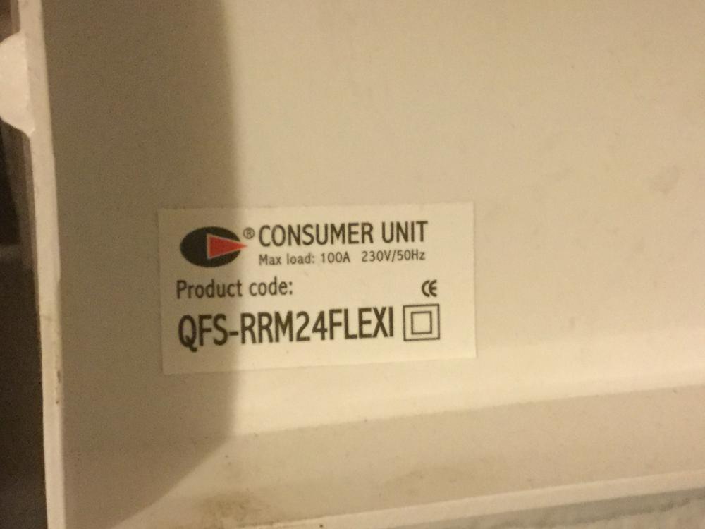

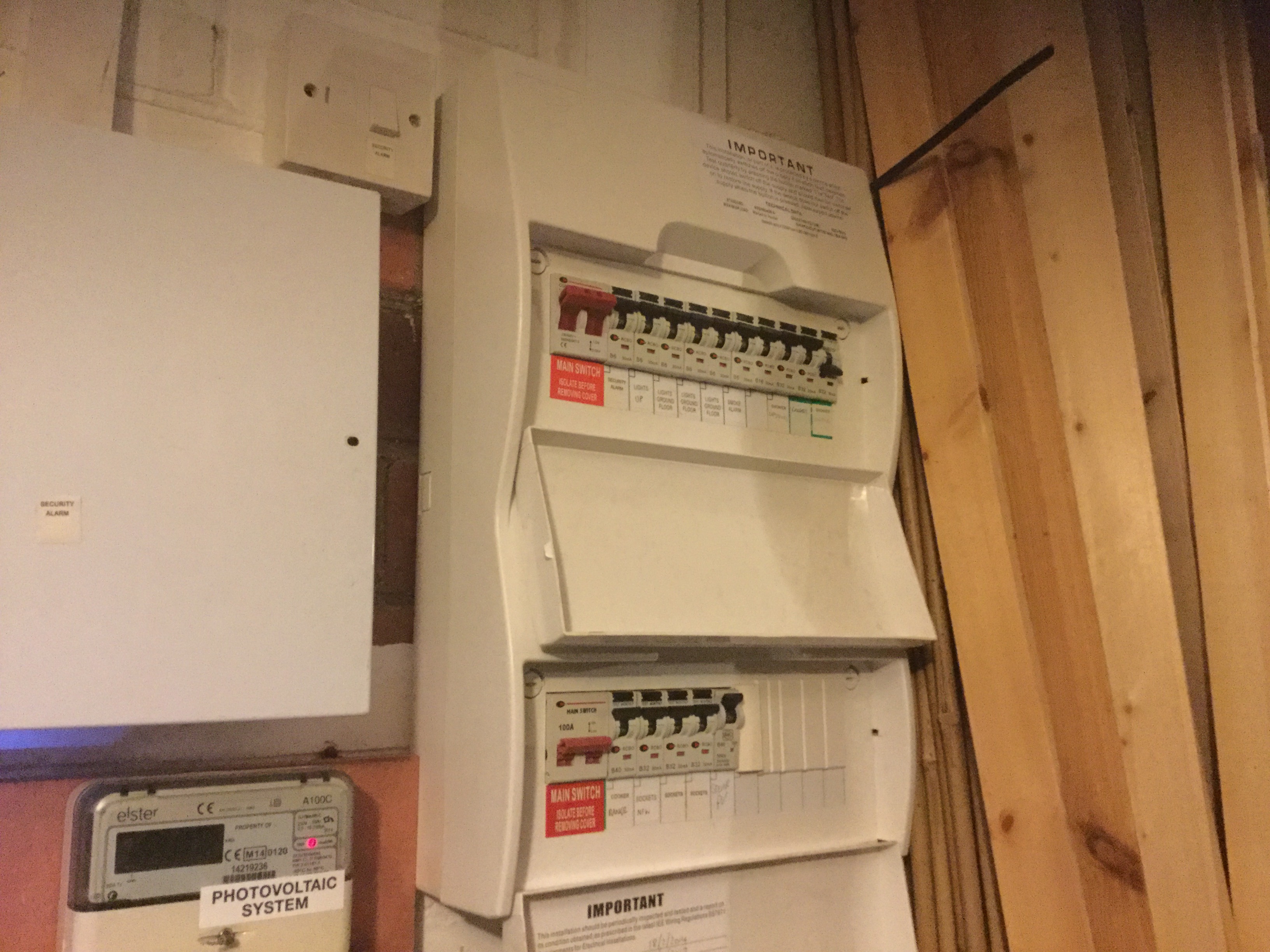

Ferdinand Posted January 23, 2017 Posted January 23, 2017 (edited) On another thread @Steptoe commented on my electrical setup: Quote The Unit is a QFS-RRM24FLEXI 20-way from Control Gear, and seems quite solid. The upgrade was notably good value. http://www.controlgeardirect.co.uk/ A quick note @Ferdinand Those are only Single Pole RCBOs, IMO not really fit for purpose tbh, You can get daisy chain faults as the neutrals don't disconnect. And, totally not permitted on TT systems, only can be used on TN, I'd advise anyone considering using RCBOs to ensure they are DP, I have had a look around and my RCBOs are to BSEN 61009-1, and I think that it is OK if not quite latest best practice. GIven that the setup meets regs circa 2014 I think I am reasonably happy. A few questions if I may: What is a TT system and a TN system? What are the differences and how can I tell which one I have in place? This is my consumer unit. Ferdinand Quote Edited January 23, 2017 by jack "SIngle" --> "Single" in subject :-D

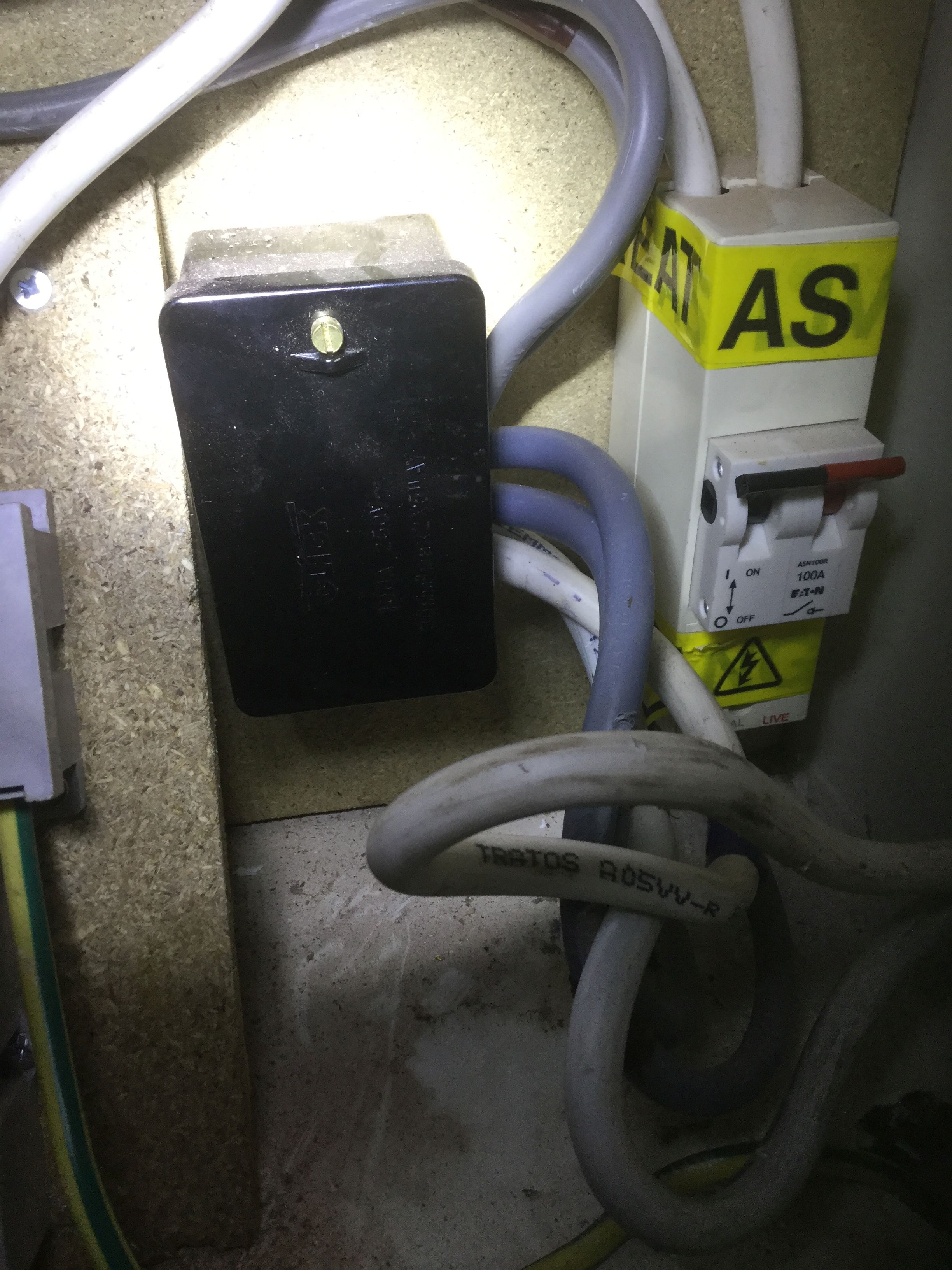

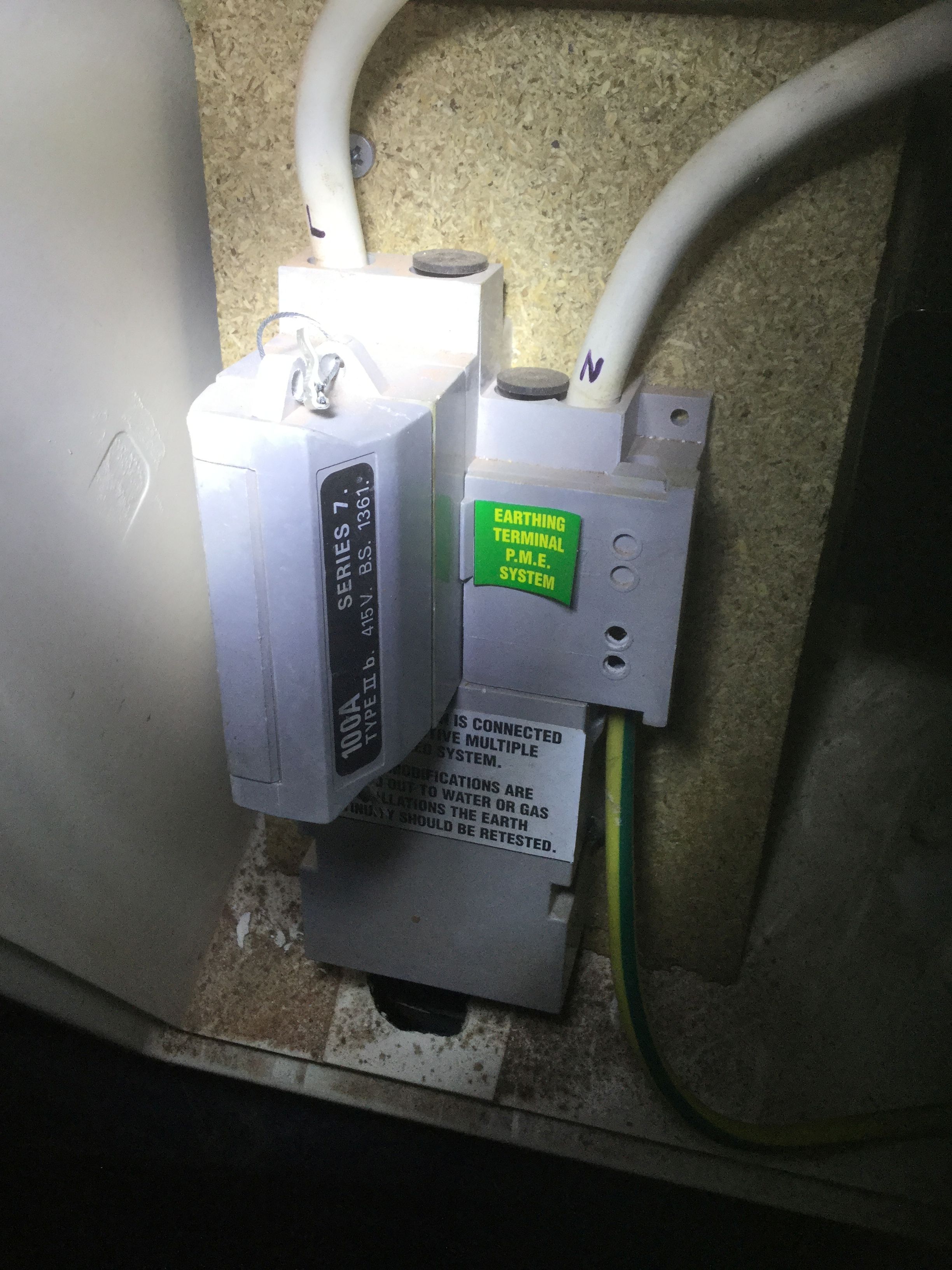

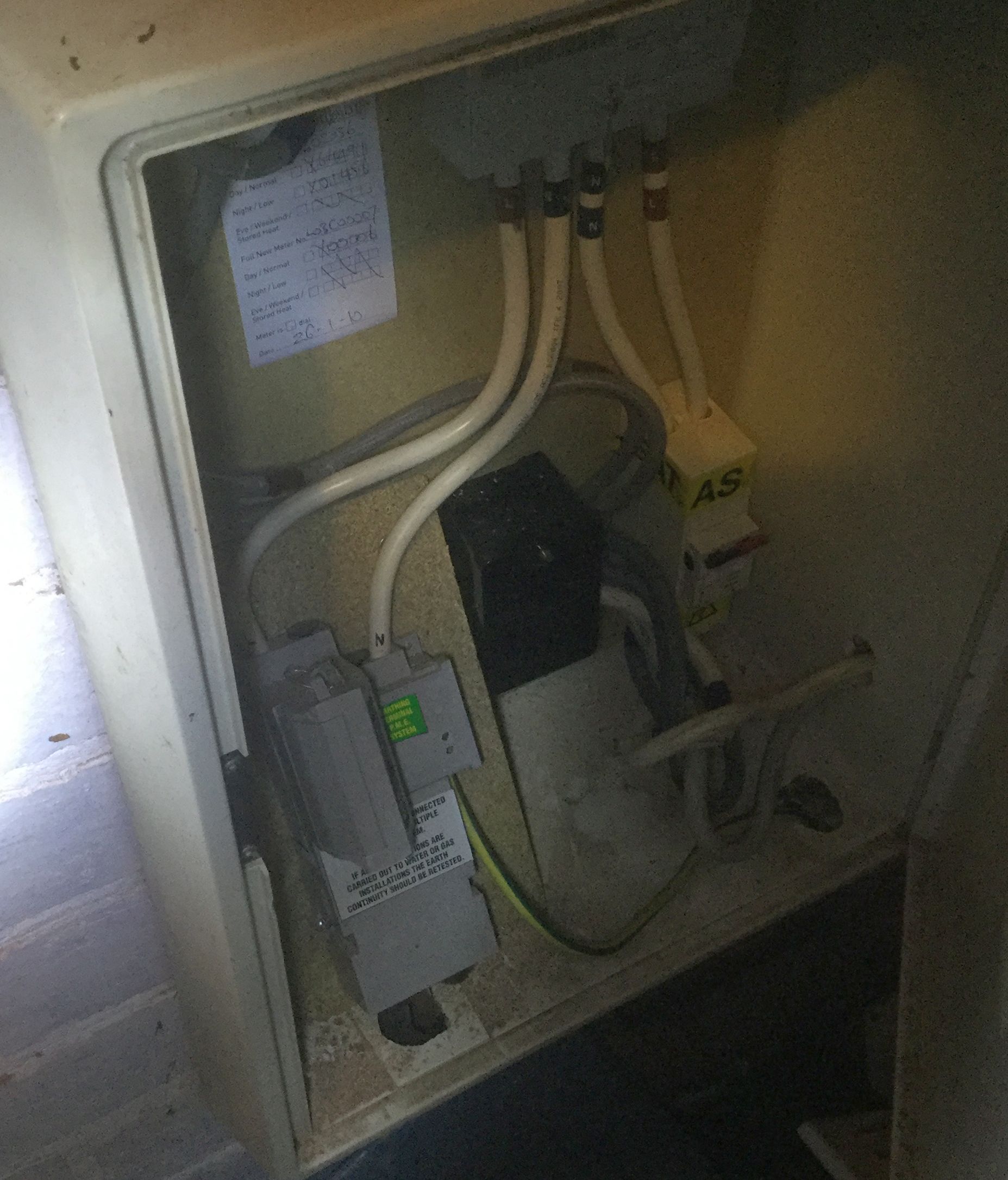

Steptoe Posted January 23, 2017 Posted January 23, 2017 3 hours ago, Ferdinand said: Thanks @Alphonsox Can you point me to something shorter e.g. One page which will help me find out which system I have in place? eg do I look in the meter box and trace it back visually until I find an earthing point? Cheers F Can you post a picture of your cutout,? ie, the incoming supply fuse and cable.
Ferdinand Posted January 23, 2017 Author Posted January 23, 2017 39 minutes ago, Steptoe said: Can you post a picture of your cutout,? ie, the incoming supply fuse and cable. Will do later.
Ferdinand Posted January 23, 2017 Author Posted January 23, 2017 Here we are. It is all in the meter box. Not very good photos, I am afraid.
Ferdinand Posted January 23, 2017 Author Posted January 23, 2017 To my eye the green label "PME" suggests it is a "TN-C-S (PME)" (from the link) system which - based on the initial comments above - suggests compatibility. Ferdinand

Steptoe Posted January 23, 2017 Posted January 23, 2017 26 minutes ago, Ferdinand said: To my eye the green label "PME" suggests it is a "TN-C-S (PME)" (from the link) system which - based on the initial comments above - suggests compatibility. Ferdinand 100% correct TN-C-S and a claimed PME system (they aren't always) , but they have to state them as such to comply with ESQCR TBH , most new installs are actually proper PME, well, the new bit anyway.

Steptoe Posted January 23, 2017 Posted January 23, 2017 3 minutes ago, PeterW said: I noticed that new installs by WP have a neatly sloping incomer with the fuse in it that means there is no odd bend in the cable - also means the meter is much less cramped towards the top of the box. We had the supply listed as the final supply point so I've also had to fit the isolator and a Henley in there so it's looking tight but hopefully they will be ok as the whole of the left side of the cabinet is free.... As long as its not a DP Henley (proper name ISCO btw) , like that widowmaker @Ferdinand has
PeterW Posted January 23, 2017 Posted January 23, 2017 2 minutes ago, Steptoe said: As long as its not a DP Henley (proper name ISCO btw) , like that widowmaker @Ferdinand has How do you mean...?
Ferdinand Posted January 23, 2017 Author Posted January 23, 2017 I'm worried again now. We have a widow in the house already and don't need any more . F
Steptoe Posted January 23, 2017 Posted January 23, 2017 21 minutes ago, PeterW said: How do you mean...? @Ferdinand has an ISCO with both Line and Neutral cables being connected, These are very prone to cracking inside , then the next time someone knocks it, or tries to remove the cover,,,,,, Prepare to meet your 40 virgins,
PeterW Posted January 23, 2017 Posted January 23, 2017 Ok so what is the alternative...? Pair of single block Henleys..? Reason I ask is that is what we have fitted in line with 17th Edition so if there is something wrong I'd like to know before the meter is installed and before Amelie the seal fairy has to come and visit....
Ferdinand Posted January 23, 2017 Author Posted January 23, 2017 Just now, PeterW said: Amelie the seal fairy has to come and visit.... Onk! Onk! Onk! Onk! Onk!
Steptoe Posted January 23, 2017 Posted January 23, 2017 DP ISCO are quite permitted in the regs, but I would only ever fit them as a last resort and space really was that tight, they are a smidge smaller than 2xSP blocks, but not by much, Also, SP gives you the option of entering either end , (oh err,), Your isolator switch should be between the block and the meter anyway, so that should provide isolation even when sealed.
