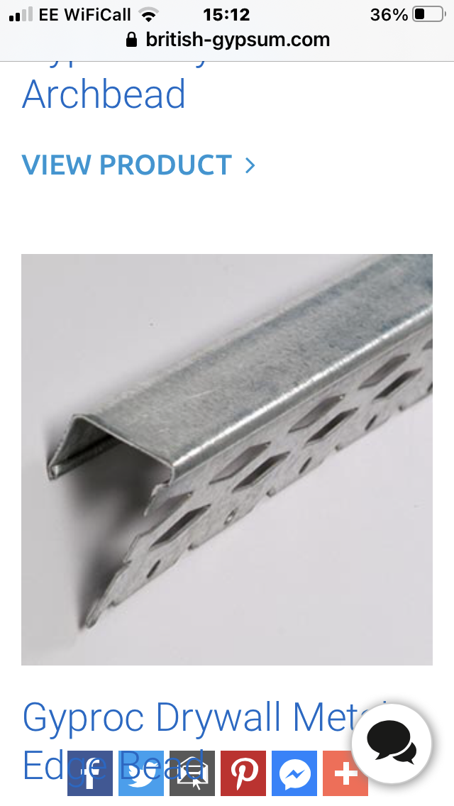

nod Posted November 22, 2020 Posted November 22, 2020 On 22/11/2020 at 12:22, Russell griffiths said: I’m looking for a trim @nod that I want to put on the edge of the boards that go into a window reveal. I want to thin skim the reveal but want a clean line against the windows, not a plastered line that will crack and require caulking. Hunting around and just just looking for recommendations. Cheers. Expand I normally use the tap on type of edge bead I buy by the box from BG But Travis Perkins should be able to order you some in 1
