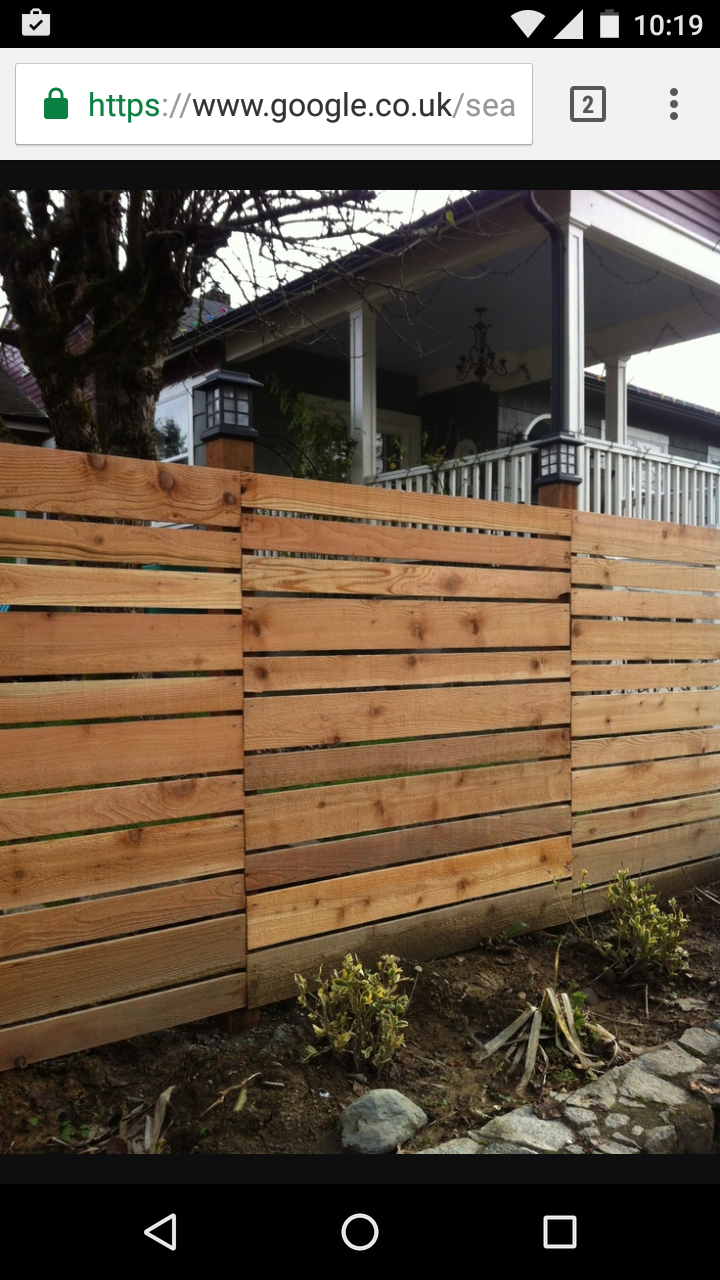

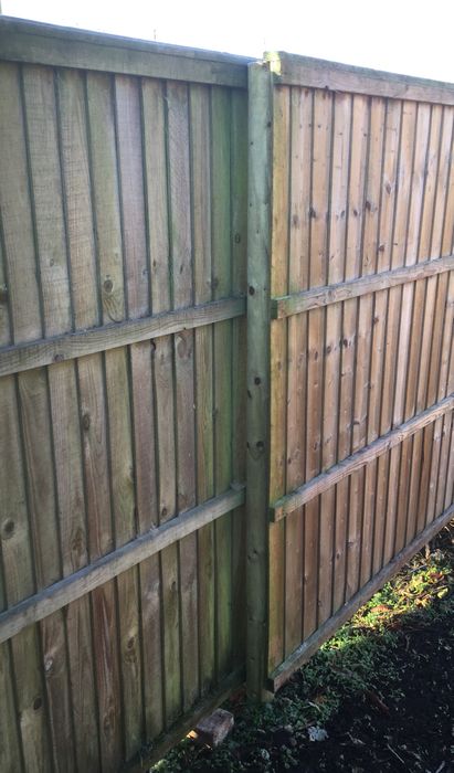

Hillydevon Posted January 23, 2017 Share Posted January 23, 2017 Hi all. I'm helping out a friend who has a very sorry looking perimeter fence. It's a run of those el cheapo panels - about 15m - which have been battered to smithreens by the elements (quite exposed and does get a hammering). My thought for a low-tech, concrete-free solution was to fix posts onto breeze blocks using proprietary plate thingies, sit them in gabions and fill with whatever stone can be sourced. Then use scaffold boards horizontally, alternating them each side of the post to give a solid appearance but also allow air flow. Anyone got two cents' worth to chuck in?? Thanks in advance! Link to comment Share on other sites More sharing options...
Crofter Posted January 23, 2017 Share Posted January 23, 2017 Is there something stopping him from being able to dig a hole? Concrete is not scary, you can use postcrete if you really want. Link to comment Share on other sites More sharing options...
Ferdinand Posted January 23, 2017 Share Posted January 23, 2017 (edited) Let me try some pertinent questions that may I hope help. What is the cost per metre of your solution? What is the required height? How long must it last? What job is the fence to do? What are the ground conditions? Can it be seethrough? Have you built a test panel and did it stand up? What size gabions are you aiming for? I would expect scaffold planks to be hellishly heavy to support and for it to perhaps blow over unless you use large gabions. Small gabions seem to start at £15 each. I use three types of garden fence myself plus hedges. One is hammered in 8ft 4" or 5" round tantalised posts, for which I pay about £3 each, and leave at 6ft high, and join them by decent closeboard 6'x6' fence panels at about £25 each wedged one brick off the ground and screwed using Wickes green outdoor screws. This will last 5-10 years and can be shelter while a hedge is established, or a building site next door is being built. Materials are about £13-15 per metre, and can usually be reused two or three times for panels, twice for the posts. The second is substantial concrete slotted posts at perhaps 3m postcreted in and using a 6" or 12" gravel board and the similar panels. This should last 15-20 years, and the posts and gravel boards should last 40 years. This is approx £25-30 per metre for materials. The best place for Postcrete is nearly always Wickes. The third is using 3" round posts at 5'6" or 1.6m long, which cost me about £1.50 each. These are hammered in and joined by anything from a single or two strands of wire to half rounds to make a ranch style fence. WIth two layers of half rounds and posts at 2m this will cost about £4-5 per metre in materials. Type one and type 3 could also be used to supported chain link or sheep mesh or dog mesh. And postrammers are worth their weight in caviar. Perhaps scaffold planks could slide into slotted concrete posts but they will need to be treated and kept off the ground. If I need something elegant I would use wrought iron Estate Fencing or posher panels such as Hit and Miss or palisade. Or a hedge. For a hedge I would use hawthorn laid properly every generation, or privet or perhaps holly .. or gorse or myrtle if really exposed to sea winds. Or beech or hornbeam for a semi evergreen or semi evergreen for a heavy soil. Or a mixture. WIth the occasional bush allowed to reach 4m for birds to roost. I think you are probably flogging a dead horse with gabions and scaffold planks and stone unless one or two of them comes for free. Of course I could be wrong. Everything is tanellised, and apart from the panels I buy at an agricultural supplier. Farmers usually know best how to get value for money. You may be stiffed for delivery costs - collect or negotiate if you can. OTOH 15m is a nice short fence! A young friend who has just moved in to his first house has just discovered that properly fencing in a 50m garden all round to be dog proof and attractive easily costs more than a new central heating system :-). Anyhoo, write down your options and add up the costs. For that length it may be worth paying someone unless you want the fun of building it. HTH Ferdinand Edited January 23, 2017 by Ferdinand Link to comment Share on other sites More sharing options...

Hillydevon Posted January 23, 2017 Author Share Posted January 23, 2017 Many thanks for all that input, guys! Agree that it needs costing, and that could vary enormously depending on whether the three elements in the mix can be sourced economically. OK, not talking about 50m - that's a substantial run! - but even 50ft wouldn't come in cheap, I guess, for a decent quality close-boarded job. Plus, as stated, that would still give a large surface area for high winds to hit, which is why I wondered about the hit-and-miss method. Should have said that it backs onto a garage block, hence (a) not the prettiest and (b) will have people trundling up and down it. Height, therfore, would be in the 6ft region, and really needs to be opaque. Also thought that many people seem to use gabions as features... benches, planters etc, so it would double as a host for some kind of climbing plant down the road (fingers definitely not green so nothing to suggest in that dept!) many thanks again.... more mulling in order, nothing set in stone yet ( no pun intended!!) Cheers, Tim Link to comment Share on other sites More sharing options...
Declan52 Posted January 23, 2017 Share Posted January 23, 2017 Instead of using planks, heavy and expensive, used lengths of 4*1. Much cheaper and will give more slots which will look nicer and allow more airflow. If you really want it to look tasty use 2*1, 4*1,6*1 and alternate them with a 10mm slot between each board. Gabions would be very labour intensive plus expensive. Dig a hole and use timber/concrete post and use postcrete. Link to comment Share on other sites More sharing options...

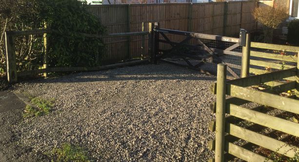

Ferdinand Posted January 23, 2017 Share Posted January 23, 2017 (edited) Here's one I prepared last week. An example of a couple of types I talked about above. 1 - Knocked in posts and fence panels on their third use, 2 - fairly dense ranch-style fencing, 3 - post and rail with 2 rails and wire dog-mesh plus strainer wires. 2 and 3 have been in 5 years. 1 went in last Thursday. The one in the background is the same length run as yours and took 2 of us a short morning. A detail of attaching panels to knocked in posts - alternating side to allow space to attach to the post and to allow a little adjustment. I would strongly argue against postcreteing in wooden posts, as they will rot more quickly and the stuff will be a pain to get out, and an even bigger pain to repair when a single post goes - you will have to dismantle it and dig out the concrete, or insert a repair spur and use a big block to bridge the concrete plus bolt right through. Either knock in wooden posts like a farmer or postcrete in something concrete that will outlast your friend. From the conversation, I think for the security aspect you perhaps want a properly done 2m paid-for fence (prob £700 or so), and then add trellis to the top after a couple of months and perhaps some pyracanthas on the inside side. Also, anything horizontal will provide footholds. F Edited January 23, 2017 by Ferdinand Link to comment Share on other sites More sharing options...
