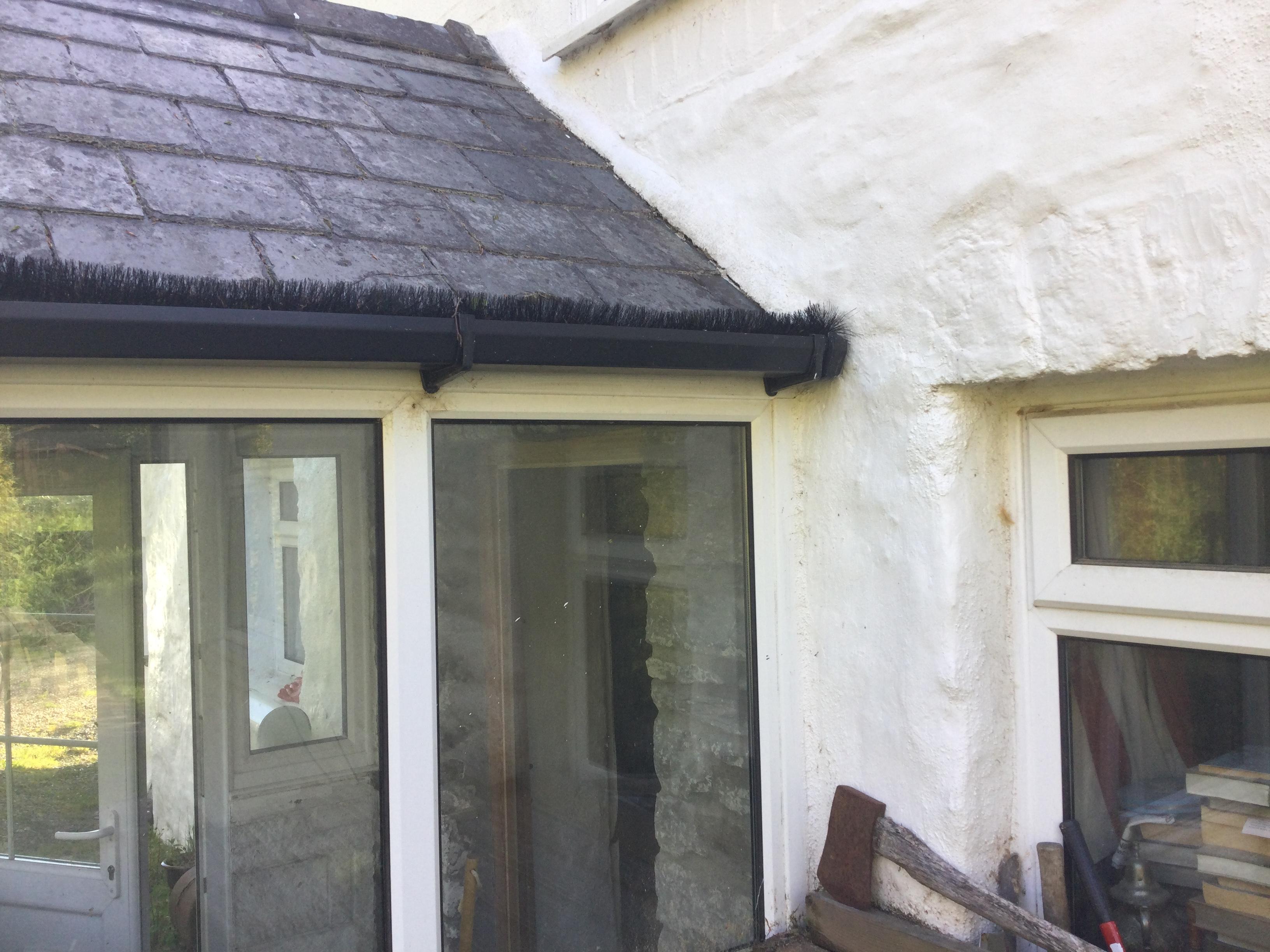

zoothorn Posted May 23, 2021 Author Share Posted May 23, 2021 20 hours ago, jfb said: Filler like that never looks quite right. I tend to fill with mortar instead. not sure about the damp. Do you have a picture from the outside? Hi jfb, yes should've filled with mortar. Live & learn. Anyway a pic of porch outside Link to comment Share on other sites More sharing options...

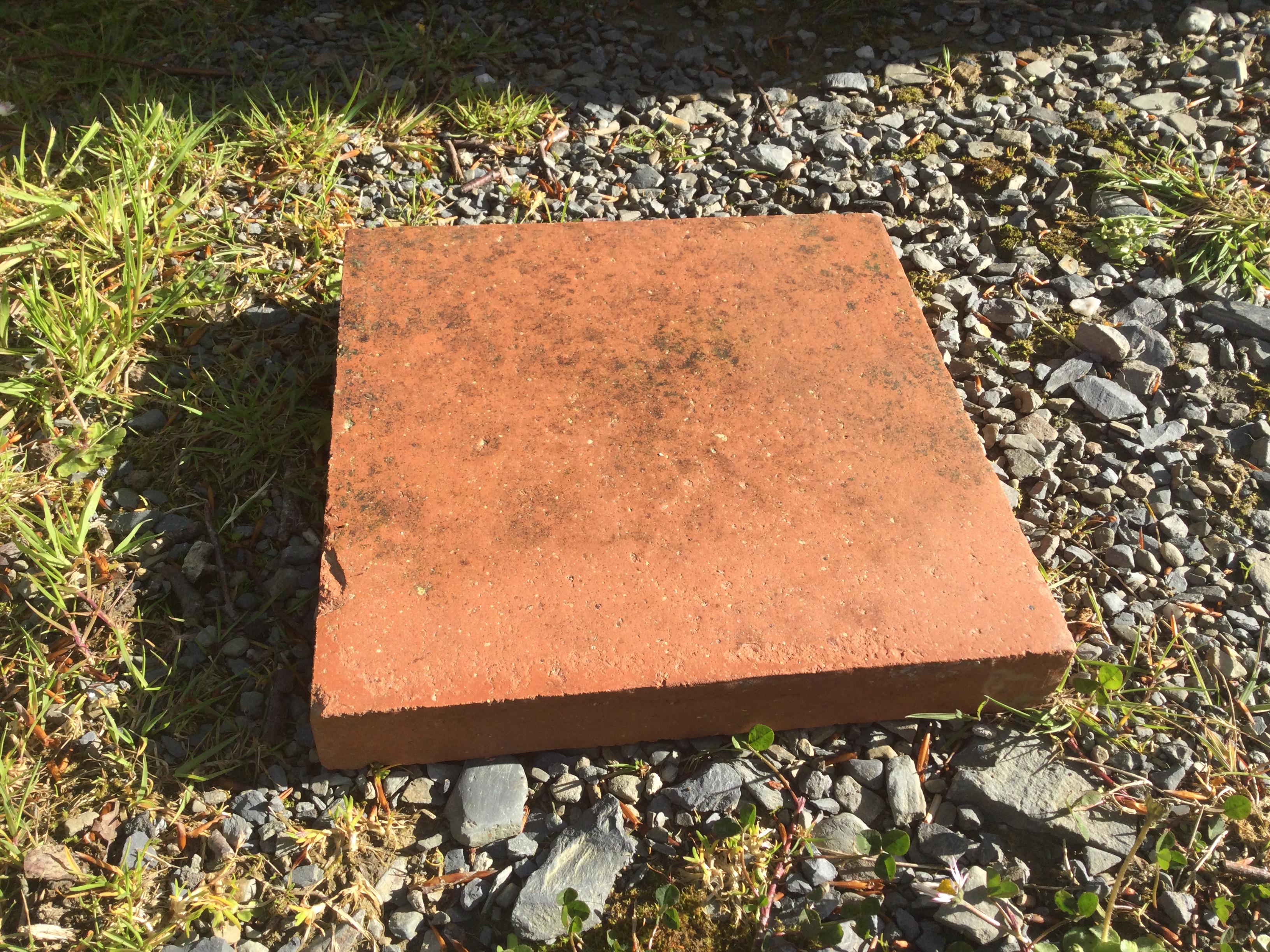

zoothorn Posted May 23, 2021 Author Share Posted May 23, 2021 4 hours ago, newhome said: They even make them new like this to get the rustic look. https://www.pavingandflooring.com/old-welsh-quarry-tiles Hi there newhome, those do look nice and clean though.. a third of mine are like so (this is scrubbed really hard ) which just look 'dirty' & many big gouged chips too: Link to comment Share on other sites More sharing options...
Onoff Posted May 23, 2021 Share Posted May 23, 2021 (edited) Try soaking a tile in hot water and a little washing powder. Give it a scrub to work it in then leave. Might lift the dirt. Rinse well. You could probably stick them in the dishwasher...if you have one. I turned down a freebie, working one the other day... Edited May 23, 2021 by Onoff Link to comment Share on other sites More sharing options...
newhome Posted May 23, 2021 Share Posted May 23, 2021 59 minutes ago, Onoff said: Try soaking a tile in hot water and a little washing powder. Give it a scrub to work it in then leave. Might lift the dirt. Rinse well. You could probably stick them in the dishwasher Make sure that the washing powder is biological. I don’t recall a dishwasher in Zoot’s kitchen refurb ?. You can use dishwasher powder in hot water though. If that doesn’t work then maybe try something more abrasive. Link to comment Share on other sites More sharing options...
jfb Posted May 23, 2021 Share Posted May 23, 2021 I really wouldn’t worry about trying to get the tiles pristine - character it is callled! regarding the damp it is a bit hard to tell but possible that water is getting in under the mortar flashing (white in the picture) where the porch roof meets the wall. You can just see some gaps under the mortar I think. Link to comment Share on other sites More sharing options...
zoothorn Posted May 23, 2021 Author Share Posted May 23, 2021 3 hours ago, Onoff said: Try soaking a tile in hot water and a little washing powder. Give it a scrub to work it in then leave. Might lift the dirt. Rinse well. You could probably stick them in the dishwasher...if you have one. I turned down a freebie, working one the other day... Its already been done this one (concreted edges before, gunked top) in hot soapy water & jif in.. chipped off crap then galv scourer scrub the feck outta 50 of them. I think they'll have to do like this, as Joe says, it seems actually in the fired tile this black 'mouldy' looking thing. Dishwasher? Fat chance. I dont think theyve come out here yet. Link to comment Share on other sites More sharing options...
zoothorn Posted May 23, 2021 Author Share Posted May 23, 2021 41 minutes ago, jfb said: I really wouldn’t worry about trying to get the tiles pristine - character it is callled! regarding the damp it is a bit hard to tell but possible that water is getting in under the mortar flashing (white in the picture) where the porch roof meets the wall. You can just see some gaps under the mortar I think. Hi jfb.. I think you must be right yes that has to be where its getting in. Rain was slanting into this side of house for 2 days. Its the only gap, i took gutter off & no obvious entry point underneath. Fill with a thick doing of white exterior silicone stuff? Link to comment Share on other sites More sharing options...
jfb Posted May 23, 2021 Share Posted May 23, 2021 17 minutes ago, zoothorn said: Fill with a thick doing of white exterior silicone stuff? Should be ok. Or a bit of mortar. check there is no way for water to get in at the top of the mortar as well as the bottom. Link to comment Share on other sites More sharing options...
zoothorn Posted May 23, 2021 Author Share Posted May 23, 2021 1 hour ago, jfb said: Should be ok. Or a bit of mortar. check there is no way for water to get in at the top of the mortar as well as the bottom. So mortar adhering to the tiles is ok? i was thinking silicone as it would be easier to get off tiles, if ever need to. Link to comment Share on other sites More sharing options...

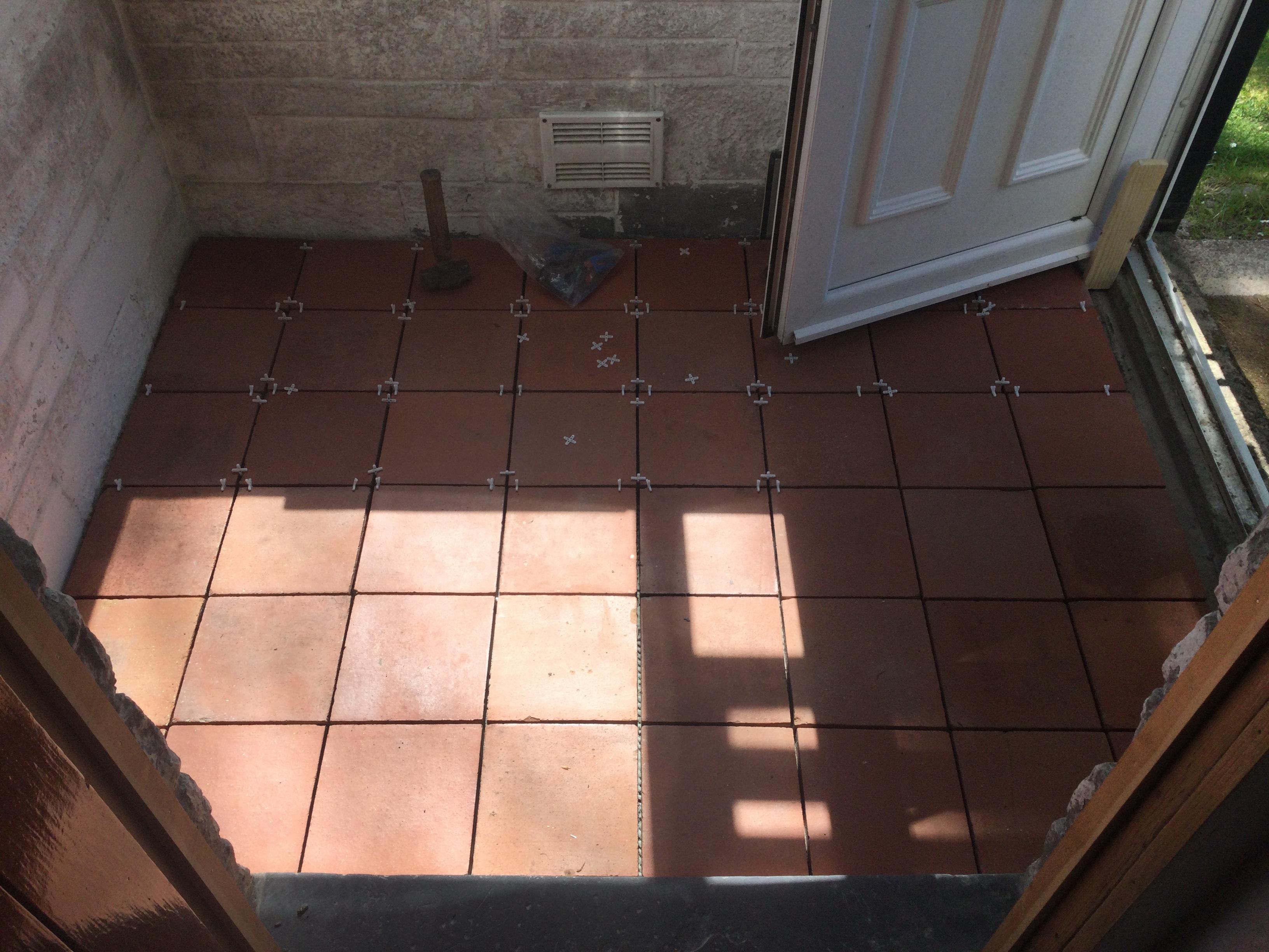

zoothorn Posted May 27, 2021 Author Share Posted May 27, 2021 On 23/05/2021 at 15:21, jfb said: Should be ok. Or a bit of mortar. check there is no way for water to get in at the top of the mortar as well as the bottom. (This post not addressed to jfb, i just cant remove the quoted post above.. again!). Turned out great so far, good few uneven corners, chips.. & the last gap bit 2" or so adjacent to door Ive 2 tiles for/ cut when i can. But way better than expected. The gap nr door area gets wet here, from door drips also rain getting thru under thru door sill somehow.. so ideally done asap. Or just mortar this gap? It'll have a matt on covering most if it. No adhesive left tho you see.. just enough to do job! V. Lucky. thanks zoot. 2 Link to comment Share on other sites More sharing options...
PeterW Posted May 27, 2021 Share Posted May 27, 2021 That looks proper tidy ..!! Well done ..!! Clean it and seal it and then grout it. Link to comment Share on other sites More sharing options...
zoothorn Posted May 27, 2021 Author Share Posted May 27, 2021 1 hour ago, PeterW said: That looks proper tidy ..!! Well done ..!! Clean it and seal it and then grout it. Hi Peter- that's as clean as they go! I'll do the Mattstone tile sealer stuff once grouted.. I used on my bathroom tiles & no issue with the grout lines: it makes the job alot easier, I think (it might make the grout not stick in the gaps is my thinking). Pretty fluky getting front/ back 6 tiles almost perfectly in- there's a 3/4" gap at back, 1/2" gap to front where slate step is, I guess just do a neat mortar job in both to fill, rather than grout? Link to comment Share on other sites More sharing options...
PeterW Posted May 27, 2021 Share Posted May 27, 2021 Grout will do in both and the Mattstone won’t stop grout sticking to the gaps but will keep the tiles cleaner when you do grout. Link to comment Share on other sites More sharing options...
zoothorn Posted May 27, 2021 Author Share Posted May 27, 2021 3 minutes ago, PeterW said: Grout will do in both and the Mattstone won’t stop grout sticking to the gaps but will keep the tiles cleaner when you do grout. Ok will do that next then before grout. Might be able to get my 250 mls left to last longer this way! Pricey stuff. thanks zh Link to comment Share on other sites More sharing options...
PeterW Posted May 27, 2021 Share Posted May 27, 2021 1 hour ago, zoothorn said: Ok will do that next then before grout. Might be able to get my 250 mls left to last longer this way! Pricey stuff. thanks zh 250ml will go a long way if you make a pad with something like an old piece of tea towel over a small sponge. Wrap over and dip it in a dish of the stuff; squeeze excess and wipe over, it won’t use that much. Link to comment Share on other sites More sharing options...
