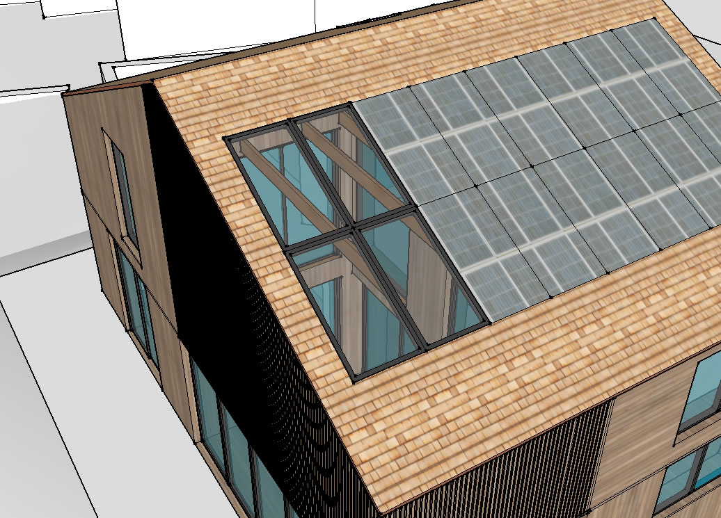

ToughButterCup Posted January 22, 2017 Posted January 22, 2017 We plan to have about 5 square meters of roof light. It's above our Winter Garden. (1720 by 3200) On a partially protected South West face The darkish area below the roof is an open, barn-style set of baffles. ... I'm thinking about our equinoxial gales, and the occasional hoolie. The area to the right of the glazing is meant to represent solar PV I'm wondering whether polycarbonate is the best choice? Or maybe 4 toughened glass sheets? I have no experience of polycarbonate at all. I've looked at too many videos. I'm all over the place and wonder what your experience is? Ian

Nick Posted January 22, 2017 Posted January 22, 2017 You'll want to use glass. Polycarbonate has some useful properties but ultimately glass will look the part and weather far better. Its just a case of specifying the glass to be sufficiently strong and then looking at the implications for weight & cost. 4 toughened sheets wont help strength if that's your concern. You'll want thicker individual sheets to resist wind, gravity and (depending on pitch) snow loads. That span could even be done in one sheet but splitting it as you've done is the sensible way to go for cost. Off the very top of my head. It will need to meet a design wind load of at least 1.5kN/m2 in an open barn style structure though i could be mistaken. Your glazing supplier should be able to advise on this and help you specify the glass.

AliG Posted January 22, 2017 Posted January 22, 2017 (edited) lAs people have said glass is better than polycarbonate. Also i would specify 3G roof lights, it makes a considerable difference to the amount of noise you will get when rain hits the roof, otherwise it will be very noisy on there. Plus heat is going to rise and leave via the roof so the more insulation the better. If you look at the spec on the velux site it shows the difference it makes depending on what kind of glass you use to both the U-Value and sound transmittance. These are the electric and manual roof windows if you want an idea of sizes and prices. https://www.roofingsuperstore.co.uk/browse/pitched-roof-windows/velux-roof-windows/centre-pivot/white-painted-electric/triple-glazed-206621u.htm https://www.roofingsuperstore.co.uk/browse/pitched-roof-windows/velux-roof-windows/centre-pivot/white-painted-manual/triple-glazed-2066.html Edited January 22, 2017 by AliG
PeterW Posted January 22, 2017 Posted January 22, 2017 3 hours ago, recoveringacademic said: The darkish area below the roof is an open, barn-style set of baffles Do you mean hit and miss..?? So the wind will be able to blow through them..?? If so, then a single 6.4mm laminated sheet would be fine - either in 2 parallel panels (so you don't need to sort out how water runs over the mullion) or use 4 and overlap the top to the bottom by 75mm with a gap over the mullion bar. If its an unheated space then seems pointless having DG or TG. Other thing to consider is cleaning as I'm sure @MrsRA will want it on your weekly list of things to clean so you may want to get self cleaning glass or use something like Rain-X on both sides to stop it getting too mucky

ToughButterCup Posted January 22, 2017 Author Posted January 22, 2017 Hmmmm, 5 hours ago, PeterW said: [...] So the wind will be able to blow through them.. If so, then a single 6.4mm laminated sheet would be fine - either in 2 parallel panels (so you don't need to sort out how water runs over the mullion) or use 4 and overlap the top to the bottom by 75mm with a gap over the mullion bar. Other thing to consider is cleaning [...] Yes, the wind will circulate. No need for 2 or 3g Why the top to bottom overlap, Pete? I cleaned windows for seven years to pay my way round my first degree. Should be fun doing the insides at that height. Ian
PeterW Posted January 22, 2017 Posted January 22, 2017 2 minutes ago, recoveringacademic said: Why the top to bottom overlap, Pete? Classic old greenhouse thing - beaver tail glass from one pane to the next and then the water runs down the middle of the panes and doesn't rot the glazing bars. Lower glass rests on a mullion and the upper straight on the glass below. In a modern set up if you have anything stopping water flowing down freely then it will find a way through the joint or you need some way of making a gutter to go round the lower pane.
