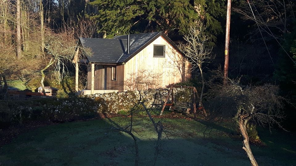

Triassic Posted January 22, 2017 Author Share Posted January 22, 2017 (edited) Because access is so poor to our plot we went for a self built cabin at the bottom of the garden, rather than a caravan. This is where we'll be living during the build. Not sure what council bracket it'll be in, no doubt we'll find out soon enough. Hopefully the bin man will still take our rubbish away. Edited January 22, 2017 by Triassic Link to comment Share on other sites More sharing options...
