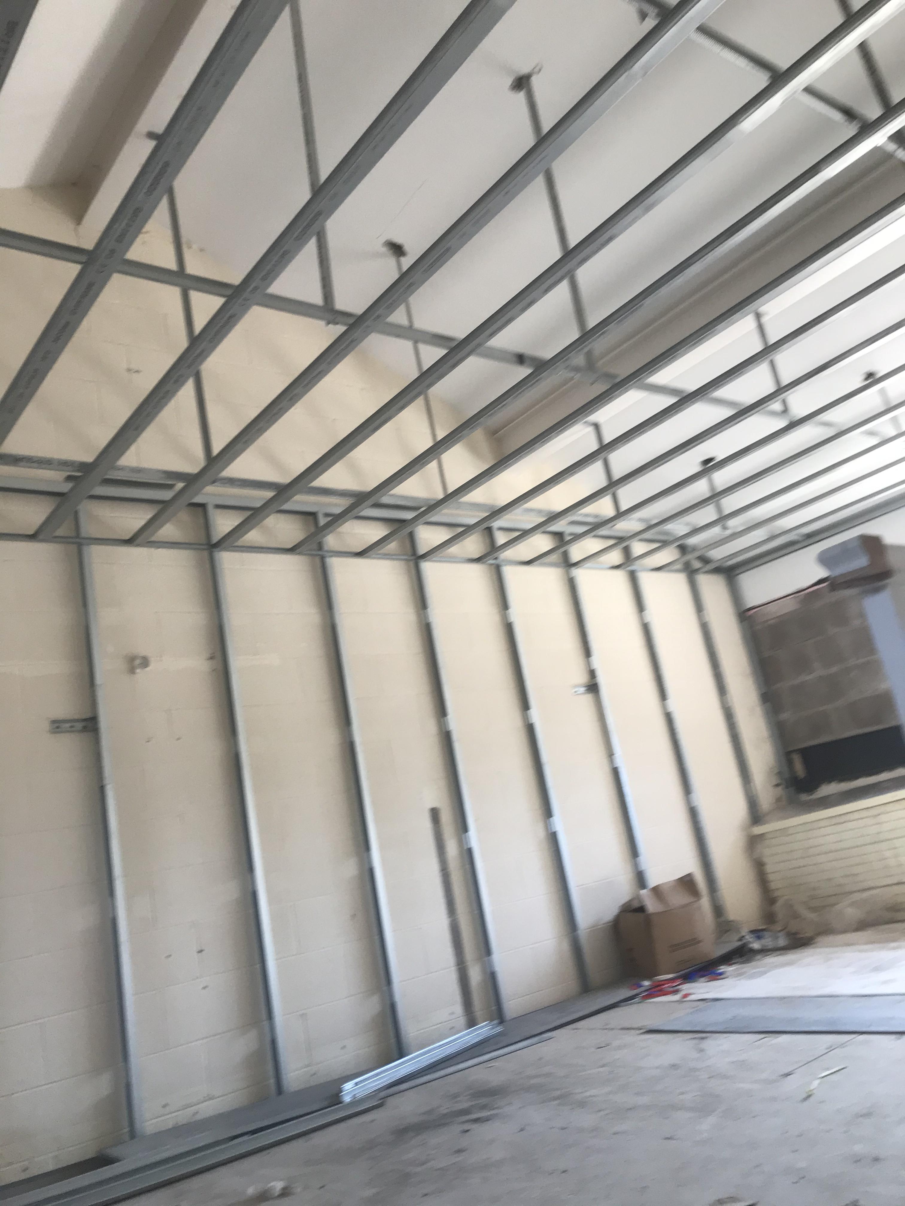

LSB Posted November 13, 2020 Posted November 13, 2020 Please can someone explain to me. I'm trying to get my head around internal insulation, plasterboards, plastering, skimming and painting for walls. I've been researching, but not getting far. So, I have block walls which I need to internally insulate and then get ready for painting. I've read about insulated plasterboard, but hear it's expensive. then there is insulation with plasterboard on top. Then, some research says you can paint straight onto plasterboard, but what about the joins, even when they are tapes, how would that ever be smooth, knowing that I'm painting not wallpapering. The what about plastering versus skimming, is it simply that one is thicker than the other. It seems to be that the more I look the more confused I become. The plan for the floors and ceiling is SuperFOIL SFUF as we are very limited in height and this insulation is very thin. TIA

OldSpot Posted November 13, 2020 Posted November 13, 2020 Hi LSB, I'd second what PeterW says about the superfoil in floors! Yep the manufacturer will tell you it can be done and granted it'll give you a bit of insulation but it won't be effective. Back to your original question(s)... Presumably you don't have an insulated cavity wall if you are considering IWI (internal Wall Insulation)? You can attach plasterboard to your block wall in various different ways. The two most common are: "Dot and Dab": This is where you use adhesive and put a number of lumps on the back of the board and then stick it to the wall. Battens: Screw battens to the block work and then screw the plasterboard to the battens. Using this method you can more easily insulate between the battens and then also attach a layer over the top. Either as an individual layer or using insulated plasterboard. You do also need to incorporate a vapour barrier. Alternatively, you can plaster the block work. Firstly with something like Thistle Hardwall or Thistle Bonding (depending on what the blocks are) as an undercoat and then a second (finish) coat is applied such as Thistle MultiFinish. If you use the plasterboard method, you can tape the joints on the plasterboard (tapered edge board not square edge) you then use a jointing compound and sand it down to get it smooth. See here. Or, you can apply a skim coat of plaster. The skim coat will give you a much better finish but does cost more.

Russell griffiths Posted November 13, 2020 Posted November 13, 2020 I think you need to do a section drawing of the whole structure, so people can understand where and how to install insulation. You could also do a drawing or pictures of the wall build up. Its just not a case of slapping some insulation on your walls it’s all to do with what you have know versus what you need to achieve.
Dave Jones Posted November 13, 2020 Posted November 13, 2020 ah ok. id definitely be digging down to get some height for starters. Assume you are removing all the external tin and replacing so will be able to make a cavity to fill with insulation. Are you having a blockwork inner skin or going for studwork ?
