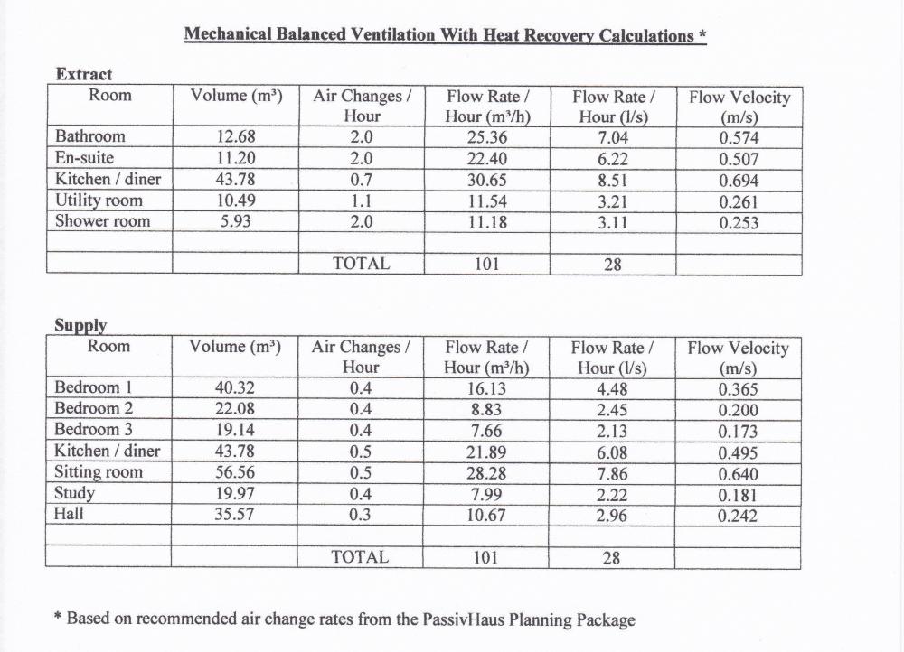

November 12, 20206 yr Me again, this time I've got some basic questions about MVHR... We have an Airflow Adroit DV96 MVHR unit (one of the earlier units without onboard CO2 sensing), with radial distribution using Airflex Pro ducting. We have a CO2 monitor in the main bedroom (unfortunately, it's not a sender for the MVHR unit) and I know there are certain levels at which the unit will show a green, amber or red light, though I'm not quite sure at what levels it would change from one to the other... With the MVHR unit on the standard setting (running at 75% of max power), we were getting the of 1300+ PPM as the maximum. I've set the unit to run the boost profile a number of times during the night, to compensate for the fact it can't increase air flow automatically (lack of CO2 sensing capability), and we're still going up to around 1100 PPM... My question is: what sort of CO2 levels can you reasonably expect to see overnight in a bedroom with properly functioning MVHR?

November 13, 20206 yr Author @ProDave re the high background ventilation rate, you're right - the boost profile would normally increase extraction by 30%, which means it should boost at 105%, so it's not extracting right. I've spoken to Airflow, who told me you should get 20% extra air flow at the terminals, but as it stands, we're measuring 13% extra on the boost profile in the bedroom. We've measured the flow rate there, it's 24.6 background and 28 boosted. The calculations for the spec of the system shows 30 background and 28 boosted...
November 13, 20206 yr 14 hours ago, MarcelHoldinga said: They have, but I'm not too sure that they were set up right. The guy doing it can't have spent more than about an hour and a half on the whole house (4x supply and 4x extract valves) - I;ve read on another blog that it could take the best part of a day to get it right... I suspect it was windy when they set it up, 'cos I've noticed that if it blows a hoolie, the levels stay low (in the 400s while we're asleep). I'm hopefully able to borrow an anemometer off the company who installed it, so I can double check the rates and (hopefully) adjust them. The installers only installed the system, they didn't supply or design it... It took us all day to set up our system. It isn't possible to set it up accurately if it's windy outside. I've never checked the CO2 levels but the humidity never increases for long before going back down to normal levels and our system has stayed at setting 2, out of four, for the last 2.5 years.
November 13, 20206 yr Author 9 hours ago, MarcelHoldinga said: We've measured the flow rate there, it's 24.6 background and 28 boosted. The calculations for the spec of the system shows 30 background and 28 boosted... that second 28 boosted should have read 36 cu m/h boosted... missed the edit window - ?

November 15, 20206 yr Author Thanks for that information, @DundeeDancer and @PeterStarck. I've been able to borrow an airflow meter off the installers. I did some measurements on Friday night and got the figures in the attached image. These are values at on the background extraction level (called At Home on our unit), with supply and extract fans both running 75%. The Specified column shows what was specified by Airflow at the design stage of the system, Actual is what I measured on Friday night. From reading @Jeremy Harris's post in Balancing MVHR - how to? by @readiescards (below), I noticed that the levels we have set as background extraction are quite close to the extraction levels you would expect at on boost... No wonder that the guy who installed it had remarked that he had to put the fans up to 75% to get the right flow rates... I'm beginning to suspec that we're working out unit too hard... Speaking to Airflow themselves, I learned that the boost supply and extract levels should be around 20% more at the valves than you would have on At Home.... Would it be right to assume that the system's been set up the wrong way around? From Jeremy's post, you start from Boost, and then work your way down to background levels, but the manual to our unit tells you to set the background level, and the unit then automatically increases the fans' output by 30% (e.g. At Home is set to 50%, the unit would automatically set Boost to 80%) Edited November 15, 20206 yr by MarcelHoldinga pressed post again before I was done...
November 15, 20206 yr 50 minutes ago, MarcelHoldinga said: Would it be right to assume that the system's been set up the wrong way around? I wouldn't say so. I set up ours starting with the level 2, which is 'at home', and getting it all balanced for that and then there is boost, level 4, which is 100%. Level three is set halfway between 2 and 4 and level 1, which is unoccupied, is set halfway between zero and level 2. Our system has run automatically, without a humidistat, for 2.5 years 24/7 on level 2. Our system has a built in EASHP which warms the air if required and, if running, that increases the speed to level 4 for around 15 seconds and then modulates down and varies the speed to what is required to provide the desired volume of air to maintain house temperature.
