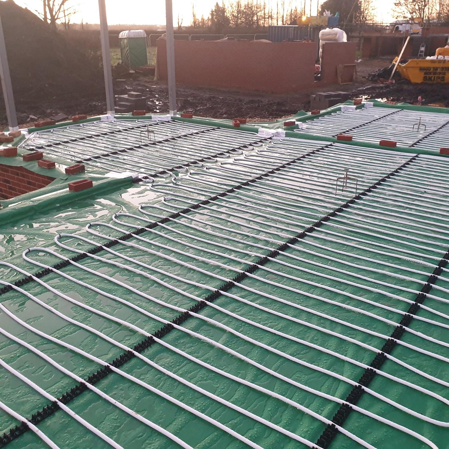

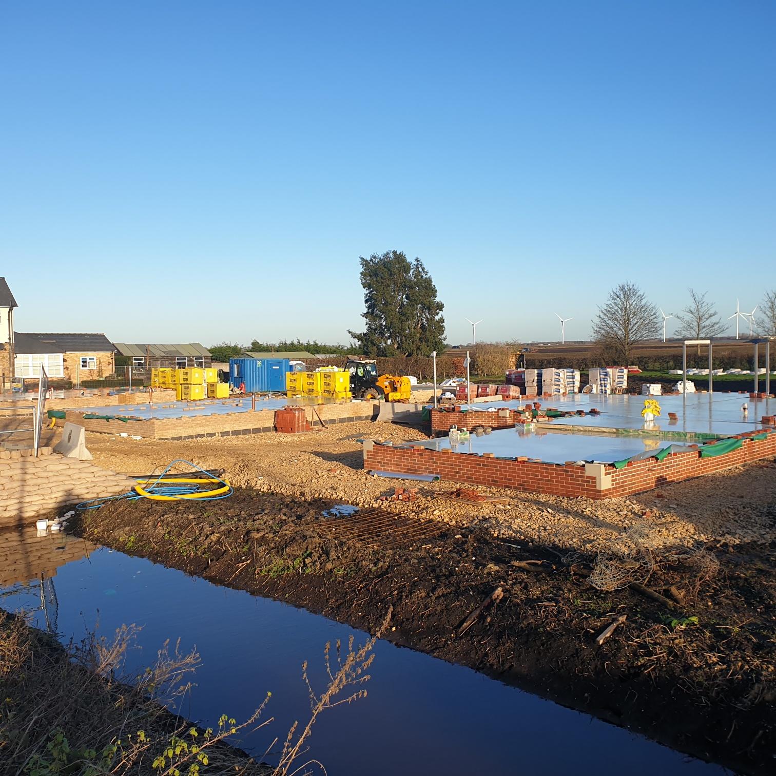

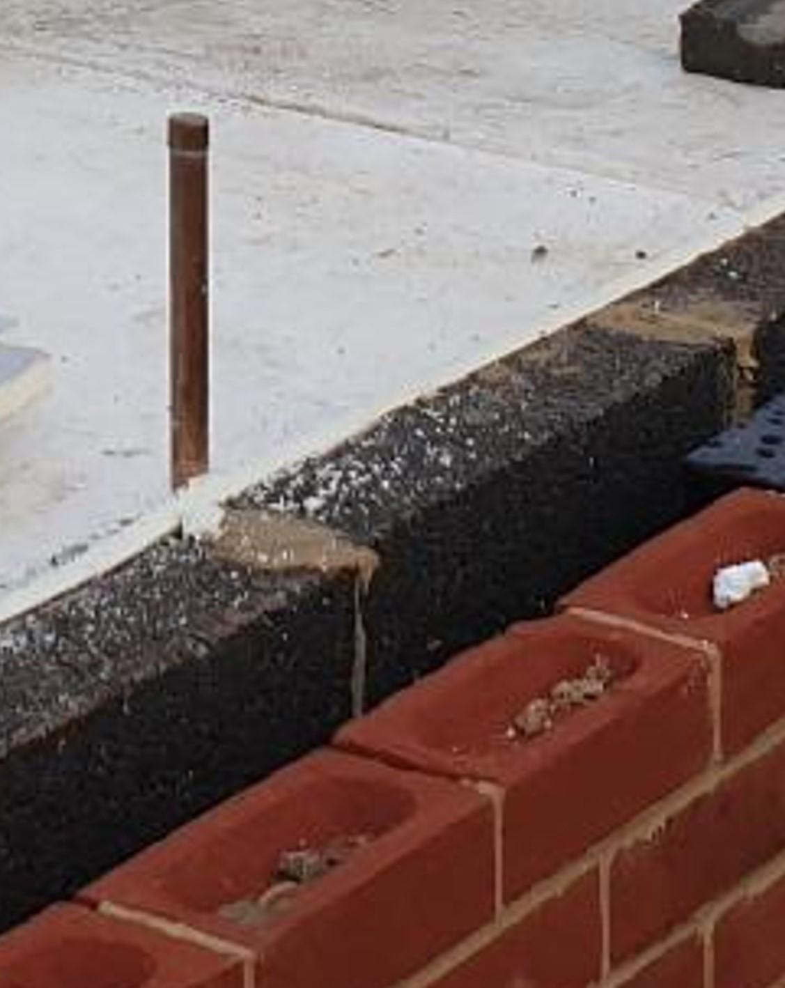

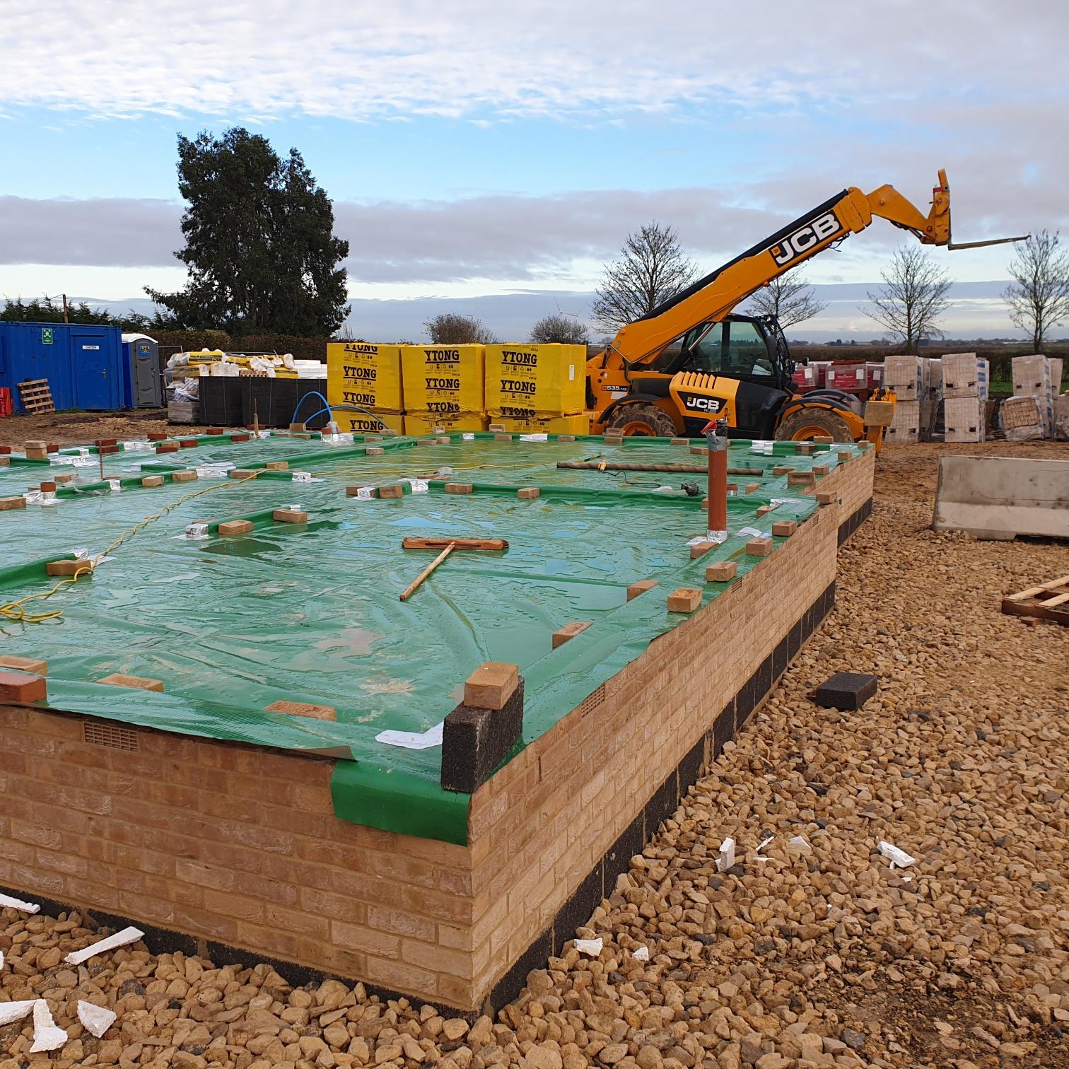

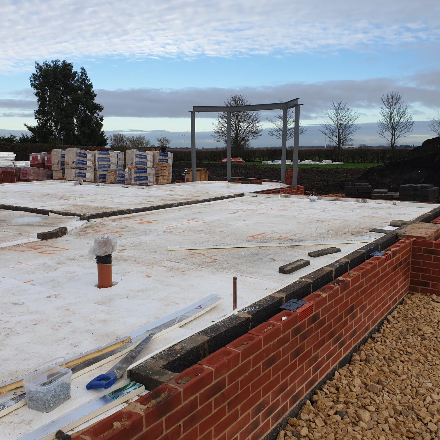

Faz Posted December 12, 2020 Author Share Posted December 12, 2020 Just by way of an update, we are up to splash on all 3 and the gas membrane is now completed throughout (final plot completed yesterday after I took the photo). UFH on Monday and concrete screed Thursday. Need to spread out the A142 mesh for the garages prior to Thursday and then a day back before Christmas to get the foot scaffold in and that wraps me up until 2021 - happy days! 1 Link to comment Share on other sites More sharing options...
PeterW Posted December 12, 2020 Share Posted December 12, 2020 Clean and tidy brickwork there ! What is the copper (??) pipe in the last photo ..? Link to comment Share on other sites More sharing options...
Onoff Posted December 12, 2020 Share Posted December 12, 2020 10 minutes ago, PeterW said: Clean and tidy brickwork there ! What is the copper (??) pipe in the last photo ..? Broom handle? ? Link to comment Share on other sites More sharing options...
wozza Posted December 12, 2020 Share Posted December 12, 2020 Definitely looks like a copper pipe capped off. And that perp looks half empty. Link to comment Share on other sites More sharing options...
Brickie Posted December 13, 2020 Share Posted December 13, 2020 Lot of underbuild on that splash-are your ground levels varying much? Link to comment Share on other sites More sharing options...
Faz Posted December 19, 2020 Author Share Posted December 19, 2020 Hi all - sorry been on site all week and haven't had time to drop by here. The copper pipe is the gas pipe - runs underneath to poly top sheet and gas membrane. Brickie - you are spot on mate - there is going to be a lot of ground to make up. The issue we had is the planners insisting that FFL was 300mm above ground and then the next 300mm constructed using flood resilient construction. Our solution was to jack up the FFL to over 600mm above ground. Anyway - good progress this week - membrane completed, screeded and the blocking lift nearly complete - back on site tomorrow to finish off. 1 Link to comment Share on other sites More sharing options...

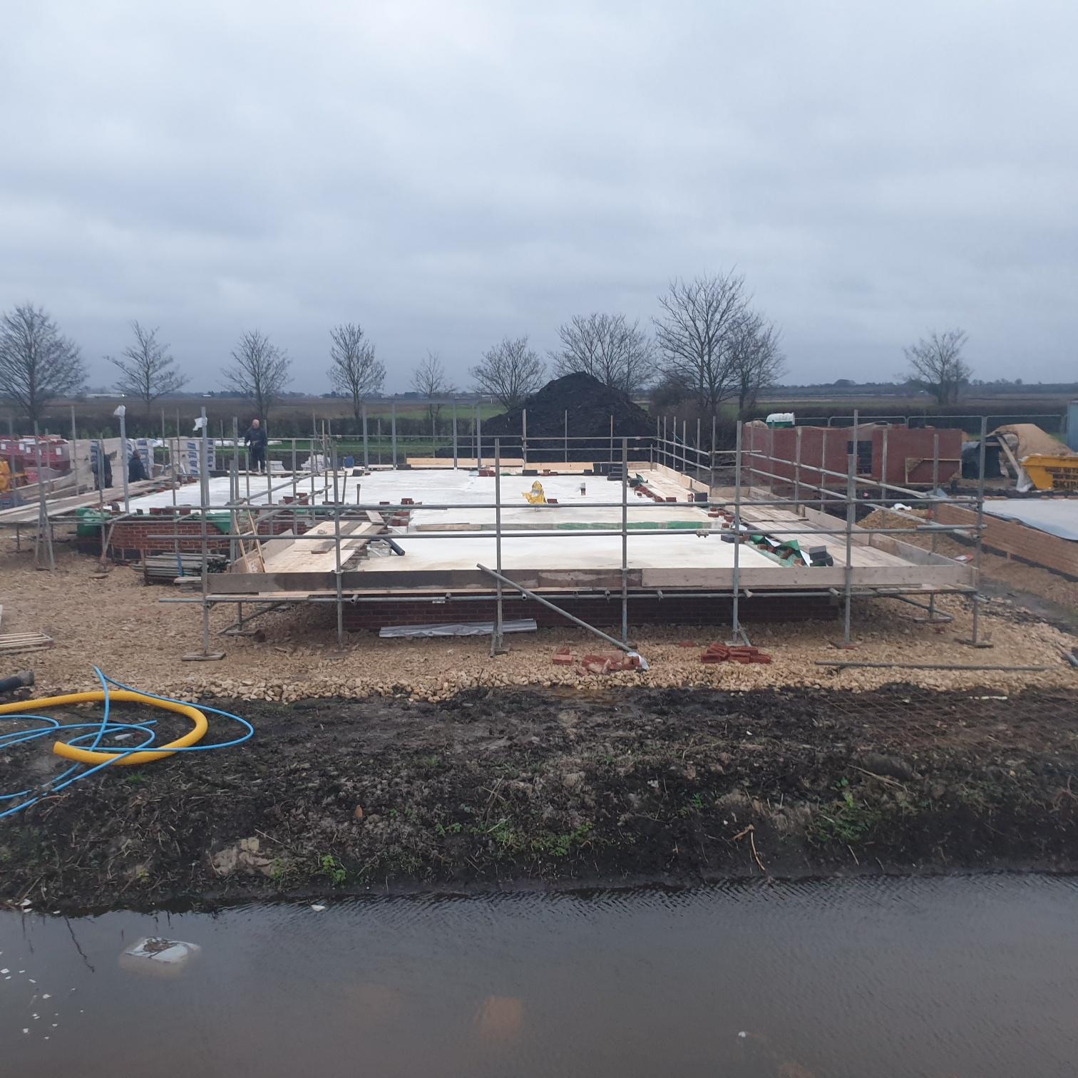

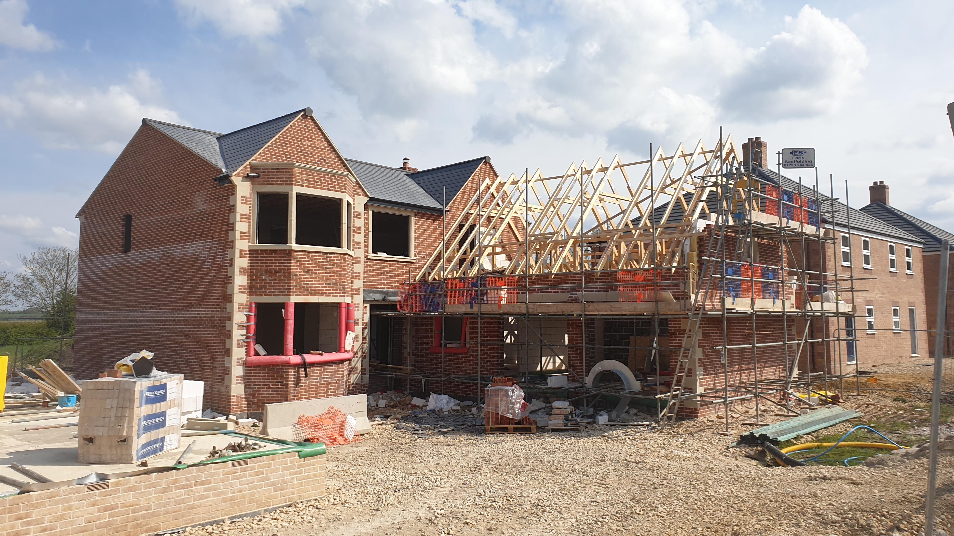

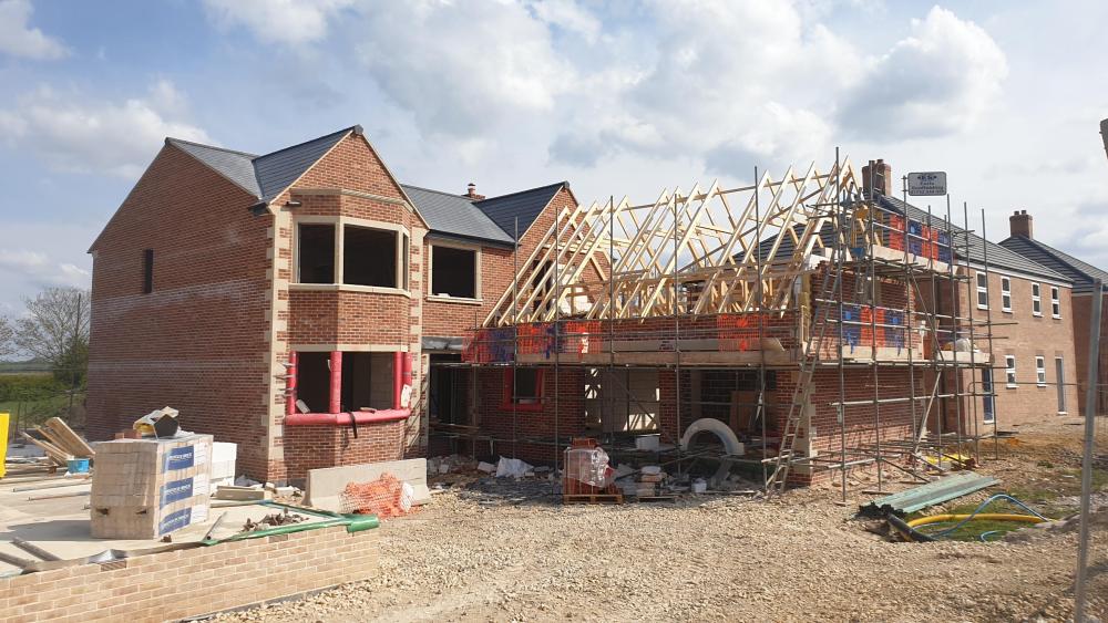

Faz Posted April 28, 2021 Author Share Posted April 28, 2021 Time flies - even through the winter. Anyway - nice to get the scaffold down. And what a terrible winter it has been to be standing in a field on the Fen! 2 Link to comment Share on other sites More sharing options...

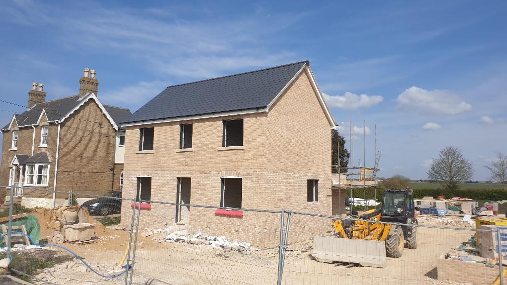

Faz Posted April 28, 2021 Author Share Posted April 28, 2021 And one of the ones to sell - looking pretty good to me. 1 Link to comment Share on other sites More sharing options...
Faz Posted April 28, 2021 Author Share Posted April 28, 2021 Actually it now doesn't with that low rez pic ? Link to comment Share on other sites More sharing options...

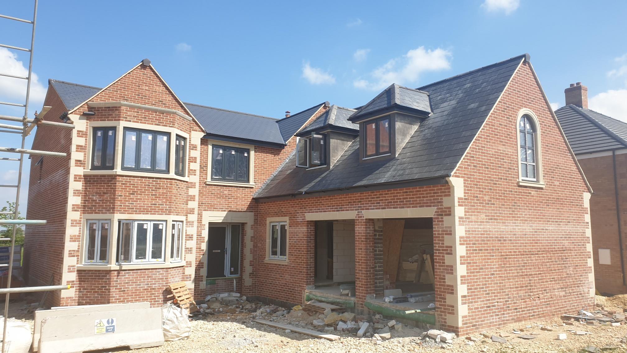

Faz Posted June 4, 2021 Author Share Posted June 4, 2021 Attic roof, dormers and windows complete. 1st fix Monday. Those Alu windows were seriously heavy with the glass in place - had to boom some in with the forks at the back over the scaffold - a bit hairy lifting a £1k slider 14m in the air! The full on transition from basically winter to the height of summer this week has taken it's toll on me and everyone else on site - it is a nightmare. 3 Link to comment Share on other sites More sharing options...
Oz07 Posted June 5, 2021 Share Posted June 5, 2021 Front step looks a bit high Link to comment Share on other sites More sharing options...
Faz Posted June 5, 2021 Author Share Posted June 5, 2021 Making up about 600mm of ground.... That is why I have let the crap pile up - its all going to end up buried anyway. Link to comment Share on other sites More sharing options...
