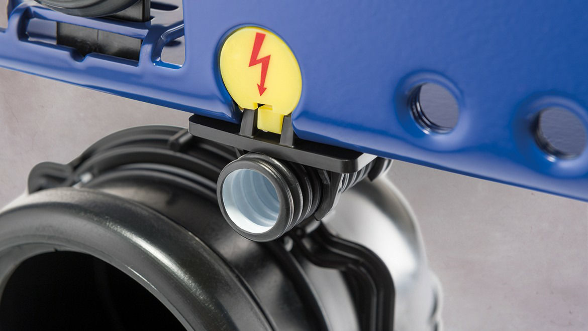

PeterW Posted November 22, 2020 Share Posted November 22, 2020 Geberit UP320 for £184 inc here Grohe Rapid SL 3 in 1 for £134 inc here Link to comment Share on other sites More sharing options...
Dan F Posted November 22, 2020 Share Posted November 22, 2020 10 minutes ago, PeterW said: Geberit UP320 for £184 inc here Grohe Rapid SL 3 in 1 for £134 inc here Thanks. Just got to work out if it makes sense to future proof now ?. Think a CAT6 just in case is probably overkill though!! haha Link to comment Share on other sites More sharing options...
