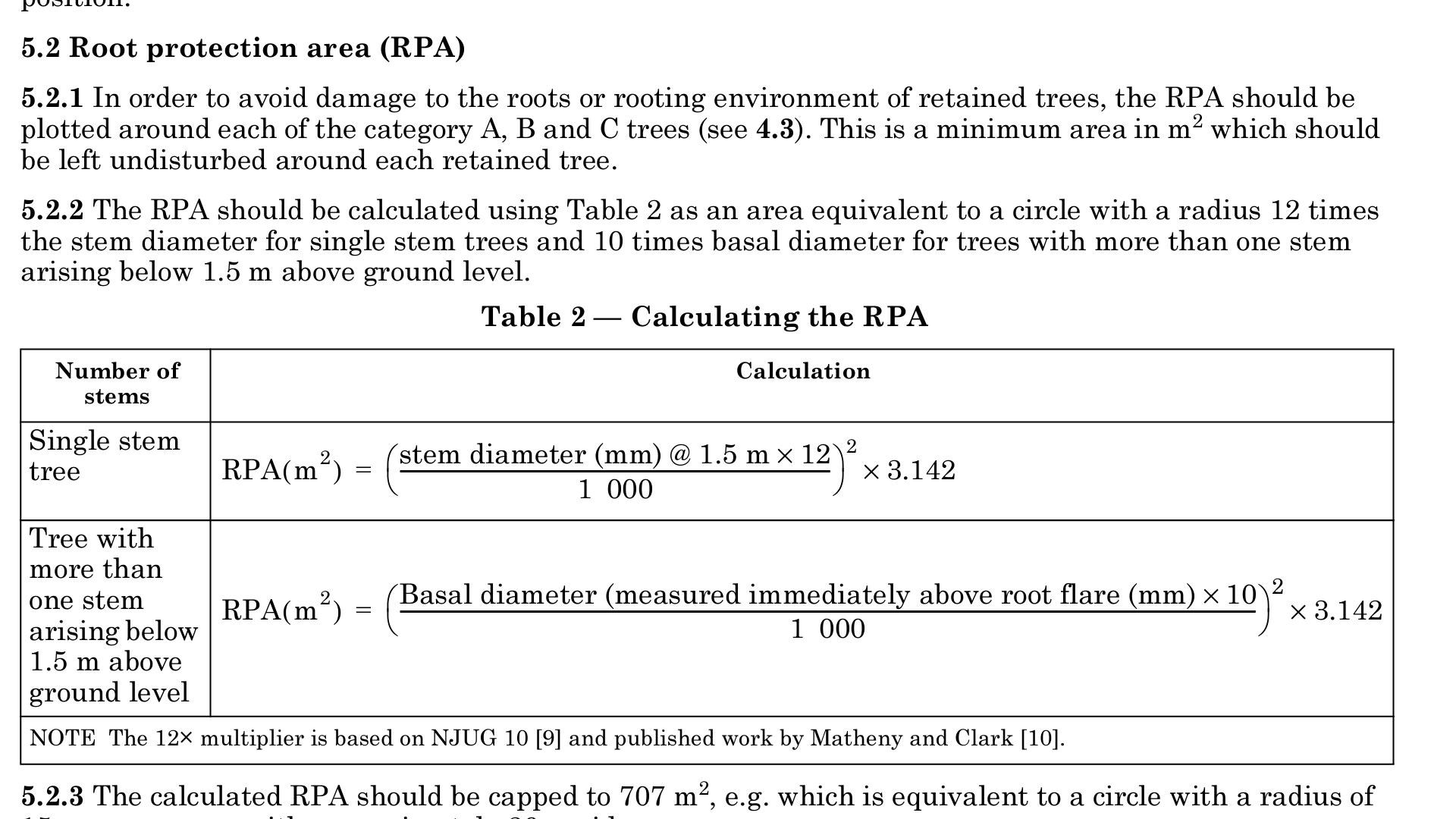

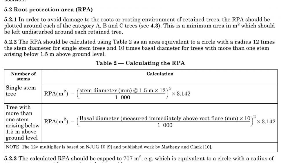

Moonshine Posted October 28, 2020 Share Posted October 28, 2020 (edited) Have a look at BS5387, this is found on line. The root protection zone extends to a circle of a radius 12 times the stem diameter. So if you have 10m space, you only have problems if the circumfrance of the tree 1.5m above the ground is 2.6m, which is a stem diameter of 0.83m. Basically you need to have bloody big trees to have an issue on your site Edited October 28, 2020 by Moonshine Link to comment Share on other sites More sharing options...
