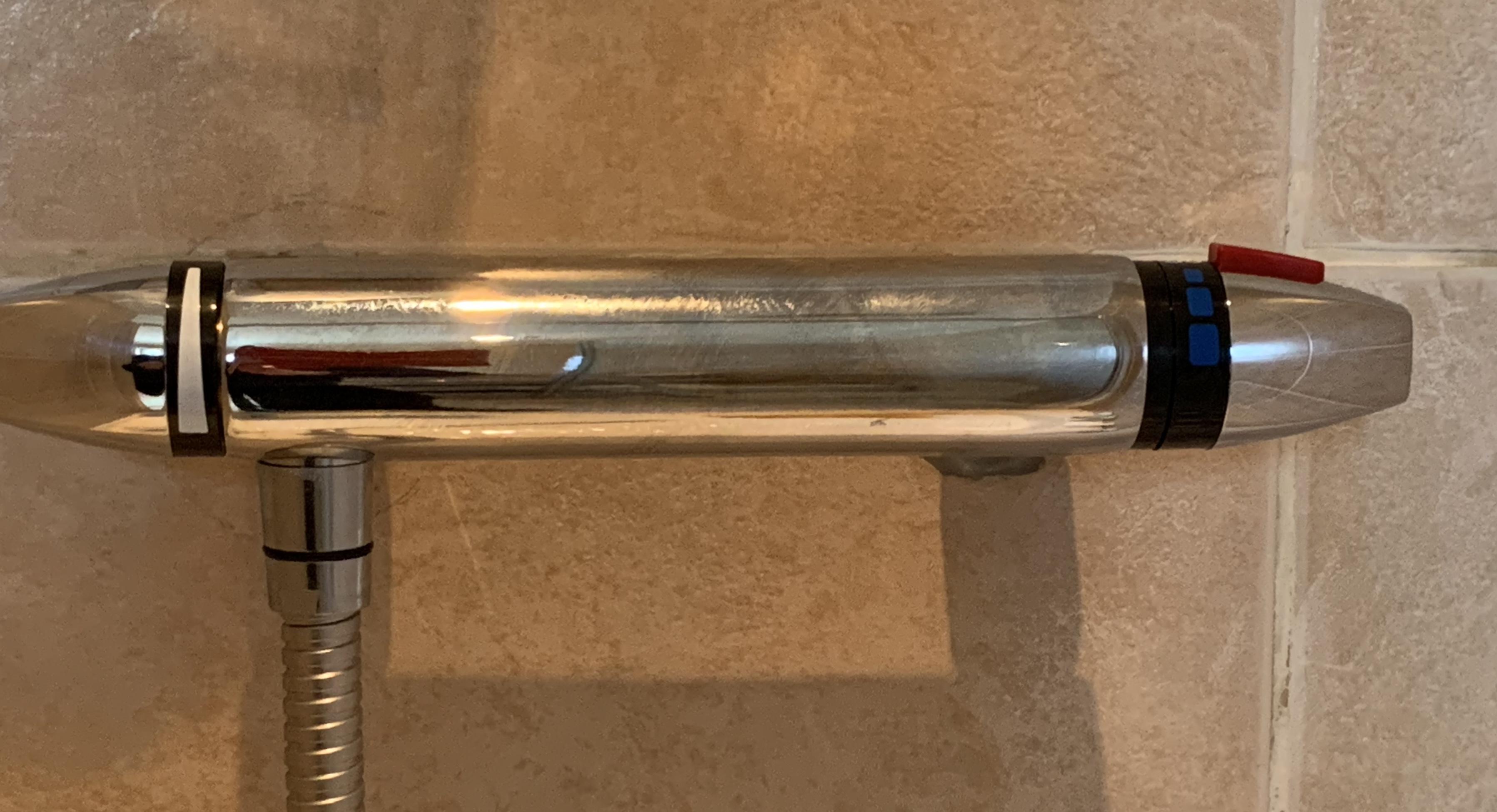

Nickfromwales Posted October 22, 2020 Share Posted October 22, 2020 Sorry I'm a bit late to this party @newhome, has been a bloody long day.... The rubber seals work well, but do NOT overtighten them Less is more here. Do not try to fully tighten one up before starting the other on the thread, so basically they need to be hand-tightened one turn at a time alternating sides until you cannot turn them by hand any more. Pinch them up with those grips / adjustable spanner, and when it becomes an effort to swing the spanner you are done. The spanner will not chew the chrome up as badly as the grips will. You can pinch it up as described and go turn on the water, see if it's 'all good in da hood', and if not just pinch and repeat until happy ( switch the water off each time so you're not fighting the tide ). Just turn the stopcock until you hear water flowing vs opening it fully for testing so if the shit hits the fan you have only allowed a trickle rate for damage limitation. Not much to go wrong here ( lol ) so should be job done and back on the Voddy's by noon 1 Link to comment Share on other sites More sharing options...

newhome Posted October 23, 2020 Author Share Posted October 23, 2020 All done ? (well it’s not leaking which I guess is a good sign ....) Had more trouble fitting the end controls than the bar itself. I couldn’t fit the trim bits as there wasn’t enough pipe exposed to screw it into with those fitted but I guess I can get some flatter ones later if I want to. Managed to do it easily with the gripper and a cloth. Will try it out properly later and see if it’s working ok. Thanks for all the help! Just one more question - do I need to turn the stopcock on until it doesn’t turn anymore? I’ve turned it on a lot but not as far as it will go. Link to comment Share on other sites More sharing options...

newhome Posted October 23, 2020 Author Share Posted October 23, 2020 Oh, and the fibre washer had disintegrated on that side hence the leak. 1 Link to comment Share on other sites More sharing options...
ProDave Posted October 23, 2020 Share Posted October 23, 2020 A bit surprised to see a fibre washer used, it's normally a rubber washer used there. Link to comment Share on other sites More sharing options...
newhome Posted October 23, 2020 Author Share Posted October 23, 2020 The new shower has a fibre washer too. A brown one. Link to comment Share on other sites More sharing options...

newhome Posted October 23, 2020 Author Share Posted October 23, 2020 37 minutes ago, joe90 said: well, I beg to differ, you did this didn’t you, small beginnings eh? Well there are a few more plumbing jobs that need to be done, although not urgent things leaking water, so maybe I’ll pluck up the courage to do some of them now .... ! I’ve used the shower to check it out and it all seems good although it’s fiercer than the old one. Not sure why that is. Link to comment Share on other sites More sharing options...
joe90 Posted October 23, 2020 Share Posted October 23, 2020 1 minute ago, newhome said: it’s fiercer than the old one. Not sure why that is. No two shower mixers are the same, also the old one may have “crud” In it. 1 Link to comment Share on other sites More sharing options...

Nickfromwales Posted October 24, 2020 Share Posted October 24, 2020 Original one was a cheapo-sack-o-shit, new one is a tidy Triton, hence the better flow rate. Adjust the shower head itself maybe for a spray vs jet ? The heads usually rotate to change settings ( the actual head where the water sprays from. 15 hours ago, newhome said: I’m bloody hopeless at anything practical. Above triumph says otherwise 2 Link to comment Share on other sites More sharing options...
