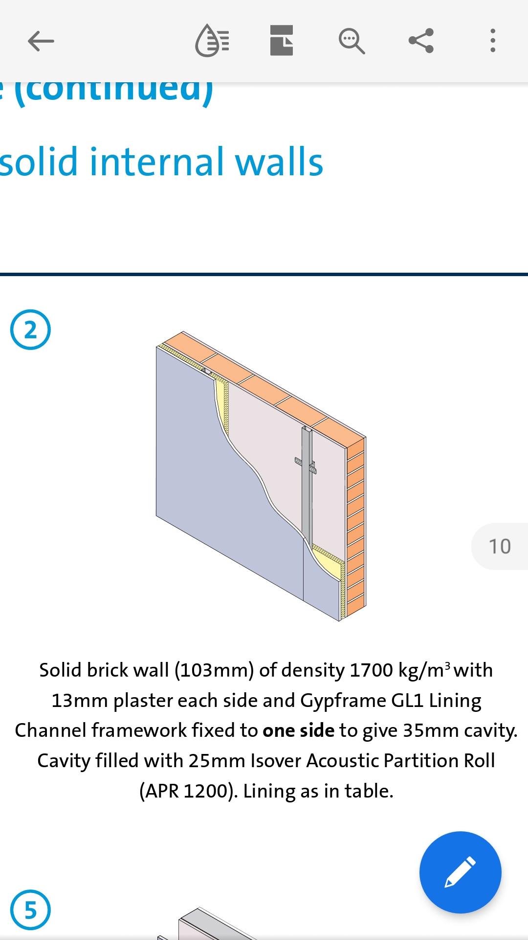

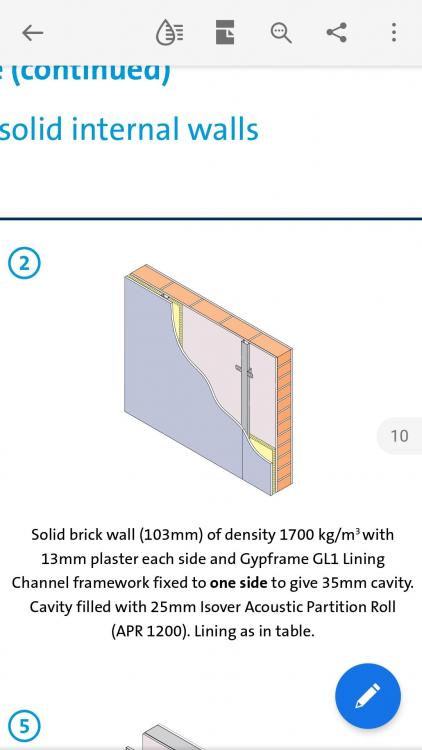

tanneja Posted October 31, 2020 Share Posted October 31, 2020 On 14/10/2020 at 05:33, Moonshine said: Have a look at the Gyplyner system, particularly system 226008, still a rigid connection but may get some looses to to flexible frame / brackets compared to direct timber fixing. https://www.british-gypsum.com/~/media/Files/British-Gypsum/White-Book/White-Book-C07-S04-Linings-GypLyner-Universal.pdf This system would lose you about 50mm with skimmed 12.5mm soundbloc. @Moonshine how do you get to that 50mm number please? Are you recommending the GL system comes off the wall by 35mm (with 25mm loose fit ARP in cavity) then 15mm soundbloc, or just 25mm cavity (filled with 25mm ARP) then do double 12.5mm soundbloc? Link to comment Share on other sites More sharing options...
Moonshine Posted October 31, 2020 Share Posted October 31, 2020 1 hour ago, tanneja said: @Moonshine how do you get to that 50mm number please? Are you recommending the GL system comes off the wall by 35mm (with 25mm loose fit ARP in cavity) then 15mm soundbloc This, from the link I provided. 1 Link to comment Share on other sites More sharing options...
tanneja Posted October 31, 2020 Share Posted October 31, 2020 1 hour ago, Moonshine said: This, from the link I provided. @Moonshine I offer my apologies for overlooking the dimensions in the PDF, thank you for taking the time to emphasise. I had read of others electing to double board with high density board, it seems best to assume that you would recommend follow as advised in the PDF. Link to comment Share on other sites More sharing options...
Moonshine Posted November 1, 2020 Share Posted November 1, 2020 9 hours ago, tanneja said: I had read of others electing to double board with high density board, it seems best to assume that you would recommend follow as advised in the PDF. If you can loose another 15mm of room space, double board would be better acoustically. Depend on what space is available. Increased cavity depth would also help Link to comment Share on other sites More sharing options...
