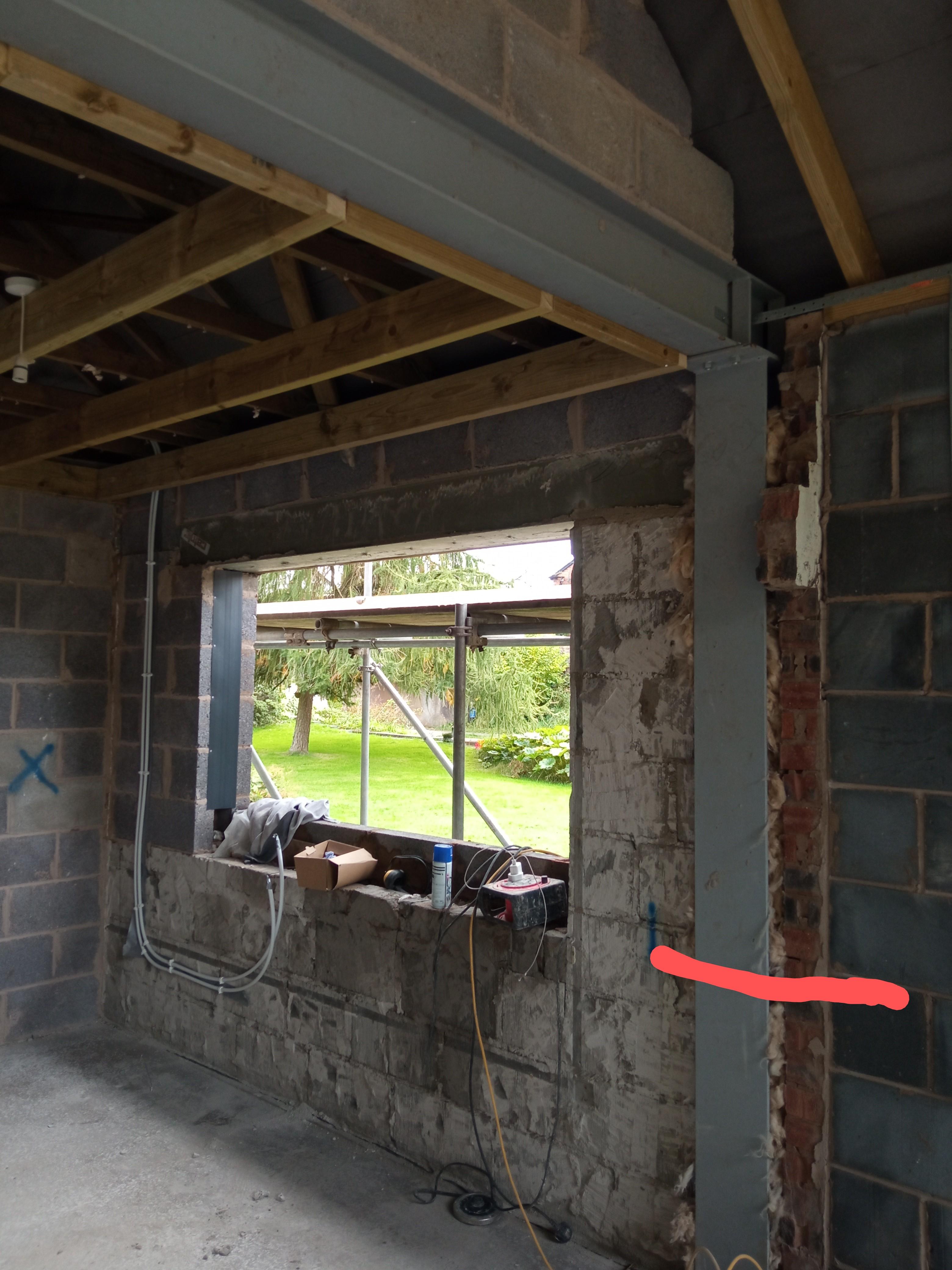

October 9, 20206 yr I need to make a decision quickly as our electrician is doing first fix. The bl00dy kitchen extraction. Don't want any, never used it, building regs say we have to. The main issue is our hob area is smack bang in between the flat ceiling and pitched extension (you won't see the beam). See where I've drawn that blue line and the start of the red one. That's where the worktop with the hob in it will start so if we had a ceiling one fitted info the flat ceiling part it wouldn't quite be directly over the hob. Option 2 is to just get something like this which is more powerful which I know we have to have if it isn't above the hob and would meet building regs and just put it in the middle of the flat ceiling kitchen area. https://www.airflow.com/Product-Detail/pg_V/iCON-Range/72591701/iCON-60 Any suggestions?

October 9, 20206 yr Why the hatred for extraction? I’d want that to get cooking smells out, plus any excess heat / steam / humidity when doing the Sunday roast. Otherwise that’ll find it’s way into your nice shiny new home....... Id go in the ceiling and either duct out or punch out through the roof. Shortest route is always best.

October 9, 20206 yr You want an standard cooker hood hanging down from the flat ceiling, and extracting out through the roof probably at the eaves. Use rigid ducting not that lousy flexible stuff that WILL fill up with condensation and sag. All your electrician needs to do is install a power feed to that area, Someone, which might be your electircian needs to install the duct before the ceiling goes up.

October 9, 20206 yr Author 1 hour ago, ProDave said: You want an standard cooker hood hanging down from the flat ceiling, and extracting out through the roof probably at the eaves. Yes but would it look odd as it wouldn't be directly over the hob as the worktop with the hob is only partly on the flat ceiling, the majority of it is on the pitched bit. Would something like this be ok https://www.klarstein.co.uk/Home-appliances/Cooker-hoods/Substructure-cooker-hood/Remy-Ceiling-Hood-Substructure-Hood-90-cm-EEK-A-620-m-h-Touch-LED-Glass-Black-Without-replacement-filter.html
October 9, 20206 yr I think a rethink of the kitchen layout might be in order. treat the problem as a whole. You know you need an extractor above the hob, so perhaps the hob is not in the best place? Another solution might be to centre the extractor slightly to the right of the beam, that will make dropping the duct down to it easier, and then just frame in a little bit of the vaulted ceiling so a bit more of it is flat to accommodate the hood and a little bit less is open all the way to the roof?
October 9, 20206 yr How about fit it into the face of the flat panel ..?? Extract doesn’t need to be an extractor, and you could put a slot extract above the beam linked to a high power fan mounted in the roof space. That would mean you have a discrete extraction that doesn’t look like an extractor and is done at reasonable cost. This is the sort of thing I’m thinking https://www.troxuk.co.uk/downloads/385b17d652ec5b84/00266311_0.pdf?type=product_info

October 9, 20206 yr Author 31 minutes ago, ProDave said: I think a rethink of the kitchen layout might be in order. treat the problem as a whole. You know you need an extractor above the hob, so perhaps the hob is not in the best place? Another solution might be to centre the extractor slightly to the right of the beam, that will make dropping the duct down to it easier, and then just frame in a little bit of the vaulted ceiling so a bit more of it is flat to accommodate the hood and a little bit less is open all the way to the roof? Too late for that! I'd rather not design the kitchen around an extractor.....
October 9, 20206 yr Author 20 minutes ago, PeterW said: How about fit it into the face of the flat panel ..?? Extract doesn’t need to be an extractor, and you could put a slot extract above the beam linked to a high power fan mounted in the roof space. That would mean you have a discrete extraction that doesn’t look like an extractor and is done at reasonable cost. This is the sort of thing I’m thinking https://www.troxuk.co.uk/downloads/385b17d652ec5b84/00266311_0.pdf?type=product_info Hmm that could work.
