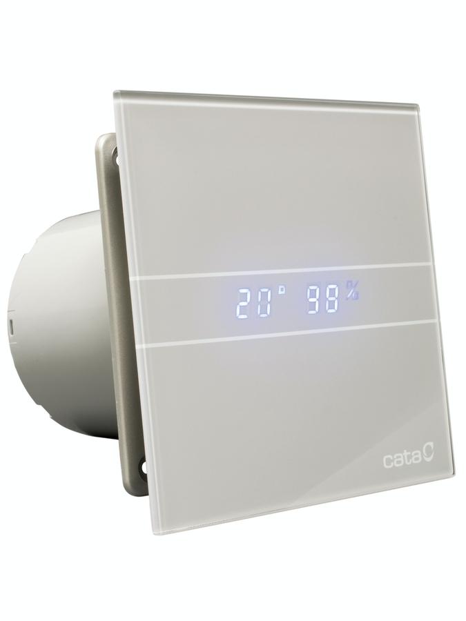

Onoff Posted October 8, 2020 Posted October 8, 2020 I can't recommend this either. Sounds like the RAF have bought their Harriers back from the Yanks: https://www.myappliances.co.uk/Cata-E100GSTH-100mm-Silver-Glass-Bathroom-Fan-With-Humidistat-Display Looks the mutt' s nuts mind... 1
