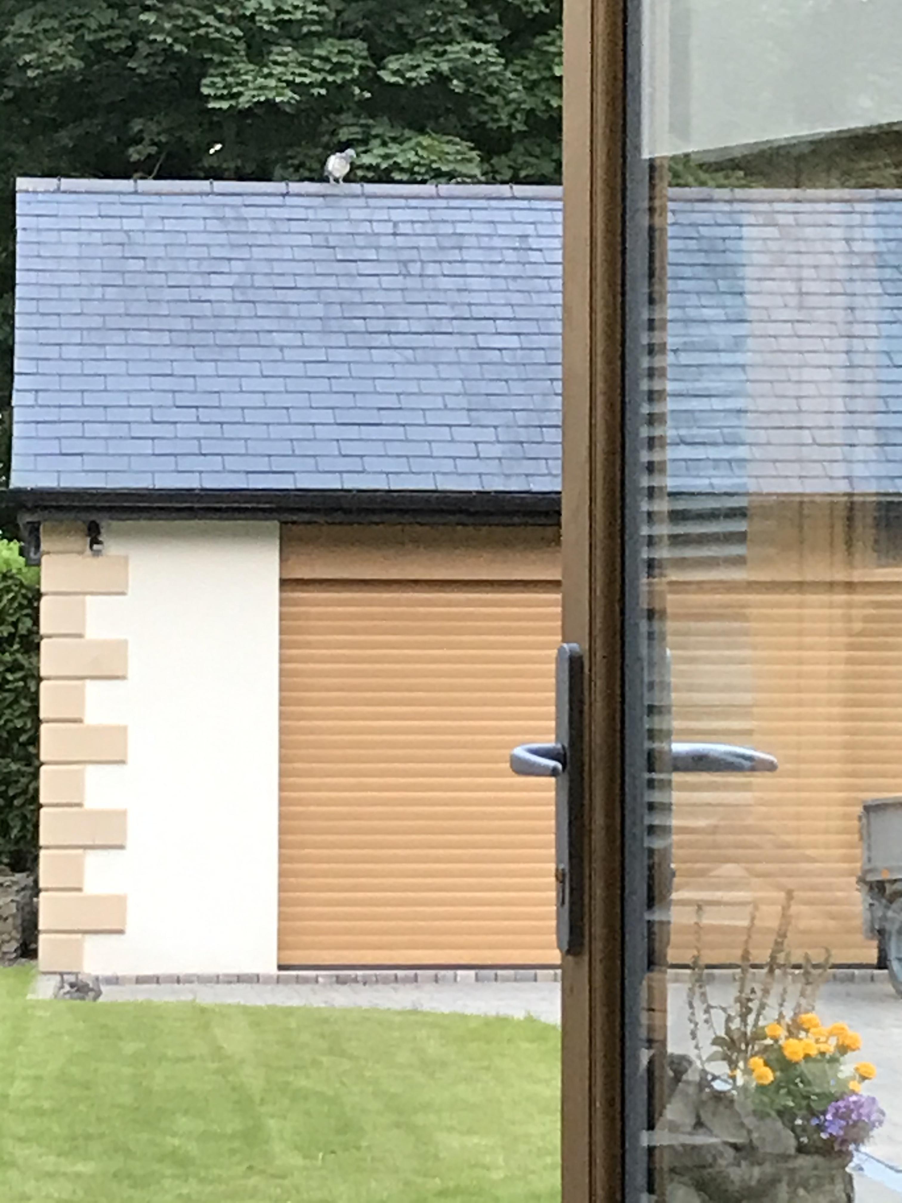

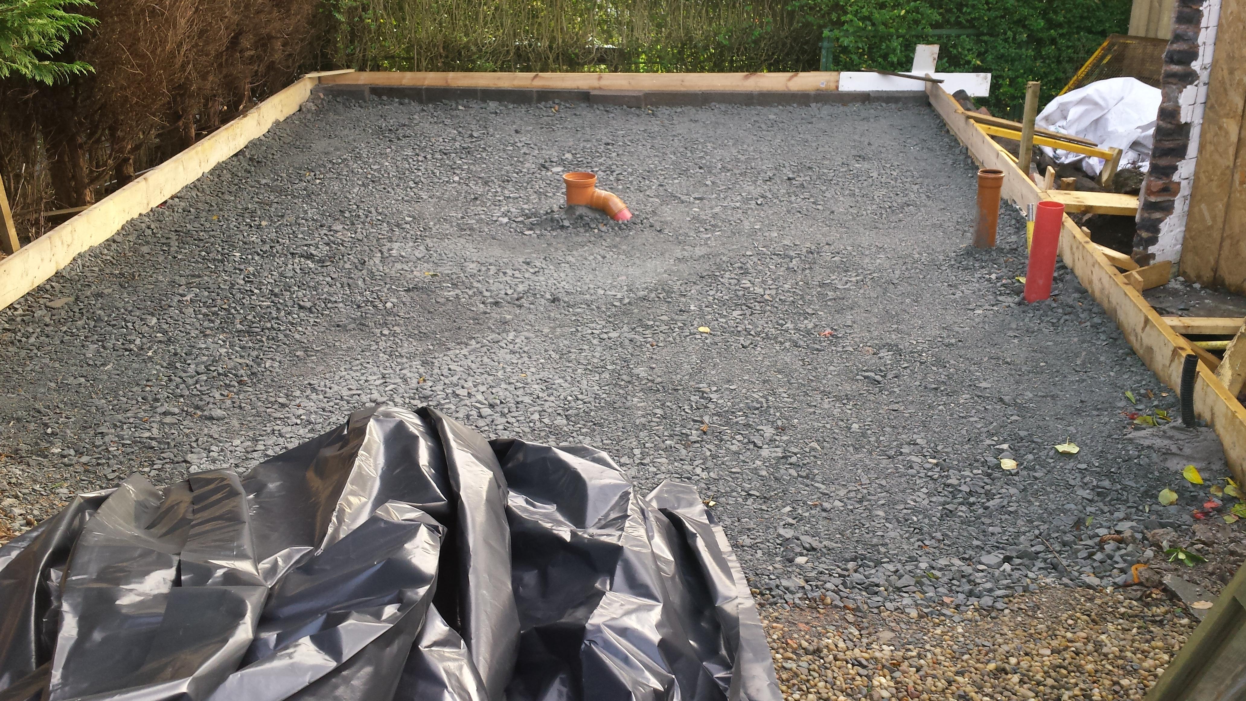

I built a 6.2 x 5m garage in 2018 - only paid for a brickie.
Dug out the area for slab with JCB which was £150 for the weekend (also other garden work)
40 tons of hardcore - some virgin some 6F2 (recycled) which was about £200
Some scrap timber and new timber for the forms £50.00
Drains (bottle gully in middle of slab etc.) £50.00

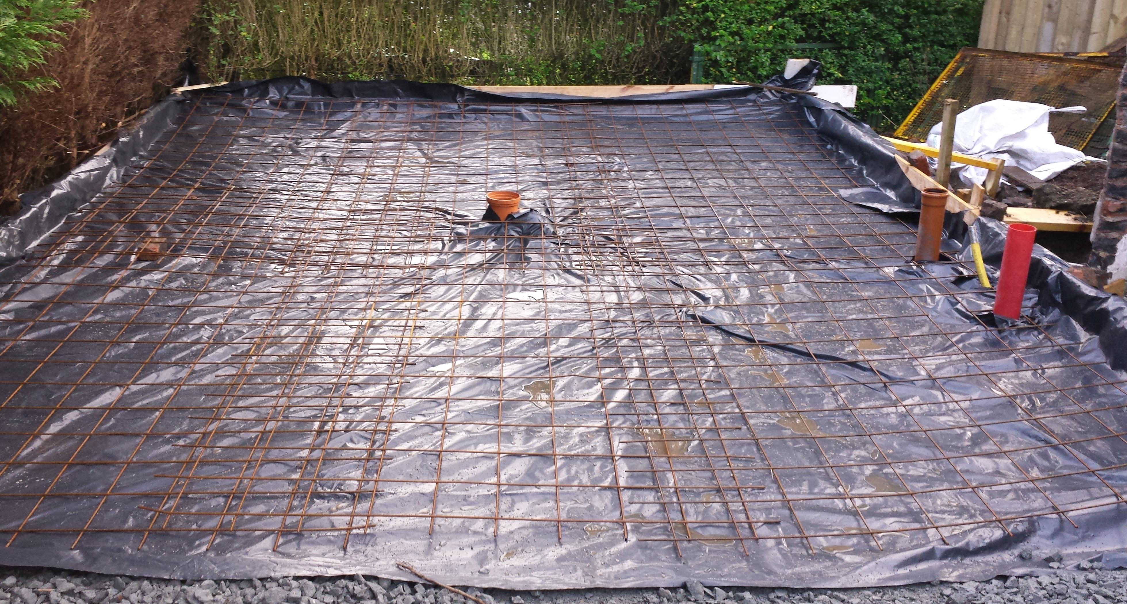

Rebar mesh £150
DPM £30
Concrete C40 250-200mm £840.00
Block, sand and cement delivery £450.
Brickie to build £250
Roof timber £400
Membrane £50
Russel Pennine tiles, 420 of £300
Electric roller shutter 3 x 2.2m with remote control etc. £700
Facias, soffit, gutter etc. £120
Rear end cladding for roof gable £100
Front end timber cladding for roof gable £120
Side door - free from a Merc dealership renovation.
Locks, hinges etc to suit above £50.00
Dry dashing materials inc. beads/bellcast about £350
Electrics - I had a new 8 way Wylex metal consumer unit from a skip, so cable, metalclad sockets and 3 LED non-corrosive battens (which I also acquired) £100.
So I think it was about £4460.
So £143.87 a meter.

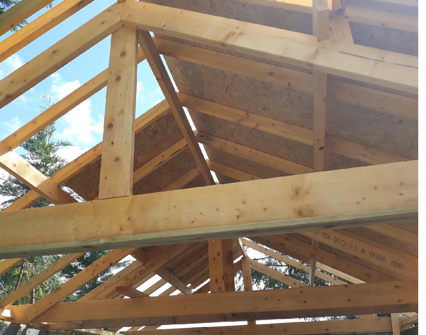

Roof timber £400
What kind of roof have you built? Did you need any calculations for it or is there a span table that covers it? I thought 5m was too wide for simple joists.
Just saw your previous reply, missed that when responding to above.
£250 bricky labour. Does he work for £75 a day!?
Fully hand cut roof,  basically a 6 x 6x2 purlin roof on 4 no 8x2 main timber trusses - no joists, it is a cathedral style roof. The span was 4.8 as the trusses sit on concrete block piers which are also straighteners for the main walls. So although nominal width is 5m it is less at the columns and used 4.8m timbers with 150mm bearing
I did my own calcs with assistance from the SE who used to work with us I can't remember it all off the top of my head but static loadings were about 1.2tons per side spread over 4 trusses etc. etc. plus the gable end support itself which took a portion of the load it worked out pretty good + snow and wind it was close but came in on target.
Been up for 2 years, interestingly I was looking at the roof the other day checking for deflection in the main trusses and got the tape out, all good, I think in 2 years the mid point of the truss has maybe dropped a few mm but they were crown up and therefore now sit deadly straight.

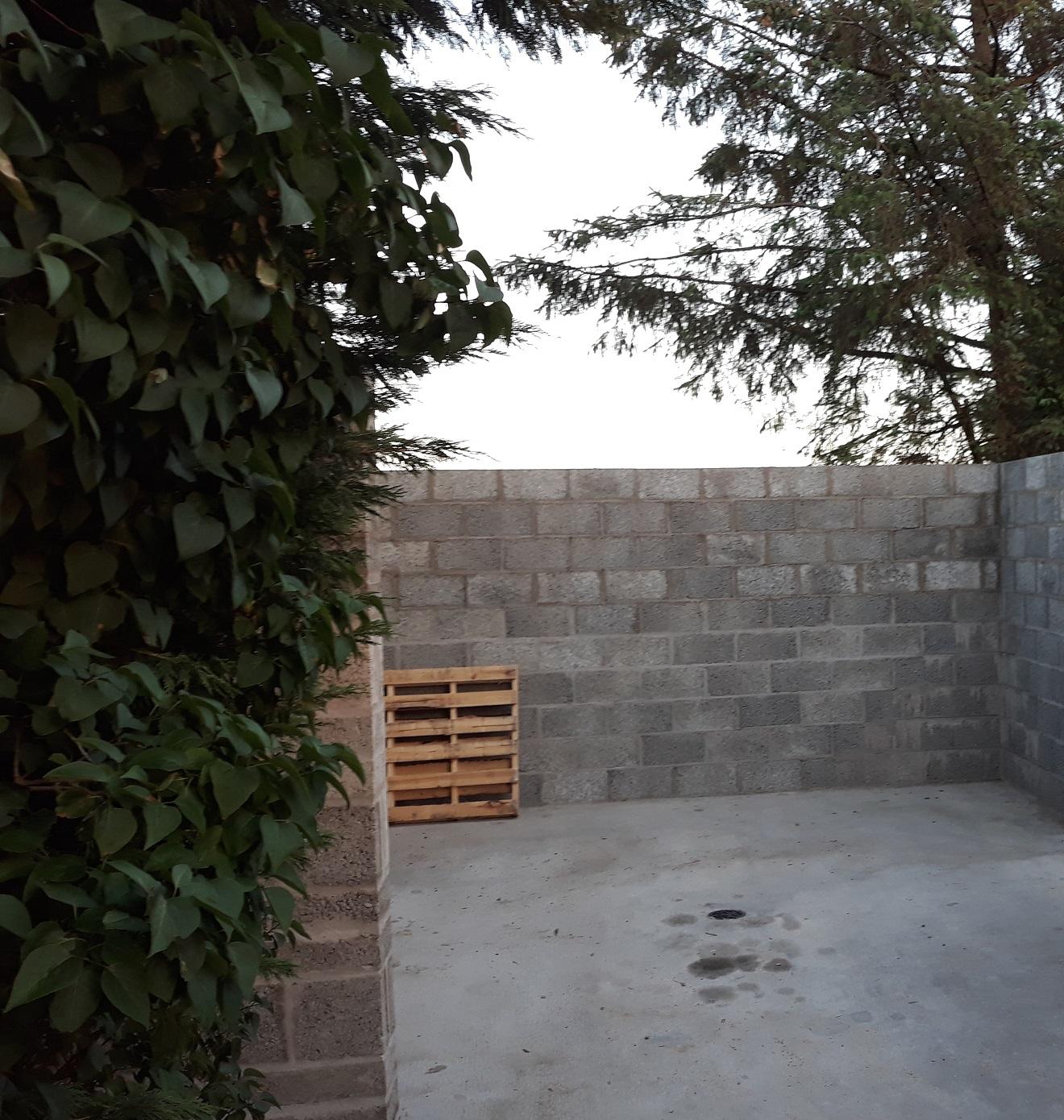

Did you just have single skin block walls? I'm not concerned about having insulation so was wondering if single skin is ok as it makes the internals a bit bigger and obviously reduces costs.
Yes - single skin with 2 piers down the long walls and at the main door - a half height pier on one side of the pedestrian door for extra strength. I have about 20mm of dry dashing on the exterior built up with base coat and top coast etc. so the thing is dry as a bone. Sure it can be cold in the winter but I keep a car and garden tools in it!
I'll get some photos... hang on a minute...
Edited by Carrerahill
