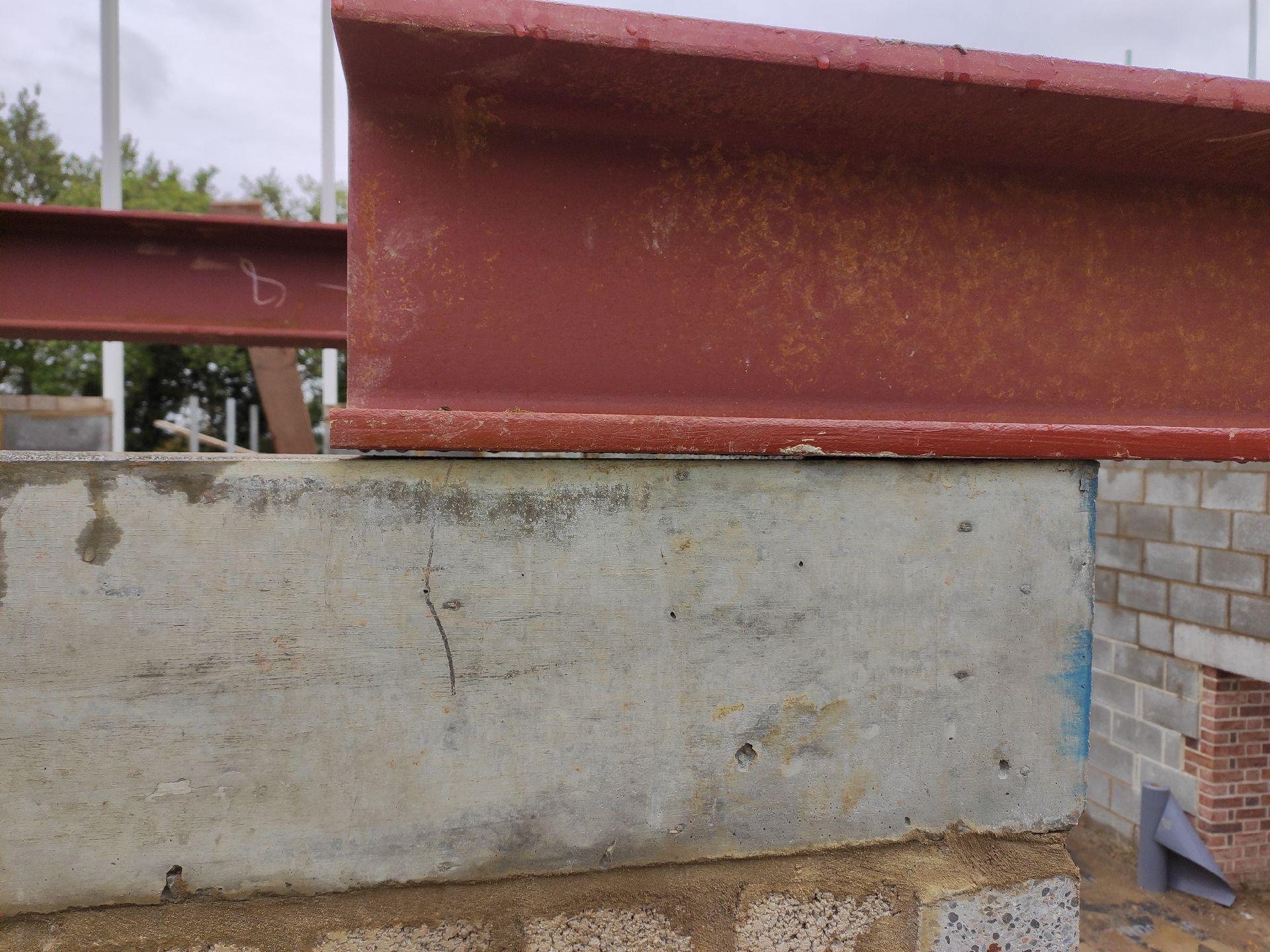

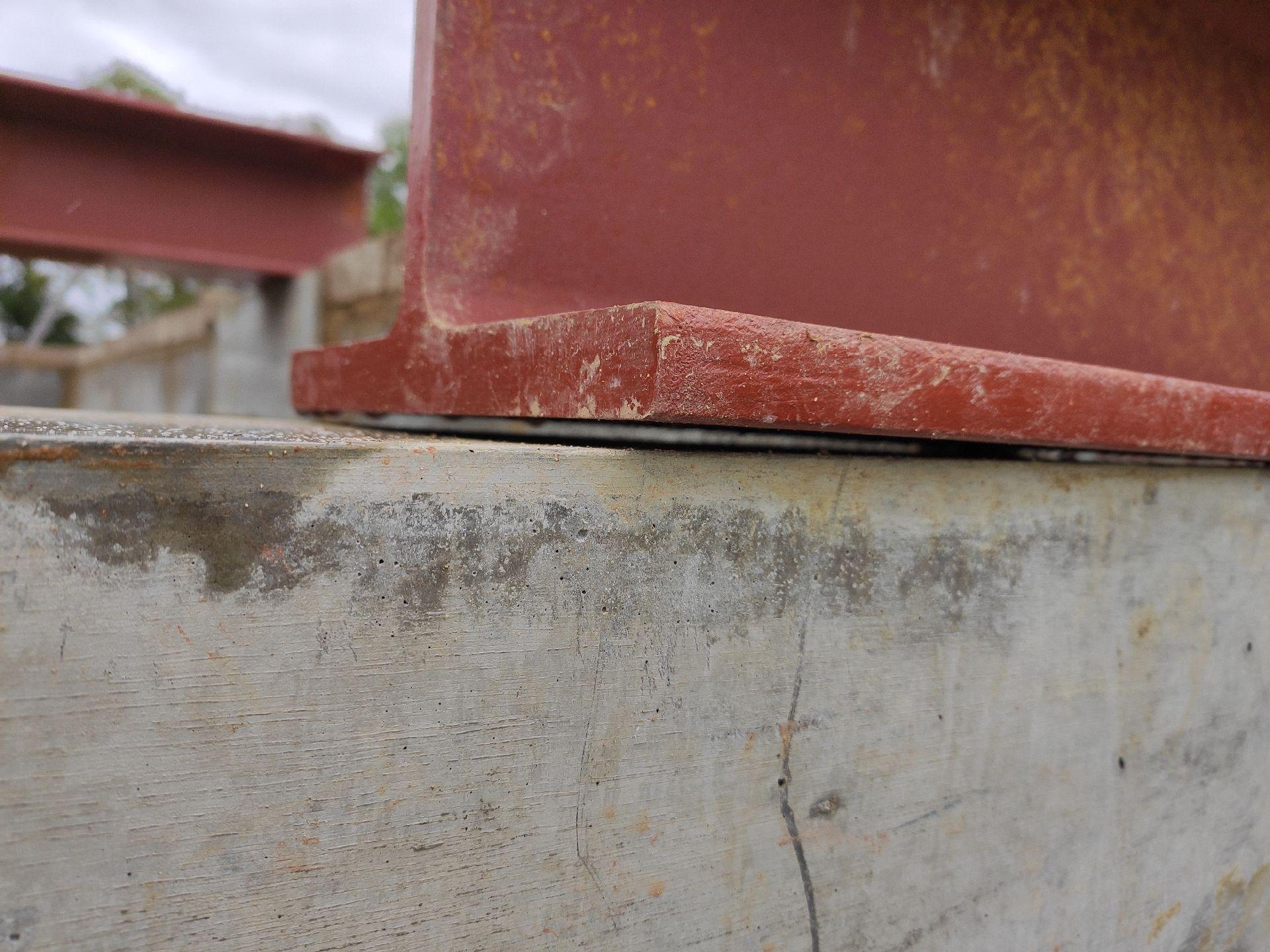

MortarThePoint Posted October 3, 2020 Share Posted October 3, 2020 We've just installed some steel beams (UC 203x203x86). One padstone looks to be a bit out of level and across the 400mm opens up a gap of about 3 mm. Is this a worry? If so what should be done to fix it? For reference, the bottom flange of the beam is 20.5mm in height. The padstones are large and heavy (660x190x215, about 65kg) so getting them perfectly level would always be a challenge. Link to comment Share on other sites More sharing options...
PeterW Posted October 3, 2020 Share Posted October 3, 2020 1:1 cement and sand thin mortar bed will sort that. You won’t split slate fine enough. Worth checking the other end too, is it absolutely level..? Depending on the length of the beam, it may be that it’s deflecting enough to kick the end up slightly. Are they being bolted down at all..? 1 Link to comment Share on other sites More sharing options...

MortarThePoint Posted October 3, 2020 Author Share Posted October 3, 2020 (edited) 23 minutes ago, PeterW said: 1:1 cement and sand thin mortar bed will sort that. You won’t split slate fine enough. Worth checking the other end too, is it absolutely level..? Depending on the length of the beam, it may be that it’s deflecting enough to kick the end up slightly. Are they being bolted down at all..? Thanks PeterW. The beam is 4m clear span and currently not loaded other than self weight. Another beam of similar length has much less of a gap <=1mm. I had wondered about using stainless steel shims. They're not getting bolted down. I had asked the Structural Engineer a couple of weeks ago about that and he said that thermal expansion could cause masonry cracking so he wasn't a fan. The drawing says "END OF BEAM T BE FULLY ENCASED IN MASONRY, FILLING ALL VOIDS WITH RAMMED DRY PACK MORTAR". Is this the sort of void that's referring to? Edited October 3, 2020 by MortarThePoint Link to comment Share on other sites More sharing options...

PeterW Posted October 3, 2020 Share Posted October 3, 2020 45 minutes ago, MortarThePoint said: The drawing says "END OF BEAM T BE FULLY ENCASED IN MASONRY, FILLING ALL VOIDS WITH RAMMED DRY PACK MORTAR". Is this the sort of void that's referring to? so ... 41 minutes ago, MortarThePoint said: The SE was happy with the overhang and a 254 x 146 has less out of plane strength whilst also being deeper which was undesirable. ...? So your spec says that it should be fully encased, but your beam overhangs the padstone...? You can’t do both ..! The spec will be for fire protection - that beam will also need two layers of plasterboard to encase it. And yes, you can dry pack that lot but it will be much easier with a 1:1 semi dry bed mix. Link to comment Share on other sites More sharing options...
MortarThePoint Posted October 3, 2020 Author Share Posted October 3, 2020 48 minutes ago, PeterW said: And yes, you can dry pack that lot but it will be much easier with a 1:1 semi dry bed mix. The challenge is a bed mix involves lifting one end of a 400kg beam. I could use an acrow I suppose. Link to comment Share on other sites More sharing options...
Mr Punter Posted October 3, 2020 Share Posted October 3, 2020 If you are keen to increase the bearing you could use some metal shims or some runny structural grout. Link to comment Share on other sites More sharing options...
MortarThePoint Posted October 3, 2020 Author Share Posted October 3, 2020 56 minutes ago, Mr Punter said: If you are keen to increase the bearing you could use some metal shims or some runny structural grout. Runny structural grout sounds interesting. What sort of mix is that or is there a particular product I should look out for? Link to comment Share on other sites More sharing options...
Onoff Posted October 3, 2020 Share Posted October 3, 2020 2 minutes ago, MortarThePoint said: Runny structural grout sounds interesting. What sort of mix is that or is there a particular product I should look out for? Weber Five Star Grout we use at work for packing clearance holes through structural slabs. Link to comment Share on other sites More sharing options...
PeterW Posted October 3, 2020 Share Posted October 3, 2020 3 minutes ago, MortarThePoint said: Runny structural grout sounds interesting. What sort of mix is that or is there a particular product I should look out for? Sika 111 is the one I use - you would not need much, just duct tape round the edges and pour it in. Link to comment Share on other sites More sharing options...
MortarThePoint Posted October 3, 2020 Author Share Posted October 3, 2020 3 minutes ago, Onoff said: Weber Five Star Grout we use at work for packing clearance holes through structural slabs. Just now, PeterW said: Sika 111 is the one I use - you would not need much, just duct tape round the edges and pour it in. Thanks, these look great. They look to develop a strength of 40MPa which is 40N/mm2 so close to C50 cement of the padstone and should be runny enough to flow or get pushed in. Wonder if I can get less than a 25kg bag as I'll need less than 1kg. Link to comment Share on other sites More sharing options...
willbish Posted October 3, 2020 Share Posted October 3, 2020 If your steel beam is level and your padstone is slightly on the pi$$ you aren't going to be able to pour a runny grout mix up hill. Wedge a few steel shims in there Link to comment Share on other sites More sharing options...
