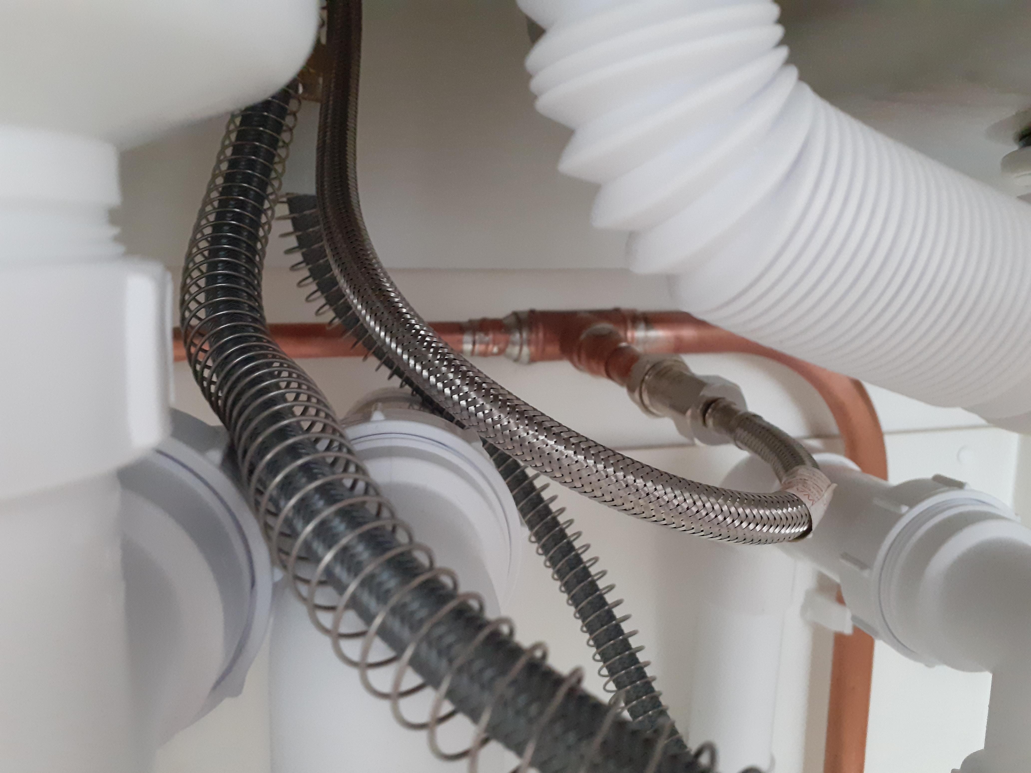

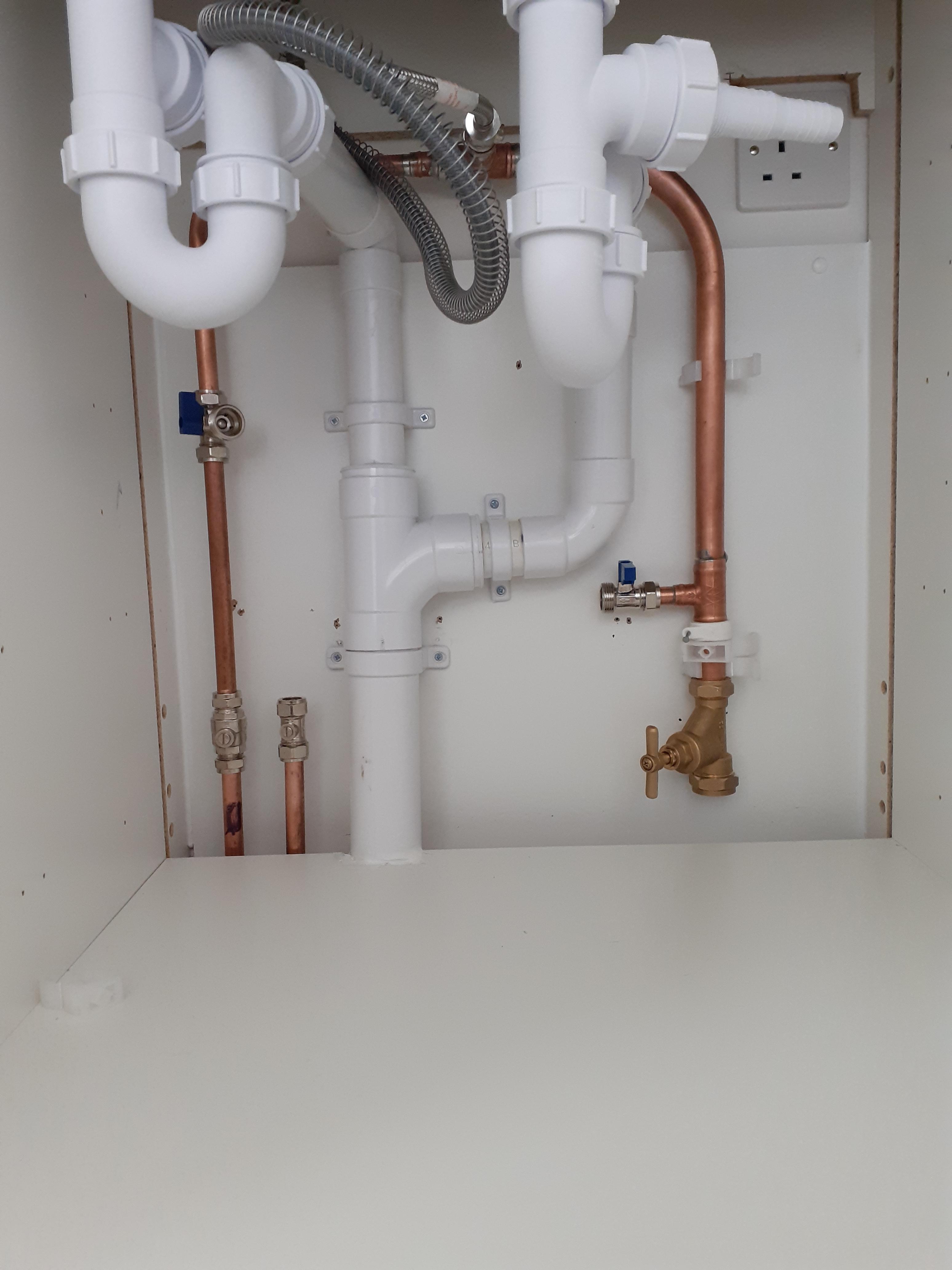

MJNewton Posted September 30, 2020 Posted September 30, 2020 Does anyone have photos of their under-sink plumbing (of course you do) that you wouldn't mind sharing (maybe not)? I'm looking for inspiration as to how to lay things out... For what it's worth I've got a 1.5 bowl sink, mixer tap and dishwasher to cater for. My supply and waste pipes will be coming in from one side too. Your setup doesn't need to match though - I can cherry pick interesting features from anything I'm sure.

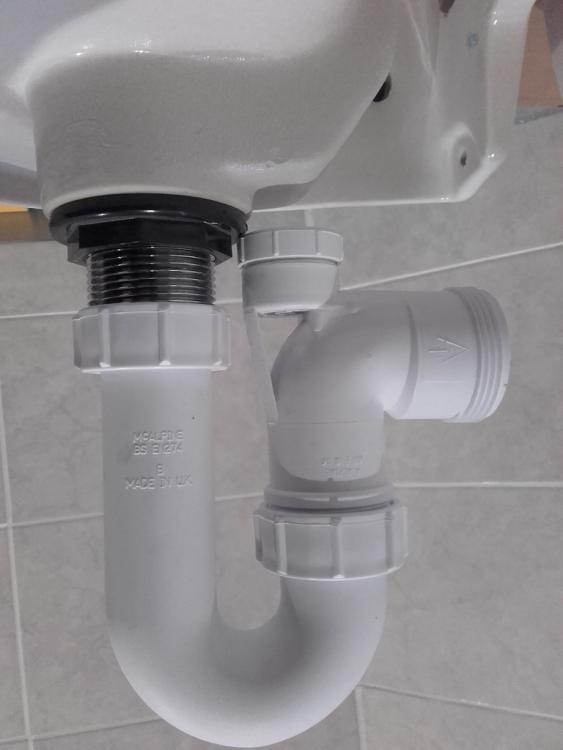

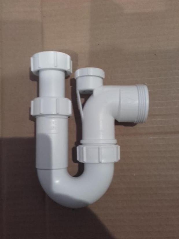

Onoff Posted October 1, 2020 Posted October 1, 2020 (edited) The McAlpine anti siphon trap I bought sat too high so I bought a telescopic, non anti siphon one and made a telescopic anti siphon trap: & two become one: Looks like you could change that lower elbow and fit the anti siphon type. Edited October 1, 2020 by Onoff 1

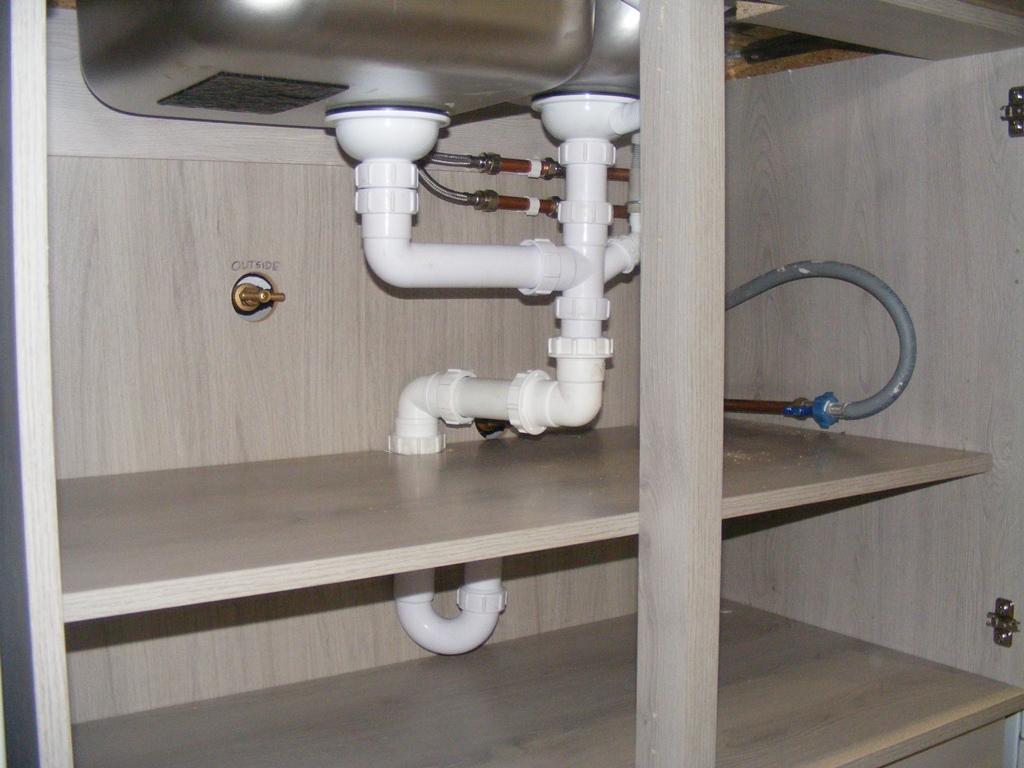

ProDave Posted October 1, 2020 Posted October 1, 2020 Kitchen sink waste. Utility sink wast. This one I was a little creative to get the trap out of the way to save cutting a massive hole in the shelf.
MJNewton Posted October 1, 2020 Author Posted October 1, 2020 (edited) 2 hours ago, Onoff said: Looks like you could change that lower elbow and fit the anti siphon type. That looks like a neat idea, and could make installation slightly easier as it'd give a vertical adjustment below the manifold in addition to those above it if I too changed the whole trap. Edited October 1, 2020 by MJNewton
MJNewton Posted October 1, 2020 Author Posted October 1, 2020 5 minutes ago, ProDave said: This one I was a little creative to get the trap out of the way to save cutting a massive hole in the shelf. I note you've used telescopic components too - I can see that they're really useful to enabling a neat installation lining everything up just where you want it.
Carrerahill Posted October 1, 2020 Posted October 1, 2020 (edited) I deliberated for some time on how to do this. 22mm to start which feeds first appliance T and then kitchen tap before dropping to 15mm to head to the bathrooms and boiler. We have very good water pressure/flow rate and it works a treat. Benefit of keeping it up at 22mm until past the kitchen tap (and washing machine as it is on the first T) is that there is nearly no noticeable drop in flow when the kitchen tap is on while water is being used in bathrooms. I also settled for nothing less then soldered and radiused copper. On the waste the run to the 110mm pipe is in 50mm, the first T is 50mm where it reduces to 40mm to each trap totally separately, both sinks can drain at top speed this way and if there was a trap blockage in one it means the other side is still active. This was yet to be fully clipped. Unsupported pipework is a bugbear of mine. Edited October 1, 2020 by Carrerahill

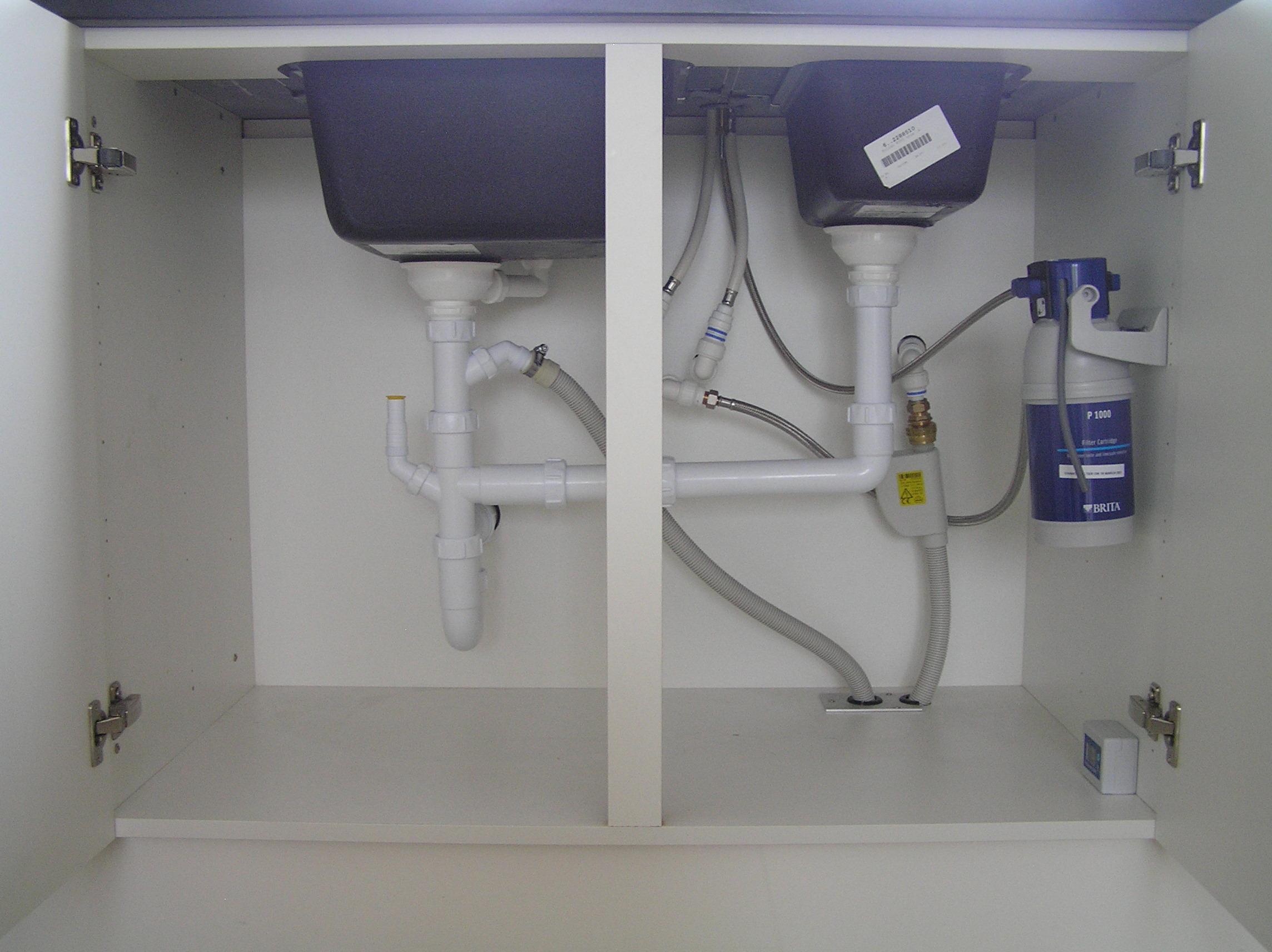

MJNewton Posted October 1, 2020 Author Posted October 1, 2020 15 minutes ago, PeterStarck said: This is ours warts and all. Looks perfectly functional to me! You've reminded me that modern appliances seem to always come with anti-flood hoses so I must make sure I'm not too tight for space to accommodate them. Do you/anyone know if orientation matters?
Gone West Posted October 1, 2020 Posted October 1, 2020 3 minutes ago, MJNewton said: Do you/anyone know if orientation matters? IIRC ours had to go a certain way up.
MJNewton Posted October 1, 2020 Author Posted October 1, 2020 (edited) 2 minutes ago, PeterStarck said: IIRC ours had to go a certain way up. I thought there might be, although the manual for our proposed dishwasher doesn't mention it (but I'm sure I'd read elsewhere it does). Whilst having it downwards facing (like yours) would make things a little more difficult for me it'd be playing it safe just in case and it won't become any easier to do this than right now. Edited October 1, 2020 by MJNewton

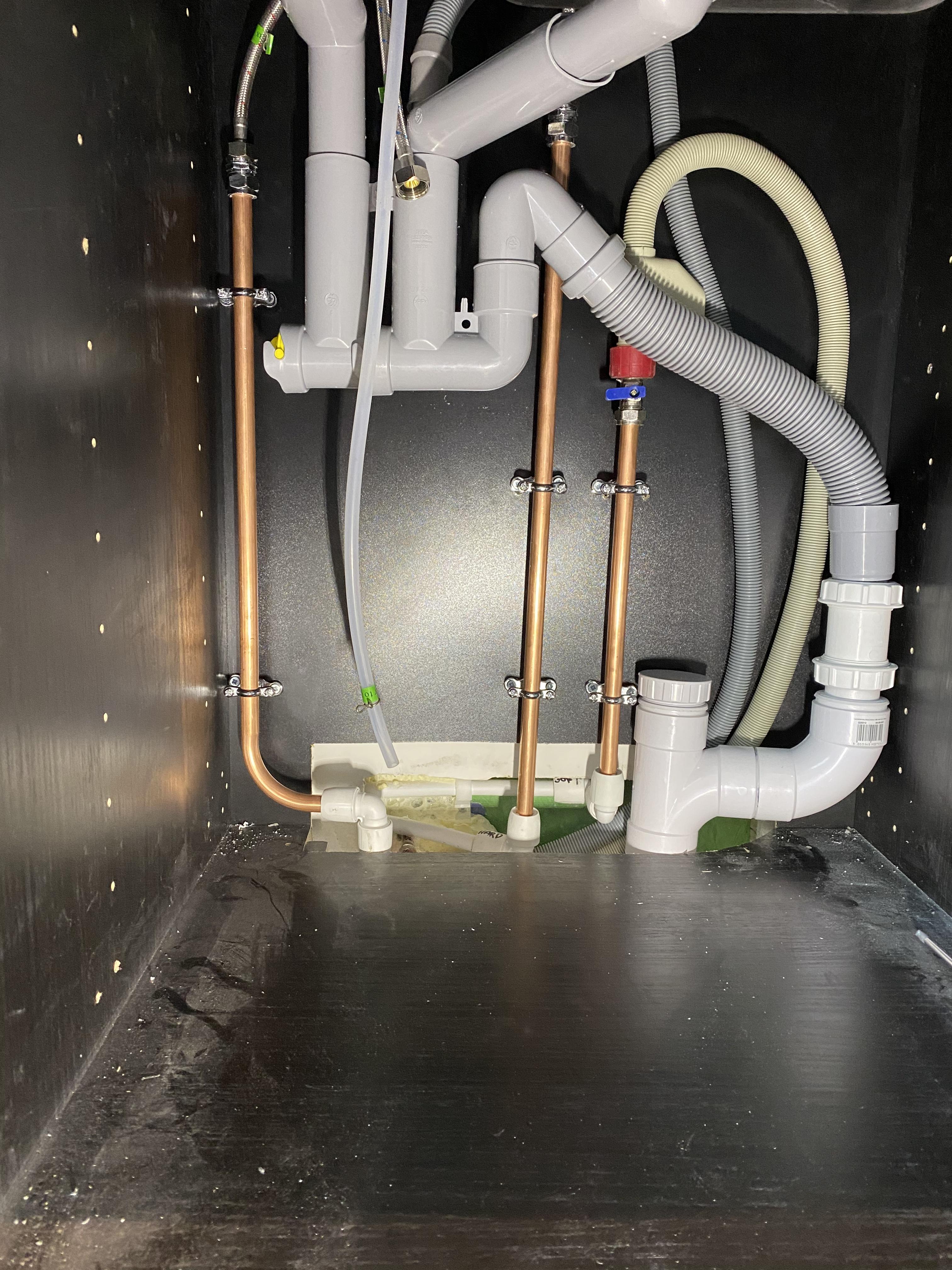

Nickfromwales Posted October 1, 2020 Posted October 1, 2020 This is what I do. 50mm waste rising vertically from 110mm fW directly underneath, with 110x50mm bung. 50mm T with an access cap on the top to rod the lot, and then the side of the T picks up the duties. If the FW run isn’t direct to an external inspection chamber or is T’d into by another 110mm, eg underground, then the second ( internal ) means of rodding access will be a B-Regs requirement
Nickfromwales Posted October 1, 2020 Posted October 1, 2020 If doing wastes from scratch and not using g the supplied generic stuff I always put a washing machine upstand for the appliances so you don’t get the factory / obligatory gurgle which comes with putting the appliance on the inbuilt appliance waste connector ( as that is before the trap so the noise comes up though the waste / plug hole ? and into the room ). 1

dpmiller Posted October 1, 2020 Posted October 1, 2020 1 hour ago, MJNewton said: You've reminded me that modern appliances seem to always come with anti-flood hoses so I must make sure I'm not too tight for space to accommodate them. Do you/anyone know if orientation matters? The Miele in Peter's photo has the inlet solenoid valve in the grey bit, and orientation doesn't matter IME. Other brands can use an excess-flow "waterstop" which may be a bit more sensitive. 1

MJNewton Posted October 1, 2020 Author Posted October 1, 2020 2 minutes ago, dpmiller said: The Miele in Peter's photo has the inlet solenoid valve in the grey bit, and orientation doesn't matter IME. Other brands can use an excess-flow "waterstop" which may be a bit more sensitive. Ah, I see. I didn't realise they'd moved the solenoid out of the machine. I'll try and err on the side of caution I think and arrange for a downward facing connection to suit all requirements.
