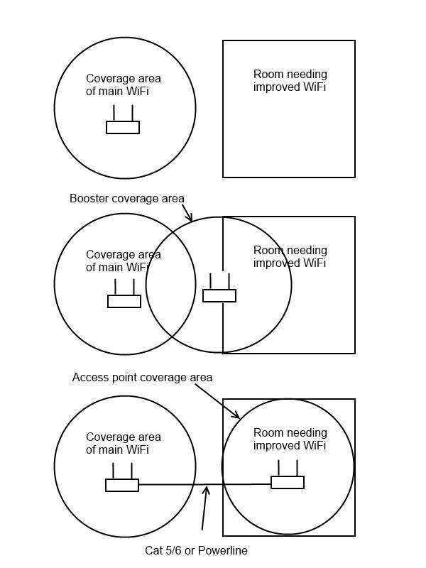

Temp Posted October 1, 2020 Share Posted October 1, 2020 (edited) Simple explanation of why Cat 5/6 or Powerline access points are better than wifi boosters (in my opinion).. Suppose you have an existing "main wifi" source (which is typically in the modem provided by your ISP) and a "remote room" that has a poor signal. A wifi booster receives and rebroadcasts the wifi signal on another channel. So a booster in the remote room would have the same problem receiving the wifi signal as any other device in the remote location. The only advantage it has is possibly a bigger antenna to receive the weak signal. So to be most effective a booster may have to be placed between the main wifi source and the remote location. It's like putting a stepping stone in a river to make it easier to cross. No point putting the extra stone on the far bank. It has to go somewhere in the middle where it can be reached from both banks. However this means the booster isn't exactly where you would want to put a new access point which is right in the middle of the remote room. If you use a Cat 5/6 or Powerline Access point the new access point can go anywhere in that remote room and give you max signal. Edited October 1, 2020 by Temp Link to comment Share on other sites More sharing options...
