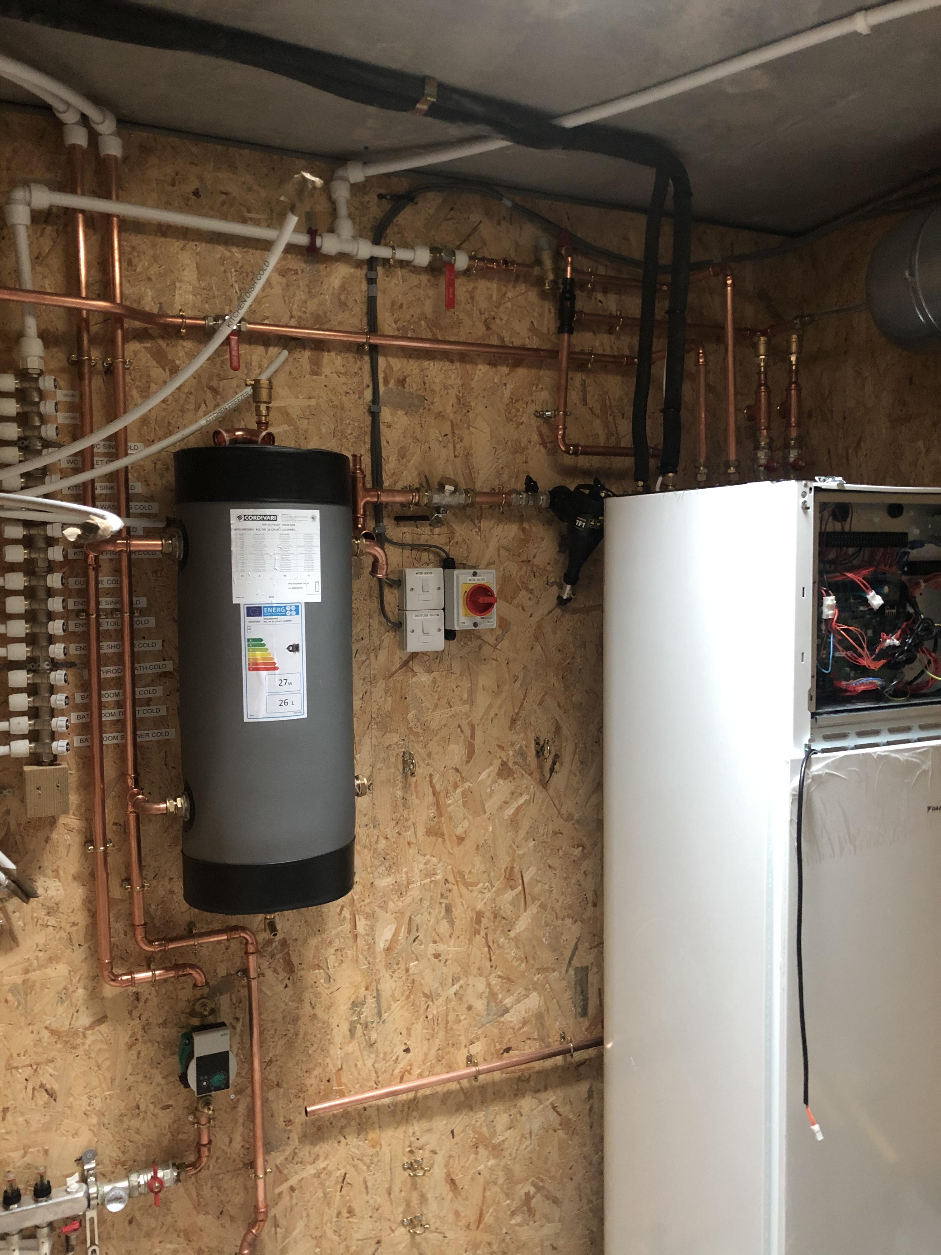

Pocster Posted September 28, 2020 Author Share Posted September 28, 2020 Guys have been busy .... 1 Link to comment Share on other sites More sharing options...
joe90 Posted September 28, 2020 Share Posted September 28, 2020 That’s just not good enough, they have put their pipes in front of your nice manifold labels ????? 1 Link to comment Share on other sites More sharing options...

Pocster Posted September 28, 2020 Author Share Posted September 28, 2020 1 hour ago, joe90 said: That’s just not good enough, they have put their pipes in front of your nice manifold labels ????? He did apologise for that ! ? Link to comment Share on other sites More sharing options...
PeterW Posted September 28, 2020 Share Posted September 28, 2020 Crap installation of both the mag filter and the valve with handle before it. How are you supposed to get the mag unit off ..?? 1 Link to comment Share on other sites More sharing options...
Pocster Posted September 28, 2020 Author Share Posted September 28, 2020 (edited) 33 minutes ago, PeterW said: Crap installation of both the mag filter and the valve with handle before it. How are you supposed to get the mag unit off ..?? Waiting for examination of the photo . Just for the record installed by a company recommended many times on here ! Edited September 28, 2020 by pocster Link to comment Share on other sites More sharing options...
PeterW Posted September 28, 2020 Share Posted September 28, 2020 Valve upside down will leak down it’s spindle when it goes - into your electrics .. and how do you get to the bottom of the mag unit to drain it off ..? Link to comment Share on other sites More sharing options...
Pocster Posted September 28, 2020 Author Share Posted September 28, 2020 1 minute ago, PeterW said: Valve upside down will leak down it’s spindle when it goes - into your electrics .. and how do you get to the bottom of the mag unit to drain it off ..? Don’t know . I’ll ask him tomorrow Link to comment Share on other sites More sharing options...
PeterW Posted September 28, 2020 Share Posted September 28, 2020 Can’t see the point of two valves either ..? Lever and a butterfly on the same pipe leg or is that part of the filter unit ..? Link to comment Share on other sites More sharing options...
Pocster Posted September 28, 2020 Author Share Posted September 28, 2020 5 minutes ago, PeterW said: Can’t see the point of two valves either ..? Lever and a butterfly on the same pipe leg or is that part of the filter unit ..? No idea Link to comment Share on other sites More sharing options...

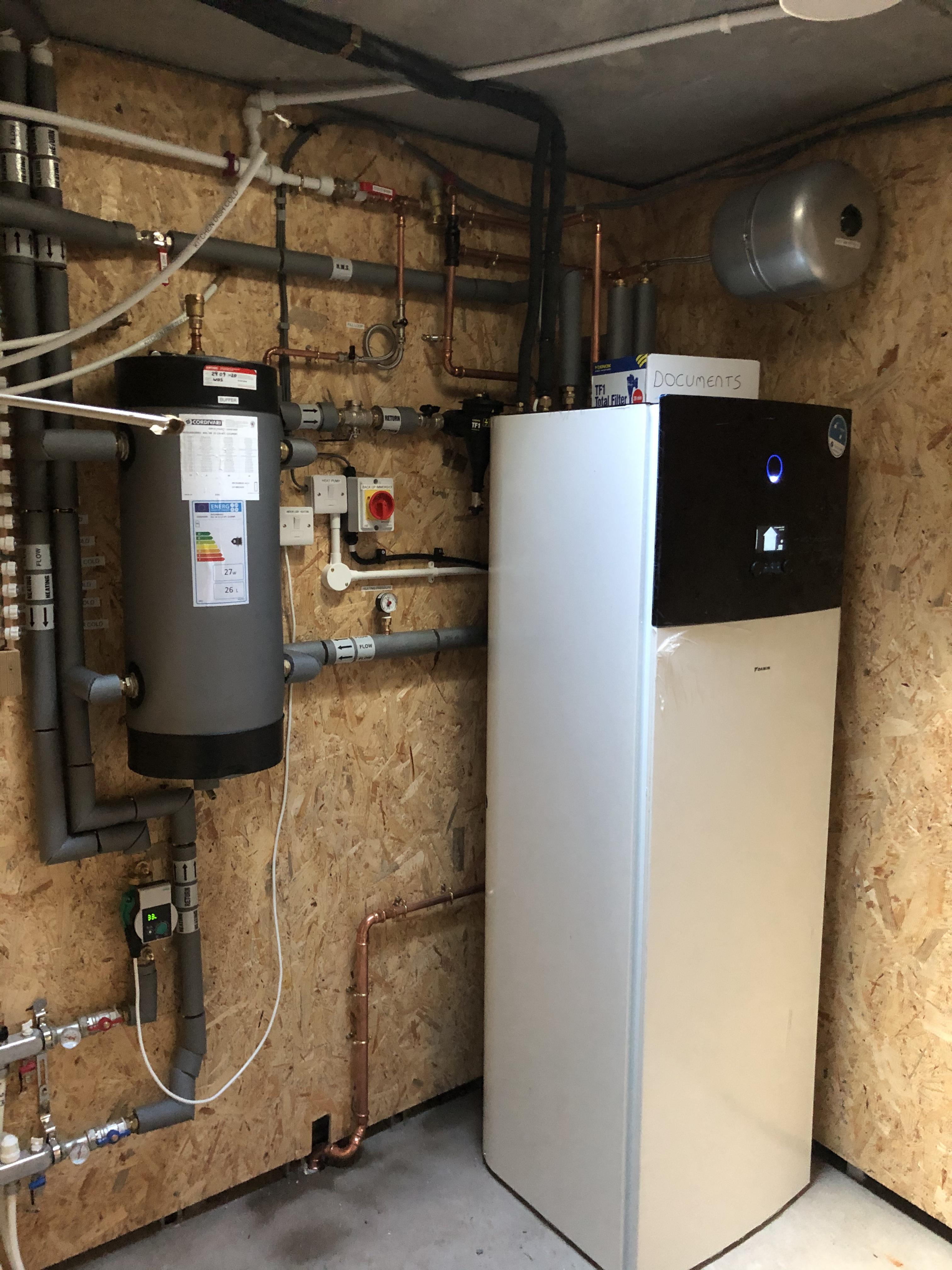

Pocster Posted September 29, 2020 Author Share Posted September 29, 2020 All done . They did suggest moving the electrics under that valve . 1 Link to comment Share on other sites More sharing options...
