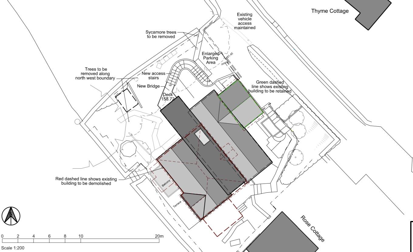

ZacP Posted September 19, 2020 Share Posted September 19, 2020 We have a few options with our build, and would like ask you experienced and well regarded intelligent people for some guidance. We don't want to fall foul our the VAT reclaim regulations and end up hanging to pay VAT on the whole build. Here is the site plan. The red dotted line is a bungalow we are demolishing. The green building is a store with no water or gas but electricity via a cable drawn from the bungalow. It's got windows and a door etc but is a store at the moment. The buildings are at the moment not connected in any way other than the power cable. Option 1: Build as shown and integrate this into the store so there is access internally between the new building and the old (does this mean that it might be classed as an extension, and also we would-be be removing all existing buildings on site)? Option 2: Build up to the store but create no internal access between, almost like making a semi-detached house. Option 3: Build to near the store, but not touching it, ensuring that its definitely a separate building Option 4: Knock down everything and start again. We're hoping for option 1 or 2. Obviously option 4 isn't great! Separately, I guess if we wanted to convert the store at some point to be a granny annex (it would be cozy, but it is 2 stories) that would affect things too and obviously the conversion wouldn't be 0% VAT? This is purely in respect of VAT, I know changes to the scheme would mean some form of alteration in planning. Thanks for your help! Link to comment Share on other sites More sharing options...

Temp Posted September 20, 2020 Share Posted September 20, 2020 (edited) 11 hours ago, LSB said: Ok, I sit corrected, we are converting a barn and that is 5% Its 5% but you can reclaim that (so 0%) but its not relevant here as already residential. I think anything but option 4 is risky. The rules I've seen are pretty clear about the demolishing all buildings on site and/or only retaining a front wall if required by planning. Edited September 20, 2020 by Temp Link to comment Share on other sites More sharing options...

ZacP Posted September 20, 2020 Author Share Posted September 20, 2020 @joe90 planning is to attach it to the new build and incorporate it as habitable space. I didn’t know if that had a bearing on the VAT position. The main residential building will be completely going and being replaced footings up just not this one that was called a store during planning. No way could it be a garage due to access unfortunately! Link to comment Share on other sites More sharing options...

newhome Posted September 20, 2020 Share Posted September 20, 2020 When you have a complicated case like this with £££ riding on it you really need to write to HMRC and ask them. It will come down to what they say ultimately, not what people think on here. I don’t think you can leave the building and incorporate it into the new house and have it count as a new build as it fails the “demolish everything to foundations” test. It might then turn it into a conversion instead but it would fail on that point as the building you are demolishing has been a dwelling and presumably lived in. 2 Link to comment Share on other sites More sharing options...
ZacP Posted September 20, 2020 Author Share Posted September 20, 2020 2 hours ago, newhome said: When you have a complicated case like this with £££ riding on it you really need to write to HMRC and ask them. It will come down to what they say ultimately, not what people think on here. I don’t think you can leave the building and incorporate it into the new house and have it count as a new build as it fails the “demolish everything to foundations” test. It might then turn it into a conversion instead but it would fail on that point as the building you are demolishing has been a dwelling and presumably lived in. This might well be the way forward. it does seem pointless to knock down a perfectly solid building just to rebuild it. do you have any idea of which department of HMRC deal with this? Or even an address/email? thanks! Link to comment Share on other sites More sharing options...
newhome Posted September 20, 2020 Share Posted September 20, 2020 44 minutes ago, ZacP said: do you have any idea of which department of HMRC deal with this? Or even an address/email? National DIY Team SO970 HM Revenue and Customs Newcastle NE98 1ZZ Don’t bother with the phone as they have a habit of giving incorrect advice and later say that they have no record of it. Something in writing is the way forward. Link to comment Share on other sites More sharing options...

ZacP Posted September 21, 2020 Author Share Posted September 21, 2020 How does this sound for a solution: 2 new planning applications: 1 - to build existing house as a new build abutted to but not interconnecting with the store 2 - convert the store to be a separate 1 bed dwelling Then we have one as 0% as tis a new build and one at 5% as a conversion if I understand the rules correctly? TIA! Link to comment Share on other sites More sharing options...
PeterW Posted September 21, 2020 Share Posted September 21, 2020 3 minutes ago, ZacP said: 2 - convert the store to be a separate 1 bed dwelling Then we have one as 0% as tis a new build and one at 5% as a conversion if I understand the rules correctly? Is the store part of the existing property boundary ..?? i.e. has it been used as ancillary to the current dwelling as a store..? If so, it is deemed to be part of the existing dwelling house and any conversion would be at 20% VAT not 5% VAT. The lower rate only applies for conversion from one building type to another (office to residential etc Also, it’s highly unlikely you will get PP for the second 1 bed dwelling on it’s own as the council won’t see it as such. You won’t get any refund under self build VAT as you won’t qualify, and your mortgage funder is unlikely to fund the second build as it would be commercial. Unless you must keep the store, I would bulldoze the lot and start again. 1 Link to comment Share on other sites More sharing options...
