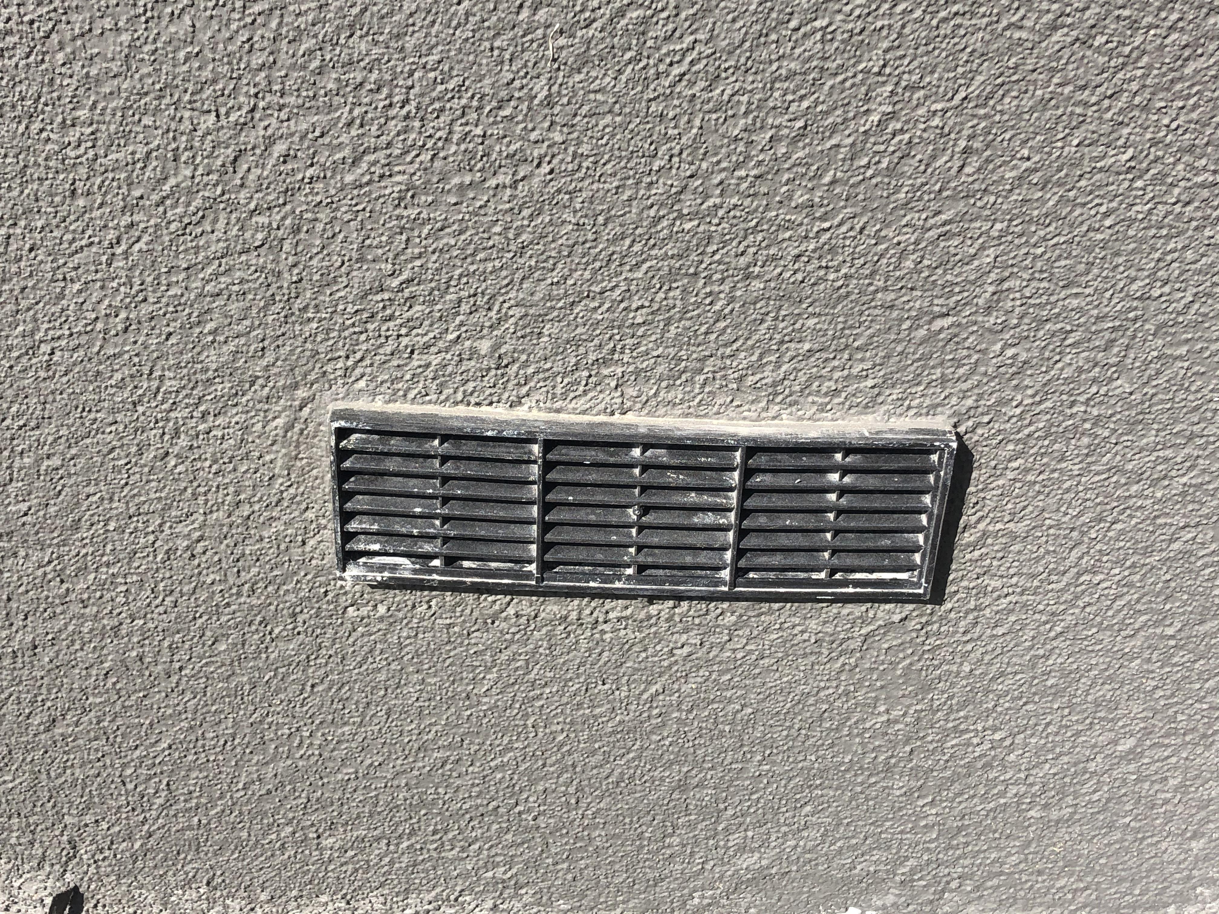

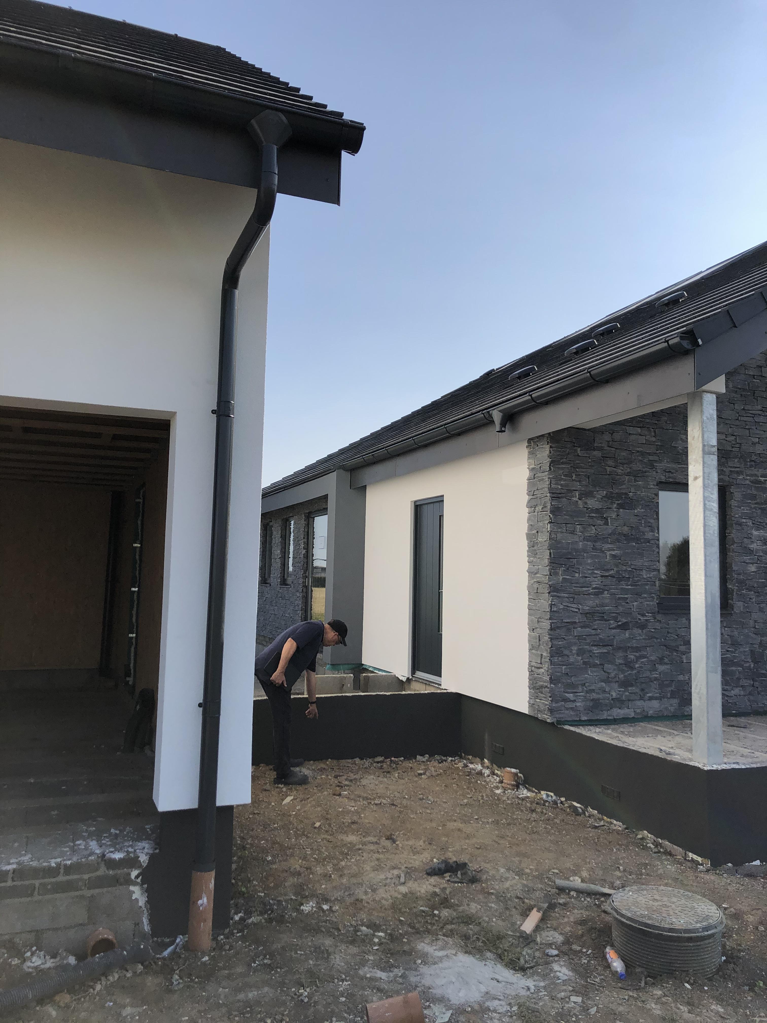

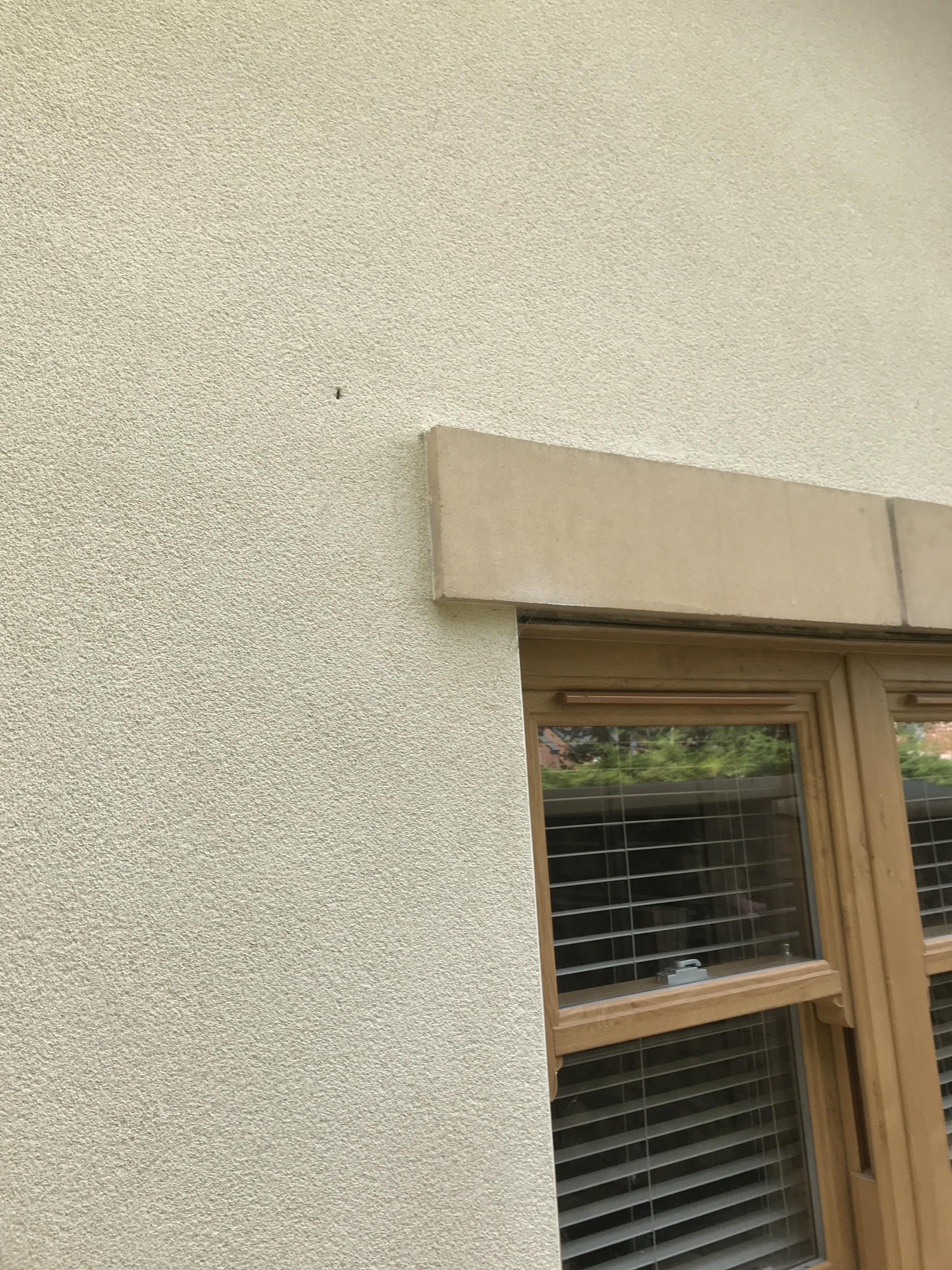

Mandana Posted September 17, 2020 Posted September 17, 2020 Hi guys The ‘envelope’ on our SIPs house was completed yesterday ... that’s the great news. Not such great news is we’ve discovered some vents in the base course are missing. The builder will be sending the groundworkers back to carefully cut out blocks to retro-fit these vents. The problem is the base course has been rendered, so it’s a major job, and it may end up needing patching. We've told them if the render doesn’t look great afterwards they’ll need to re-render those areas which they don’t want to do. Their words were basically everyone needs to pull together and compromise. Our view is they screwed up and missed 9 vents. The architect has said 4 of those can be dropped so we now have 5 that need doing. Would you expect the render to look as good as it does now around the vents that were correctly installed, or accept it may not look so perfect? You can see two of the Rytons vents on the wall on the right for reference.

Russell griffiths Posted September 18, 2020 Posted September 18, 2020 (edited) I would want it to look perfect if you have paid somebody to do it, if it looks inferior to the rest I would want that section re- rendered. Would it be be simpler to fit round vents so they can be drilled in using a core drill so the new round vent will cover the round hole, rather than them trying to cut out a square hole. Just a thought. Edited September 18, 2020 by Russell griffiths 2

Mandana Posted September 18, 2020 Author Posted September 18, 2020 7 minutes ago, dnb said: Are the whole of the telescopic vent thingies missing, or is it just the brick sized vent covers in the outer skin that are missing? The whole thing is missing - hole, sleeve and cover. Spoke to our architect this morning and he reckons the render will be fine if they are careful as it’s so fresh. It’s STO render - acrylic based for the SIPs, so it’s got movement in it and will be easy to touch up. Apparently!

nod Posted September 18, 2020 Posted September 18, 2020 6 hours ago, Mandana said: Totally agree nod. Sadly Covid had a lot to do with that. We were lucky to get any work done at all, especially as our contractors were 6 hours from home so finding accommodation was a nightmare. Even so, they should have been supervised. I’m just looking at the picture I can’t see the weeps above the openings Have they gone over those as well ?

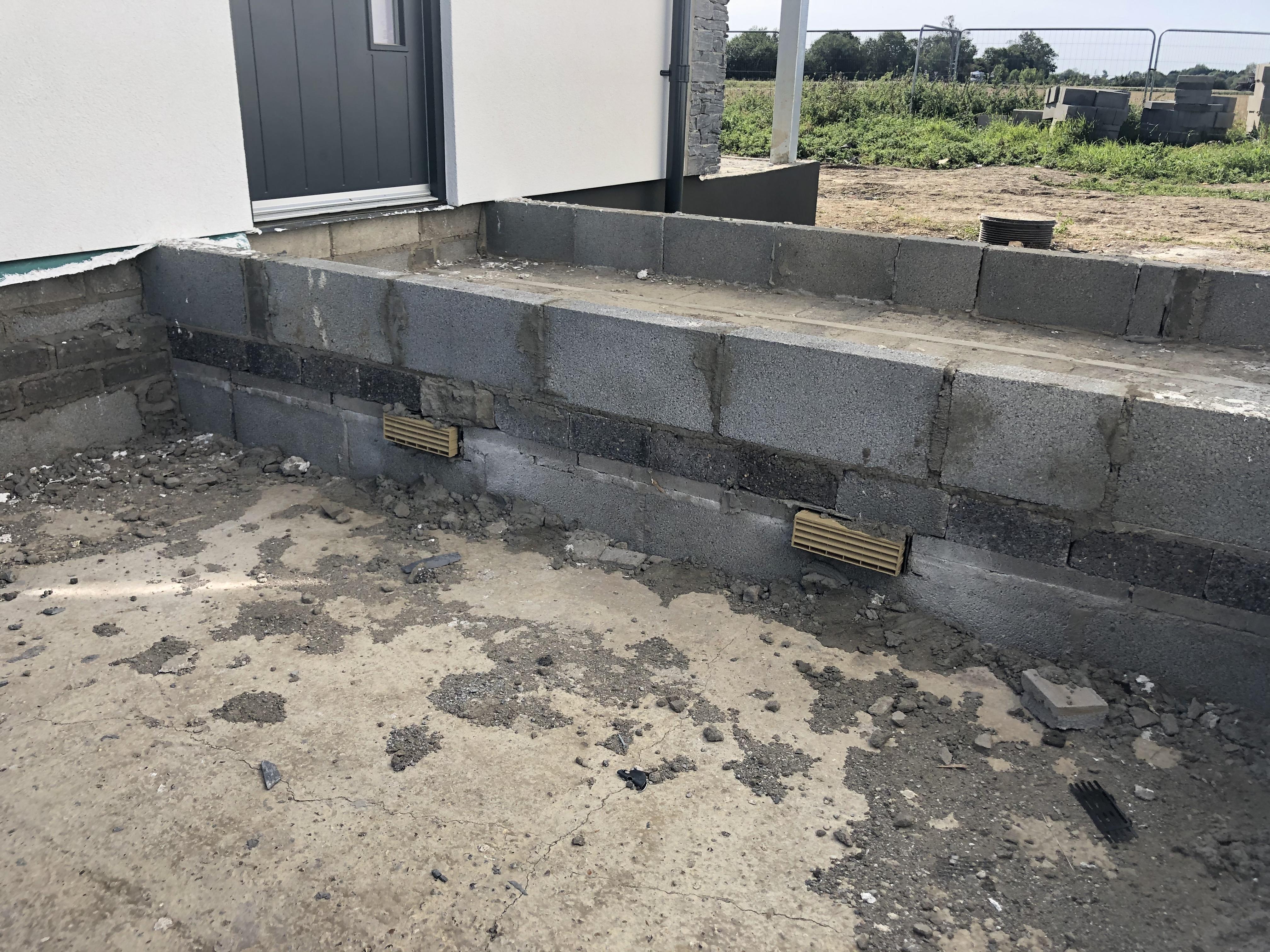

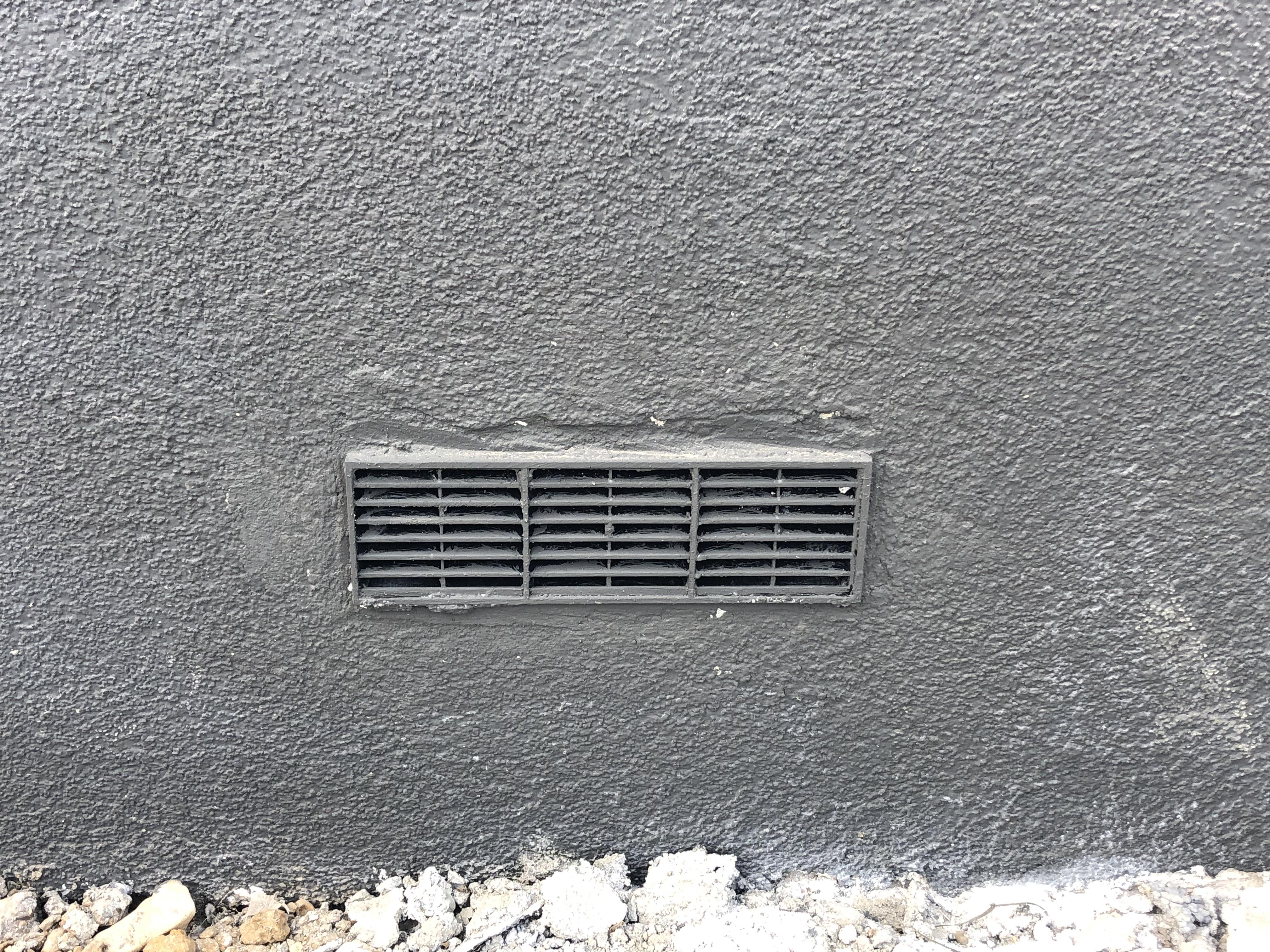

Mandana Posted September 18, 2020 Author Posted September 18, 2020 36 minutes ago, nod said: I’m just looking at the picture I can’t see the weeps above the openings Have they gone over those as well ? Not sure what you mean. There’s no weep holes in addition to the vents, if that’s what you mean? Just took this picture of one of the vents they missed and did knock through. Shame so many others were discovered after they left ? The second photo is a vent that was installed prior to the render application. And the third photo is of 2 more vents that were retro fitted but they weren’t in render, just under the (future) decking area.
nod Posted September 18, 2020 Posted September 18, 2020 There should be drains leading from the cavity trays and weep vents piping through the render
Mandana Posted September 18, 2020 Author Posted September 18, 2020 4 hours ago, nod said: There should be drains leading from the cavity trays and weep vents piping through the render Yours are high up the wall. Our vents are in the base course allowing air to circulate under the house. We raised our house by 2’ onto beam and block so that’s what the ventilation is for. Our architect didn’t design any weep holes anywhere. Ours is a SIPs construction so we want to keep both air and water out.
