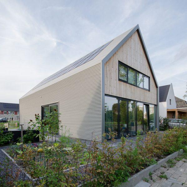

Trw144 Posted March 28, 2021 Share Posted March 28, 2021 (edited) Has anyone stumbled across a product/finish like this in their research into metal roofs? We have such a large roof/wall to clad (16m long, two stories, plus gables) I am concerned the amount of seams is going to make it aesthetically "busy" on the wall facade. I very much like the finish this company does (a company called Lofthome who build steel frame homes in Holland) and translating their website does suggest it's pbx greencoat from SSAB. Without seeing the construction detail, my concern will obviously be water ingress between the panels... https://lofthome.nl Edited March 28, 2021 by Trw144 Link to comment Share on other sites More sharing options...
