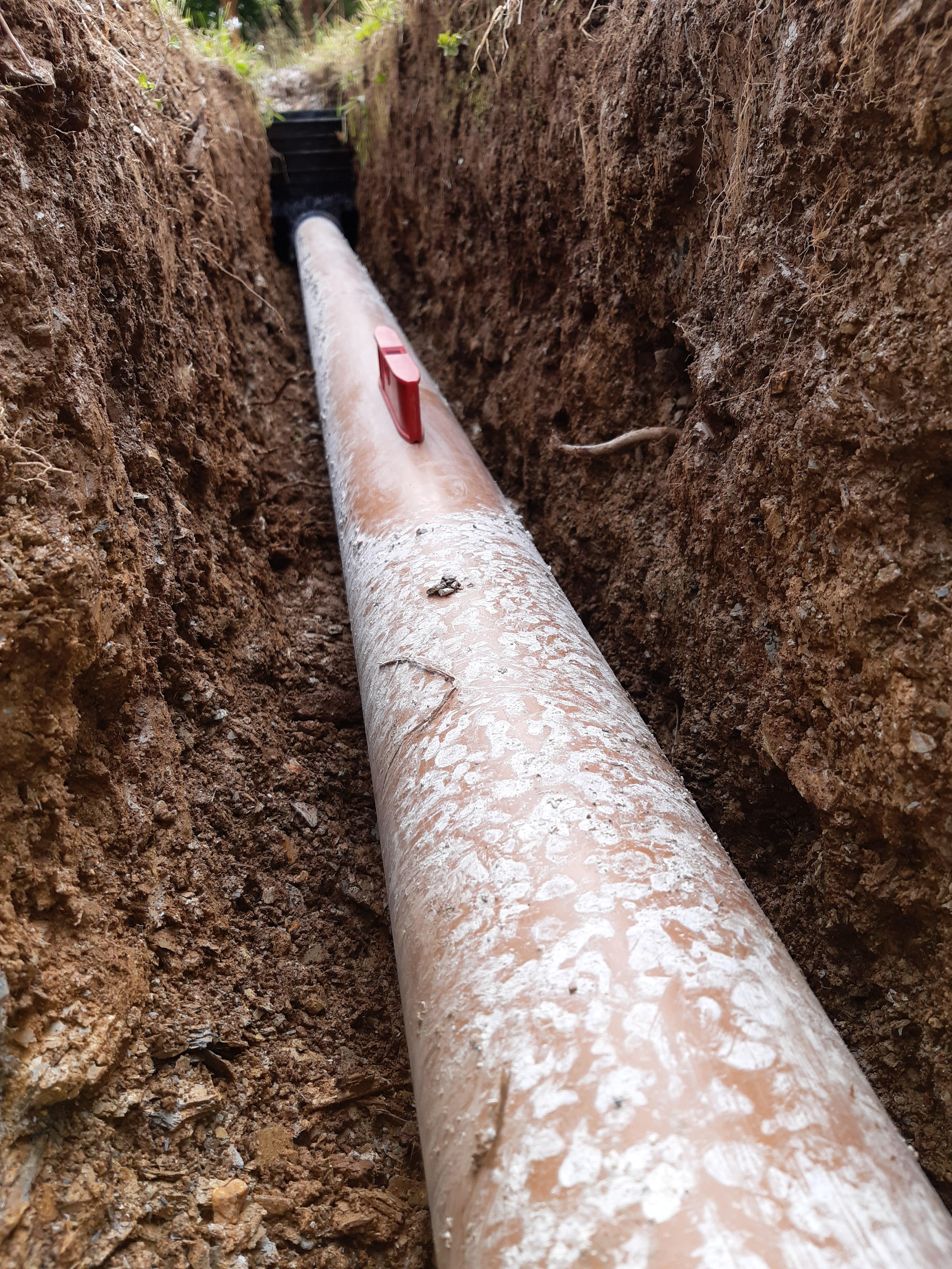

BotusBuild Posted September 8, 2020 Author Share Posted September 8, 2020 Belated follow up and to clarify a few things - we have Full Planning Permission granted 31 Oct 2017. Therefore, @Temp CIL does not apply. I thought that I had to tell the planning department at the council that I had started. Turns out I don't need to. I contacted Cornwall Council - the lack of knowledge of what I needed to do (or not do in this case) was astounding. I got three different pieces of advice as to what I needed to do. The last message I got started "If you'd like ..." !!!! I spoke to my architectural engineer who lives and works in Cornwall and so is very familiar with the processes down there. He had just had the same situation with another client who had used a planning adviser, and it turns out the key is that building control (not planning) has a record that work has begun. As I am using Stroma for building control, this replaces Cornwall building control department, and so I have no need to tell the council I have started. I have the confirmation from Stroma that I have started before the end of the 3 year condition on the planning permission, and so can provide proof the condition was met if anyone asks. @DevilDamo, the extra 6 months was in the back of mind, but I felt it was better to get in before the original 3 year limit. @Ferdinand, glad you celebrated my start in a good way. 1 Link to comment Share on other sites More sharing options...

BotusBuild Posted September 10, 2020 Author Share Posted September 10, 2020 (edited) On 08/09/2020 at 22:09, Temp said: Looks like Cornwall only introduced it in jan 2019. ... and the planning for us was granted before this date, so it doesn't apply @DevilDamo @Omnibuswoman - see previous commentary: I spoke to my architectural engineer who lives and works in Cornwall and so is very familiar with the processes down there. He had just had the same situation with another client who had used a planning adviser, and it turns out the key is that building control (not planning) has a record that work has begun. As I am using Stroma for building control, this replaces Cornwall building control department, and so I have no need to tell the council I have started. I have the confirmation from Stroma that I have started before the end of the 3 year condition on the planning permission, and so can provide proof the condition was met if anyone asks. The attached photo of some drainage pipe in a trench approx 600mm deep with an inspection chamber attached was sufficient for Stroma. There were some other photos showing pea shingle around the pipe and chamber as well. Edited September 10, 2020 by BotusBuild Link to comment Share on other sites More sharing options...

BotusBuild Posted September 10, 2020 Author Share Posted September 10, 2020 54 minutes ago, Temp said: You can always send evidence to the planners but apply to discharge that condition with others later. Saves the fee. I did ? ... and Cornwall Council told me categorically that a time limit condition cannot be discharged, so I'm satisfying myself with the fact that I have evidence (dated photographs) approved (by Stroma) that I can put under people noses should they poke them in ? 1 Link to comment Share on other sites More sharing options...
