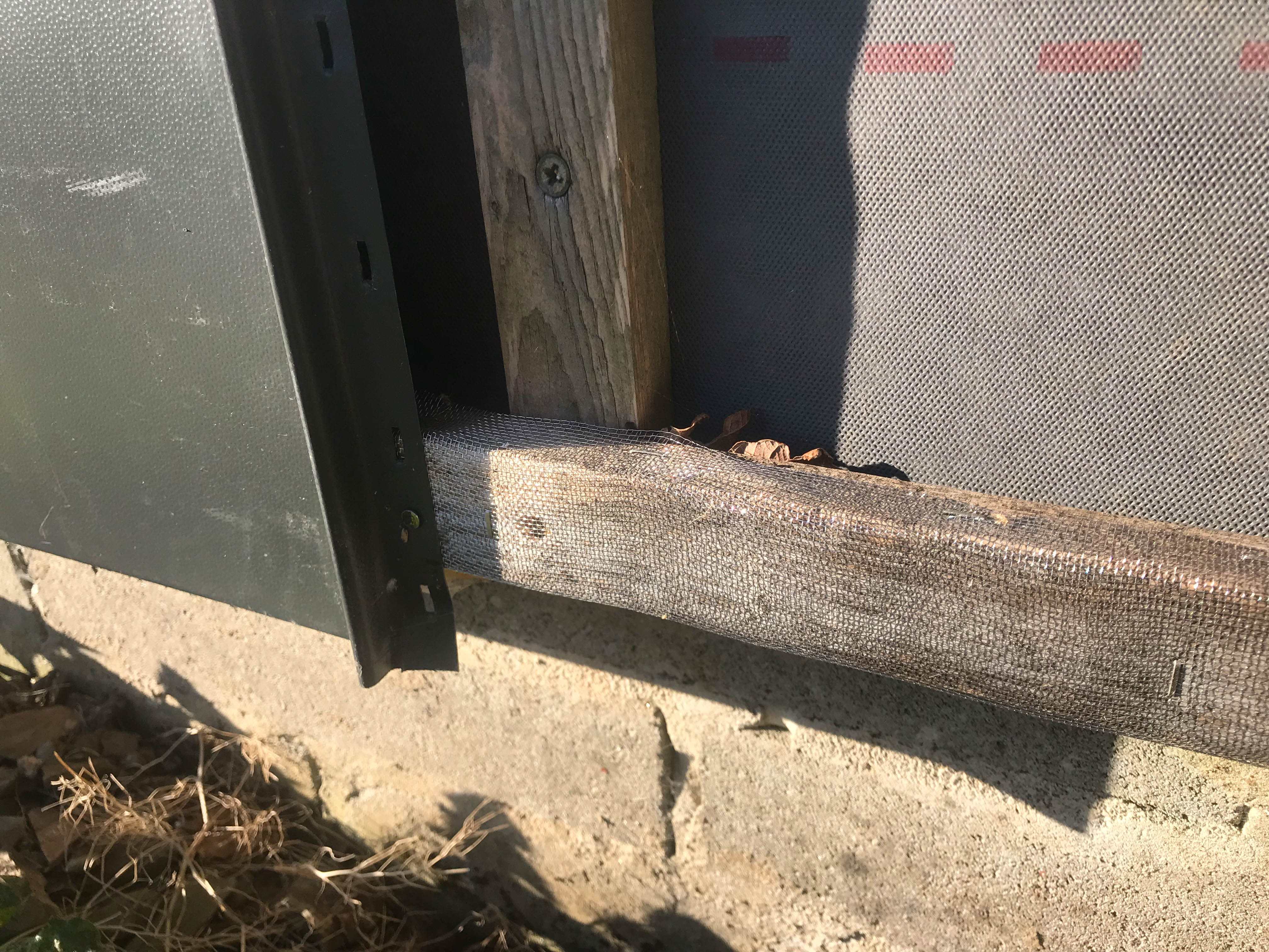

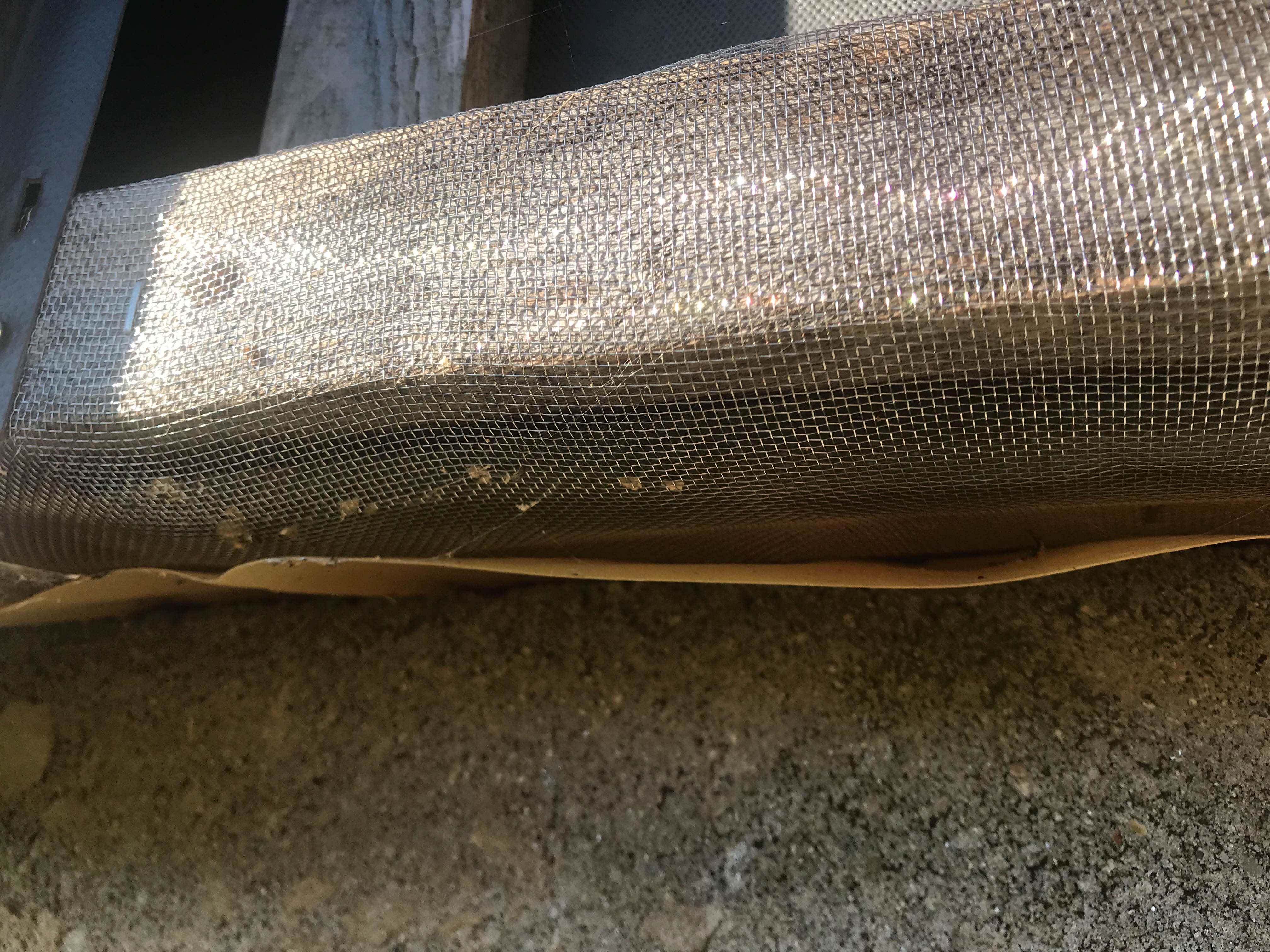

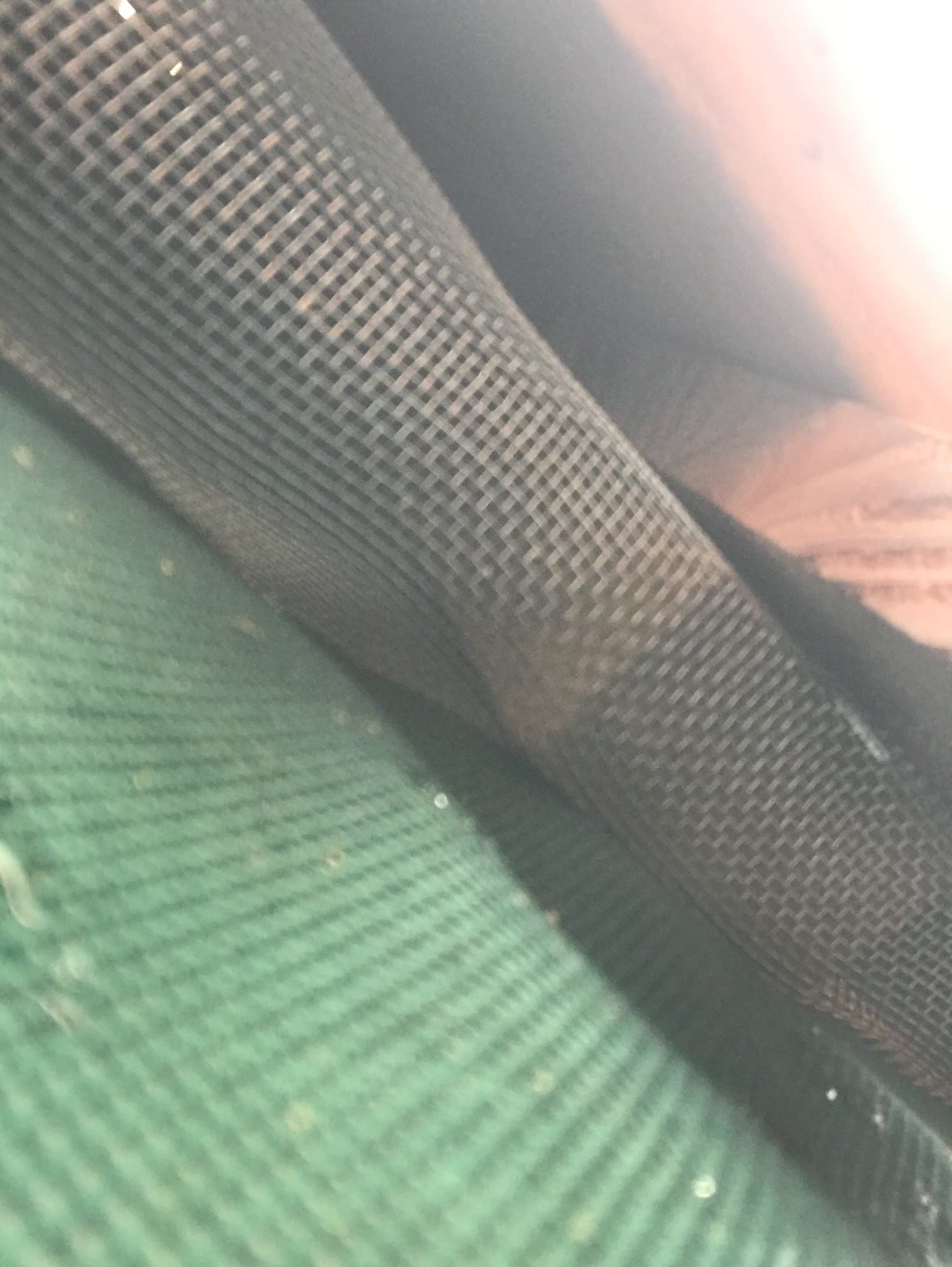

@junglejim
A couple of poor quality photos enclosed, 2 from 2021 where  the vertical Cedar cladding meets the metal cladding and other horizontal cladding (garage) taken just now.
I was able to staple the mesh to the timber frame behind the breather membrane and then pull up the front of the batten in a u shape.
I had a fixed horizontal batten with a gap at the back for air to circulate between each vertical batten, to confuse you I had a counter batten for the vertical Cedar boards. Its clear in my head!!
I did the same at the top of the boards.
I used 150mm mesh.
