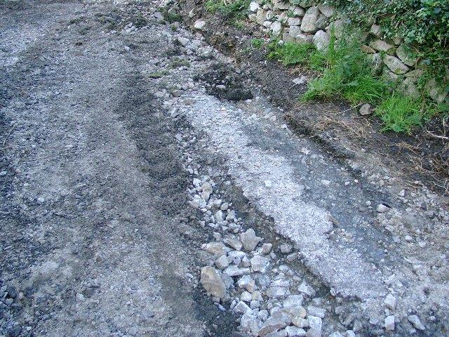

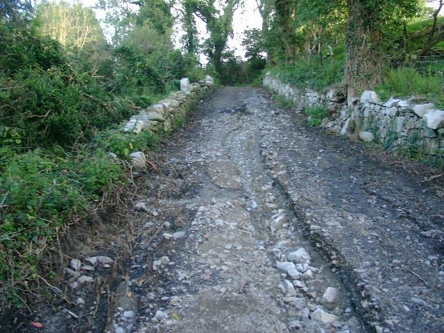

scottishjohn Posted September 3, 2020 Share Posted September 3, 2020 my road has just been washed out with the monsoon we had yesterday -water coming off farmers field on upside of the road- so yes i got to repair for time being but thinking of concrete the road in bits --but what sort of surface to put on it to make it usable in freezing weather --tarmac sounds like it will be more expensive +just as slippy with the hill suggestions pictures of damage to follow later Link to comment Share on other sites More sharing options...

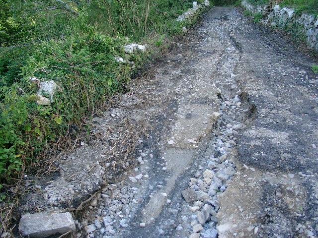

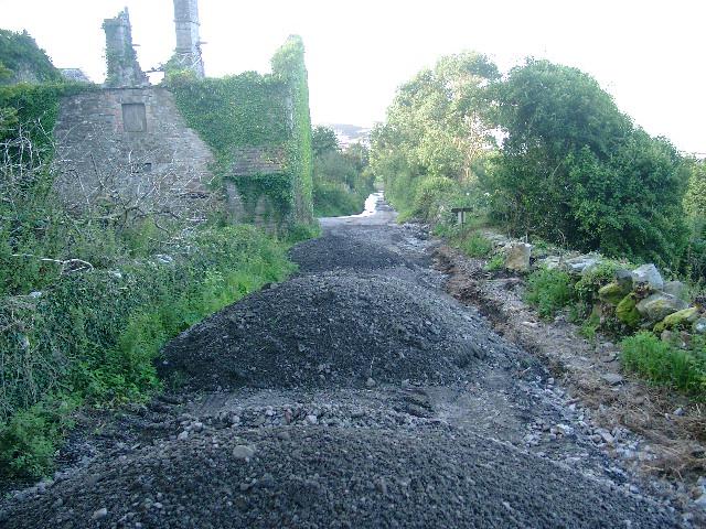

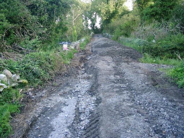

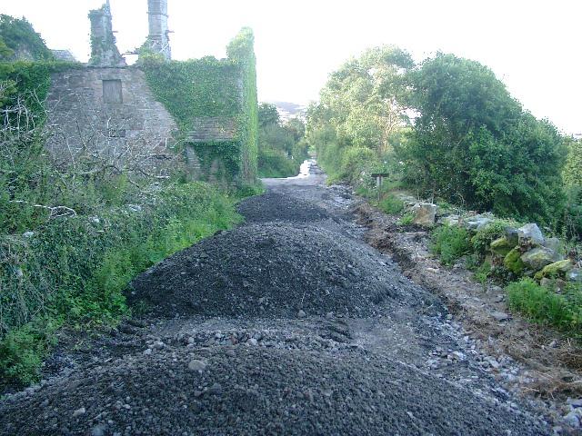

scottishjohn Posted September 3, 2020 Author Share Posted September 3, 2020 digger coming tomorrow and most of what was washed down has now been hauled back up by farmer and umped for me to work with it -get it back into place as afras being hard you will see when I get pictures that is not a problem -we have 12" DEEP GULLY in it and its still granite waste below that and then 2 or 3 leayers of tarmac above it --so hard fill is not the problem --jusat need to divert water --but where is the problem to be fair is was a once in 40 year event yesterday local farmer says last rain like that was 1954 -- -A75 was closed in parts due to fields washing on to it further along to gatehouse area 1 Link to comment Share on other sites More sharing options...

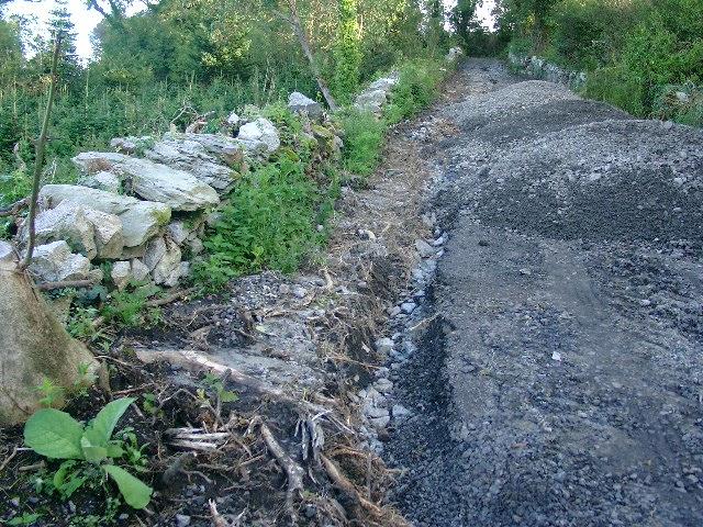

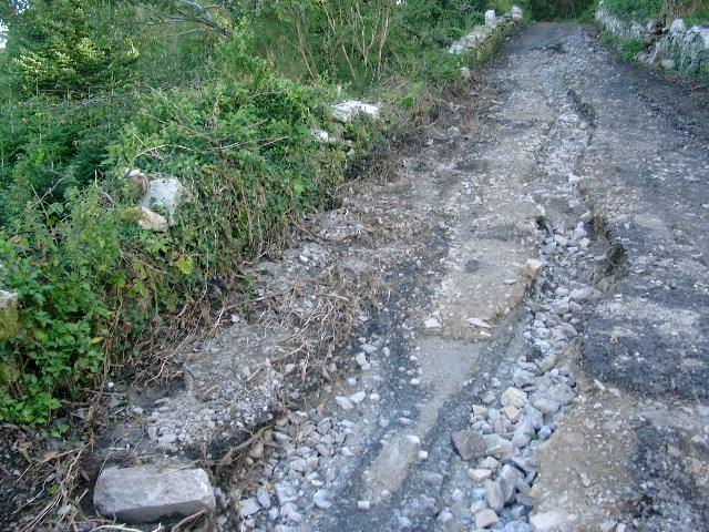

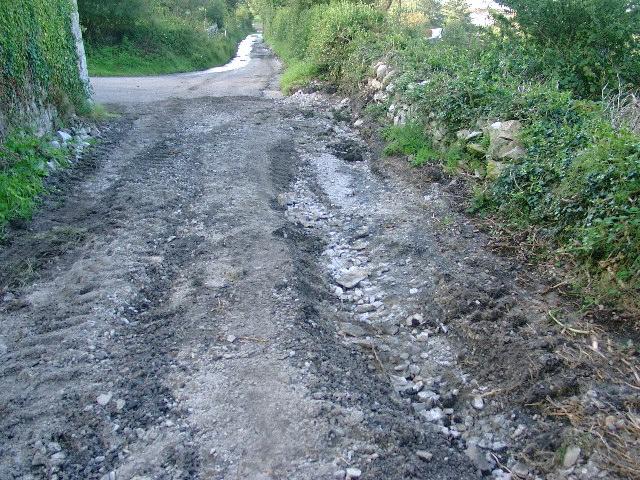

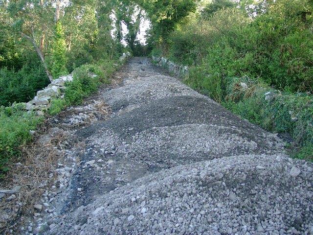

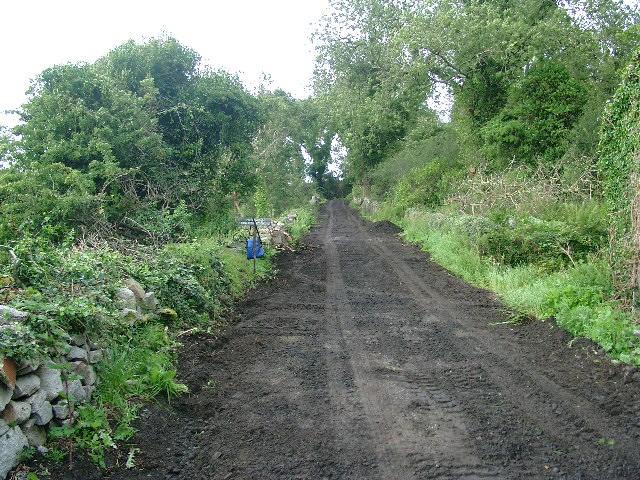

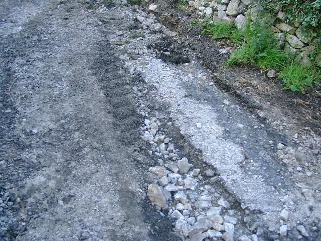

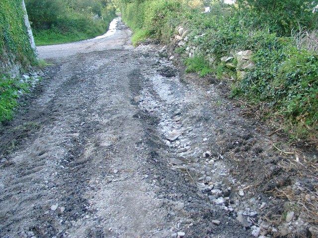

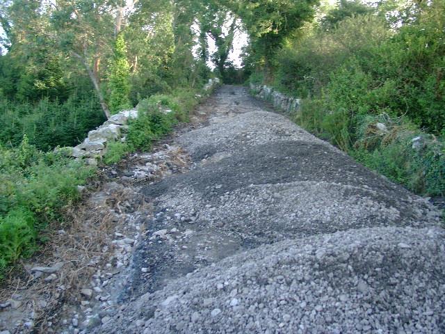

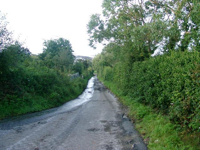

scottishjohn Posted September 4, 2020 Author Share Posted September 4, 2020 first picture was what the road was like on monday of this week. the othe pictures are the road after the monsoon which caused a burn to burst its banks in farmers field and then cascade over his wall onto my road the piles on the road are what we recovered from the bottom opf the council prad and hauled back up . today digger arrived and we started to remake it Link to comment Share on other sites More sharing options...

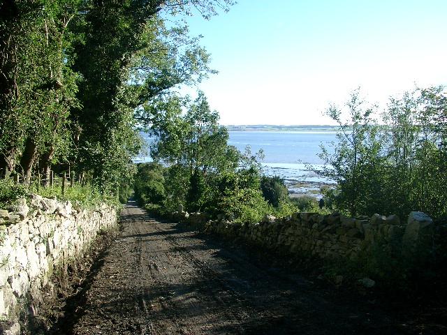

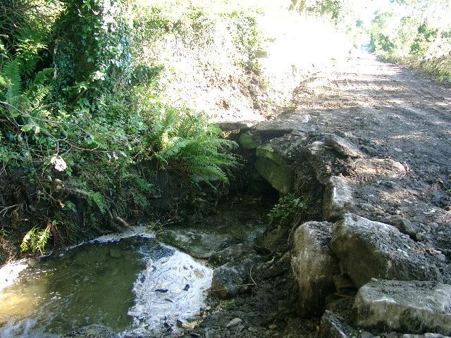

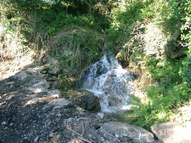

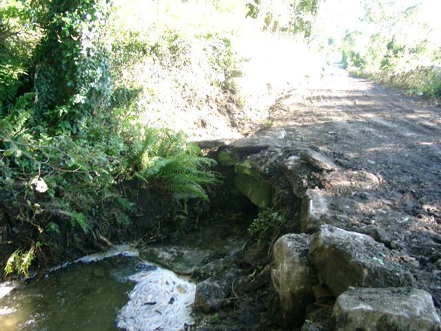

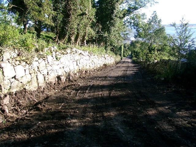

scottishjohn Posted September 6, 2020 Author Share Posted September 6, 2020 (edited) road now put back injust need roller and also remade the waterfall and culvert area where the burn crosses the road think Ii should rename this area as"timotei falls "--looks just like the advert with this flow and of course such a nice night -got to have some piccies of the view --its all that keeps me going when i,m feeling tiered and its too big a job also spoke to farmer and we modified his bit of the burn which caused the problem -- fixed I HOPE for my lifetime Edited September 6, 2020 by scottishjohn 1 Link to comment Share on other sites More sharing options...

scottishjohn Posted September 7, 2020 Author Share Posted September 7, 2020 (edited) this road has been in use for over 200 years and where the water ate through it you could see many layers of tarmac+ and hardcore+lack quarry waste mix --which is still as hard as hell even the deepest ruts still had well compacted hardcore at the bottom --so once it drys up enough for me to vibro roll the top layer back in I, m sure it will need nothing more than a hard water proof layer the reason it broke up to start with was due to 40 years of tree growth on the surface and root penetration and my clearing of it which meant i had to break through parts of the original hard top to remove 6" roots from the 30ft trees that grew on it my guess is a 5cum jigger of concrete will do about 10m of road more planning required and good weather my thoughts are to wait till house is built and heavy road usage by big trucks and construction equipment is past I will need a nice little lottery win to tarmac it all the way Edited September 7, 2020 by scottishjohn Link to comment Share on other sites More sharing options...
